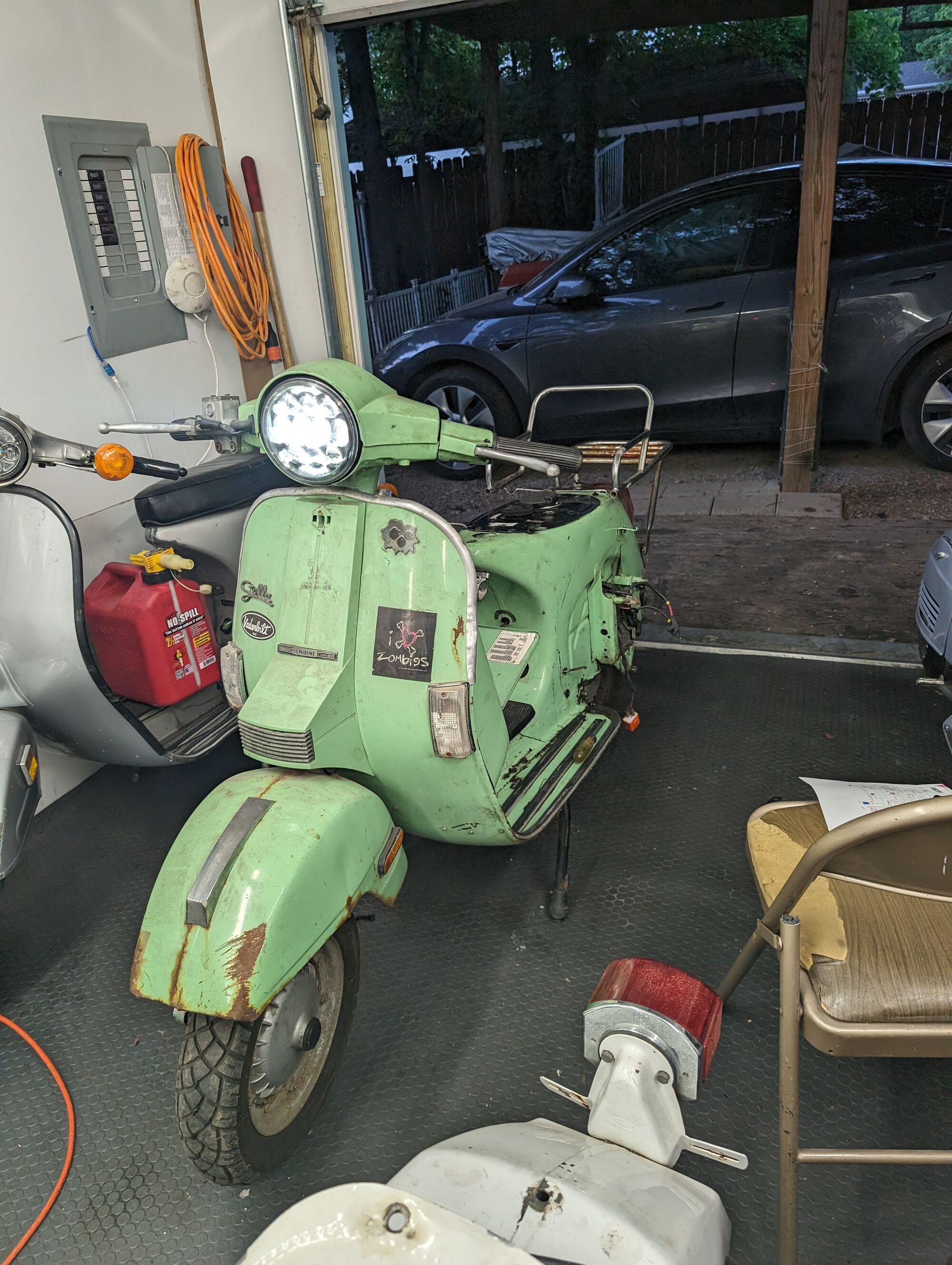

Okay...minty fresh might be a bit of a stretch, because I'm just going to get it cleaned up and put right mechanically for sale, not truly getting it minty fresh, but a reliable bike that you won't worry about anything that happens to it.
The motor is a Stella motor with a DR 177 and (at least for now) a SIP Road 2.0.
The first couple of updates were over in Today, I... This thread picks up where those leave off.
Hopefully, I'll leave the fires over there for a while, too. Razz emoticon

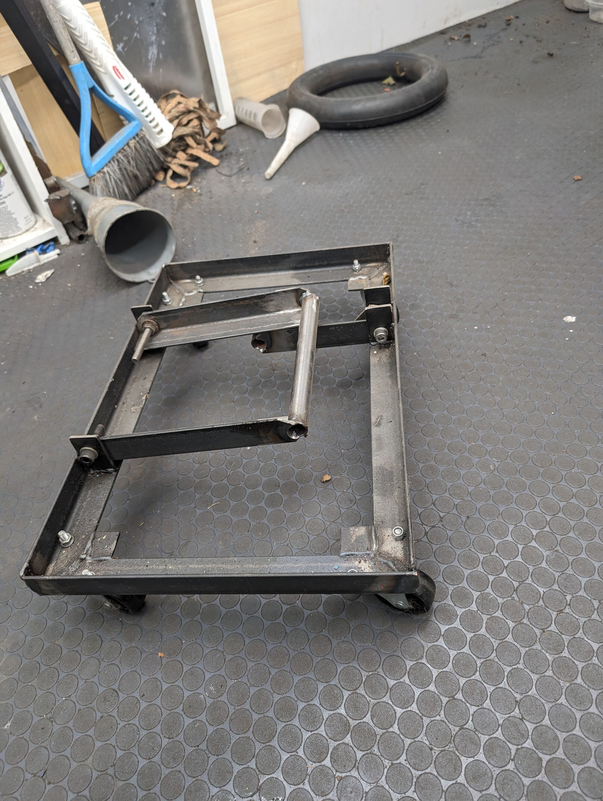

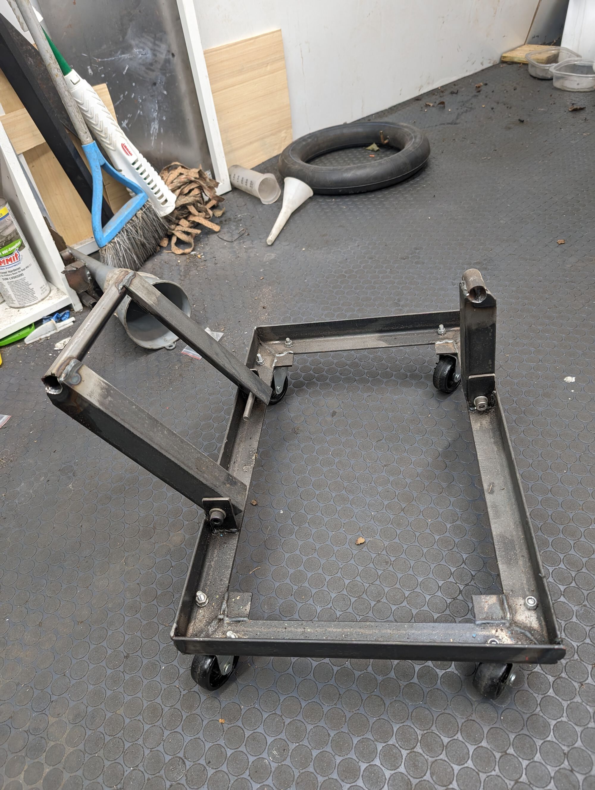

It was something I made as a project when I first got my welder. Which was coincidentally about the same time I pulled the motor from the Stella without an immediate plan to replace it, so I made this thing for easily storing/moving scoots with no motor in them. It also folds for storage in case I don't have any engine-less scoots.
The width is to give it enough lateral stability that the bike didn't need to be on its center stand.

Solid.

No, this is a totally different motor for the bike and it was built with the DR, but is stock except the top end and exhaust--and I'd do a stock exhaust if I had a non-catalyzed one on the shelf. I'd be hesitant to do anything but a mildly tuned motor in a bike I was selling unless someone specifically wanted it tuned out.
(On a not-totally-unrelated note, I'm contemplating putting the Sprint's motor back in it and selling it, too, which would be something of a violation of that rule. It's a BGM 177 with a 60mm cut crank, SIP RoadXL, 24/24, and set up to go fast. The "how much to de-tune" conversation has begun in my head, with your P200 experience being very much in my mind.)

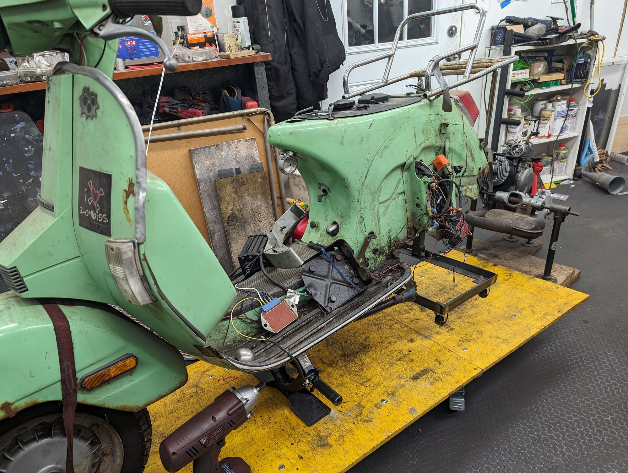

I spent some time today cleaning of the worst of the schmutz off the frame, then installed the motor.
I discovered on the test ride that the shift cables were backwards. How is it that I screw up something which should be, at worst, 50/50 odds, 75% of the time?
When I went back out later, it'd leaked gasoline on the workshop floor, but I just left that for now. I'll clean it up in the morning and track down the source. Hopefully it's something dumb/easy that I didn't check like a loose hose clamp.
Still, first kick start from dead cold is nothing to sniff at.
Next up after fixing the fuel leak will be electrical.

I spent a little time this evening getting the wiring back to a stock state, then installed and connected up the regulator. Amazingly, it all worked first try.
I even finally properly ran a new tail light wire to replace the one that's been run outside the frame for at least fifteen years.
Next up is a battery, seeing if the electric start is going to behave, and knocking the worst of the dents out of the cowls.
I'm not going to make it pretty, but I will clean up and galvanize the rusty spots, like on the mudguard.
It might even be DoTD time by this weekend.
Probably put the stock headlight back in, too.
