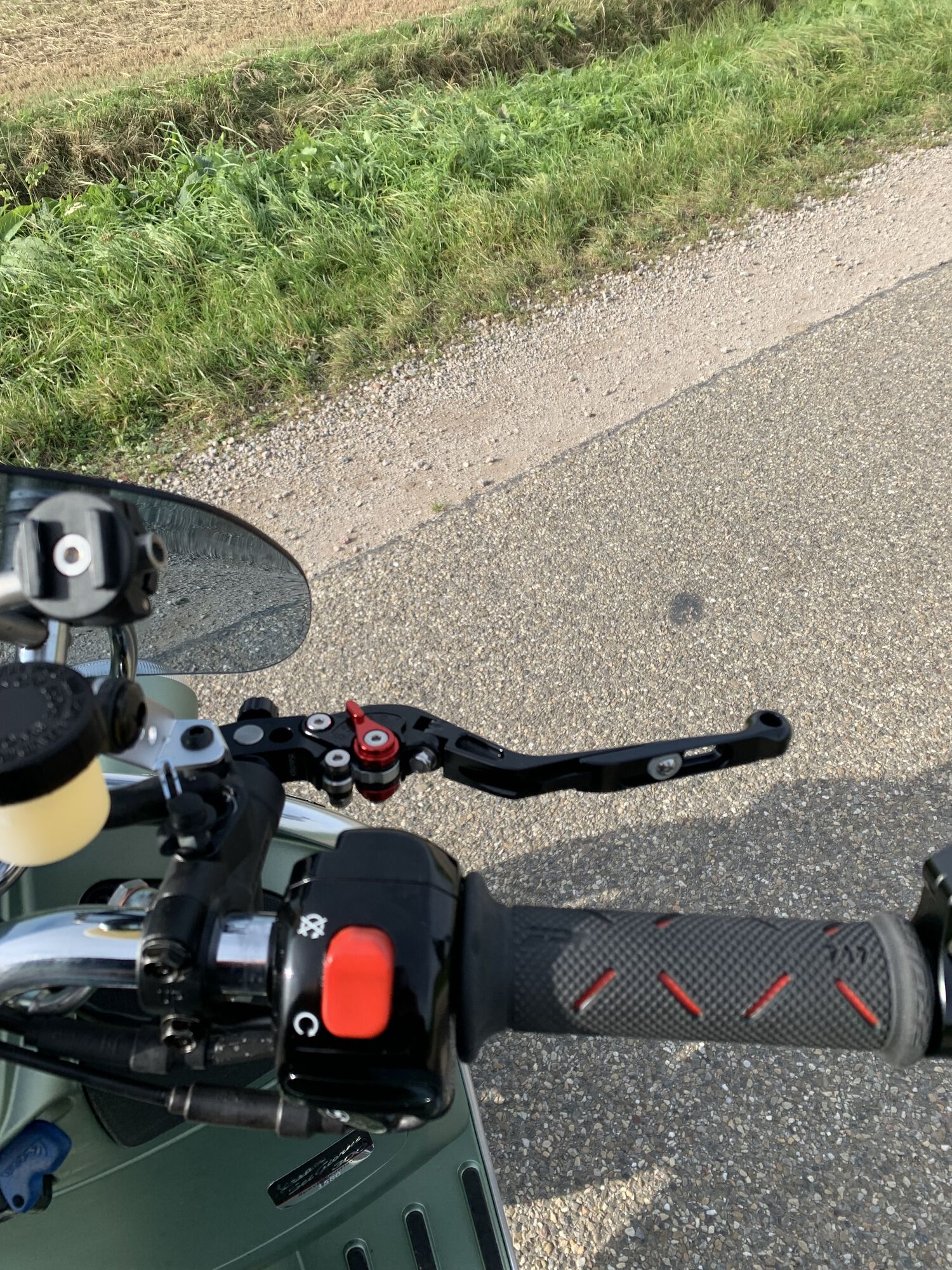

Put some radial on it

That may have to be the final solution. The issue is I don't want to spend 200.00 for a rear MC. Because I would have to purchase the front as well.
That setup does look nice, I will give you that.

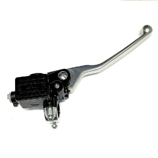

It appears that Piaggio has discontinued all the chrome master cylinders. We just got the new one for the LXV, and it went from being all chrome to this:
Sometimes you just gotta laugh.

Hi Motovista,
Hope all is well. The pic of the one you posted is the new replacement MC for the pre ABS GTV bikes?
I will order some if they are, Astatically the chrome ones get all pitted and stained over time. So black just might look better.

Cm074901 and CM074801 are likely the best ones for the GTV. They are the GTS versions of what you have now. About $120 for the pair, less the perpetual Cannonball Alumni discount. And with the savings from the Cannonballer discount, you can buy a nice big can of silver paint.
https://scooterpartsco.com/300-piaggio-c-801_836/brake-master-cylinder-rear-for-vespa-gt-gts-p-9006.html
https://scooterpartsco.com/300-piaggio-c-801_836/brake-master-cylinder-for-vespa-front-p-22824.html
