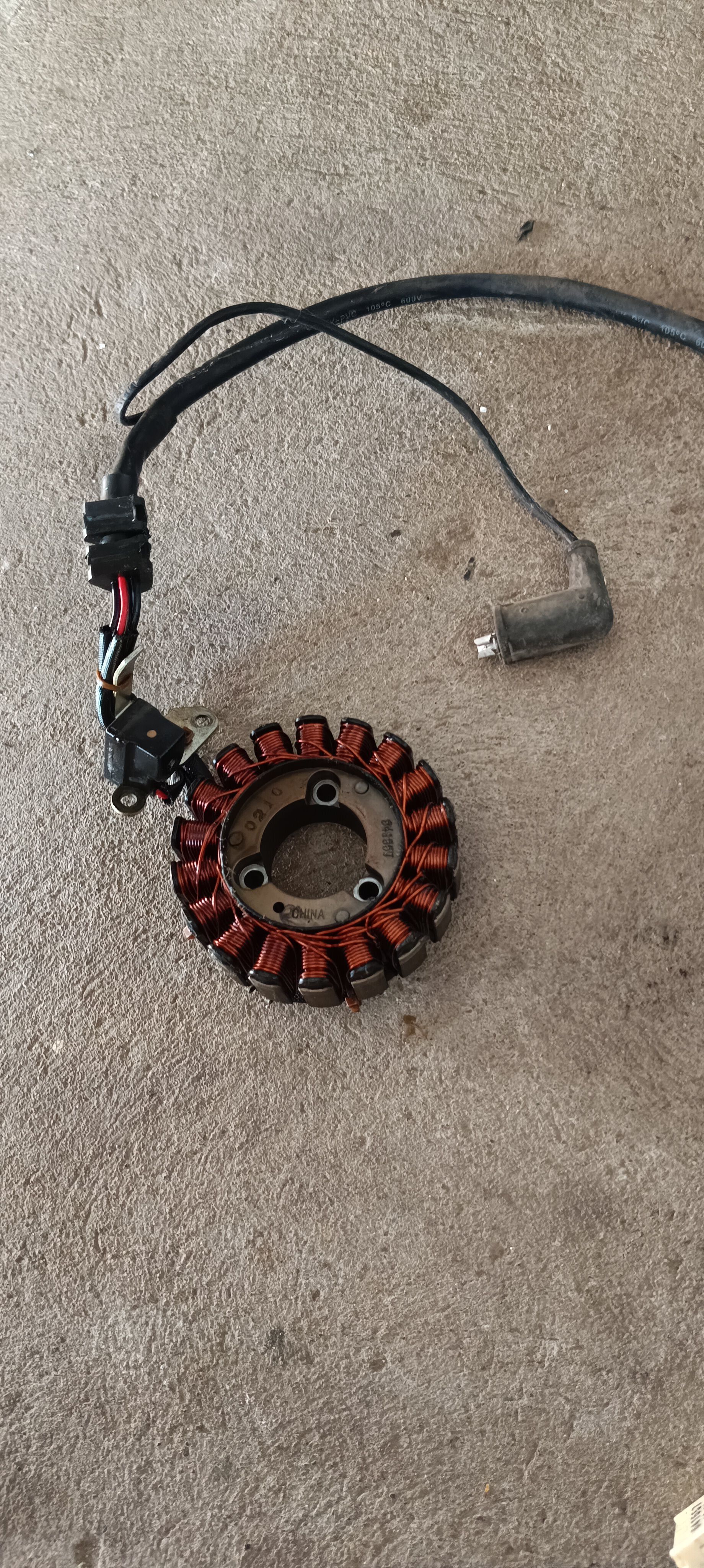

I am contacting you with a problem that there is no spark in the engine. I have checked the cables, the resistances of the sensors give good values ​​according to the service book. But I have a P0335 error code that I read with diagnostics. There is no signal. Does anyone have an idea where to look for the error? The engine revs. and turns on the AC. I bought the engine not long ago, it is not good.

The coil and the transmitter are together. I replaced both.
Ok, i thought you meant the *ignition* coil.
So since you've replaced that part it sounds like a problem with the wiring or a relay

SteelBytes wrote:
I was looking in a manual for a Moto Guzzi V7 (same ecu) and it says
P0335 is Engine revolution sensor - open circuit
thank you, I'm starting to go crazy. It started. I started to disassemble the cable that goes to the ecu and all of a sudden the error code disappeared and it started. Then again it didn't. I measured a break, it didn't break, sometimes there is a signal, sometimes there isn't.
