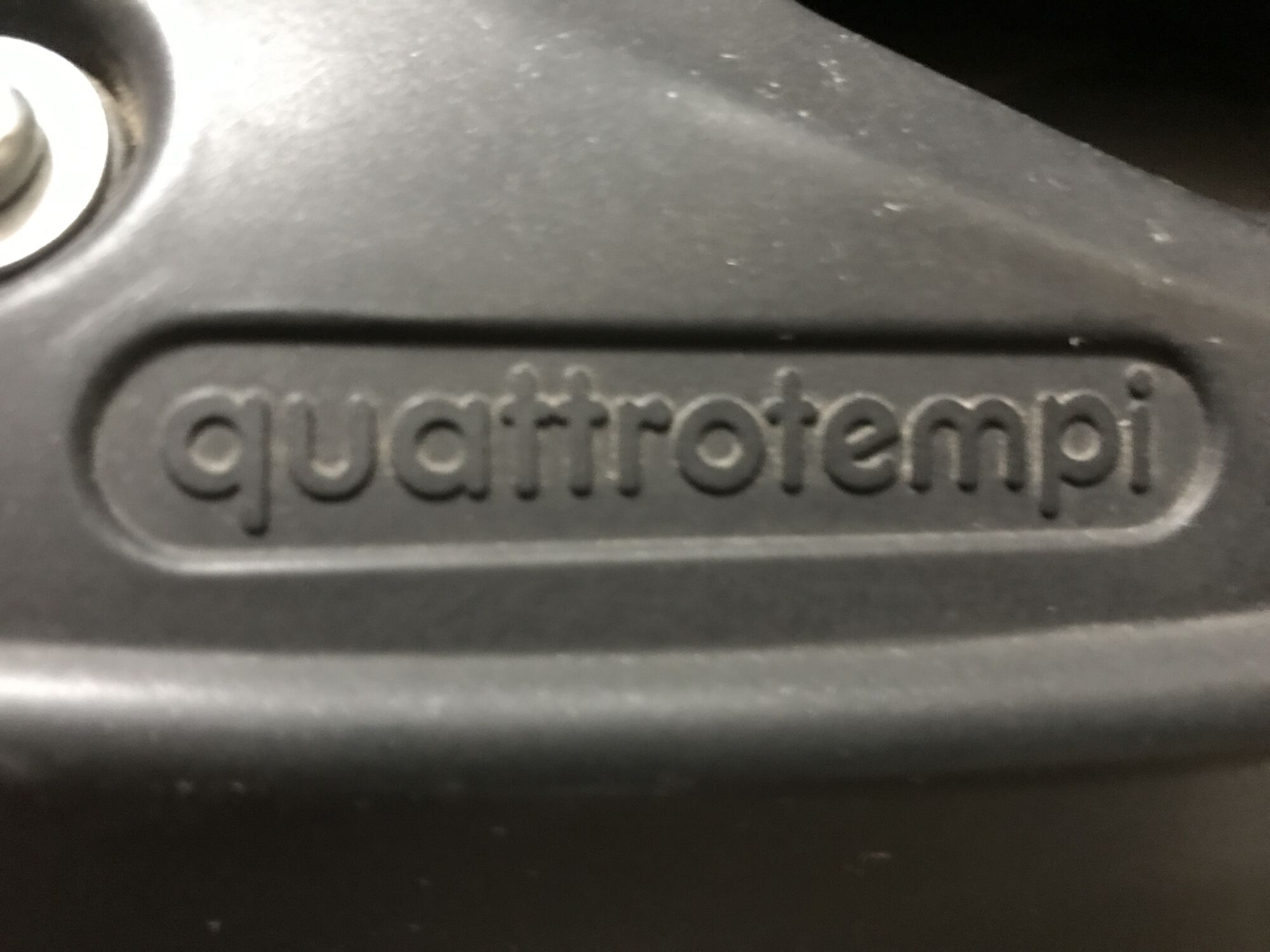

Here is a closeup of the branding on the exhaust and the extra parts that came with it in December of 2020. Is the air filter in the picture meant for improved performance?
I am not all that acquainted with scooters. What is a Variator?
The "Flat Surface" speed is 35 MPH. So I quickly agree with you that it does not have the full Malossi upgrades. According to my research fully upgraded Malossi have a top speed of 45 MPH.
Extra Parts
Extra Parts
Closeup of Exhaust
Closeup of Exhaust

It looks like someone was experimenting with the pod filter and different carb jets.
Personally I'd leave it with the standard air box it has on, I don't think the air box won't be restricting it much on a standard 50cc.
If it has the Malossi variator like the one below it will be behind the side cover on the engine (marked in red on picture).

There is no such thing as a Piaggio Malossi Fly 4 tempi. That's a whole lot of useless stuff sitting on the seat. Unless they have the Piaggio tags on the auto choke wires, those are likely the cheap Amazon qmb139 carbs that don't work on Piaggio engines. And there's jet kit that someone soon realized wouldnt' make the cheap carbs work on the Piaggio engine. The exhaust is some aftermarket brand that has nothing to do with Malossi. If the coil on the seat fits, it's a two valve four stroke, by far the slowest engine Piaggio has come up with in the modern era. From the way you describe the performance, it's a stock Piaggio Fly 2V that someone tried to make go faster. They used exactly one Malossi sticker to transform it into a Piaggio Malossi Fly, and that's not the sticker that comes with the variator, so that would be a surprise to find, and gave you a bunch of stuff they didn't know what else to do with. If they had two of those stickers, they could have made the word Malossi the same color on both sides of the scooter. If it has the red Malossi air filter, they might have gotten the belt tuning kit, which is a belt, the filter, rollers and torsion controller. If you're getting the idea it goes 35 mph from the speedometer, it likely still has the Moped State CDI, which keeps them down to around 30.
I would take off the stickers, put the big box of useless carbs away, clean it up and sell it as a very clean Piaggio Fly 50. Because that's what it is.
