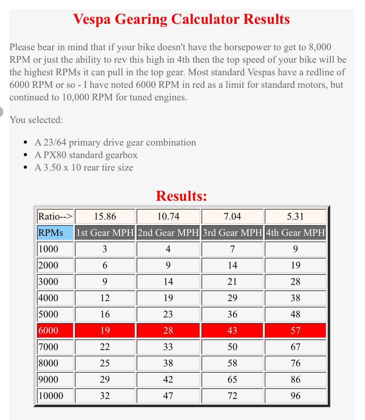

No. Your gearing now is almost the same an EFL PX150. If you had a kit that would do 8000rpm it would be plenty fast enough.

What does a kit capable of 8000 rpm look like?

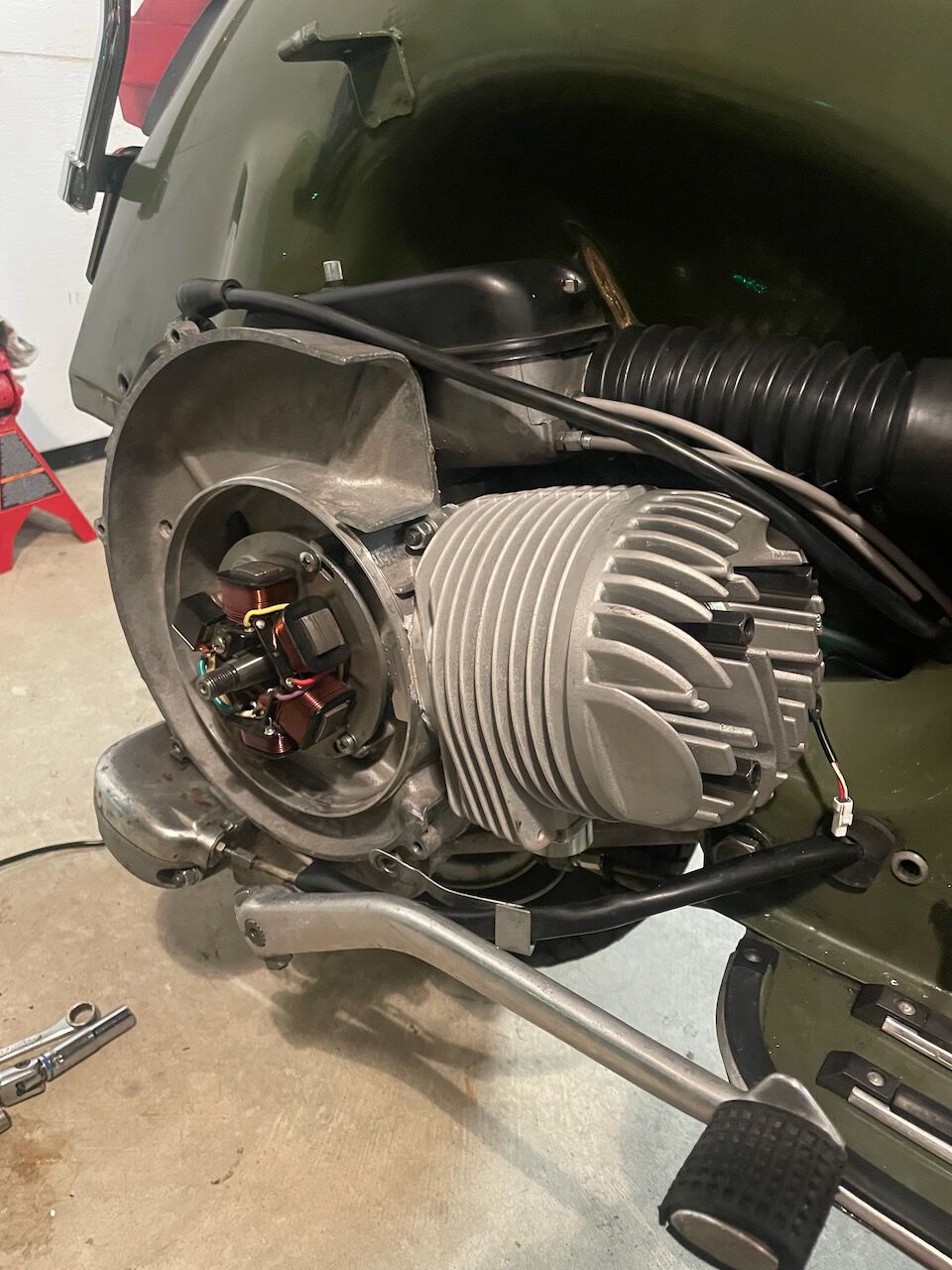

Y'all I went for it: found a set of P125X cases, nabbed a VMC Stelvio kit and did the requisite prep work. It's a real Frankenstein situation in my garage (P80X+P125X=P205X!!!). I was just about to close up the engine, but I've hit another hurdle and could use wise words.
The cush drive spindle from the P80X has a 13mm small end (like a PX150E, I think?) that straight-up won't fit into the VNX case. However, the spindle from an early model P200E I have on hand fits nicely. Before I disassemble the cush drive and create a new unholy fusion, do you know of any mechanical reasons that it won't work?
Also, side note: I have a new original-style clutch basket. Do I need to/Should I get one of those reinforced baskets to keep this higher-revving engine from flinging the clutch apart?

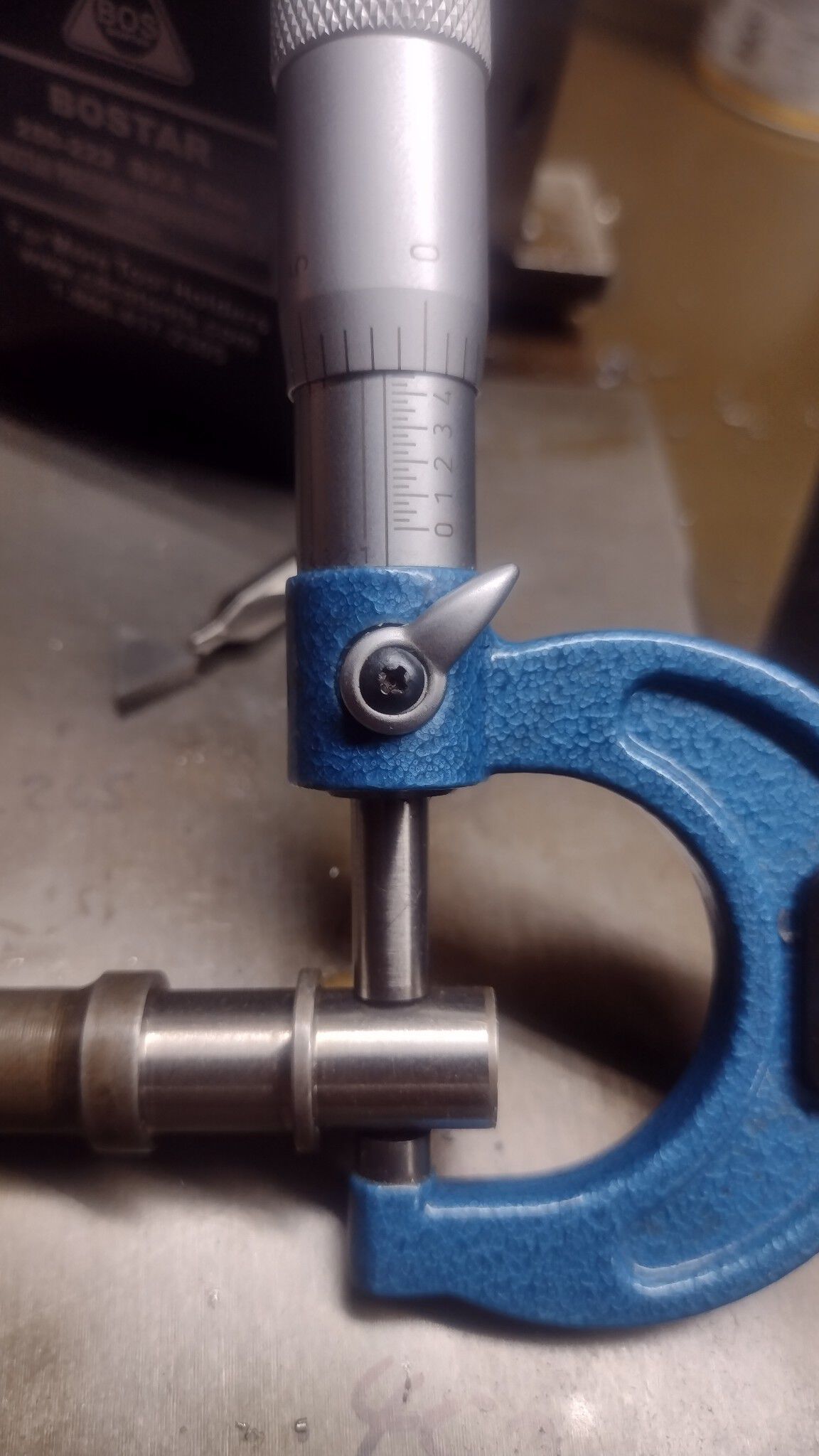

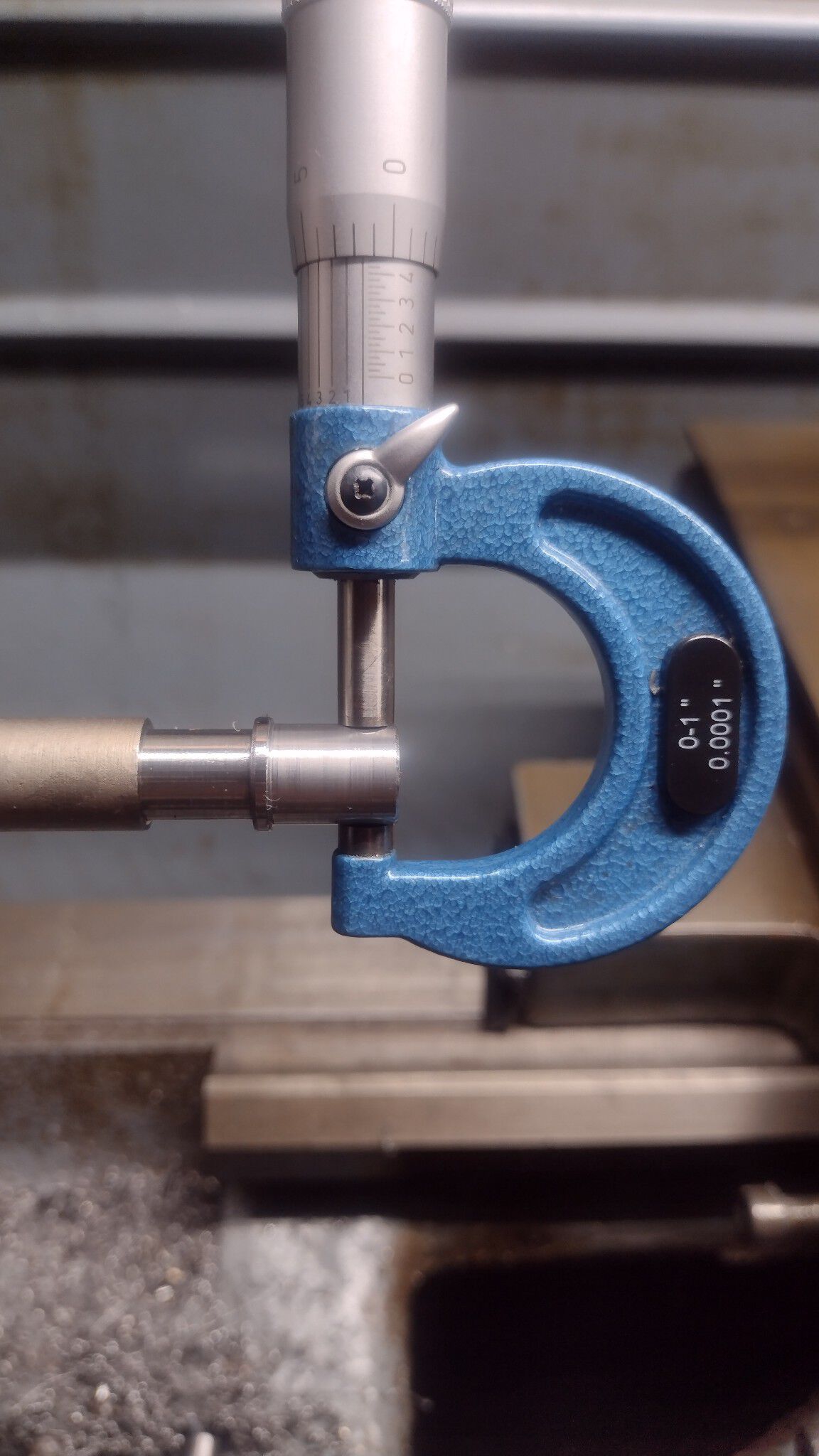

Well, it turns out that the P200E spindle is around 14.7mm where it slides into the cushion drive assembly. Too big for my stuff, even though the small end fits nicely into the cases.
Does anyone know which spindles measure around 12.7mm in the shaft, but with an 11.5mm small end where it slides into the case?

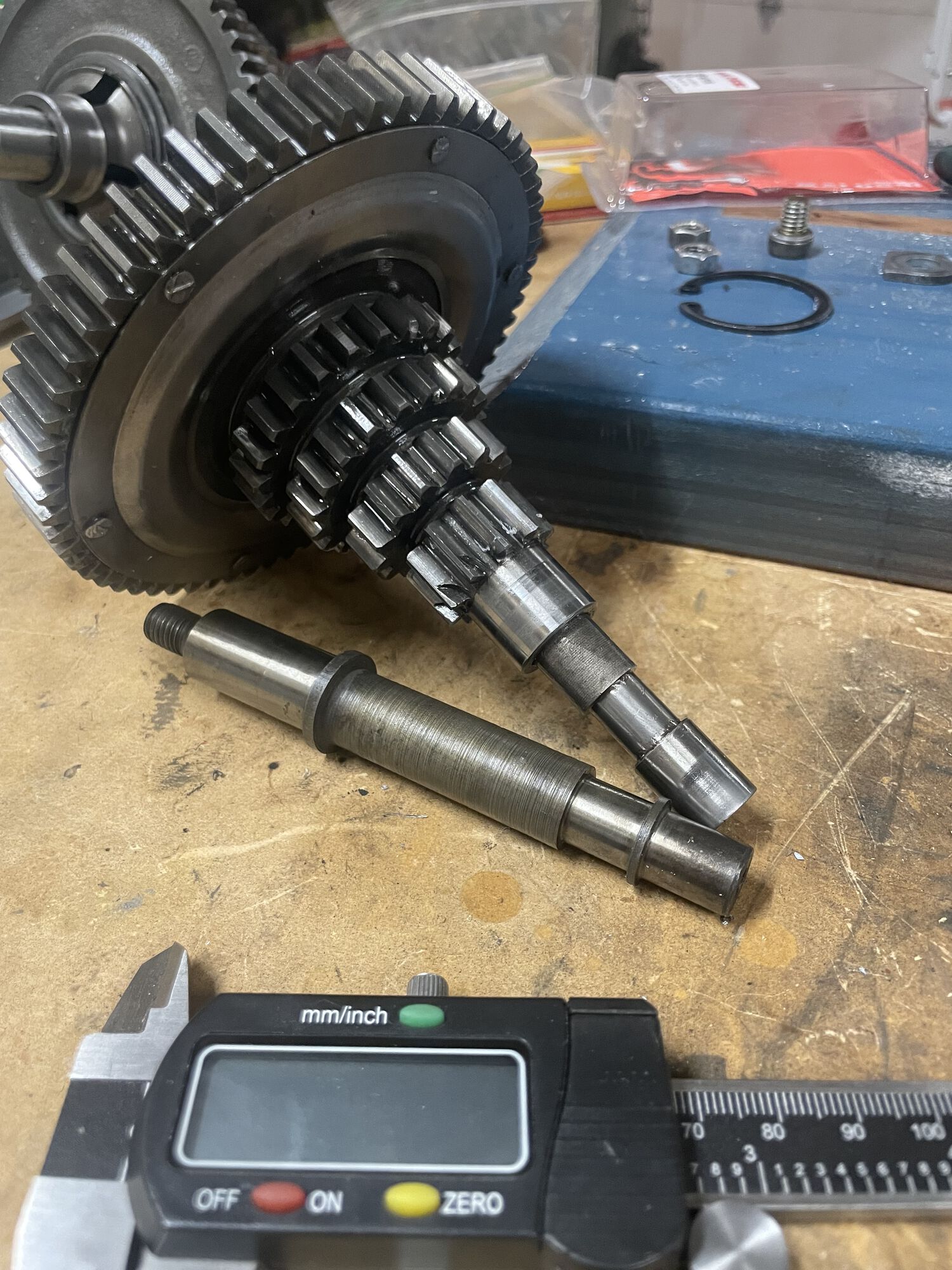

The bits. P80X cush drive / primary gears all assembled. P200E spindle in foreground.

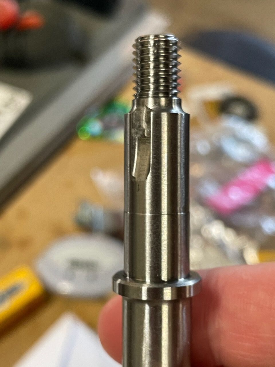

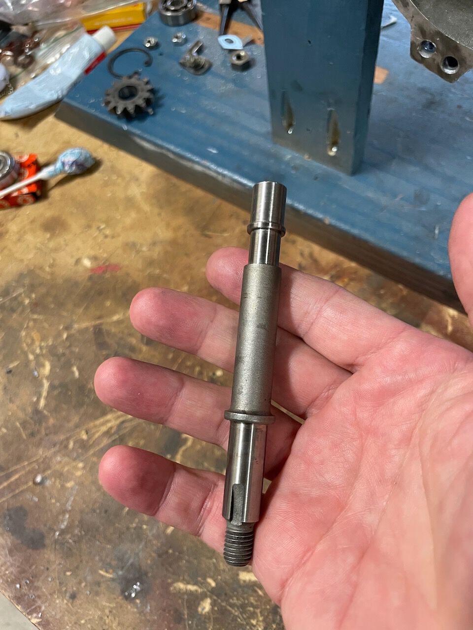

So it turns out that the P80X gearbox is such a weird little creature that this whole case swap project may double in cost, unless I can figure something out.
I can't use the original P80 cush drive spindle/input shaft in this P125X case because the small end is 13mm like a PX (case accepts 11.5mm).
A P200X spindle is both too large to fit the case on the wheel side and too thick to fit in the P80 Christmas tree.
A just-purchased P125X spindle fits the cases nicely, naturally, but at 14.7mm where the shaft fits into the gear tree is too large to fit.
I see my options as:
1) Forever sulk miserably and never ride this scooter again in this life or the next. (Zero Dollars)
2) Cram P200E gears into P125X case with Super 150 spindle/input shaft -- but how would this perform with Stelvio 177 kit? Maybe do the T5 4th gear? (Several dollars)
3) Source entire P125X gearbox and pair with existing 23/64 Malossi primary gear kit (All the dollars)
4) Find someone who can mill P80X spindle small end down from 13mm to 11.5mm (Literally no idea on cost/quality/outcome of this)
5) Custom CNC a spindle/input shaft from scratch (Chunk of change)
Any other ideas?

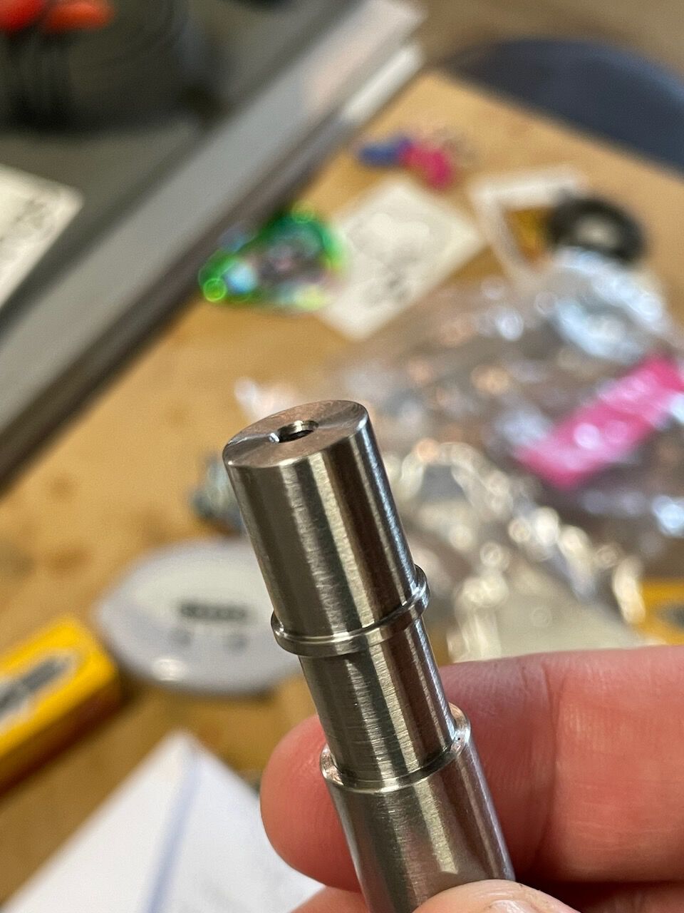

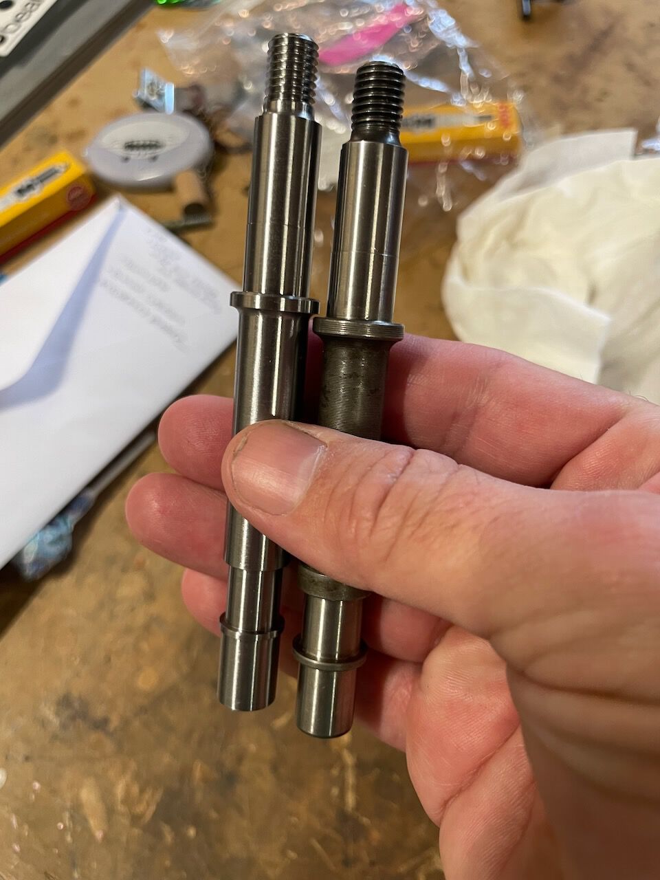

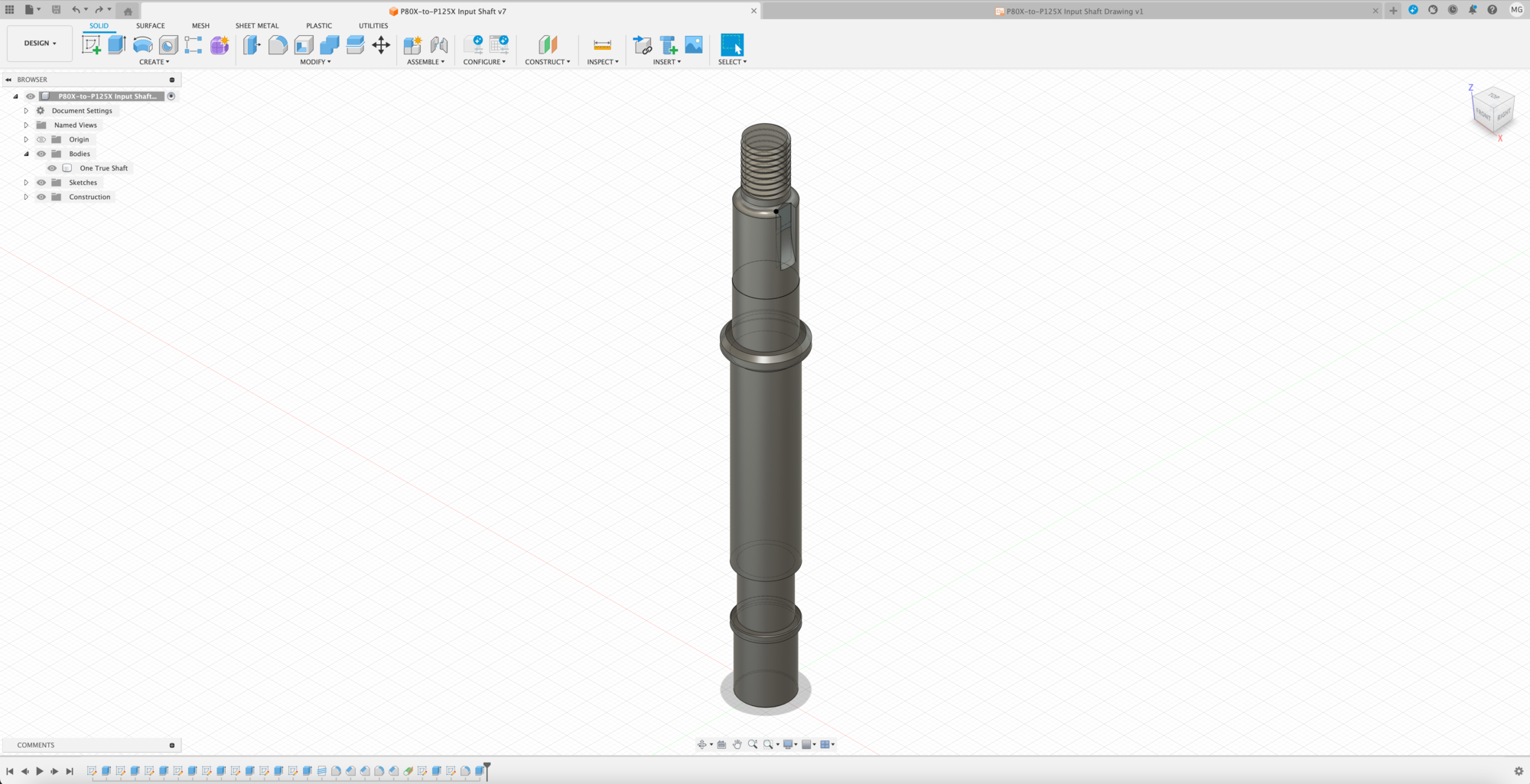

Option 5 it is. Turns out that one-off CNC milling services are pretty cheap now.
After taking many measurements and an hour of CAD, I have a design for a cush drive spindle that marries the P80X cush drive christmas tree to the P125X case. Turnaround time, including shipping, should be around two weeks. Fingers crossed!
Frankenspindle in CAD.
@steely_dan avatar
Lambretta GPs Lambretta S1s, Vespa Gl, Vespa P200, Serveta 150
Posts: 143
Location: United States
@steely_dan avatar
Posts: 143
Great solution! I really need to learn CAD. Very impressed.

how do you spec the material and hardness so it doesn't explode?
@bajarob avatar
Posts: 1768
Location: Ventura, CA
@bajarob avatar
Posts: 1768
Send me your spindle and I'll turn it down in the lathe.
LEGEND!!
Total guesswork, given it's not a shaft that rotates. It'll get milled out of AISI 4140 alloy steel. I'm not an engineer: just a schmuck with a free Fusion 360 license.
That being said...
What! Brother, I would like to take you up on this offer. Thank you! I'll DM you.
@bajarob avatar
Posts: 1768
@bajarob avatar
Posts: 1768
It's just the small end so no biggie. Flat rate box from the post office is cheap enough to make worthwhile. Then you can put it in and see if it works without spending a bunch of money.😉
@bajarob avatar
Posts: 1768
@bajarob avatar
Posts: 1768
Here you go.

Okey doke. Thanks to the amazing BajaRob, we are back together.
With the engine closed up, reinstalled and timing set, it started on the second kick. Also now I what actual compression feels like!
Here's what I've got cooking:
-VMC Stelvio + case ported
-Mazzuchelli sport crank
-SI 24/24 + drilled
-Fast flow tap
-Undrilled air filter (I had lean condition issues with a drilled filter on the old setup)
-SIP Road 3
Initial carb stack:
140/BE3/128
55/160
Now it feels like I just need to do the whole jetting rigamarole whilst running in the new cylinder kit. It seemed pretty boggy throughout the throttle band, but this is the fun part. Wondering if I'm stifling myself with an undrilled air filter.
Thanks for all your tips and guidance!
More for posterity than anything (it won't be going into the engine), check out the spindle I got back from the folks at PCBWay. They nailed my CAD file almost perfectly. If I could have had the alloy hardened, it would be perfect.
Custom spindle on left, P125X or P200e spindle on right.
Milled groove for clutch nut/washer finger thing
Business end where spindle fits into case.
