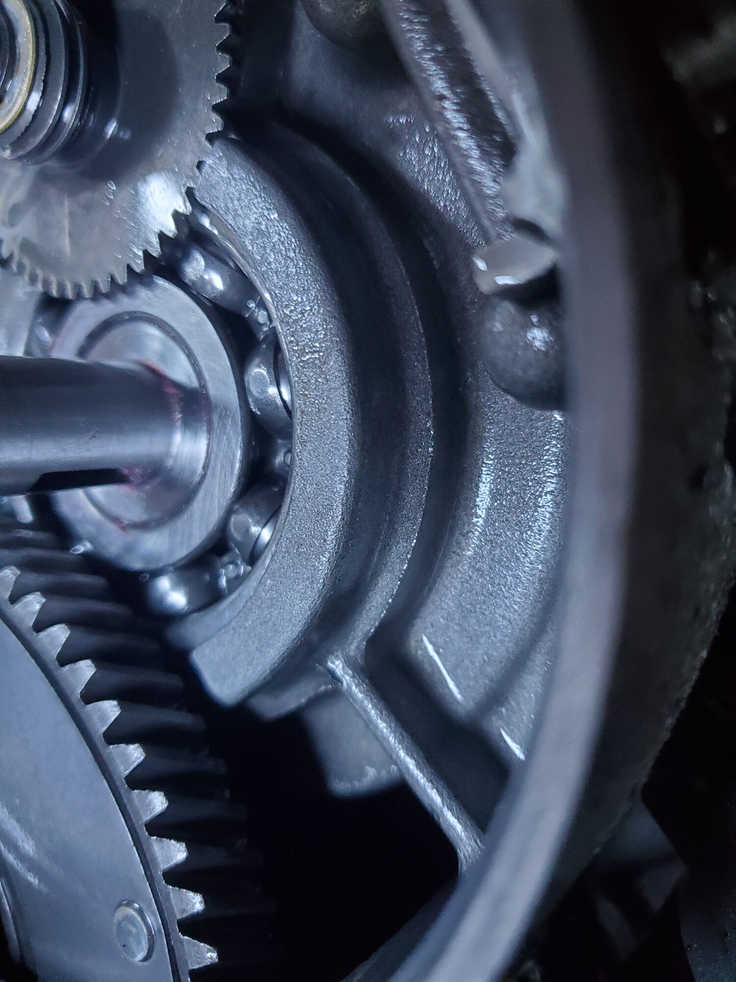

Hello all,
I am having a problem with my 2005 Stella that is killing me. I can't figure this thing out.
If I take off like a responsible scooter rider, all is well. I can feather the clutch and throttle for first gear and leave the line just fine.
But when I take off from a standstill using elevated rpm (e.g. for a fun launch or to quickly catch a gap in traffic) or uphill (which also requires elevated rpm), the bike lurches. I can freeze the clutch lever during the lurch and what I feel is essentially the clutch grabbing then releasing over and over again. Then ill have to bring the clutch in again and feather slower with less rpm for longer. This only happens on takeoff.
This has only been happening since my engine rebuild. I could launch no problem before. The bike has a grand total of 2000 miles. 250 miles ago, Sept 2023, the crank gave out in usual fashion. Engine wise, it was all stock except polini pipe. Now it has a mazz crank, road 2, and polini 177. All bearings, cruciform, seals replaced. Passed leakdown. Oil flinger installed.

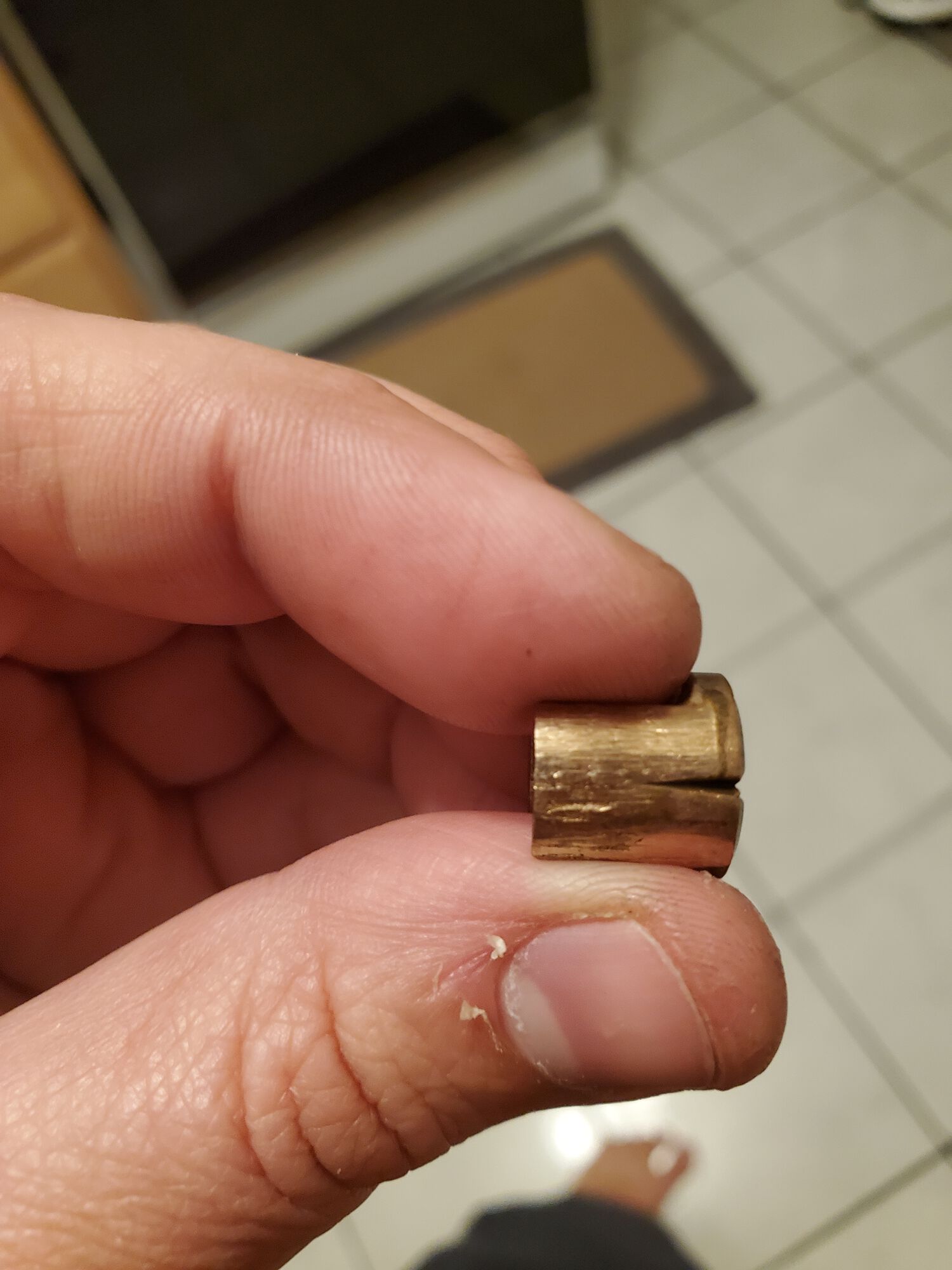

During the rebuild, I replaced the brass bush in the clutch because it was loose and put oil between all the old plates. Only the brass bush was swapped. The OD of the bush was very tight so I sanded it till is was loose (per WhiteOneRacing YT video). Bike together and I have this lurch problem. It was my first rebuild so I figured I messed something up.
I bought a brand new Stella clutch from ScooterMercado. Using the clutch tool, I separated all the plates (while clutch was together, wanting to avoid any assembly/disassembly variable) and soaked the entire assembly for three days in oil, flipping it halfway through.
Installed in the bike, problem persisted. I then replaced the gear oil, doing two 100 ml, 5 minute idle flushes (I has a guess that maybe the wheel bearing grease I used for assembly may have some additive in it causing the problem), before adding 250 ml SAE 30 non detergent oil (bottle is 2 years old). Problem persisted.
I replaced the cable inner, problem persisted (I replaced the entire cable during the rebuild).
I have adjusted the clutch loose and tight, problem still persists.
I have no idea whats left to try. Any ideas?

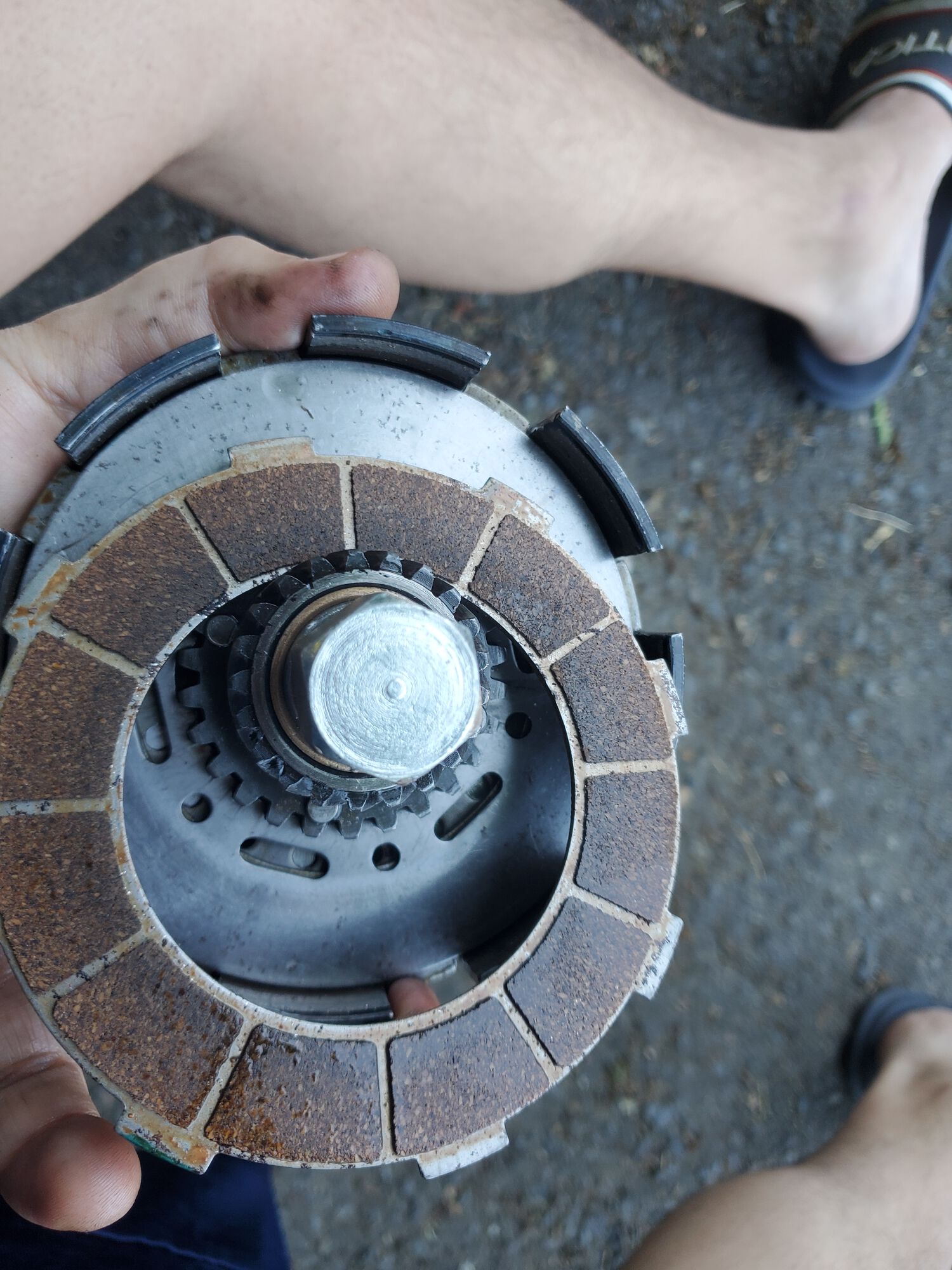

Yea so the clutch is brand new, 50 or so miles on it. It wasnt spinning on the new one nor the old one, which I replaced

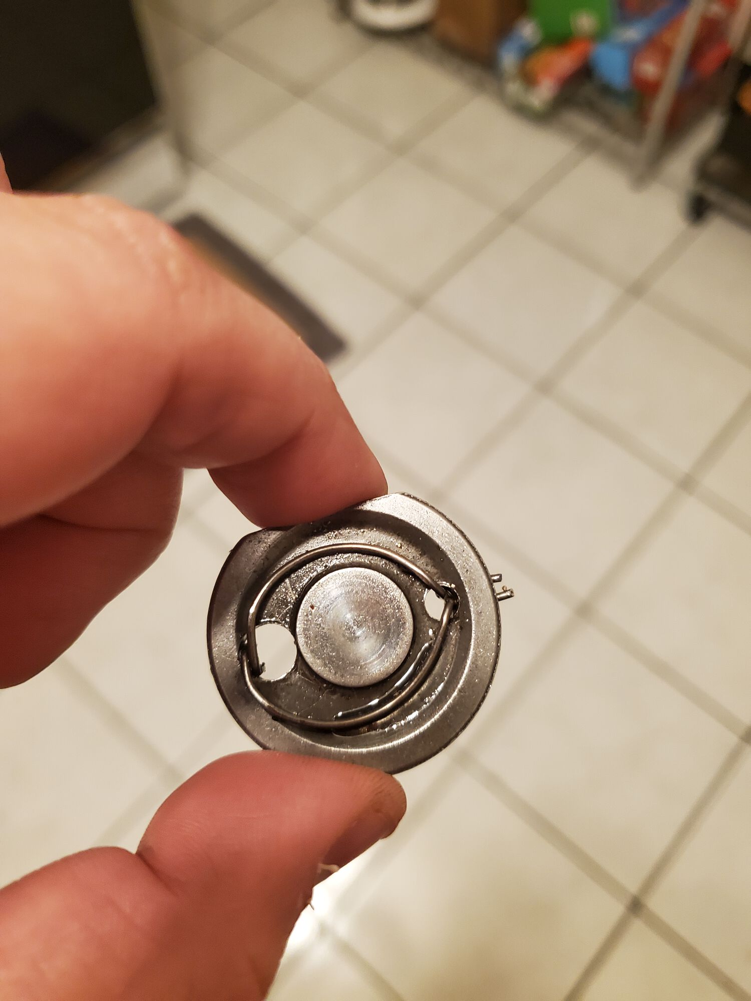

Is that the plate that the brass plunger presses on to compress the clutch? If so then no. If its the "washer" between the clutch and bearing, I dont believe I have one since its autolube, there is a gear there.

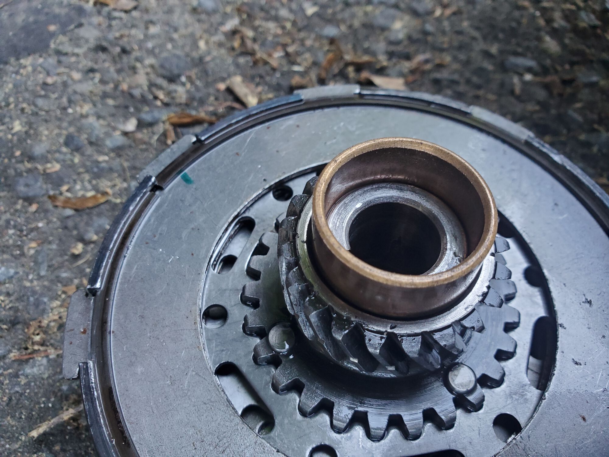

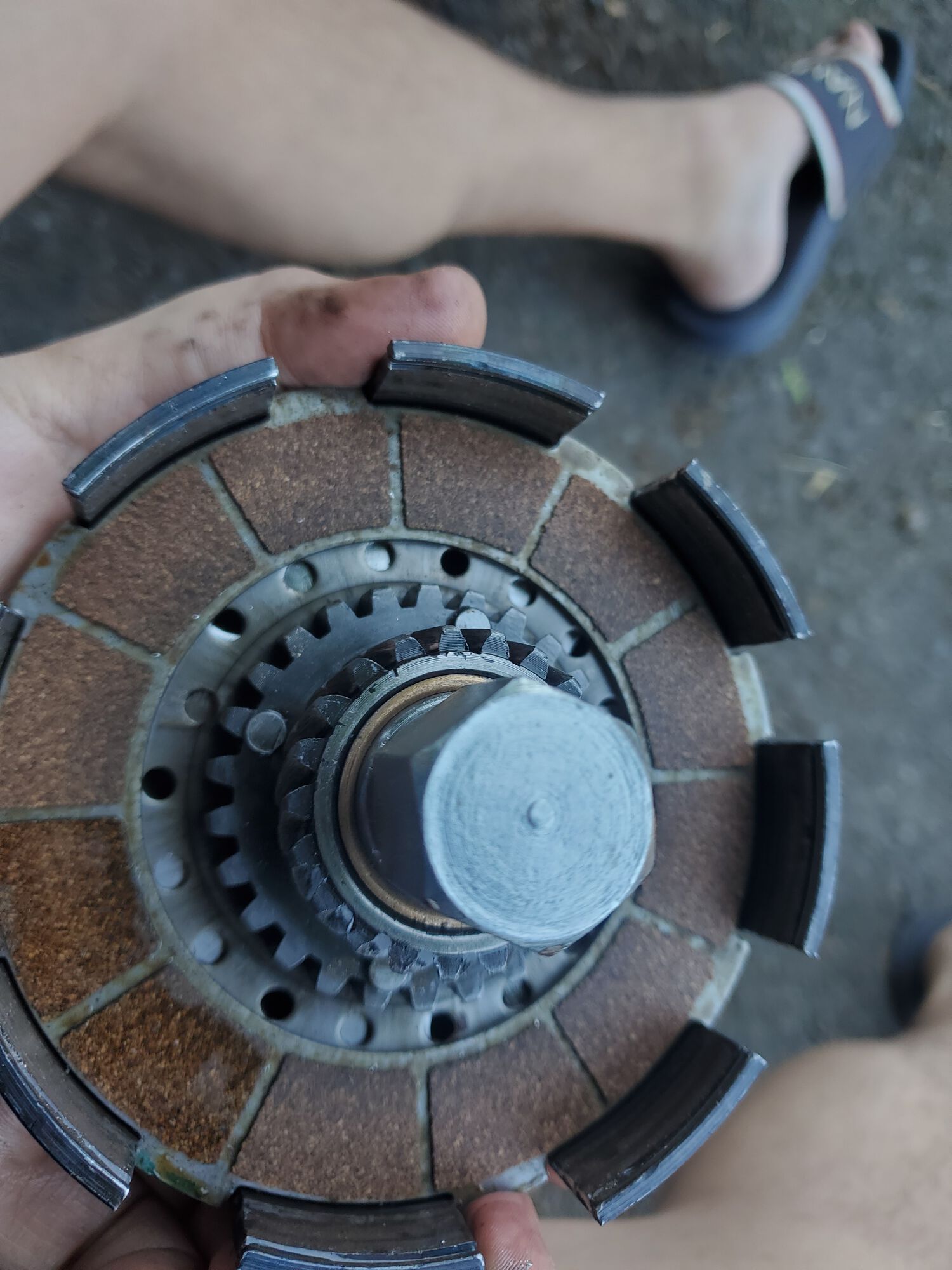

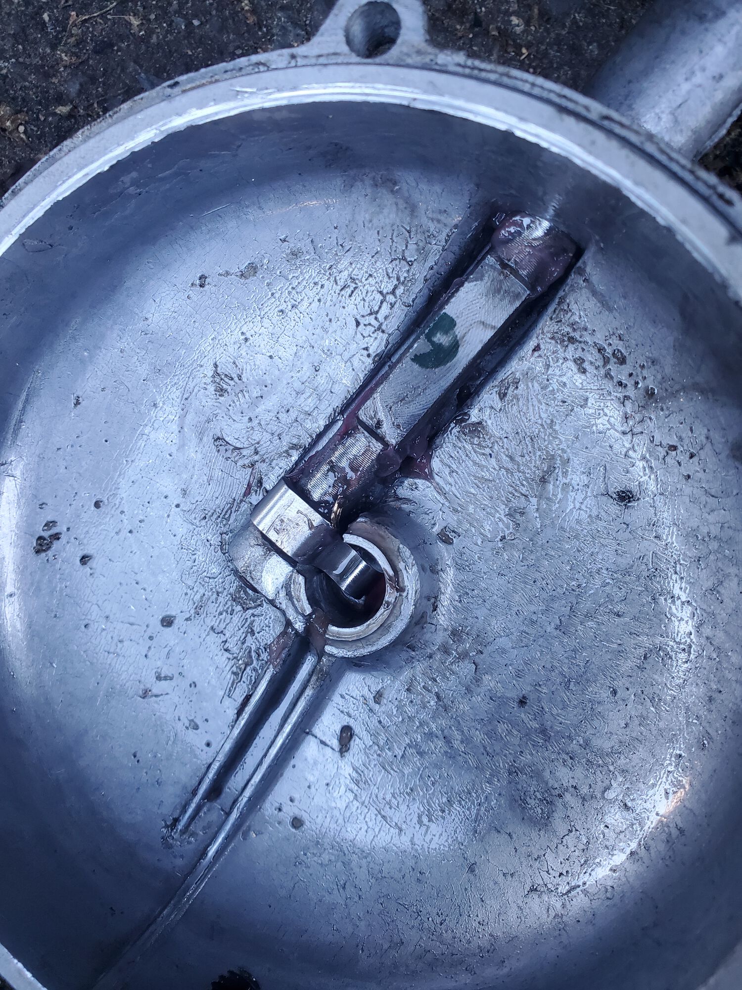

Here is a pic that i took when pulling the old clutch before putting in the brand new one. If I zoom in, I do see some kind of ring on the gear.

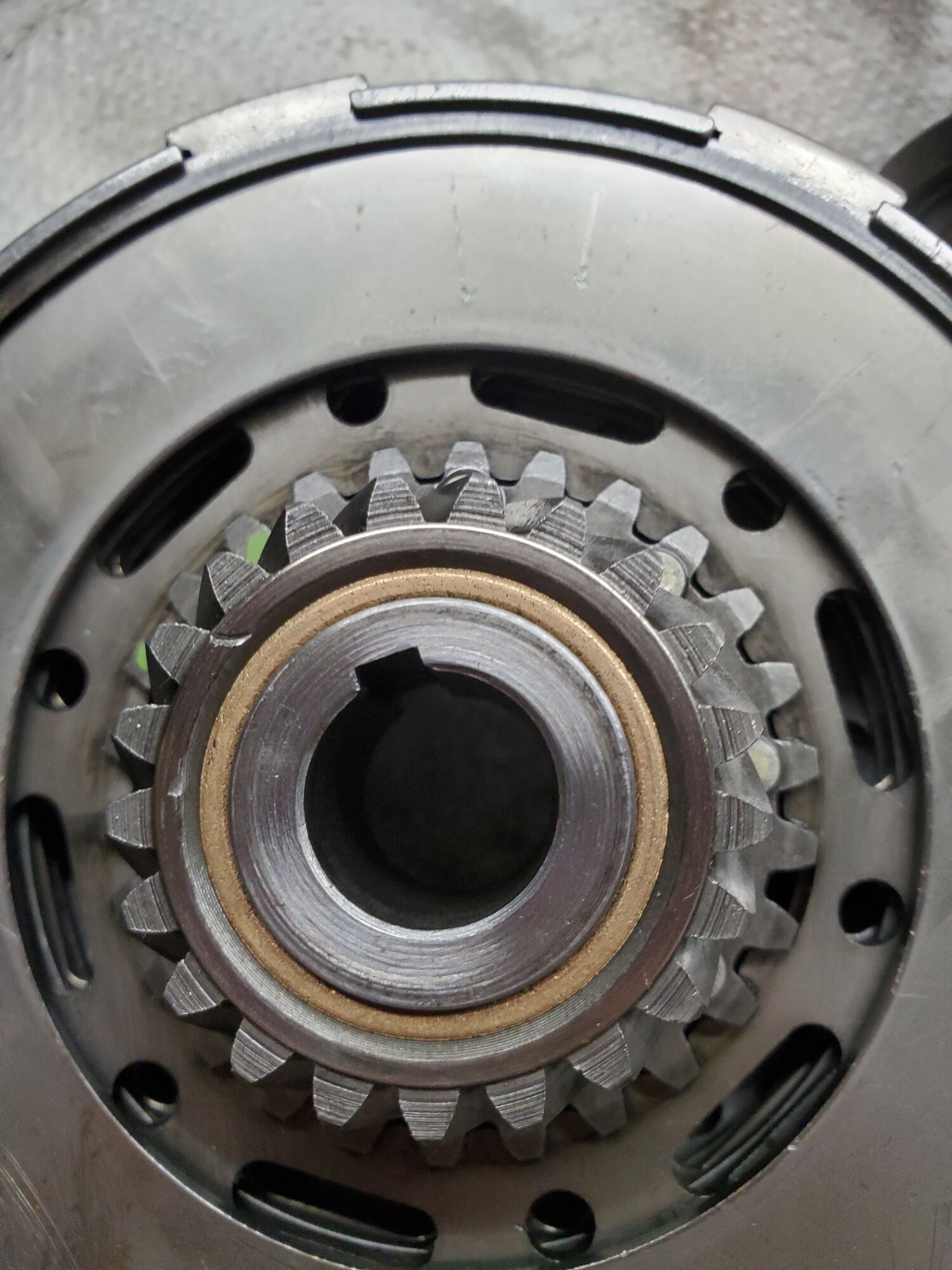

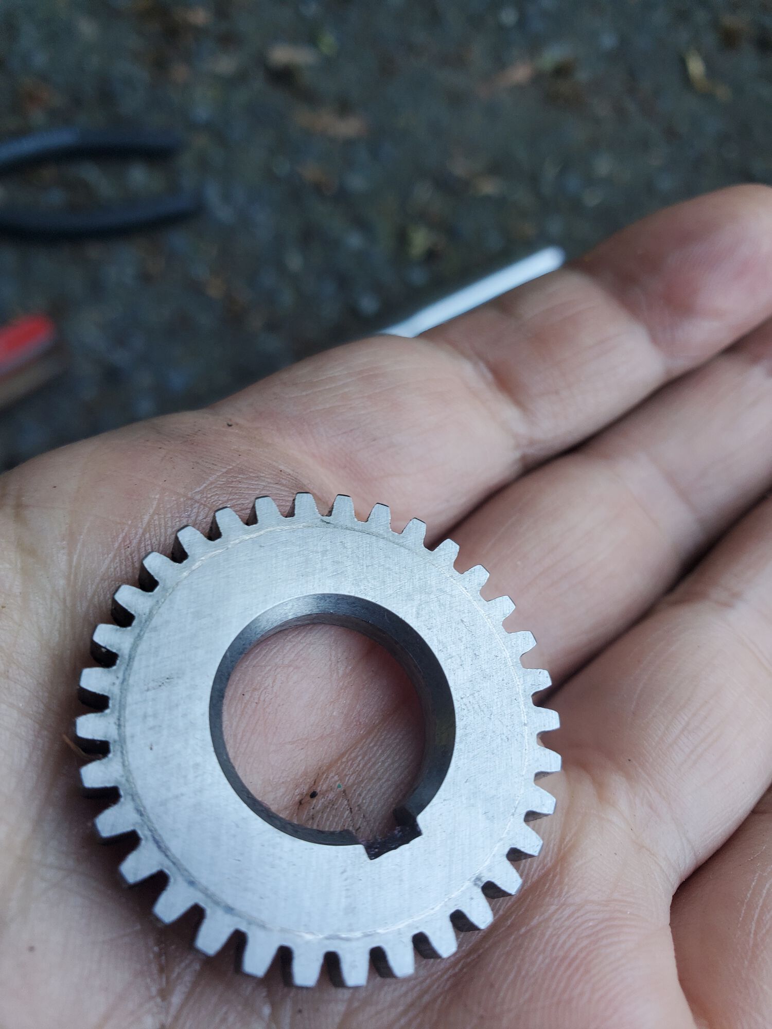

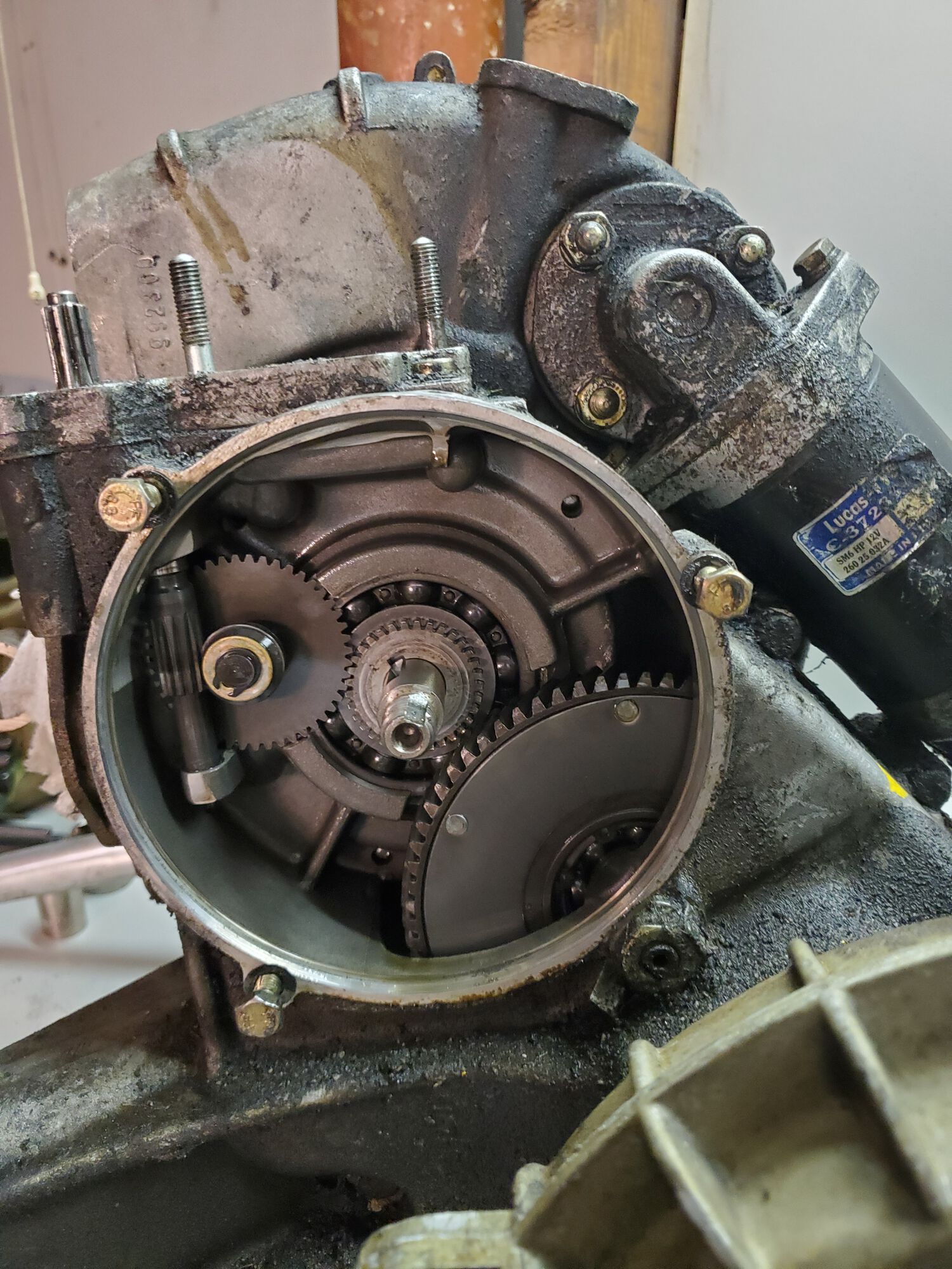

And from the initial disassembly

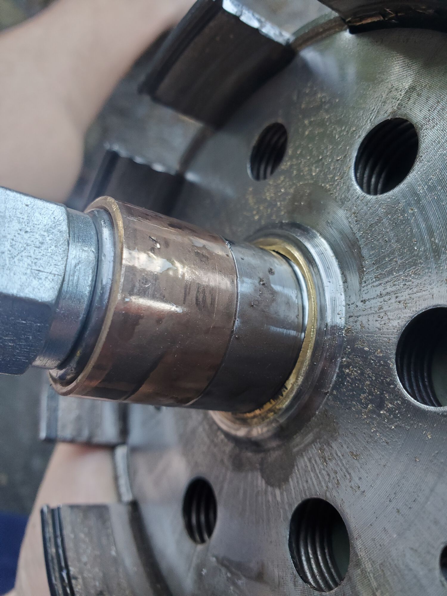

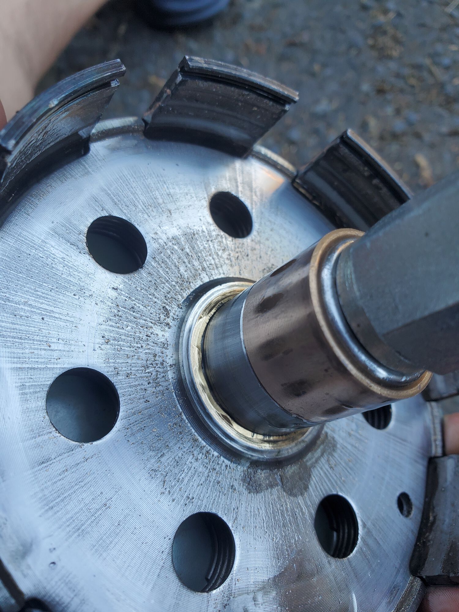

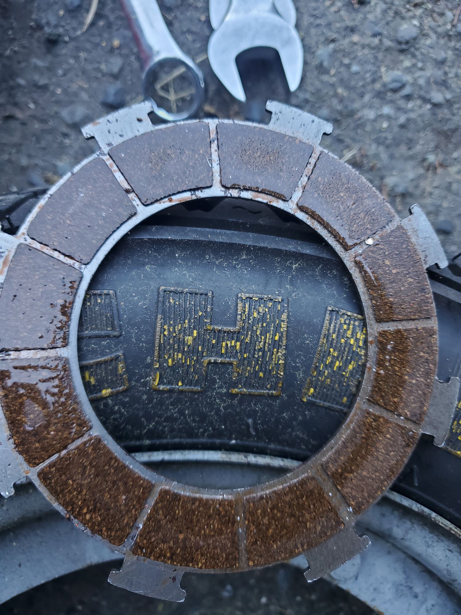

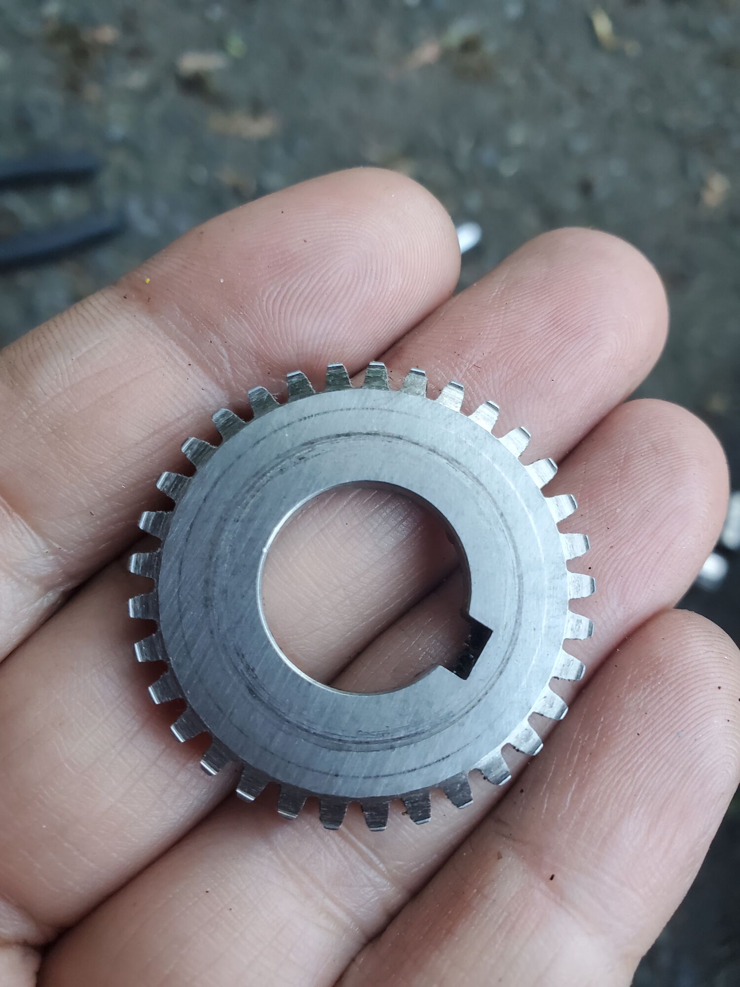

And here is the metal disk, just prior to install of the new clutch, old clutch pictured

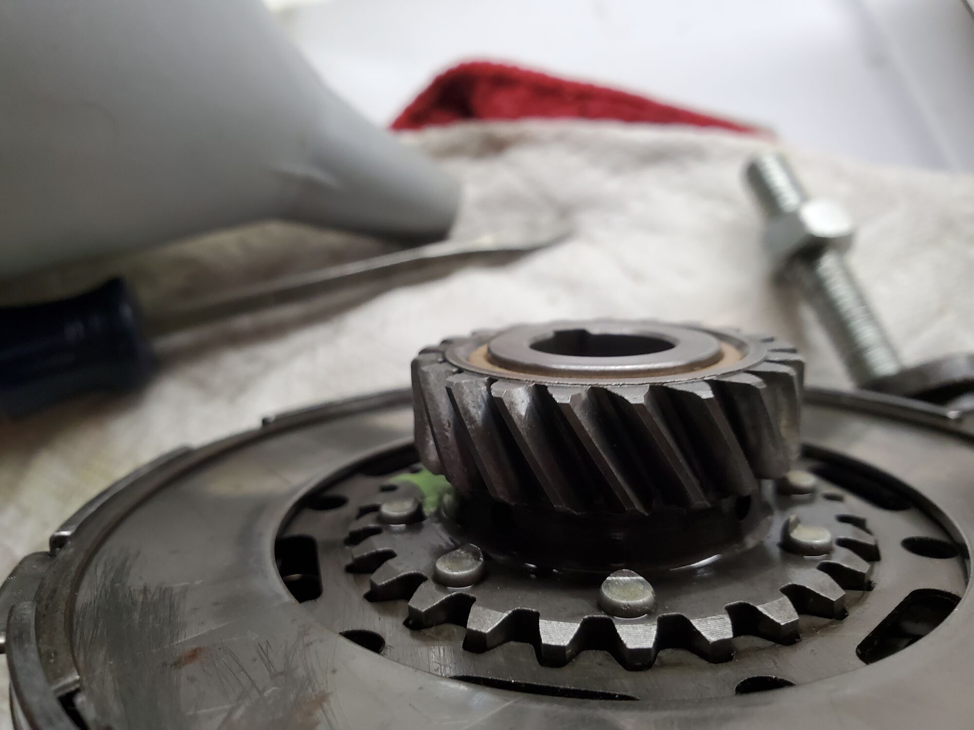

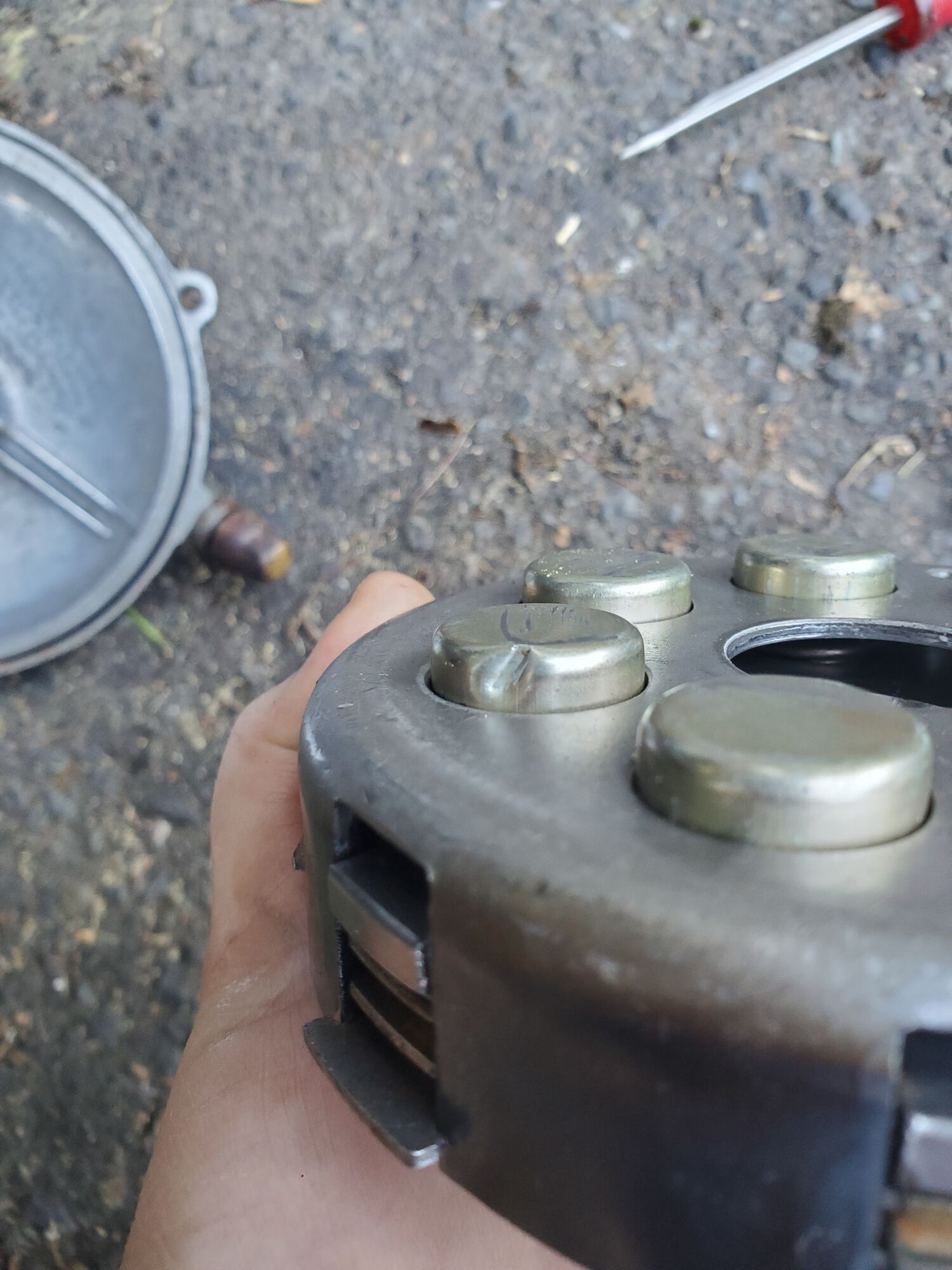

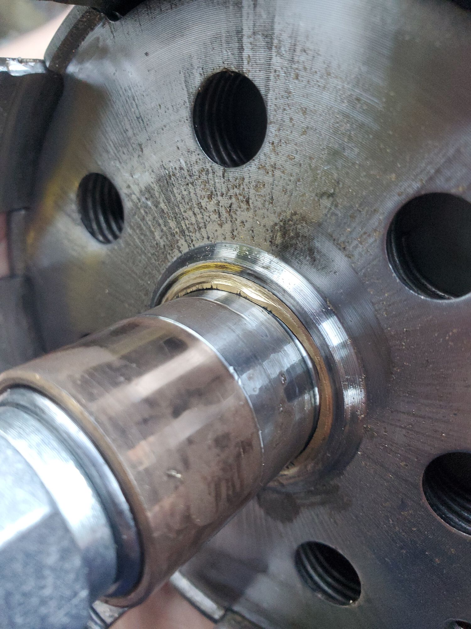

Old clutch gear faces with new bushing

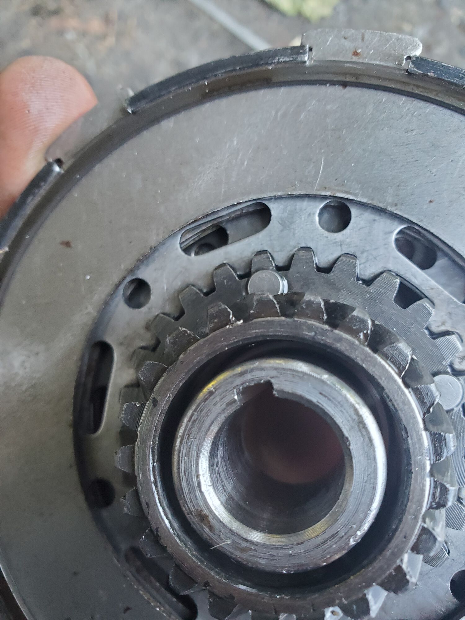

On an autolube, the thrust washer is the cog. Typical on a 2 stroke, one part with at least 2 jobs.
From the picture your one is more than fkd. Worn out a long time ago.

Thank Jack, I'll order one and give it a try!

It's the autolube cog. Yours is very fkd. Any ham bet is just robbery.

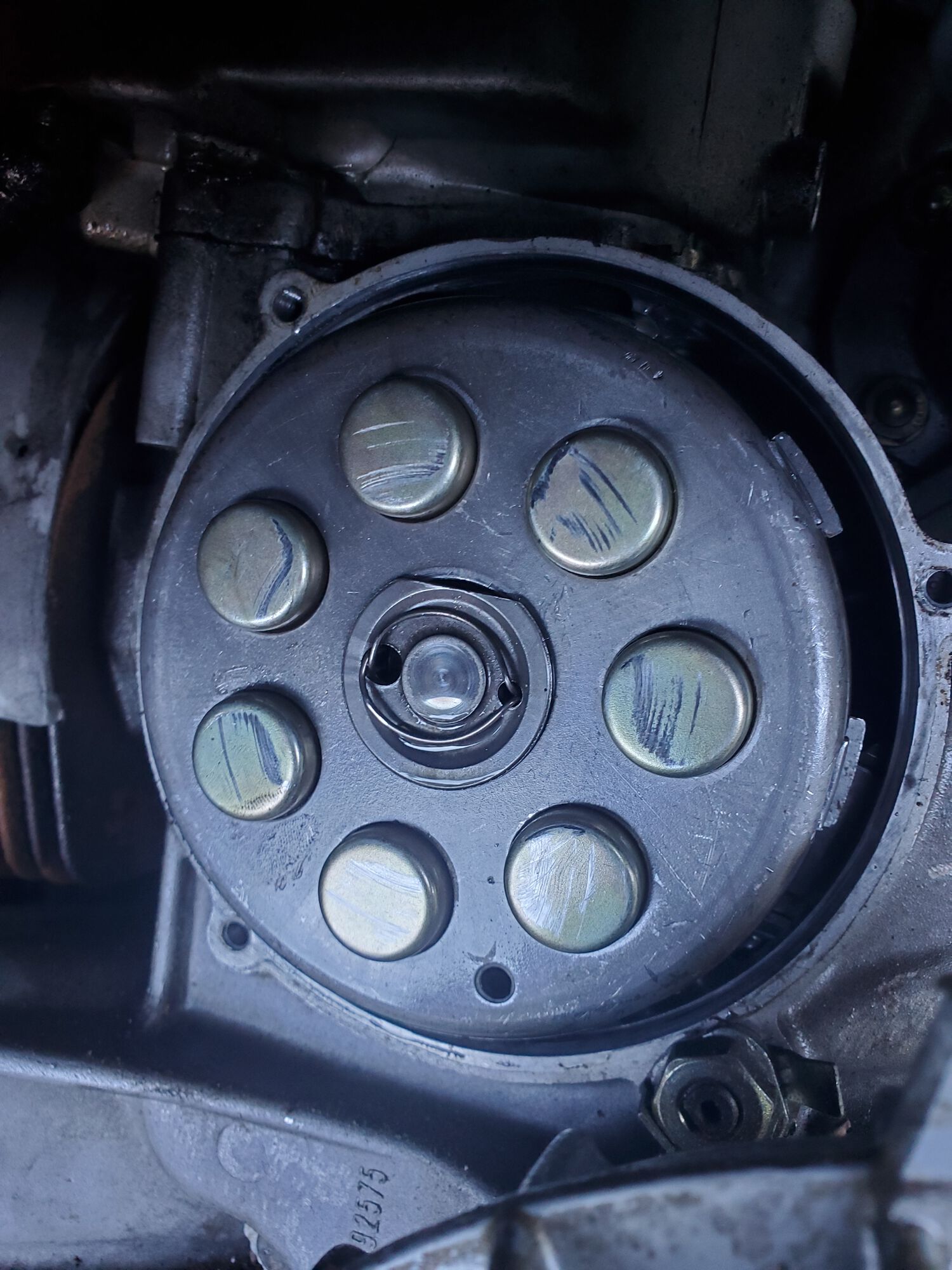

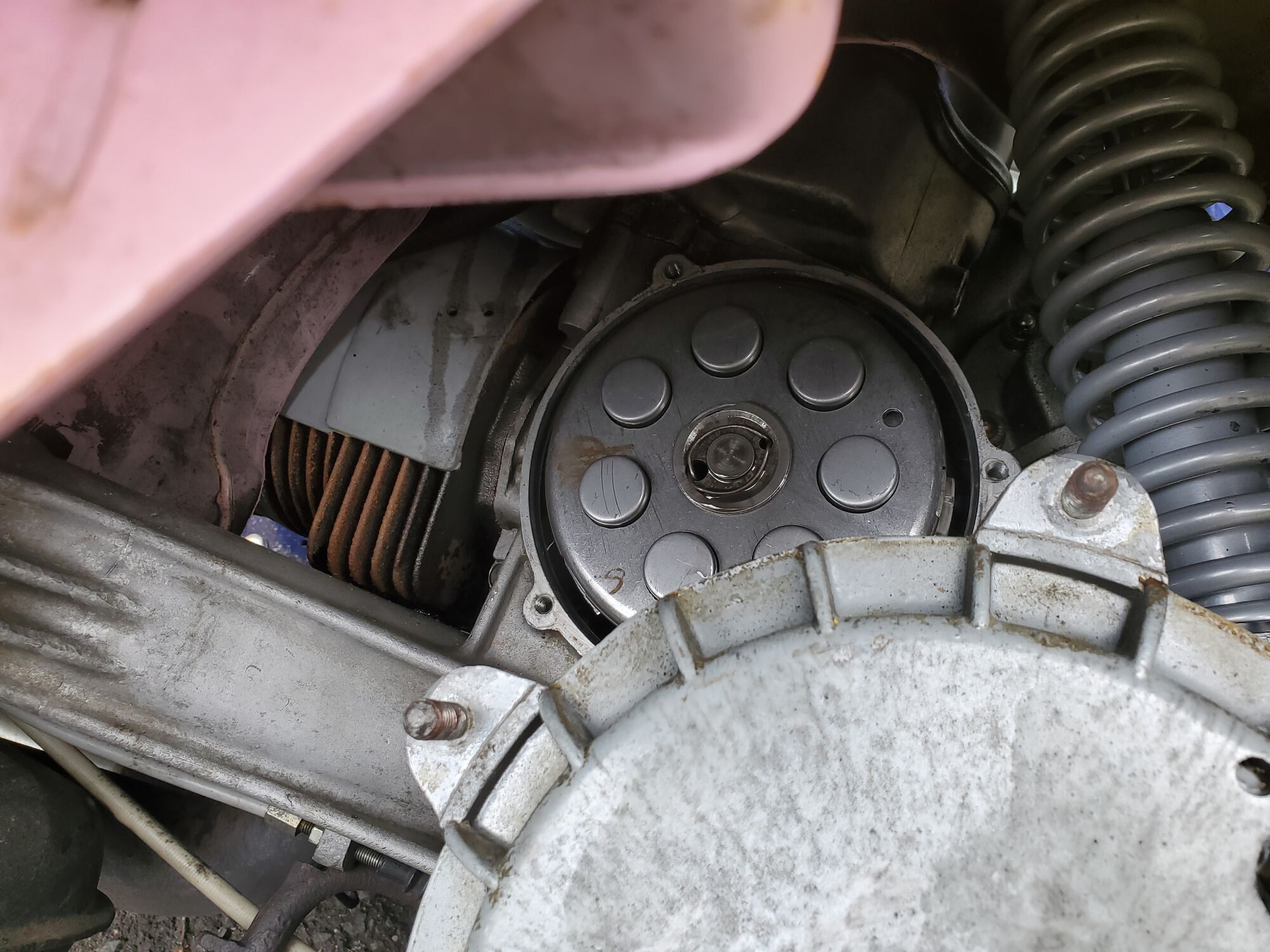

Ok so I finally had time to work on the clutch. There were some surprises. The clutch on the bike was BRAND NEW. Everything came as a package from SM. It has maybe 50 miles on it. It is a stock stella clutch with no modifications. I opened the bike up because the problem persisted and my intention was to replace the thrust washer/autolube gear, brass plunger, and plunger plate. When I removed the clutch, the nut was still torqued down.

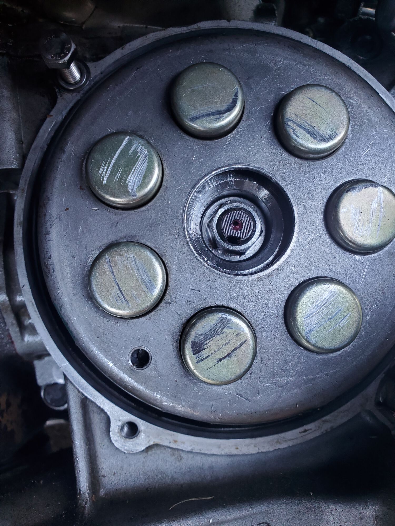

I saw that the spring cups had been fouling on I think guess the clutch cover. The scratches in reality are very light and only some barely catch a fingernail
On close inspection of the cover, I see no where the spring cups have been making contact though. I checked the milled portion of the shaft and no dings. I think the clutch disk tabs may have contacted the outer rim of the cover.
Well, upon pulling the clutch, the brass bush has already separated from the spring plate. Already!?! It was definitely pressed tight before I installed.
Here was the autolube gear. There were marks but nothing that caught a finger nail on either side.
Autolube gear again. I measure this and compared it to the new one. The old one is .07 mm thinner everywhere.
Inspected the clutch. Clearly something hit it. I also found a brass flake sitting on the clutch. No photo. But it didnt come from the plunger or the bush.
Noticed possible damage on the gear teeth
The crank sits slightly recessed in the inner race i.e. the race is proud of the flat portion of the crank. It was .5 mm lower than the race which matches Moped Freaks measurement in one of his videos
I decided to inspect the clutch internals. Those pics follow
Looks like I figured out where the brass sliver came from
How the heck does this even happen so quick.

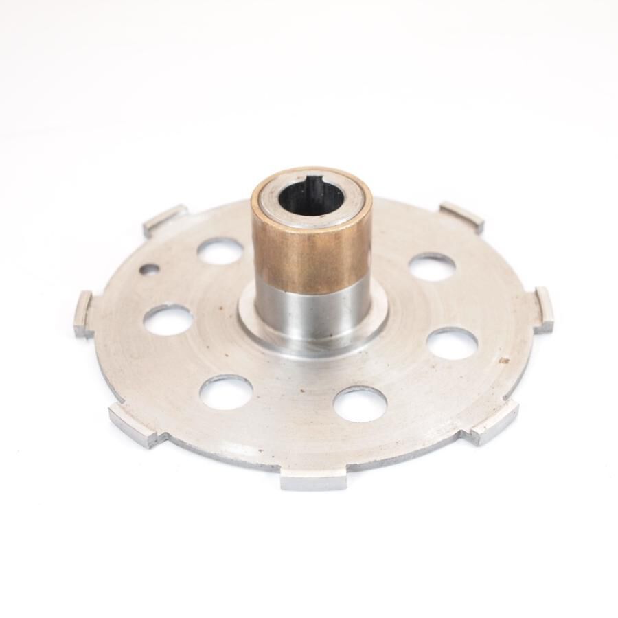

Everything buttoned up. I need to get a new brass washer and brass bushing now.
Old plunger plate
Old plunger plate
Old plunger
Old plunger
⚠️ Last edited by 245luigi on UTC; edited 2 times

So I use the cosa nut and serrated washer to secure the clutch to the crank. I have been torquing it according to the stock castle nut number. Could this nut be causing the problem?
Here is a video of the play on the clutch when on the crank and showing the clutch seats far enough to spin the cush drive. Is it normal?
https://youtube.com/shorts/S_BnnvHtw-M?feature=share
I also noticed the serrated washer notches the clutch body but the underneath of the flange nut was smooth.
All of this damage occurred in 50 some odd miles. I'm not quite sure what my problem could be! My next plan is to get the new brass bits and go back to the castle nut. Any ideas?
