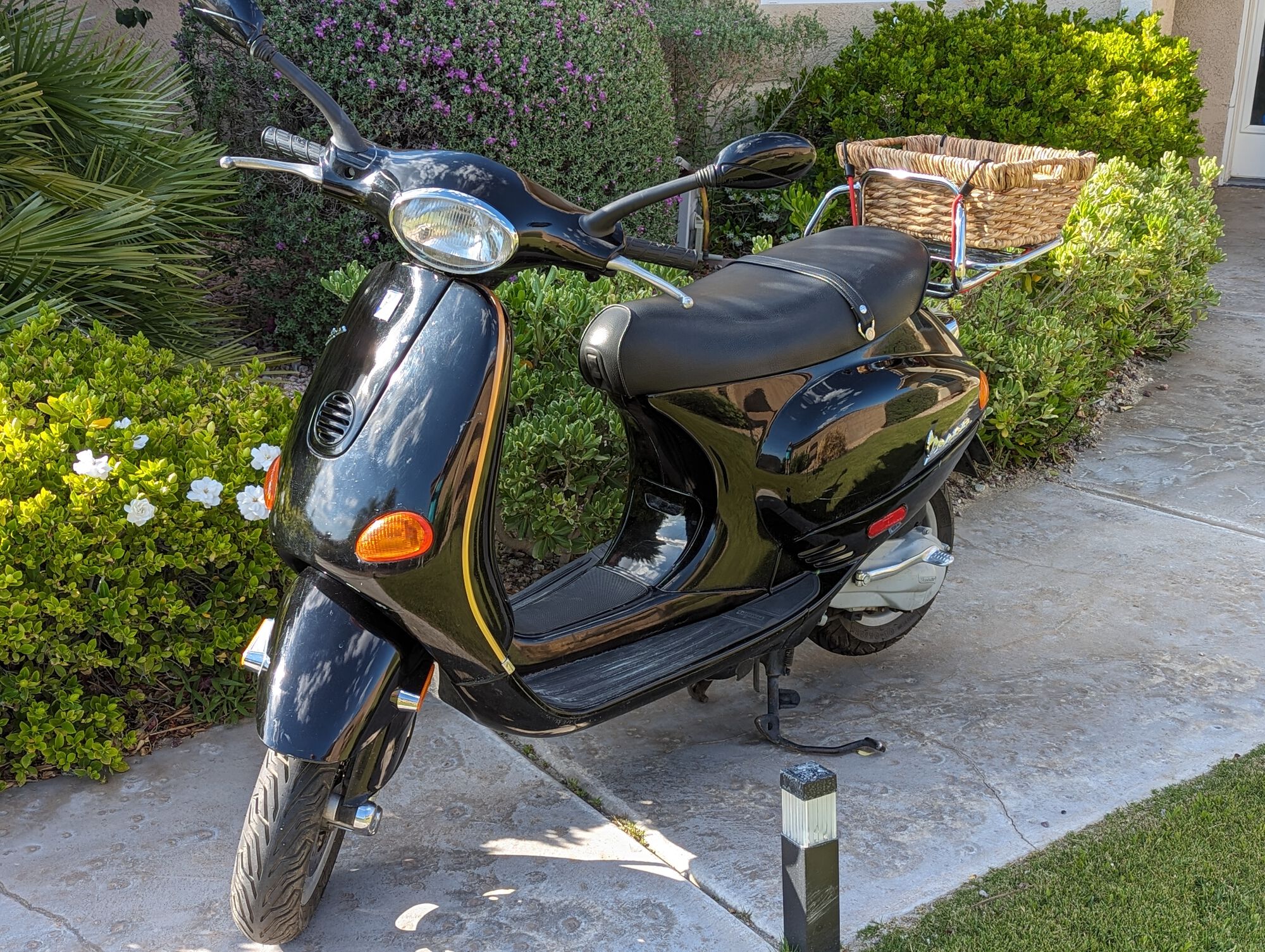

As the proud owner of a newly-running-again '01 ET2, I'll simply say I love mine. She's as much fun to ride as my '24 GTS Classic, maybe more in some ways. With that Malossi 70 kit, yours oughta be a runner. Well, once you get her running again. Perhaps there's a Malossi 70 kit in my future, too.
The advice that's been passed along to you sounds right in line with what my mechanic did for mine to get her on the road again. (I can turn the key, pull in the brake handle, and push the starter button -- that's the extent of my mechanical abilities. I'm also pretty well-versed in handing a credit card to my mechanic!)
I look forward to following your progress. And, of course, we ALL look forward to your pictures!
