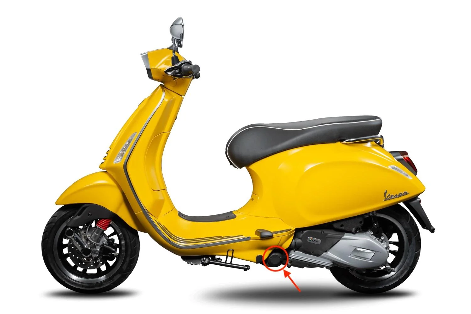

Greetings, everybody. I tried to find the answer to this question but didn't have any luck. What is the plug on the left side of the transmission box called, and what is it hiding?
Mine is missing, and I am having trouble finding a replacement.

the swingarm bushing is behind this

Thank you for the reply. Any idea where I can get the plug to cover it, or what it's called?

SKU is 1C000421, please check local availability

Wow, thank you so much. I week of search is over 🤣
