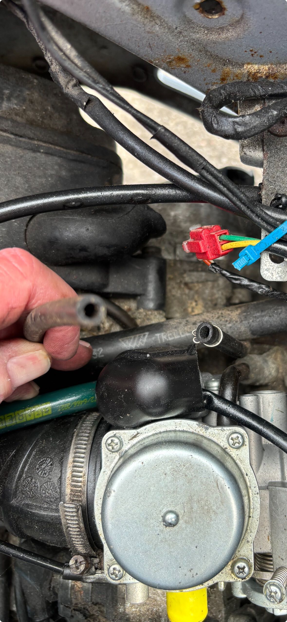

Just bought a low miles GTS 125, its currently a non runner.
Can anyone tell me where these two pipes go. Also the throttle is really stiff ?
Thanks Kev[/img]

Looks like someone disconnected the evap system from the carb.
That's my WAG anyway.

I doubt there ever was Evap Crap in there - they weren't standard in the EU/UK until quite recently.
But it'd help if we were told where the other end of those hoses were located.

Guessing the one with the clip is from the carb bowl drain. The other, I haven't a clue as I don't know where the other end is tied to.

Not sure if the GTS would be fuel injected? What year is it?

A carb is shown in the first post.
