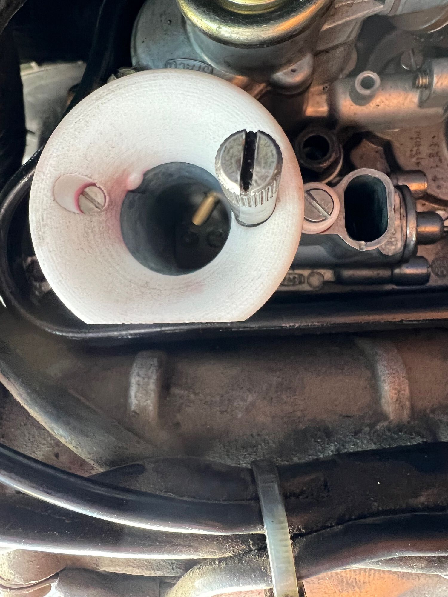

Apologies if this has been covered before. Need fasteners for an oopsclunkthud bellmouth. Threads in carb are M5. All the locally available M5 fasteners have heads that are too large to fit in the space available. O.E. front screw is a cheesehead with a 7mm diameter head. That head will fit in the front but not in the rear. McMaster Carr has these with 6.5mm diameter heads. Anyone try them? Not seeing anything smaller.

Anyway, I went ahead and ordered the McMaster Carr cheesehead screws with the 6.5mm heads. Delivery was promised for Tuesday, but they actually showed up today. The fit is spot on.
Can't tell how much is the bellmouth and how much is just the airfilter delete, but the change in jetting is pretty dramatic: from AC160/MJ115 to AC160/MJ128. Doesn't seem to have done much for max horsepower, though. Top speed in 4th gear is pretty much the same.
I will say this bellows-to-frame stuff is like crack cocaine. It's pretty amazing that after all these years no one has come up with a decent airfilter for these scoots. I live a mile from the beach, so something has to be done. I know it means I will be sucking hot air, but those Uni Pod things are cheap, so might give one a try.

Are you using the Stella airbox lid with the bellows? I've always gone with the Uni/ Marchald/Polini filters with bellmouths and the PX Stella airbox lids. I'm interested to see if there's any difference?

Yes, Stella/LML airbox lid and bellows to frame. Feels so good, but I know it can't continue. Local conditions demand some kind of air filtration.

Right on! Did you up the idle jet at all? Or just do it with the mixture screw?

None of the above. Idle jet remains the Malossi supplied 52/140. Haven't touched the mixture screw. Seems fine. Jetting will change when I slap on an air filter anyway. Will wait until then to do the really fine tuning.

The 20mm bell was designed to use the stock air filter screw with 7.0mm head diameter on the rear. the one you found is likely even better.
I've been running this filter on my Rally for many years now.

In my case, the 7mm was too thick. Would have required some modification. The 6.5mm fit like a glove.
Uni Pod filter supposed to arrive tomorrow morning. Will be interesting to see how that impacts jetting.

Uni Pod filter is oiled and installed. It must breathe pretty well because there was no impact on the main jet compared to bellows-to-frame.
Closing this chapter without having seen much of anything in the way of increased performance. Engine does sound and feel better though.
