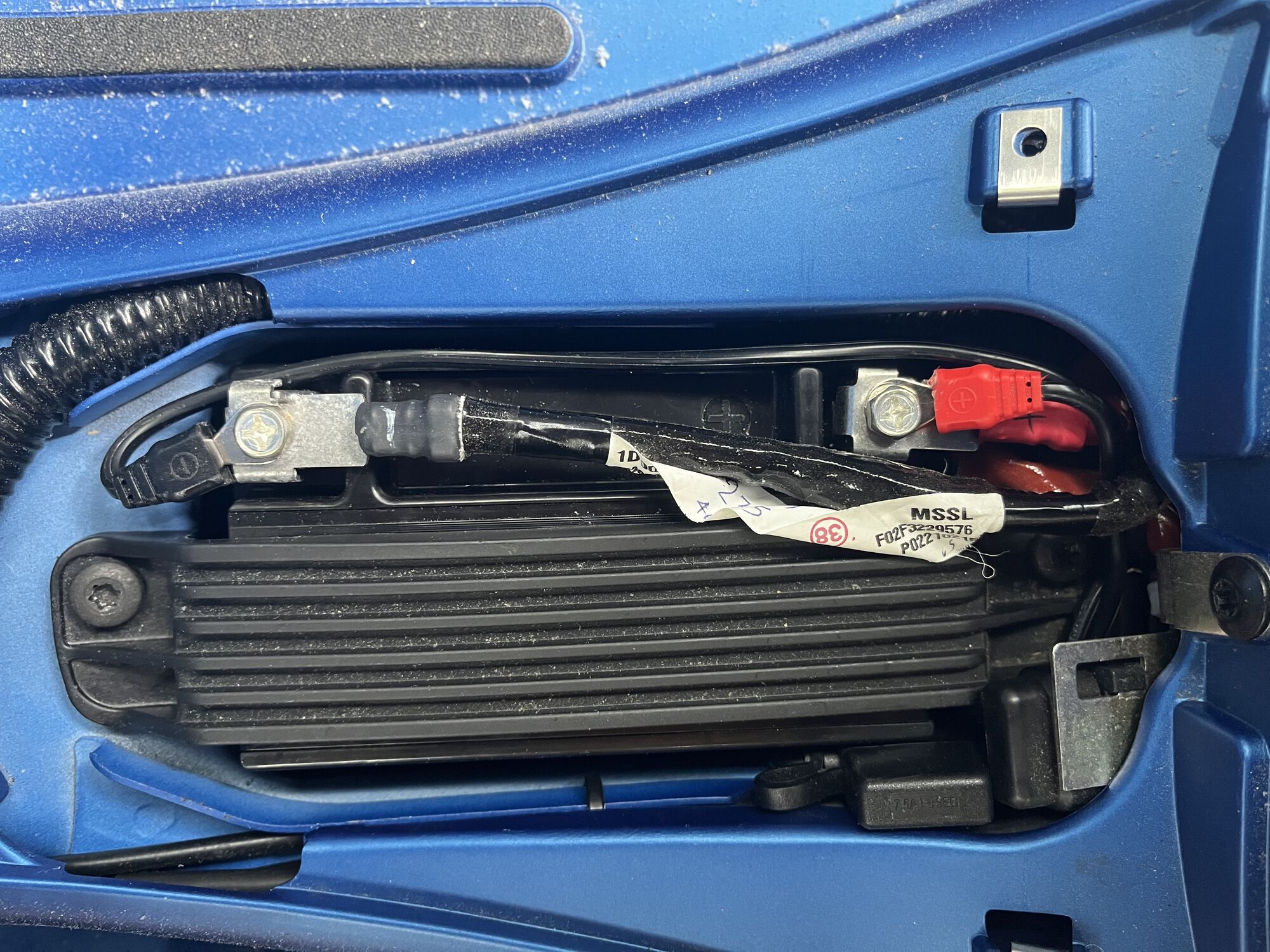

When you installed the pigtail lead for the tender, did you get the polarity right?
2022 Vespa GTS300 Super
Posts: 8
Location: NJ
Posts: 8
Location: NJ
Looks pretty good to me.
@jkj-fz6 avatar
Posts: 4577
@jkj-fz6 avatar
Posts: 4577
Yup, that looks correct.

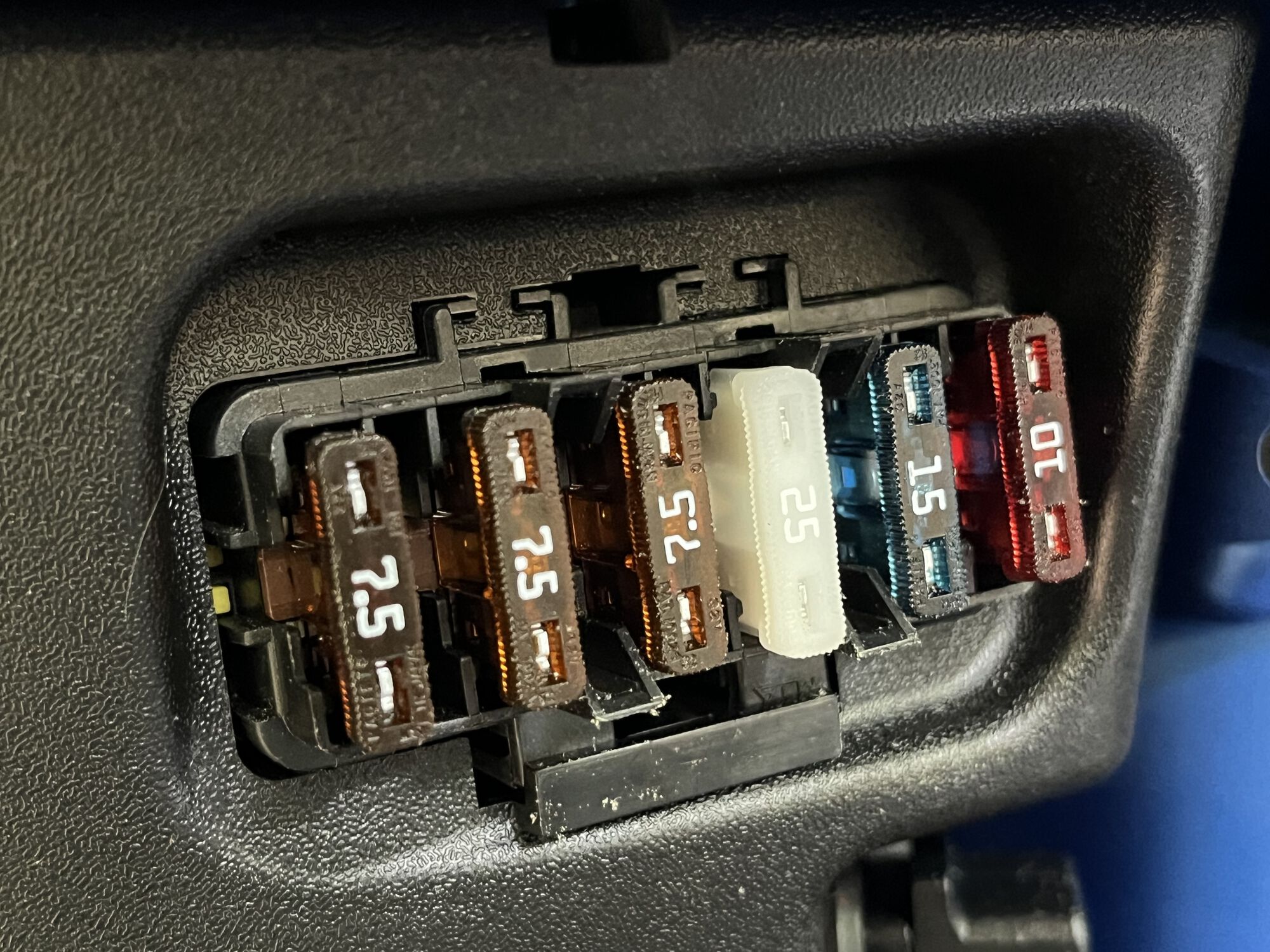

JKJ-FZ6 wrote:
Is there a fuse in the pigtail lead? Maybe that's blown.
Just checked the fuse in the lead, and all of the fuses in the glove box. They all look good.

jimc wrote:
The 'old' dead battery was the first clue... as is, why was it dead as it wasn't exactly 'old'! I suspect a duff regulator.
There should be a main 30A fuse. Remove this and see if it charges now.
Quick update. Did a test. Left the scooter unplugged for around 48 hours. And it still started right up. No hesitation.
Happy to test the regulator, but I don't have a 30 fuse. Is the 25 the one I should pull???
Test by noting battery voltage with out scooter running, should around 12.6V, start scooter battery voltage should go up above 13v, rev to 3k rpm battery voltage should not go above 15. Report what you find
@petercc avatar
Piaggio Beverly 300 ie - 2012
Posts: 1437
@petercc avatar
Posts: 1437
clucania wrote:
Hmmm. I don't seem to have a light under my seat. Am I missing something?
If you do not have a light under the seat, then that cannot be the cause for battery charge consumption.
It is a 2022 GTS 300. That means that "old" battery you replaced was only like 2 years old. That is not old. Probably it did get discharged but was still OK.
What I would do:
Disconnect the battery and measure the resistance between the plus and the minus of the connecting cables (you need a multimeter for that exercice. Or you have one, and if not buy one, it is a very useful tool that you can use for many other testing in vehicles and in your house).
With the contact off you should measure an open circuit, so infinite resistance.
If not then you have a leak somewhere.
The 25A fuse could be your main fuse with the smaller fuses as slaves behind.
(In my BV it is a 30A main fuse)
So test the 25A first. If it is the main fuse the reading should be infinite.
If so, then but it back in and redo the measurement removing the smaller fuses 1 by 1 until you have the infinite reading. The last fuse you did remove is the circuit where the leak is in.

The main fuse (30A) at a GTS 300 HPE (pre-Facelift MY23) can be found in the battery compartment.
The fuses in the glovebox are (left to right):
7.5A = Power supply via ignition lock: front indicators, "Vespa MIA" device, diagnostic plug, rear parking light.
7.5A = Power supply via ignition lock: horn, tail light, USB socket, remote light relay, flasher unit, pre-installation for accessories, Bike finder
7.5A = Power supply via ignition lock: ABS control unit, immobilizer antenna, engine control unit, injection charge relay (coil)
25A = Power supply from battery to ABS control unit
15A = Power supply via battery: cooling fan relay (contacts), 5A fuse (see below), instrument unit, remote light relay, pre-installation for accessories, bike finder.
Via ignition key: seat bench opening adjustment device.
10A = Supply via battery:
engine control unit, remote relay for injection charging, heater
And there is another 5A fuse below the pet carrier (slave behind the 15A fuse) for the diagnostic connector.
