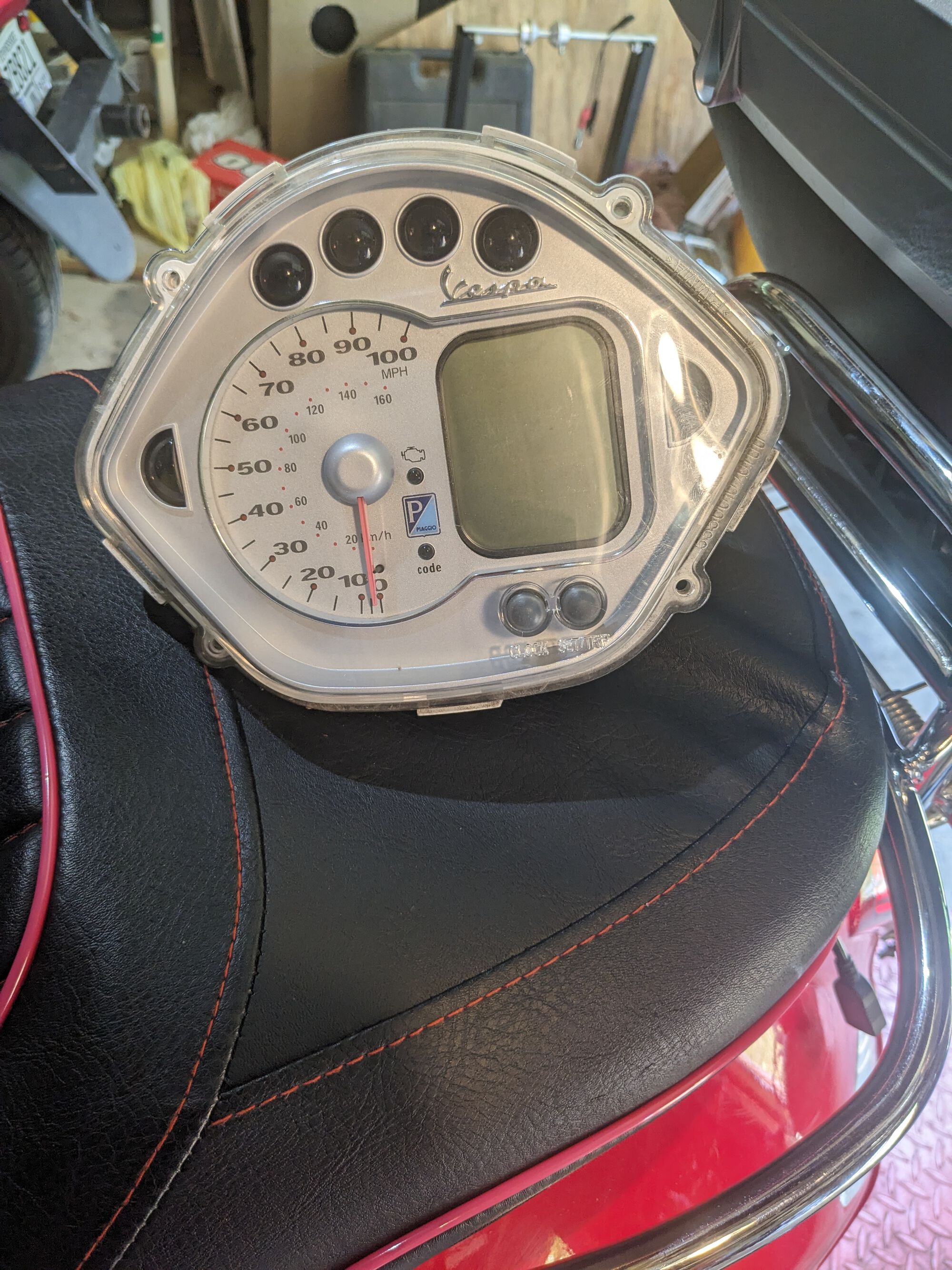

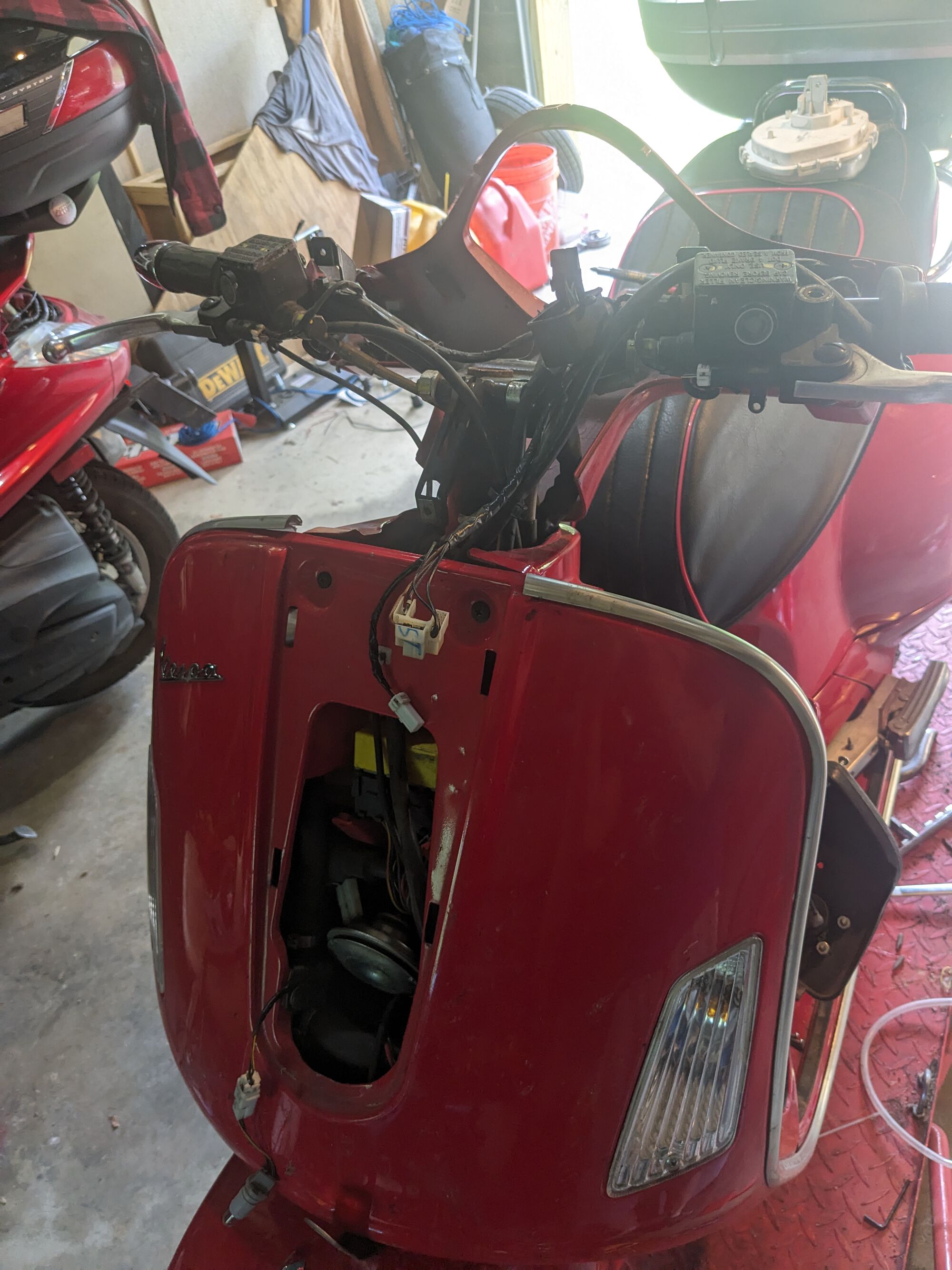

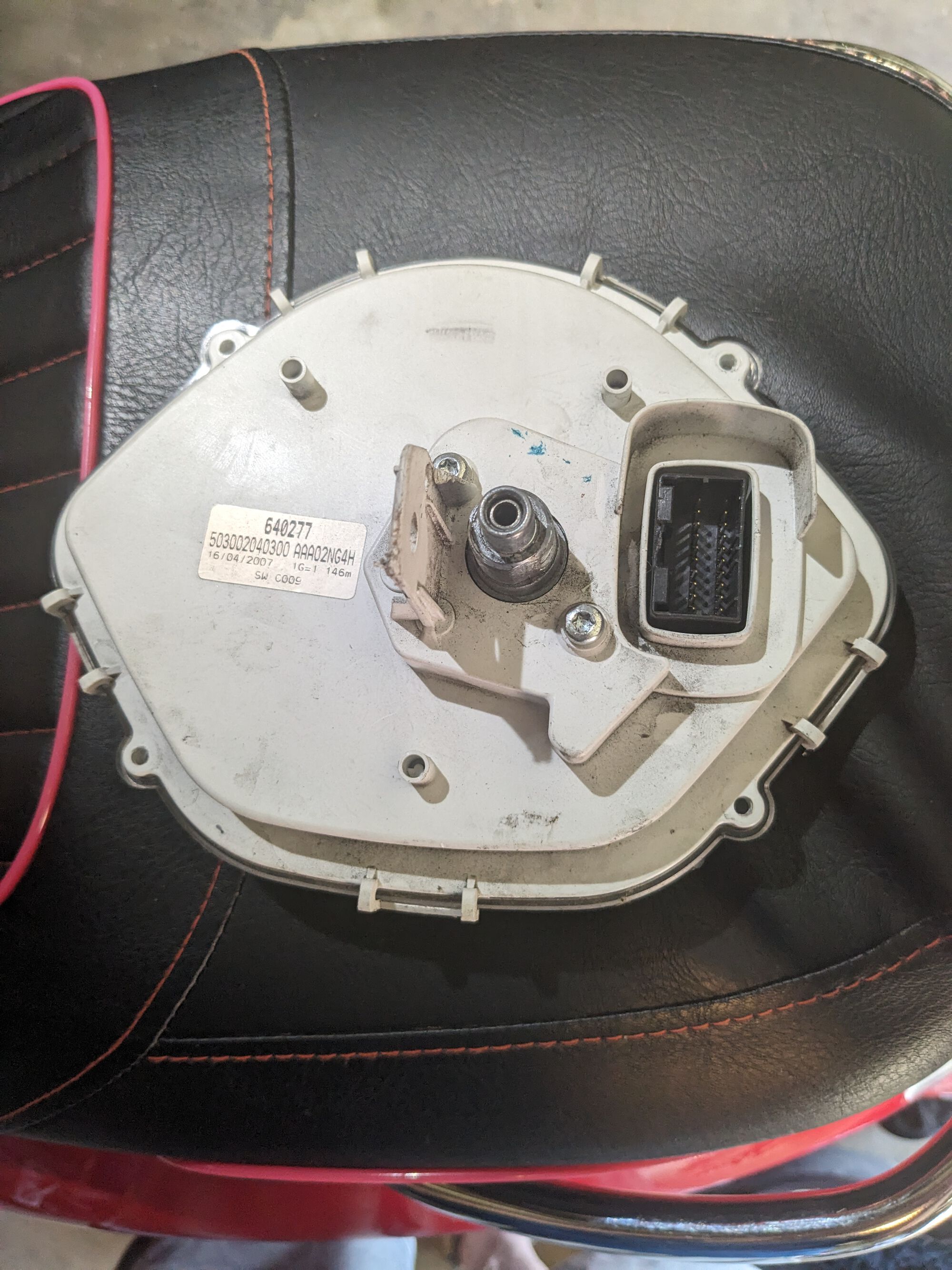

This happened yesterday as I was on a very bumpy dirt road. The display went dark but the motor was still running, headlight was on, but no turn signals or anything from the display. All fuses in the glove box checked good, I removed the handlebar cover and the plug into the display was intact, I remove the 2 fuses under the seat and they checked good also, where do I look next?

It was a bad wire behind the fuse block. All better now
