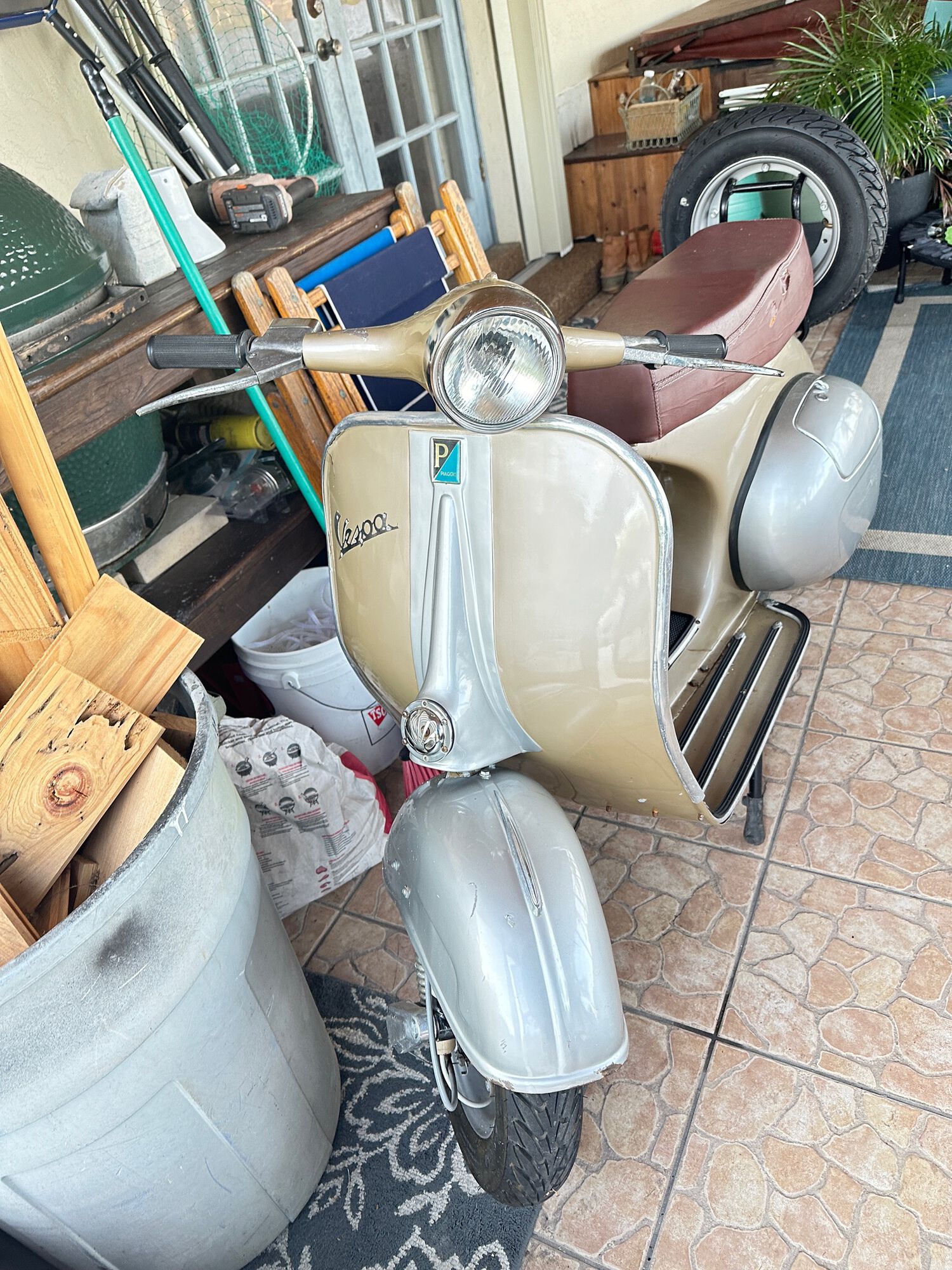

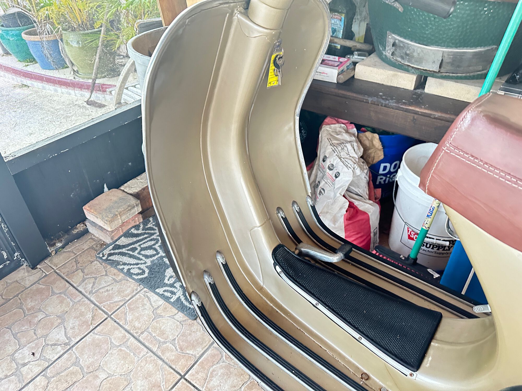

SubEtherBASS wrote:

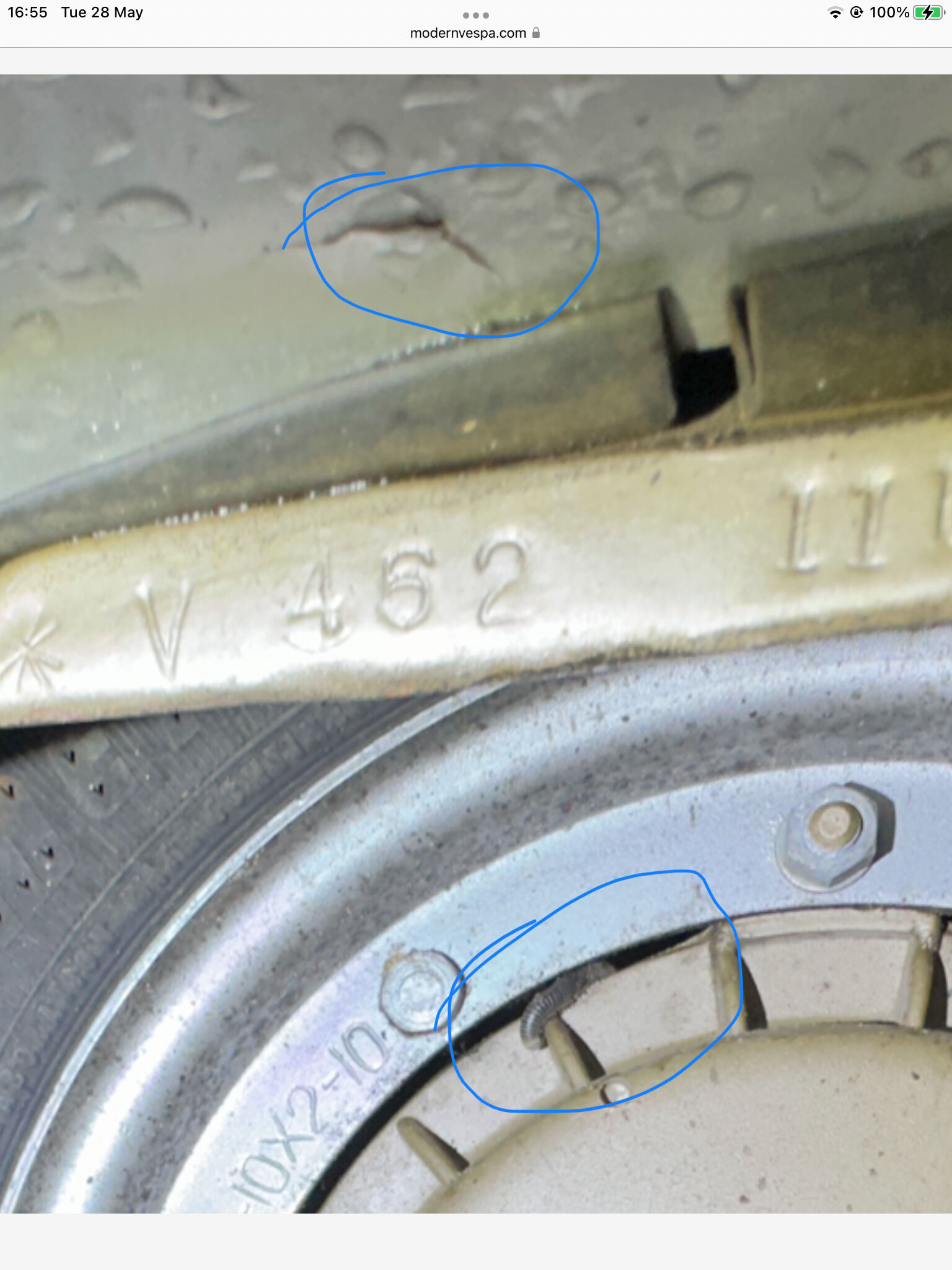

I can see what appears to be a rust hole i the side panel, but what is that poking through between the hub & rim?
Here is a better picture, I hope. That was a piece of an insect on the rim, a pill bug or roly poly.

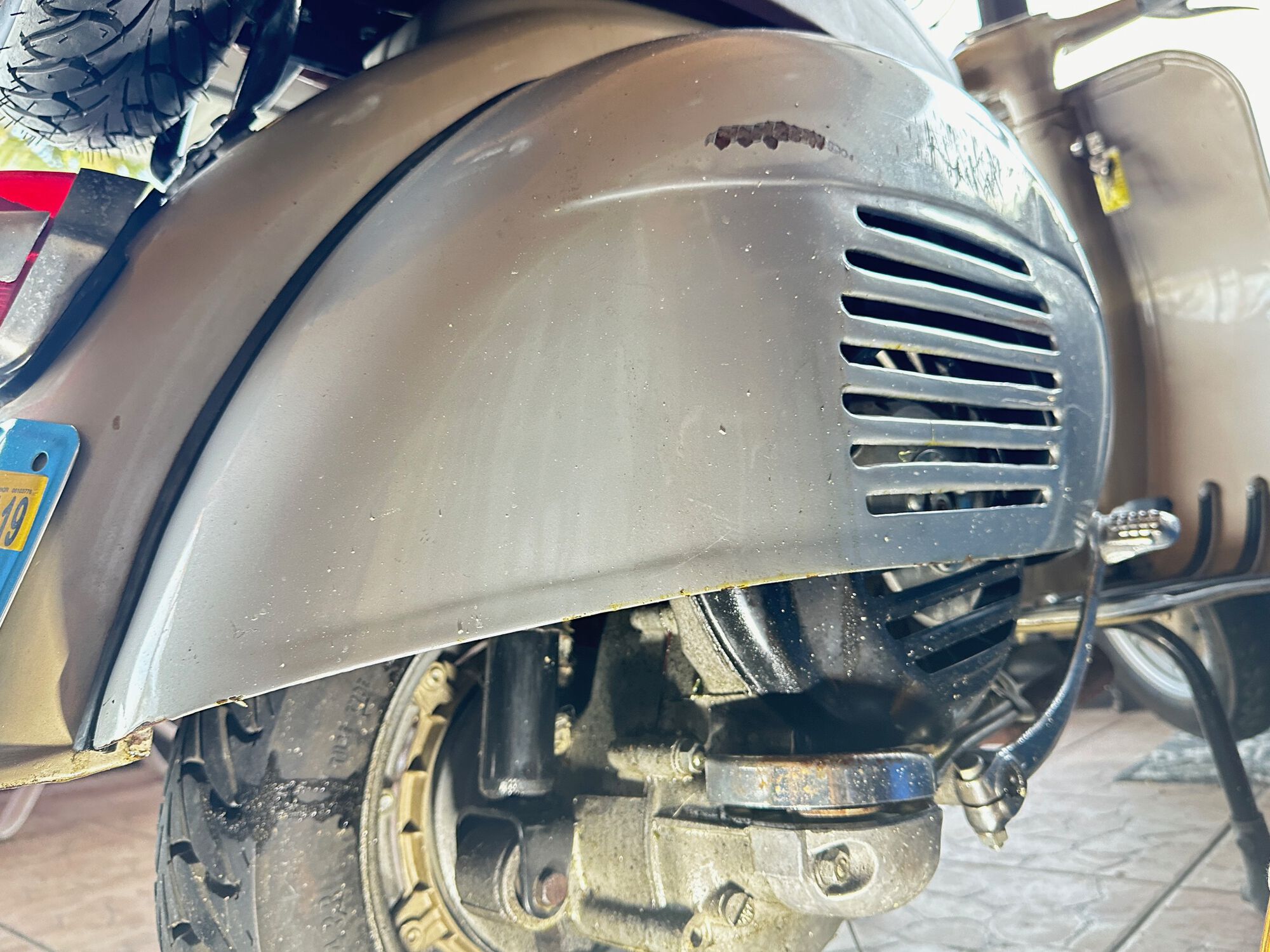

I rinsed the scoot and did not dry before the 1st pics. In person that spot looks like a repair flaw, maybe bad Bondo.
It doesn't look like rust close up, just a piece of 50-65 year old metal fender.
I don't think it is contributing to the steering wobble.

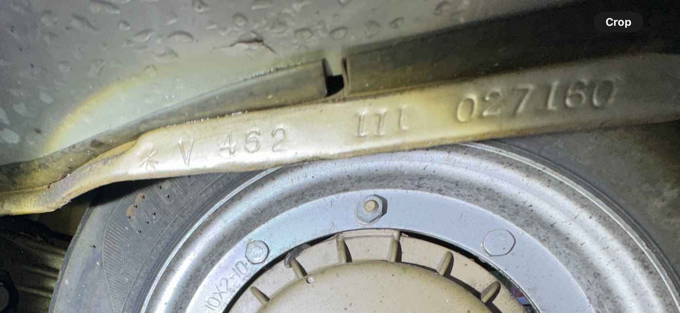

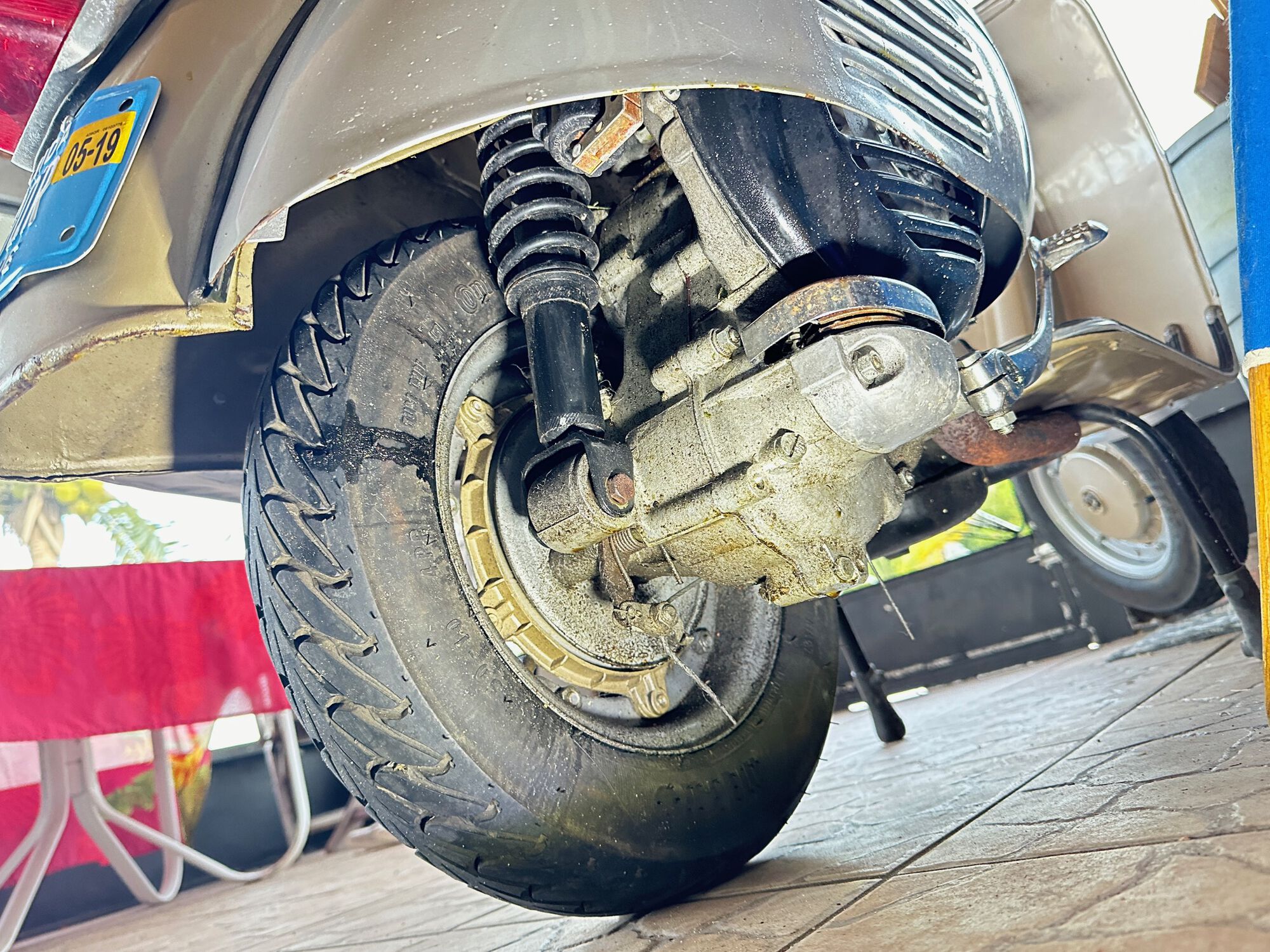

What is the provenance of the scooter, where did you get it and what did the seller tell you about it? I don't know much about what Bajaj produced and even less about what they exported to countries beyond what was officially exported to the USA which is limited to one model and for like one year around 1980 and that's it. That being said I'm inclined to agree with some of the folks that raised suspicions this machine is likely a Bajaj frame and from Asia. Post a photo of the engine VIN it's on the swingarm that may shed some light on what engine is attached. A photo of the engine cowl lever would be good something looks odd. My guess is this bike was prettied up for an unsuspecting buyer the rust under the scraped engine cowl is a good indicator. The gear selector cover poor fitting missing engine bolt funky seat etc. not that those things can't be fixed but need to know what you're dealing with and how to approach it to make it worthy. Loose steering is not good additional photos of the front suspension would also help analyze it.

SaFiS wrote:
Looks like a worm…
I did wonder that... a far better thing than a piece of wire.
Sadly the better picture of the underside of panel makes it look worse... they look like angle grinder marks in bog or covered up welding
So, can anyone suggest the best vendor that will sell me several bearing sets to address my single concern, steering wobble?
Cheers for pic, glad it was only a bug.
Have you checked that the wheel/rim is spinning straight & not bent?
Also, spin wheel & lightly put brake on just to check brake isn't grabbing.

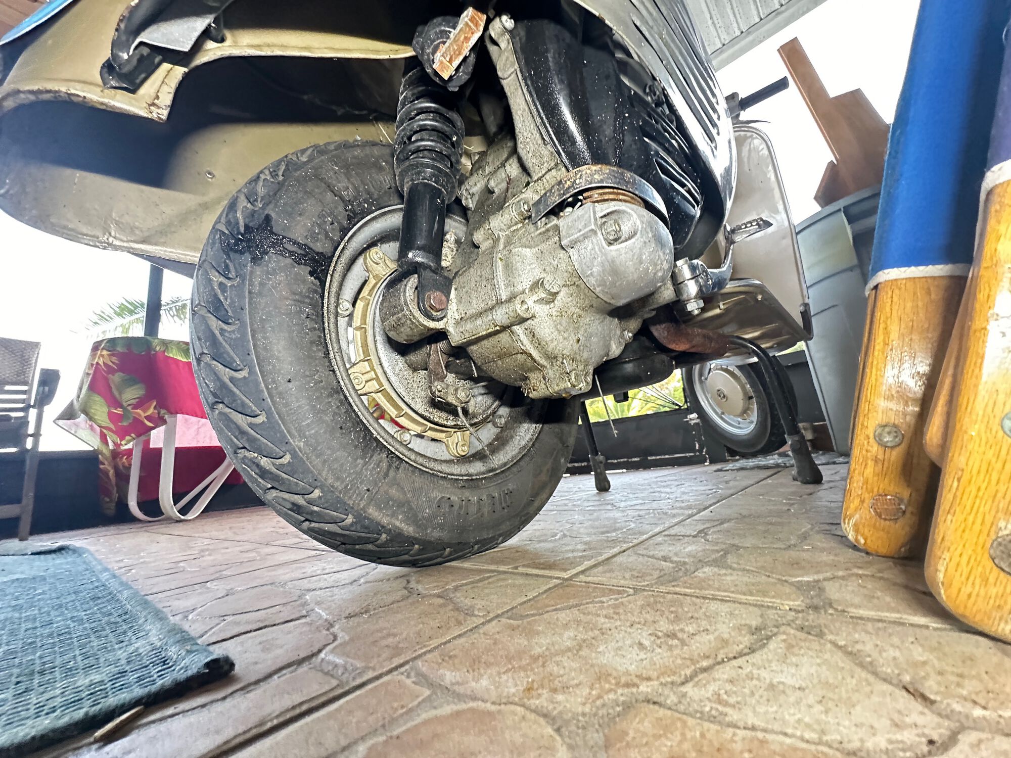

My clutch arm seal was leaking (and is leaking again). That causes a few drops of oil under the engine after running it, and centrifugal oil drips on the inside of the rear wheel. Looks like you may have a bit of that. It's more messy than a serious mechanical problem.
