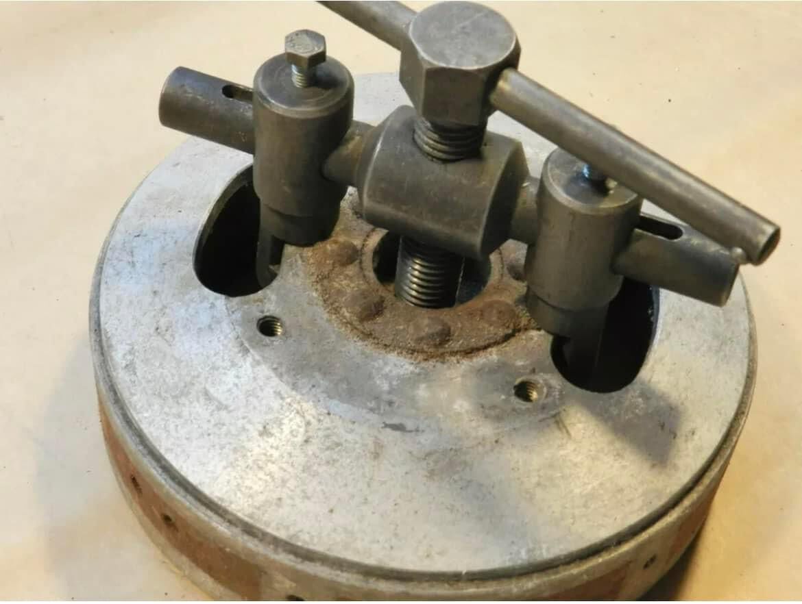

If it is a 2 inspection hole flywheel, the factory tool can be used. that late in the Super range it may be just the 1 hole inspection type.

Unfortunately just one inspection hole.
