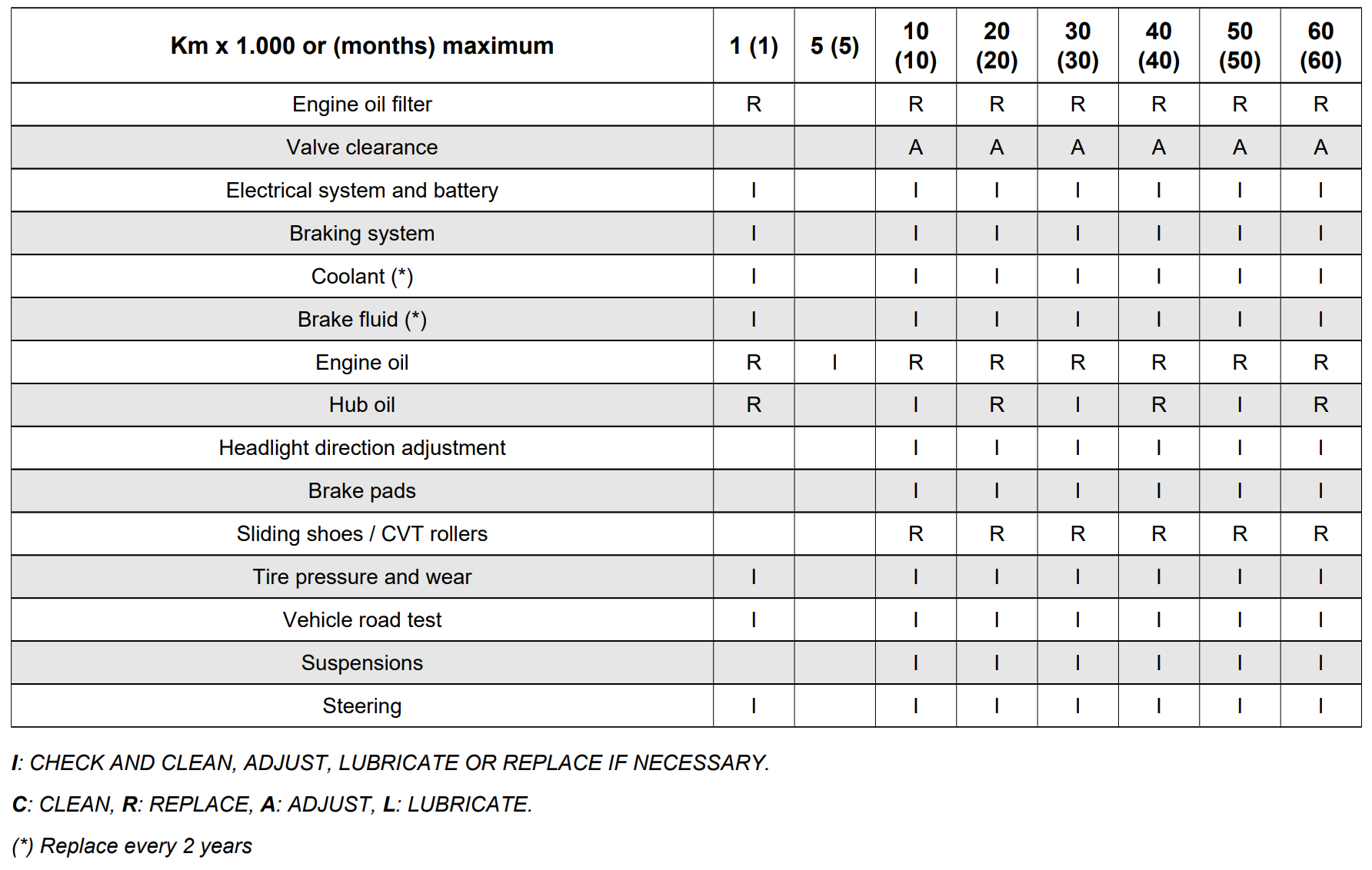

Posts: 7516
Posts: 7516
Almog wrote:
wonder why there's a 2 year limit on them even if they weren't used much.
there isn't.
read the user manual where it lists service intervals and it says to inspect every 10,000km. it does not say to replace.
should get at least 20,000-30,000. depends a lot on riding style etc. I replaced my front at 30,000 as they were worn a hell of a lot (they would have been fine to 40,000)

Location: Brighton, England
Fluid should be replaced at two years, but the brake pads only have to be removed and inspected.
