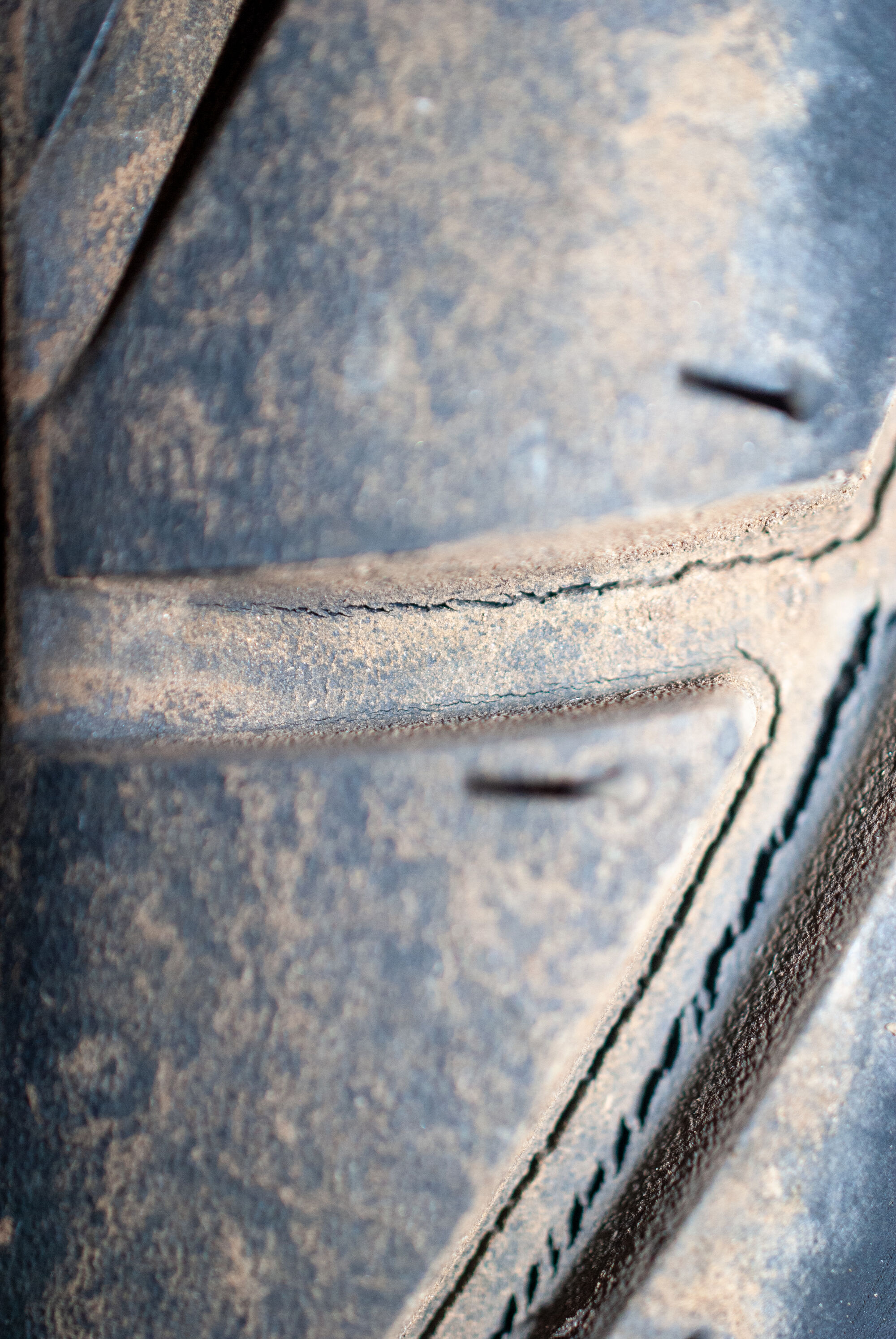

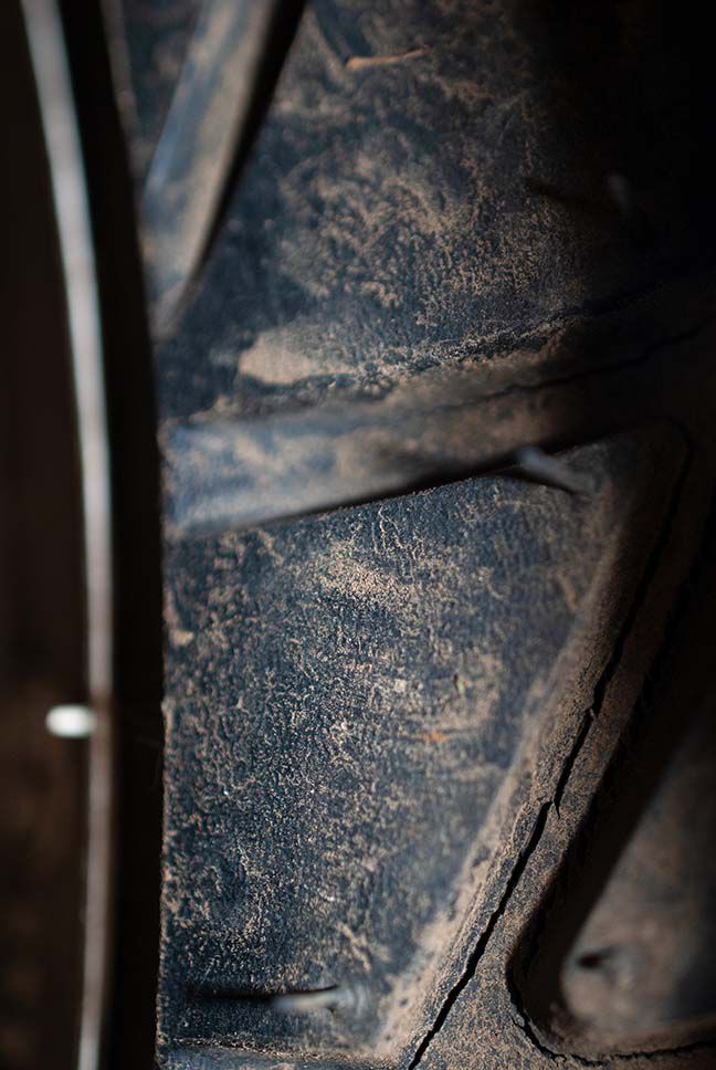

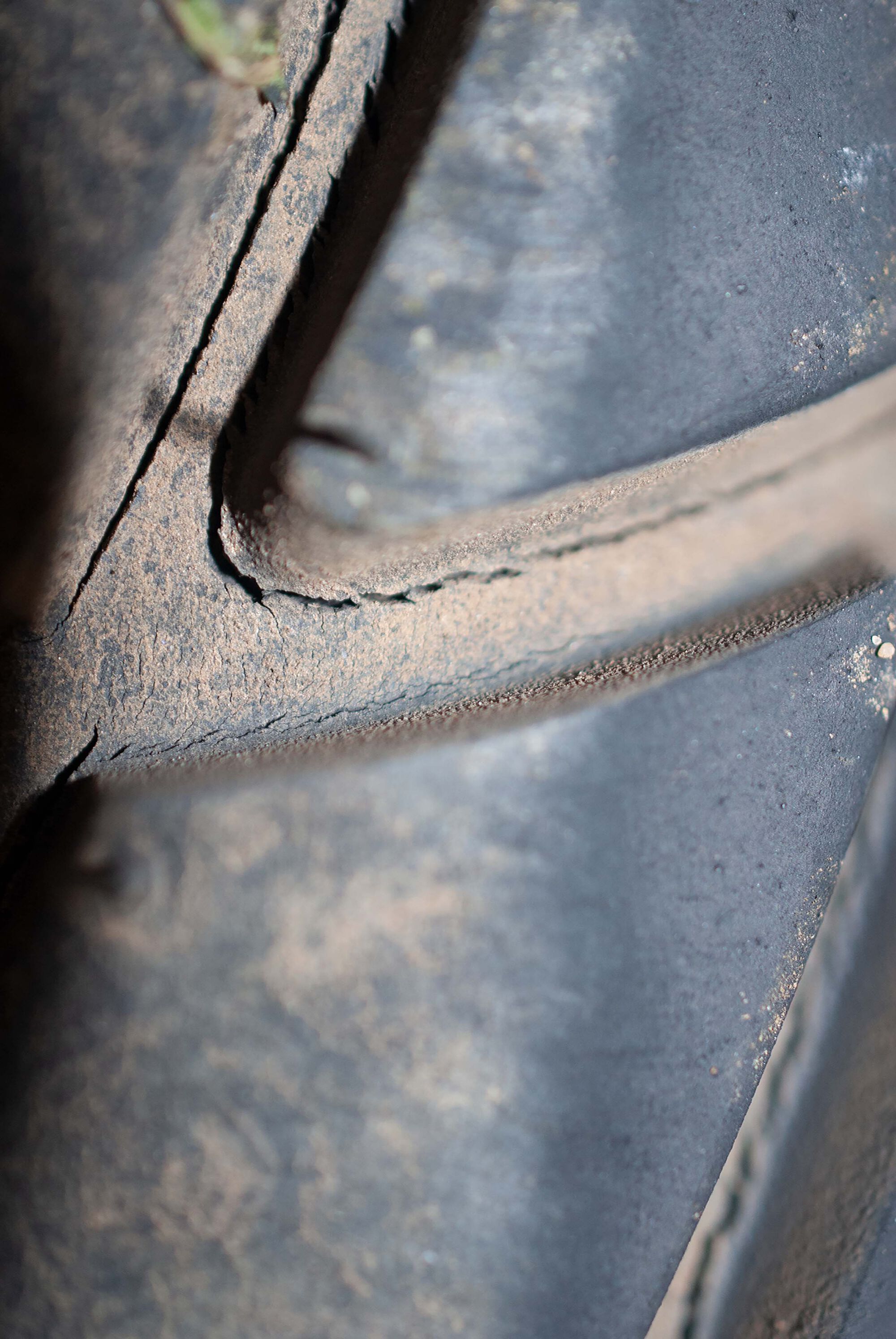

I have ridden just 700 miles on these tyres and they look like this..
I have no idea if they are or are not safe to ride on but have never seen this issue on ANY tyre on ANY motorcycle I have ridden from 1979 to the present day. I have contacted the supplier for a response - will see how that goes (but am not hopeful)

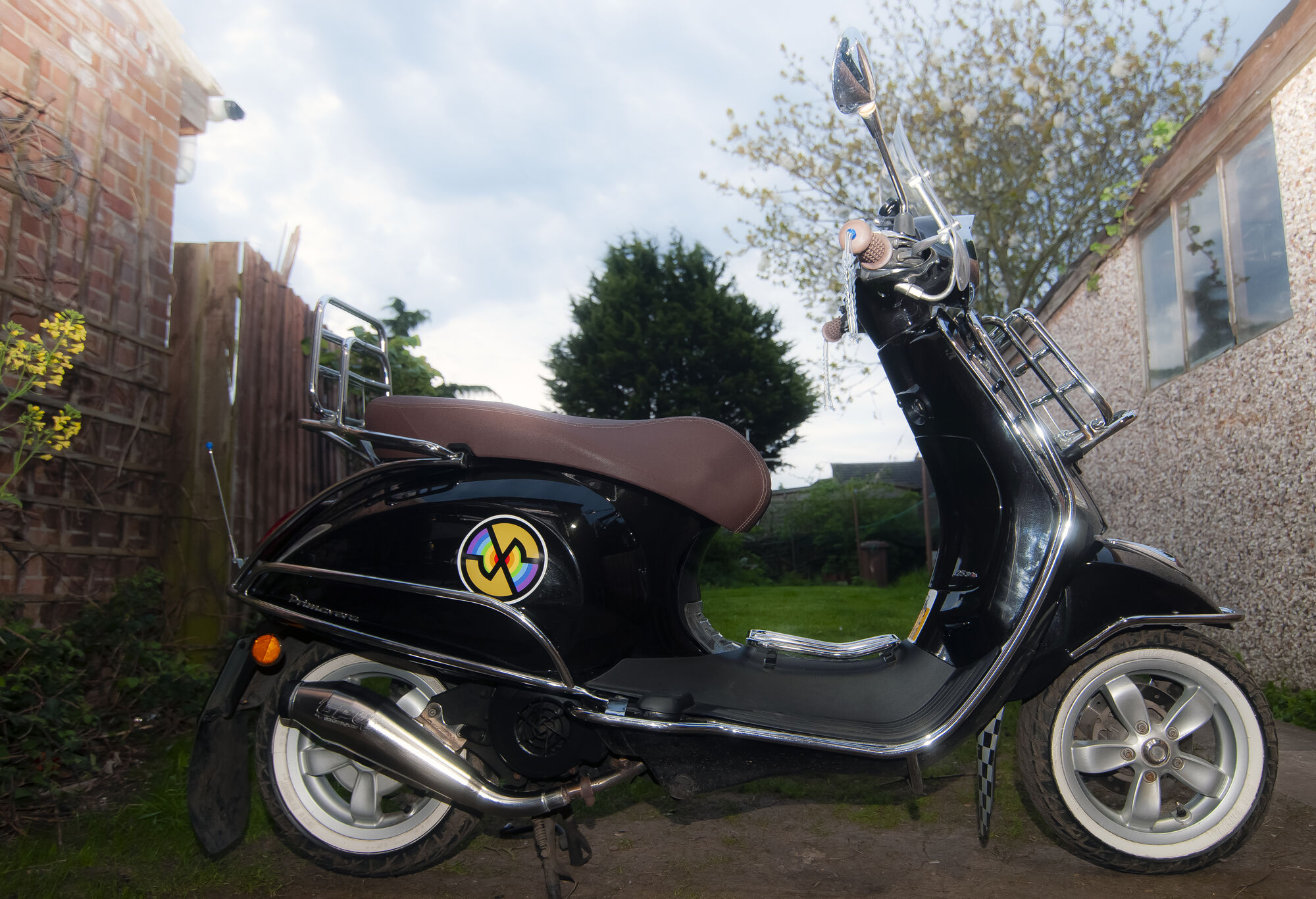

They are fitted to a 2014 Primavera 125 3V (as pictured)

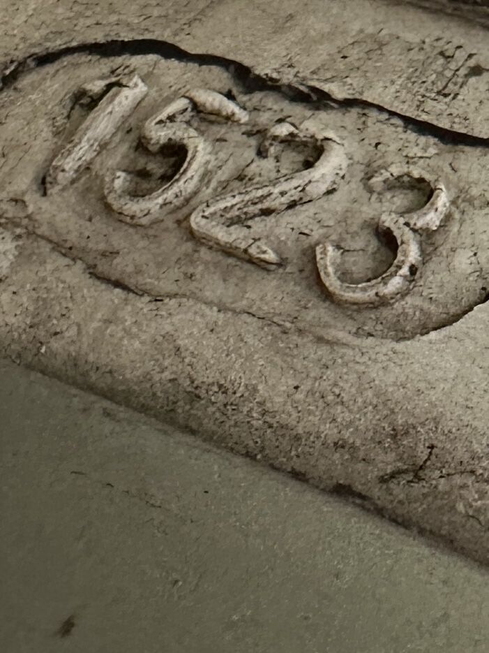

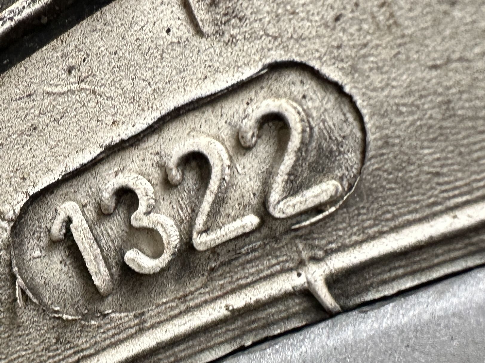

Please post a picture of the date stamp on the tire.

Thanks for your response - here goes...

Date code year of manufacture 2022 and 2023. Those are not old tires, should not be cracking like that.

my same experience on the Tomato. literally today decided to get back to either HEIDENAU K66 LT Silica (SiO2) reinforced M+S (important is that you select the SILICA VERSION) or the Michelin City Grip Mk2, which are also awesome in the cold/wet.
am walking away from the whitewalls Crying or Very sad emoticon after trying Sava, Continentals and Mitas. not worth the money nor the safety risks
PreddyBaer had similar problem few years ago, the TÜV (MOT) examiner thought that the tires are way older, then he checked the DOT numbers. could not fail him but wrote strong recommendation to change the tires ASAP.

Shinko scooter whitewalls don't win any awards either.

Many thanks for the replies

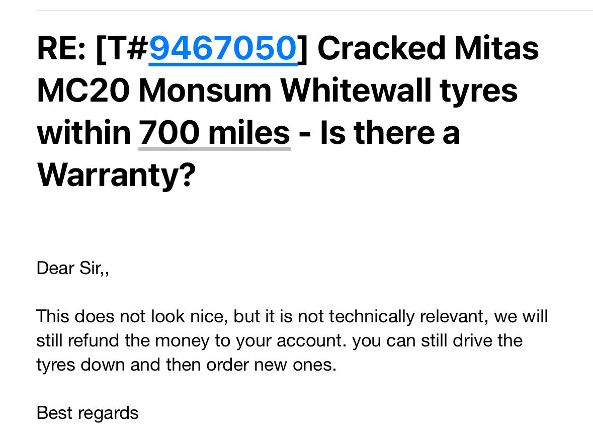

I received a response from the supplier and they are going to refund me;
"Dear Sir,
This does not look nice, but it is not technically relevant, we will still refund the money to your account. you can still drive the tyres down and then order new ones.
Best regards
Valentin Haberkamp
Verkauf
SIP Scootershop GmbH
Marie-Curie-Str. 4
D-86899 Landsberg am Lech
Germany"

That's quite a bold move to suggest they're safe to use, and that they're only replacing them for aesthetic reasons!
I'd definitely get them changed out ASAP.
