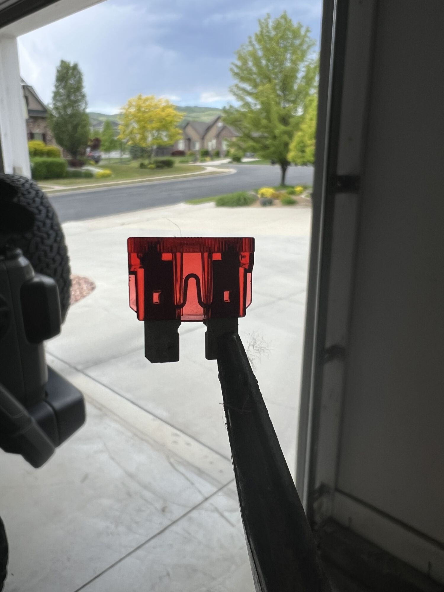

Thanks. All fuses are good. (6 of them in the glove box).

There are more fuses.
iirc one in the battery compartment and one under the pet carrier. read user manual for precise locations.
Also did you check them with your eyes or with a multimeter?

You're correct. There is one 30A fuse in the battery compartment. From research, it appears they moved the fuse from under the pet carrier to the batt compartment sometime after 2016 or so.
I just visually checked them. I'll have to get a multimeter and check if I'm getting 12v. But would any of those fuses cause the starter to crank but engine not fire?

Well, I checked the fuses (visually) and the plug wire. All seated correctly.
Guess next step is to check the fuses with a multimeter. But I have doubts since all lights and other electrical components appear to be working fine.

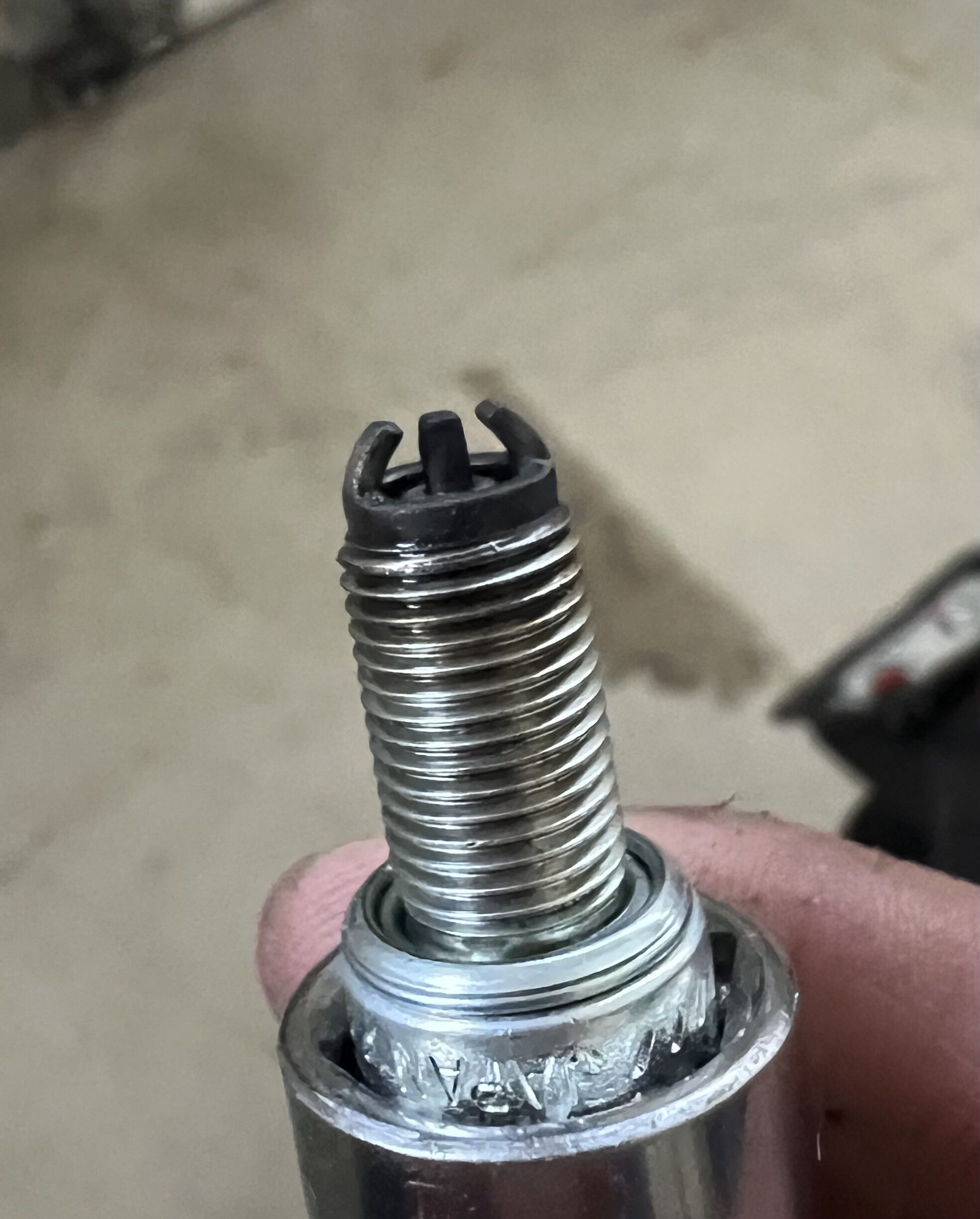

Just pulled the plug.
I tested for spark as well and all is good. I did order a new plug just in case. But spark isn't the problem. Hoping it's a flooded engine. I'm leaving the spark plug out for the night and will try it in the morning.

Put the spark plug back in, hoping if it were flooded engine, the gas would've evaporated overnight. Still no go this morning.
One thing I've noticed is when I first try starting it, the engine sputters for a second like it's about to start. Then on the subsequent start attempt, it just turns and nothing. 🤔

When I tested the spark plug, I remember it wasn't just a little blue spark. It was a big yellow spark. So it got me thinking.
Per this thread for reference. jimc 's comment on page one caught my eye.
300GTS Not starting (Page 2)
First: the color of the spark that you see is determined by what elements are in the spark. Each element when ionized in a spark emits a different color spectrum. A bit of contamination on the spark plug changes the color.
Anyway, the color is not relevant. What is relevant is that it is a strong spark.
You tested it outside of the engine in air. But in the engine it has to spark in an air-fuel mixture at some 10 bar. The higher the pressure, the harder it is to spark.
Considering it is a recent GTS 300 with electronic ignition I have no doubt if you see a spark it is a strong spark. But checking that with a brand new spark plug is fine. It is cheap.

Mystery solved!
It turned out to be the 10A fuse, which I believe is connected to the ECU.
The stock one looked fine visually (picture below) but apparently not!
I swapped in a new 10a fuse and it's all good!
Thanks for the help, all!
⚠️ Last edited by hoch on UTC; edited 1 time
That's when a cheap multimeter comes in handy.
