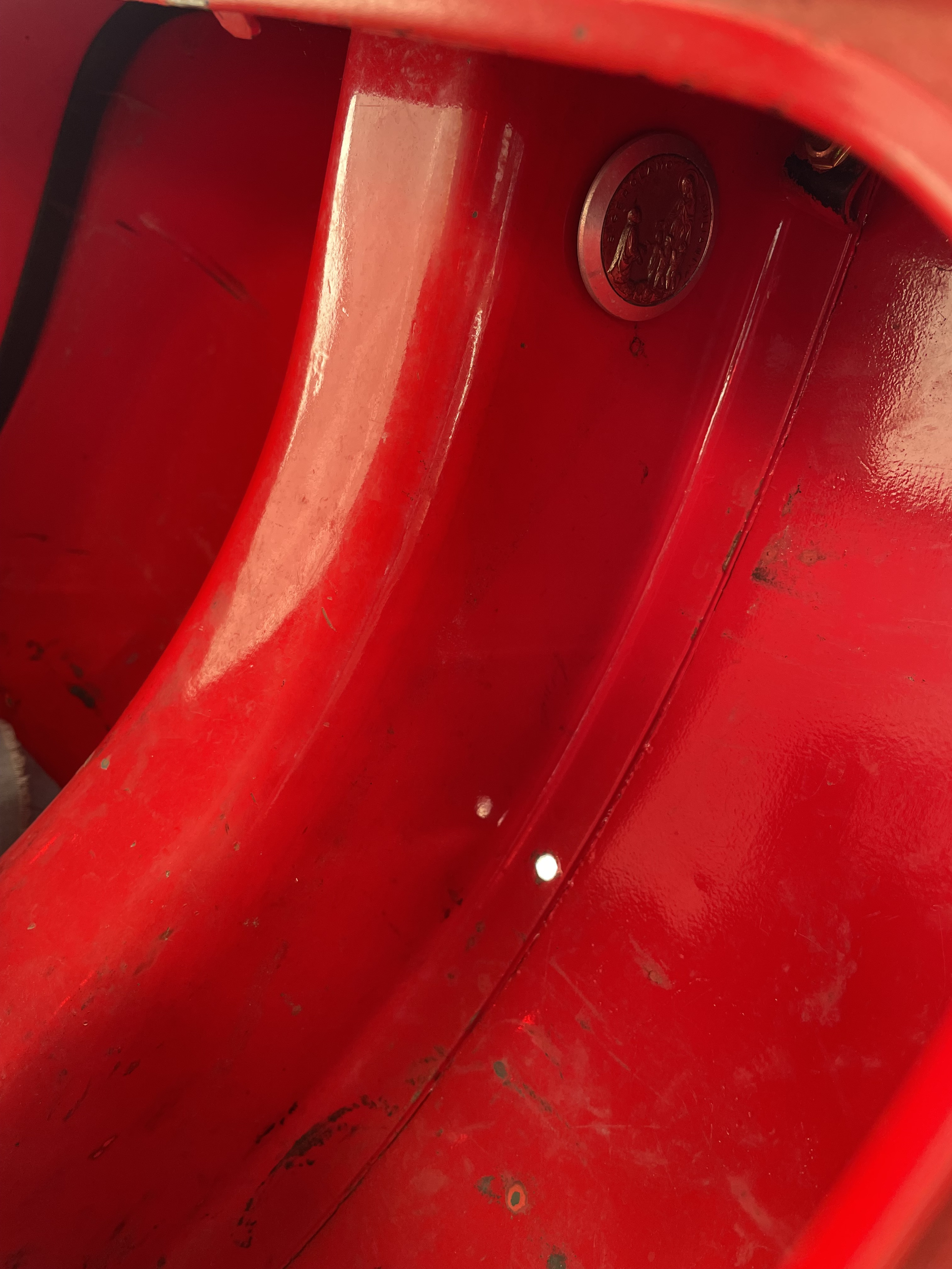

what is the key for on the rear license plate area?

I like the horncast!
That key though?

Key for quick release license plate?

More secure than velcro.

I was right about you will like that key for license plate)) And It even work.

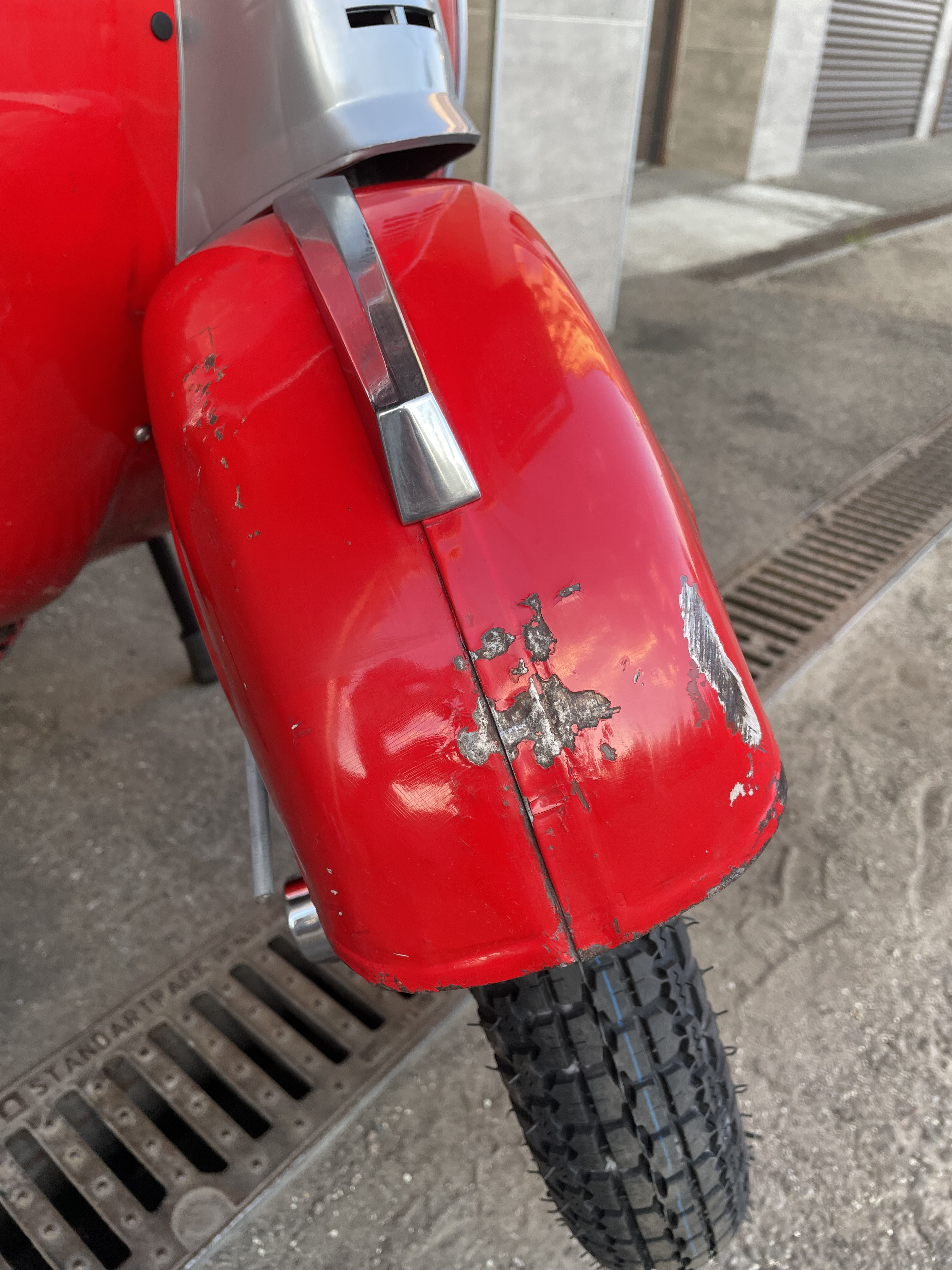

And this is the most annoying damage.
It can't be fixed because the owner refused to completely rebuild the engine because the Vespa started perfectly with fresh gasoline.
I don't think he will drive it often, most of the time it will sit next to his other retro cars. Seems like nice looking scooter is more important for him than nice rideable scooter.
So I will do as he want.

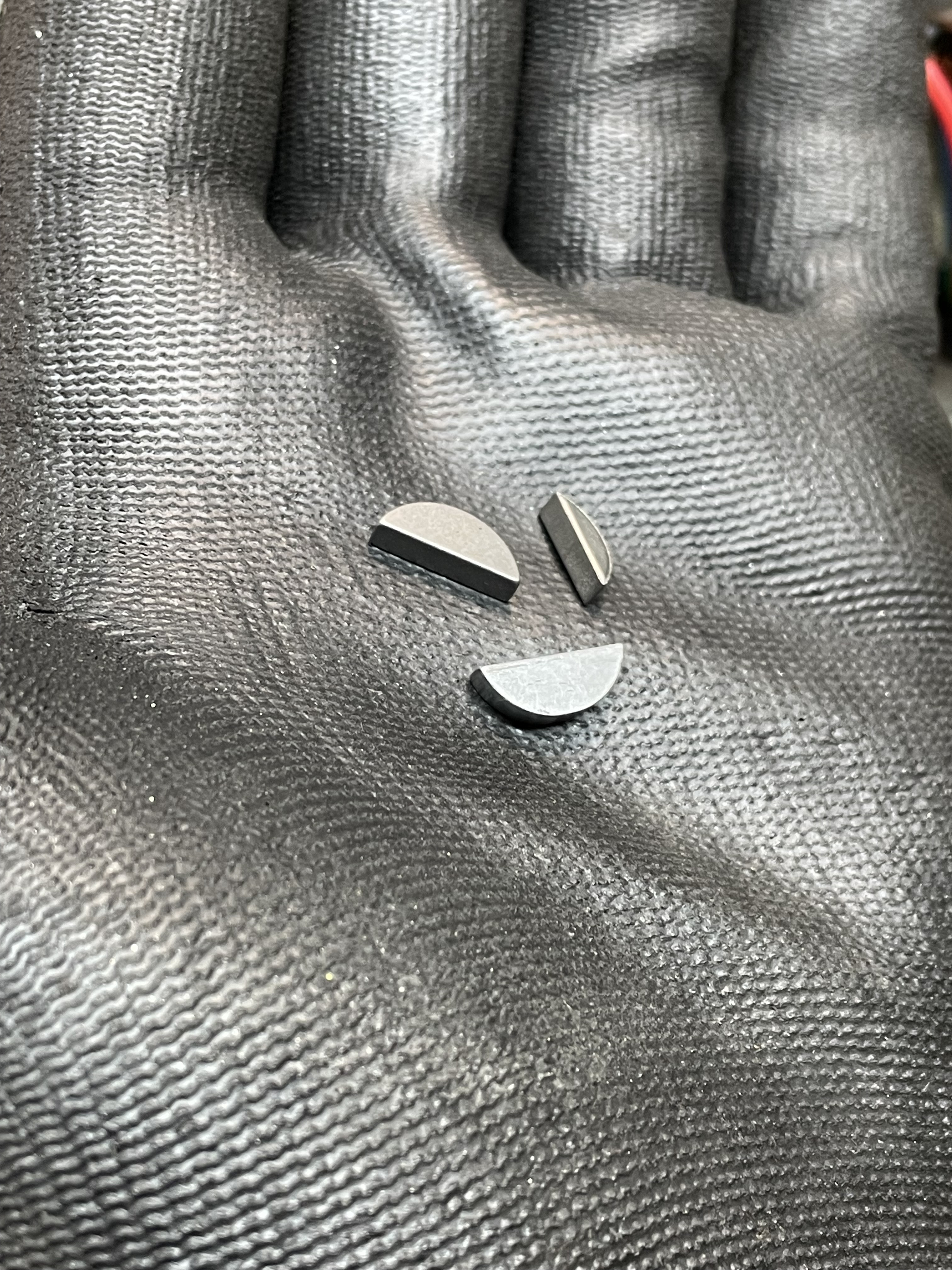

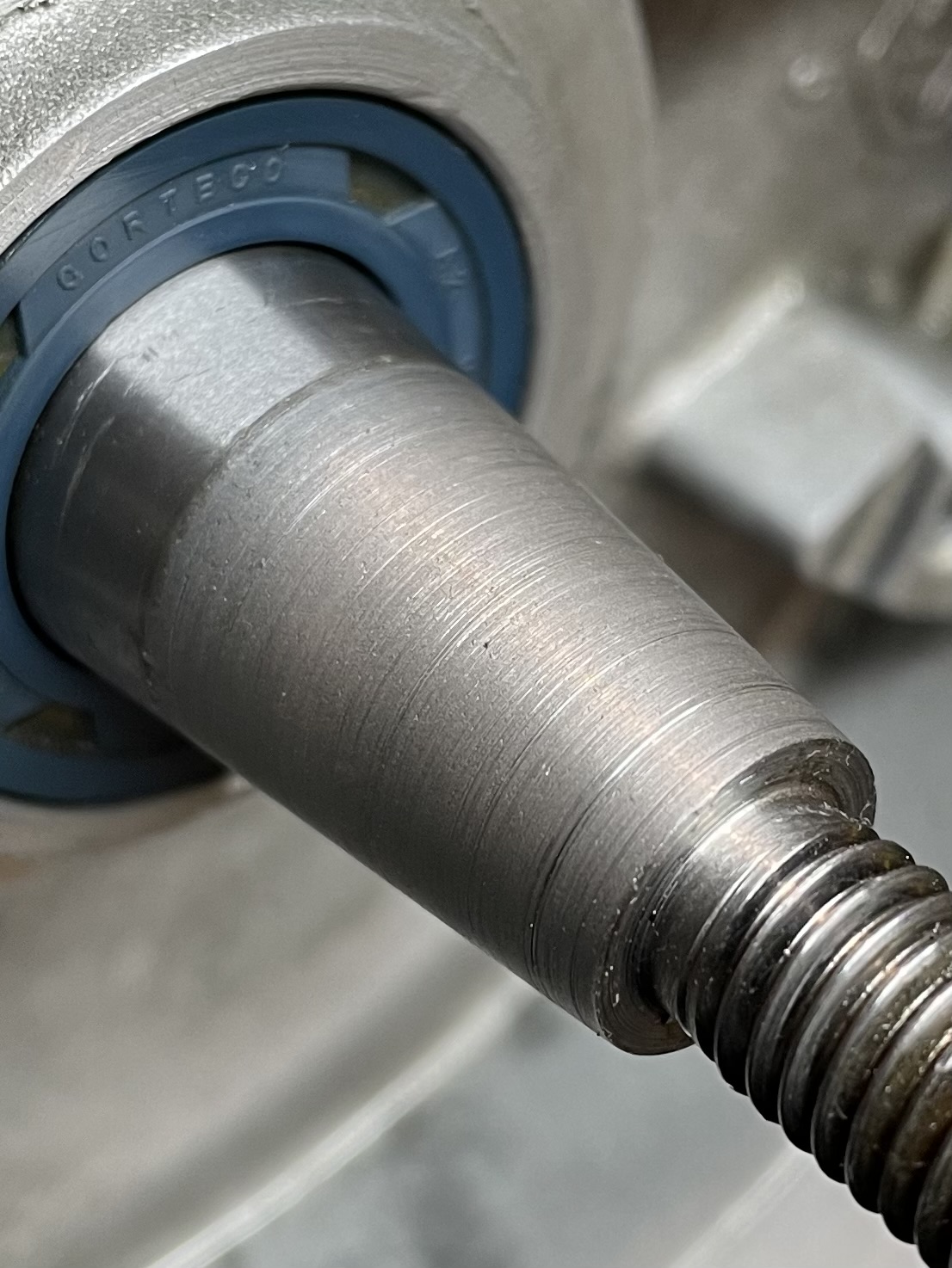

It was absolutely hard to take flywheel off. Circlip was missed and I had no spare. But it seems it will be no luck even if it was there.
With fresh wires.

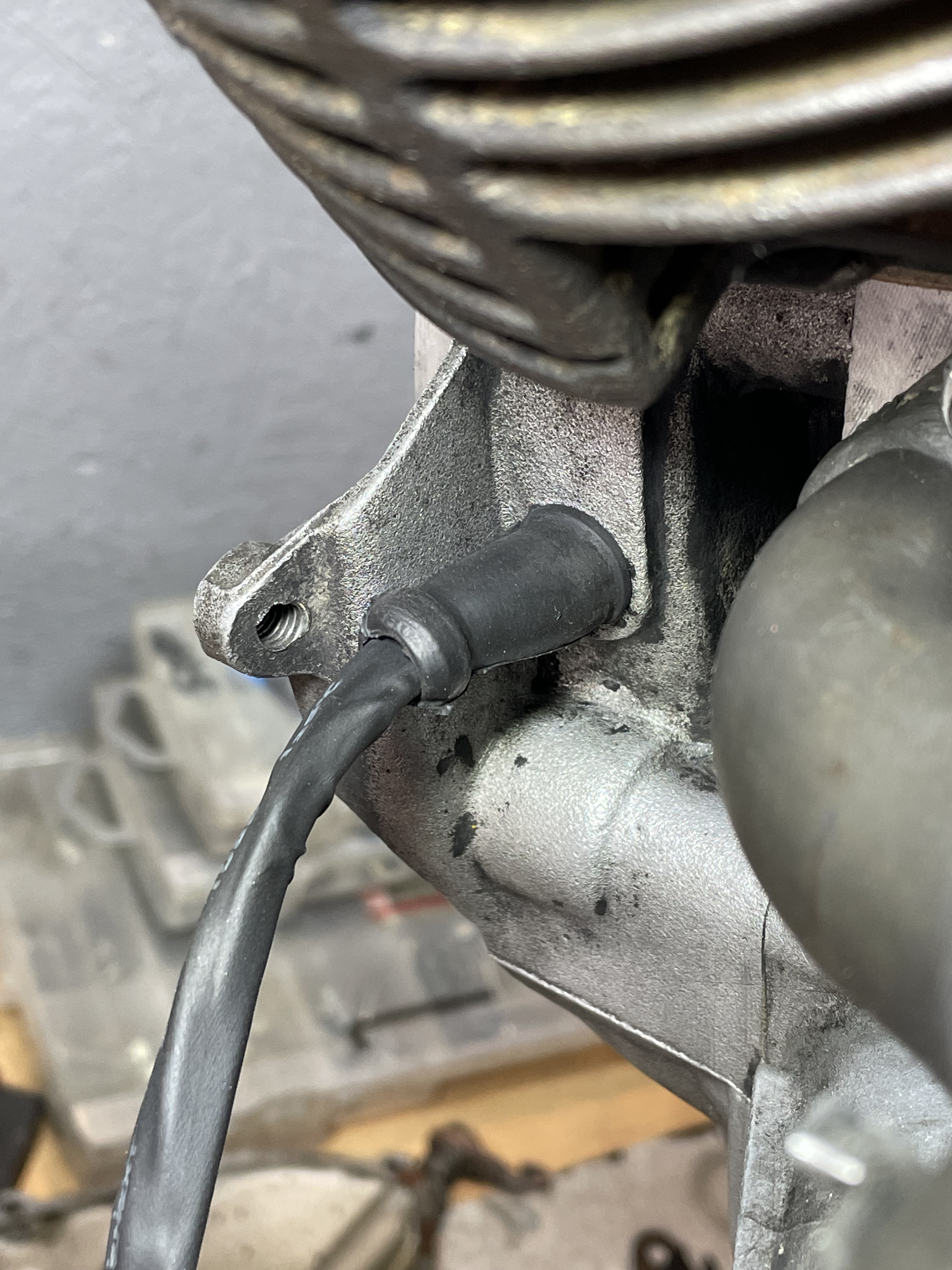

HT coil bracket was made from other FEMSA bracket.
Oops

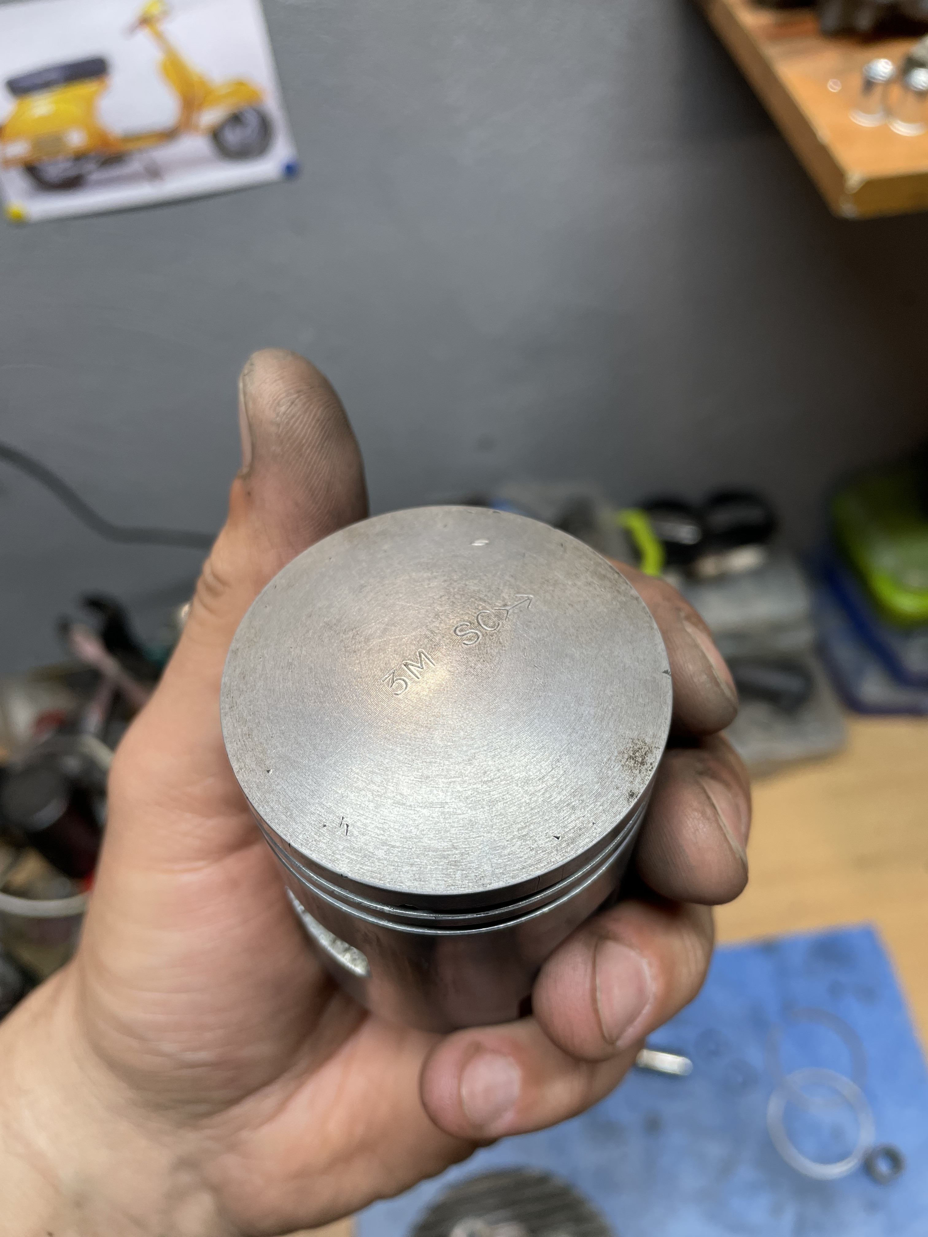

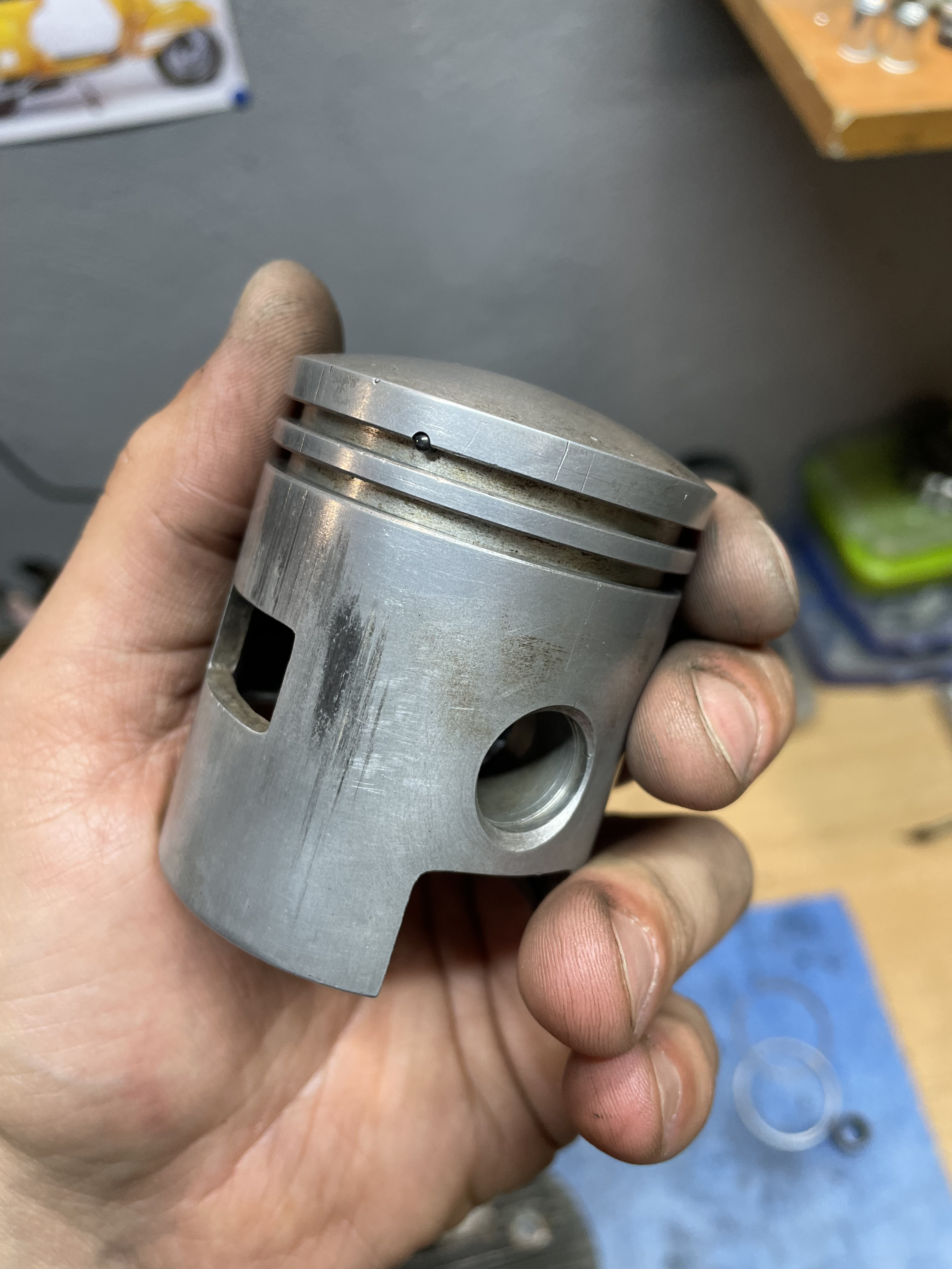

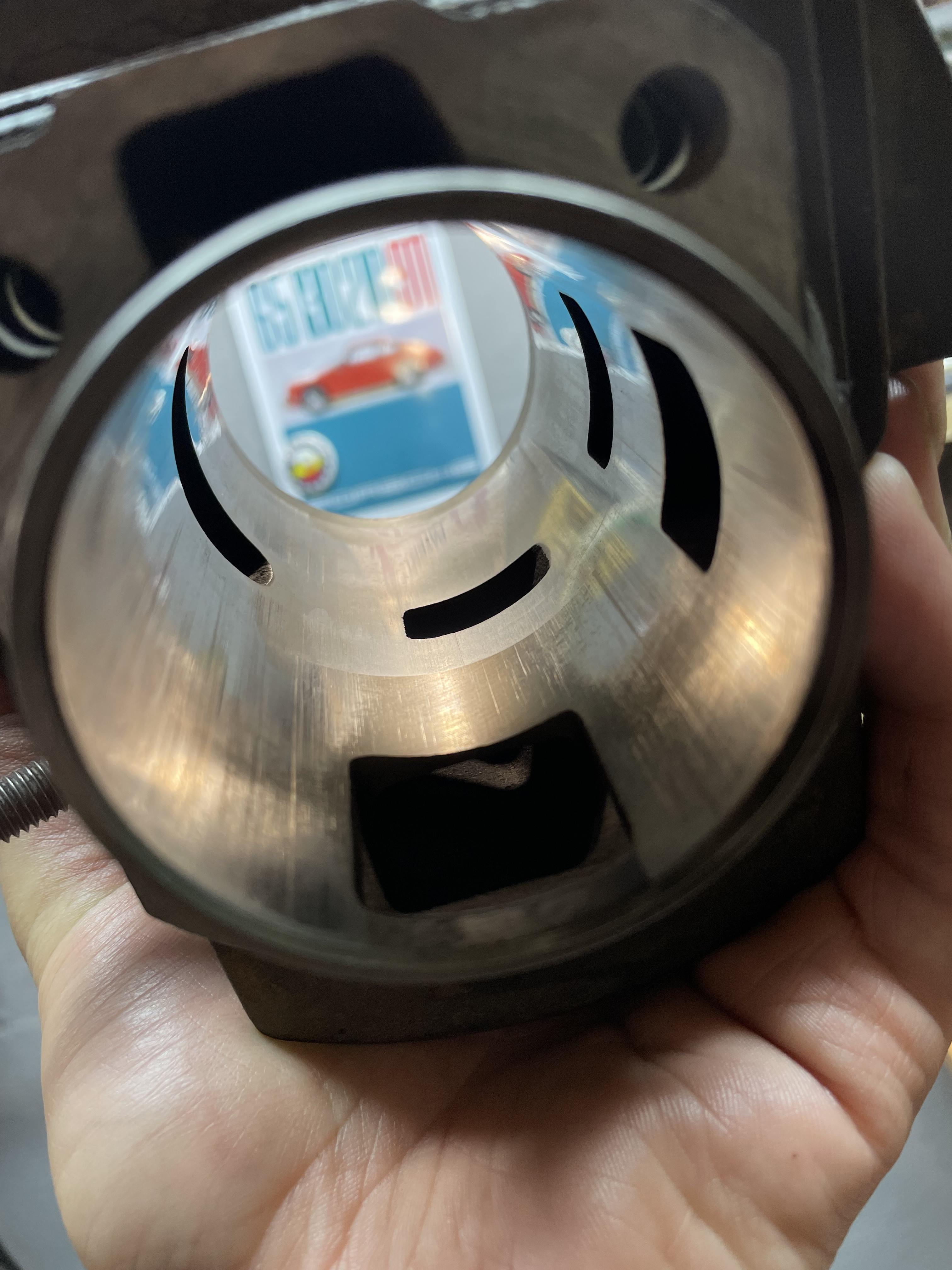

3rd oversize piston
All was cleaned, sanded, lapped and went back.
Marked for 19º and will check later with strobe.

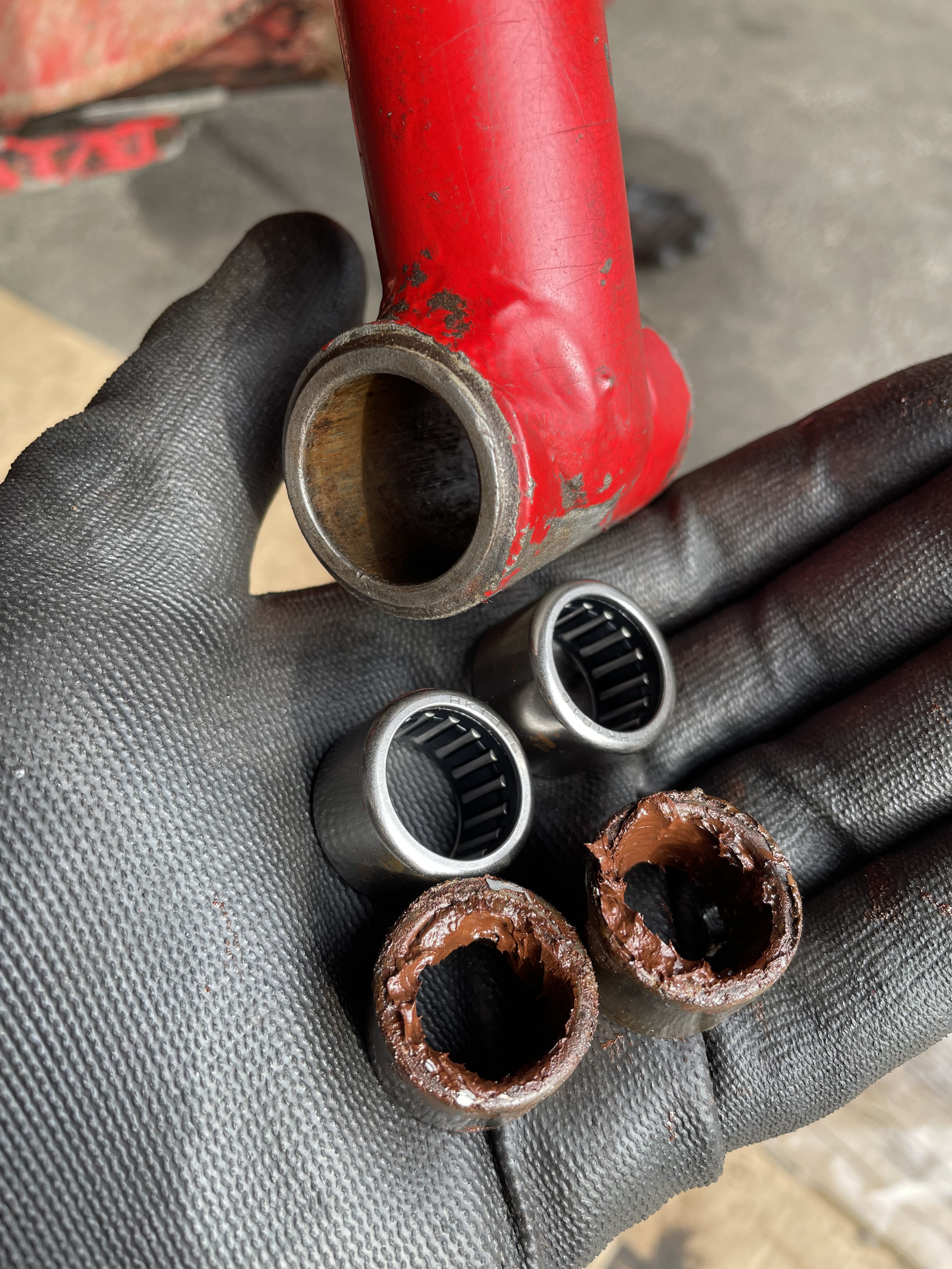

Cleaned hub and arm

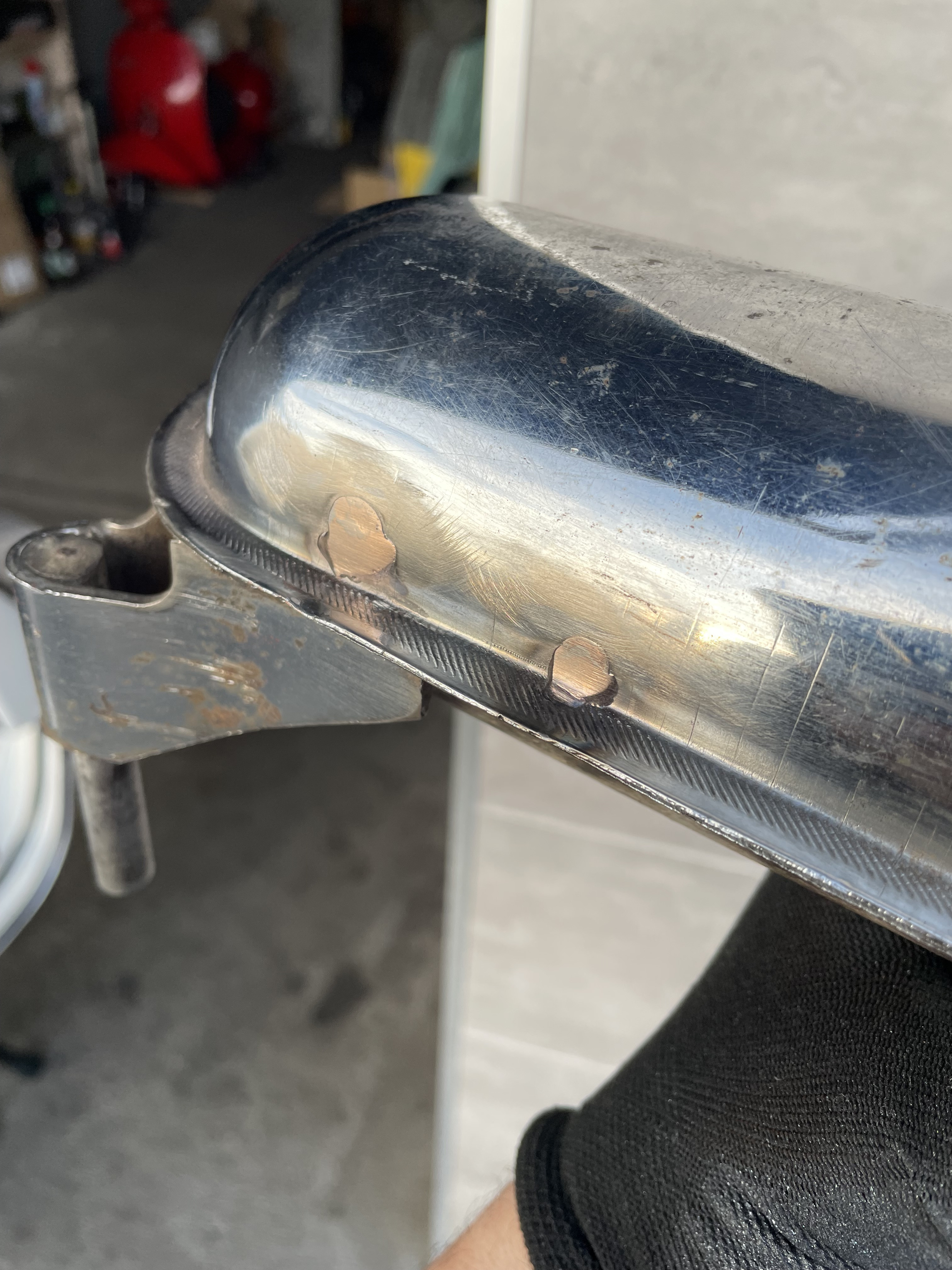

Soldered holes on exhaust.

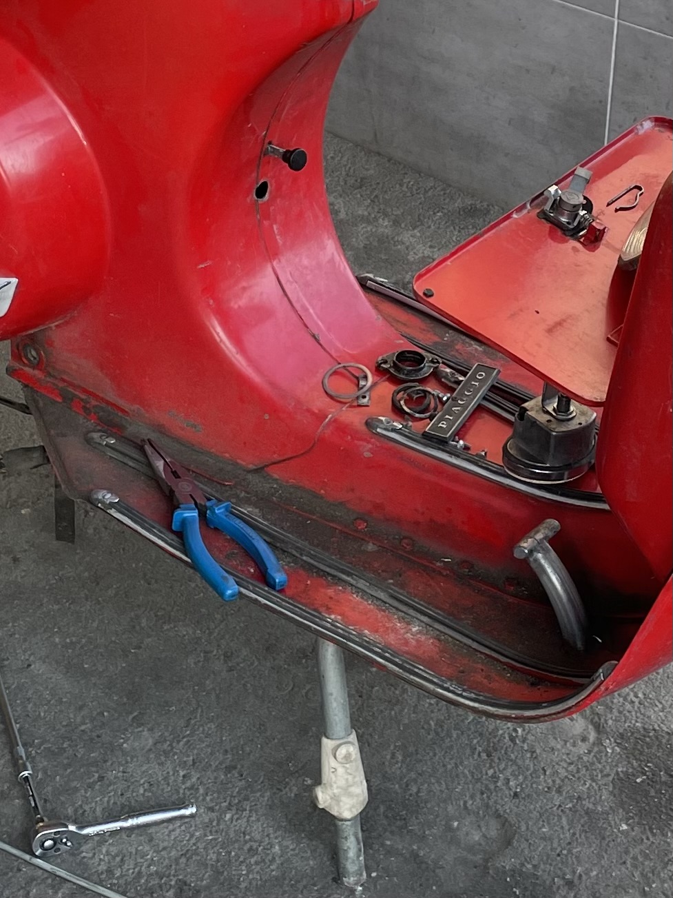

Spent few hours cleaning the floor. And seems that here is original paint.

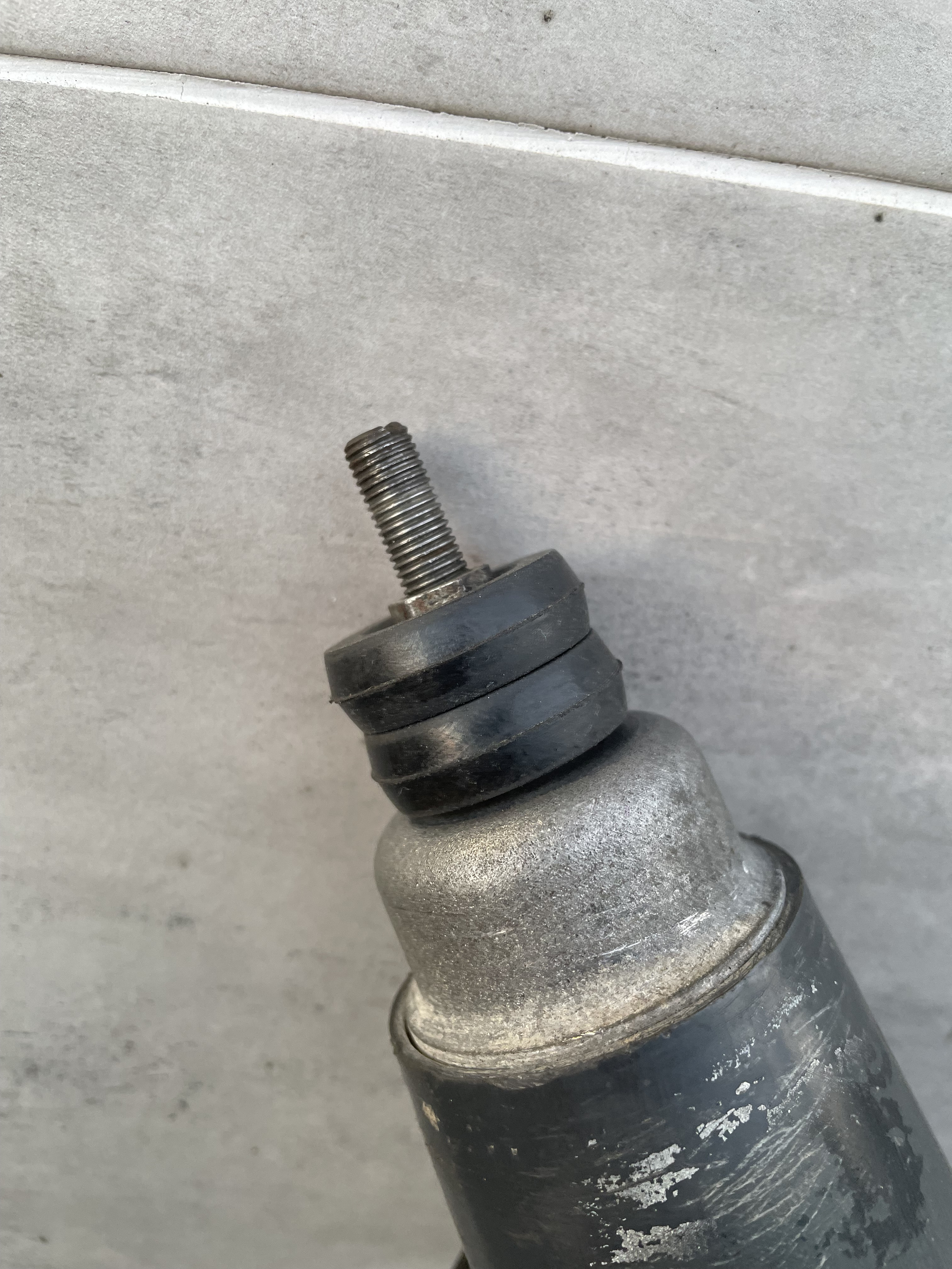

Changed rocker arm shaft and painted with spray can.
All new rubbers.

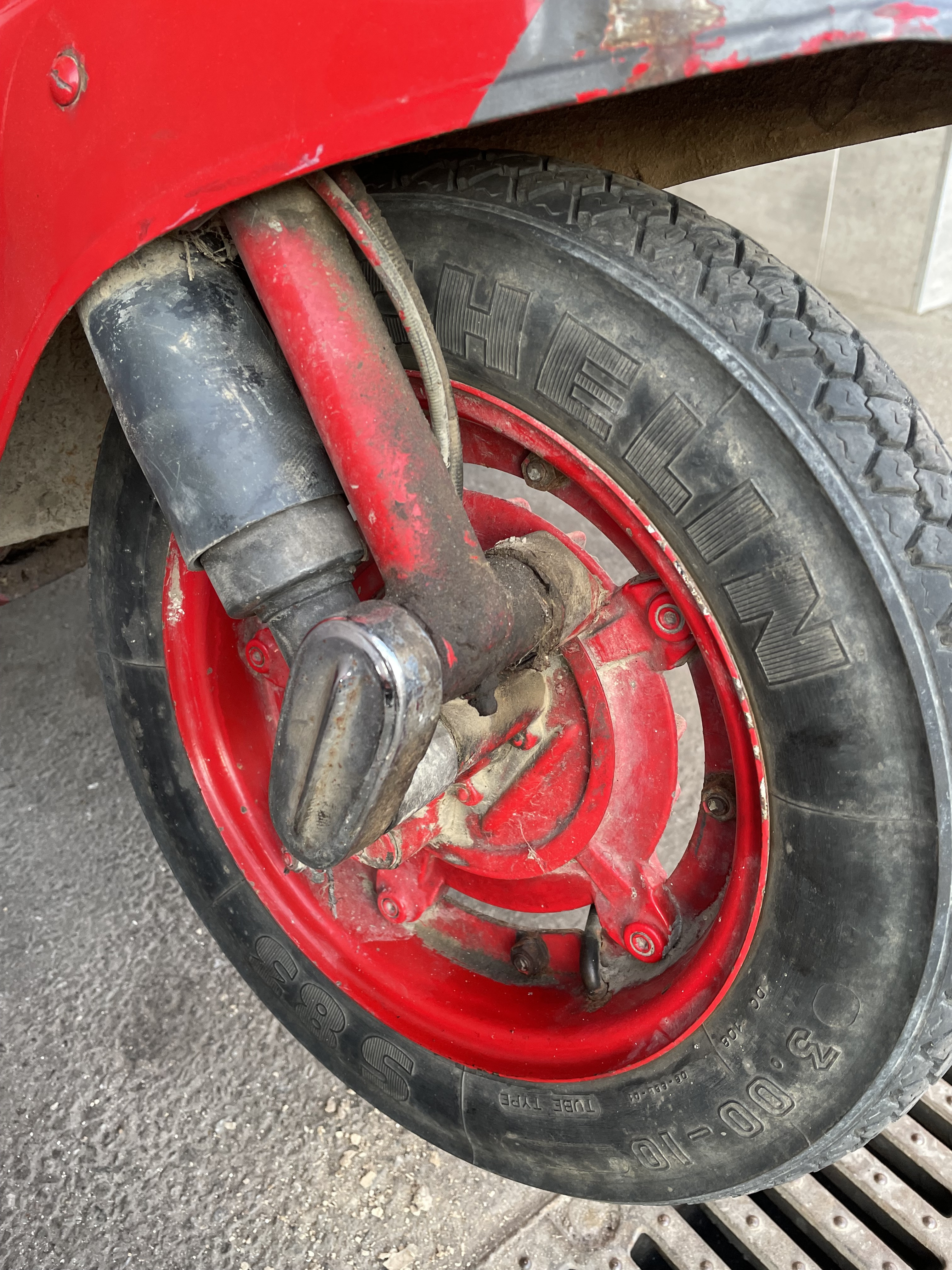

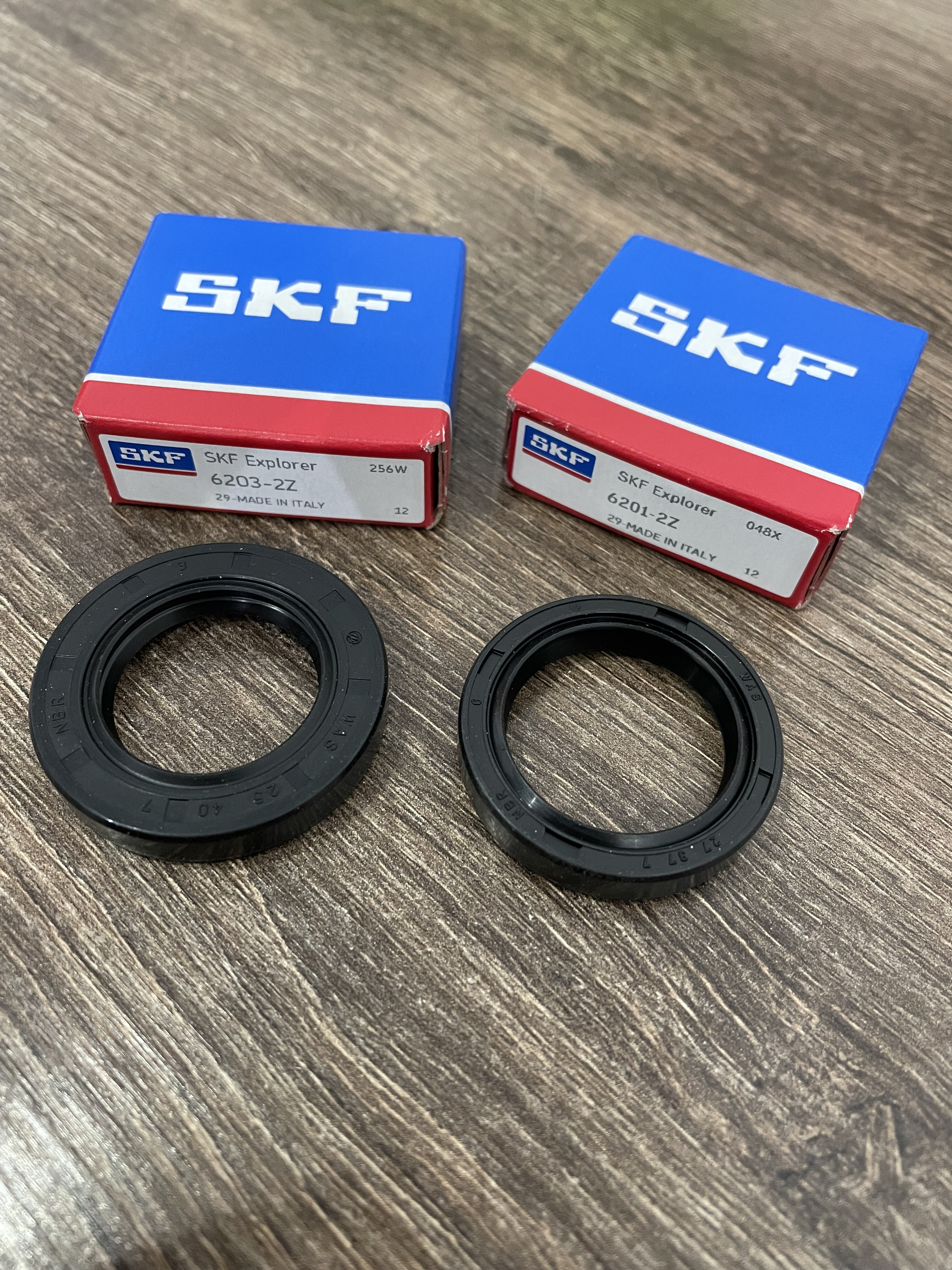

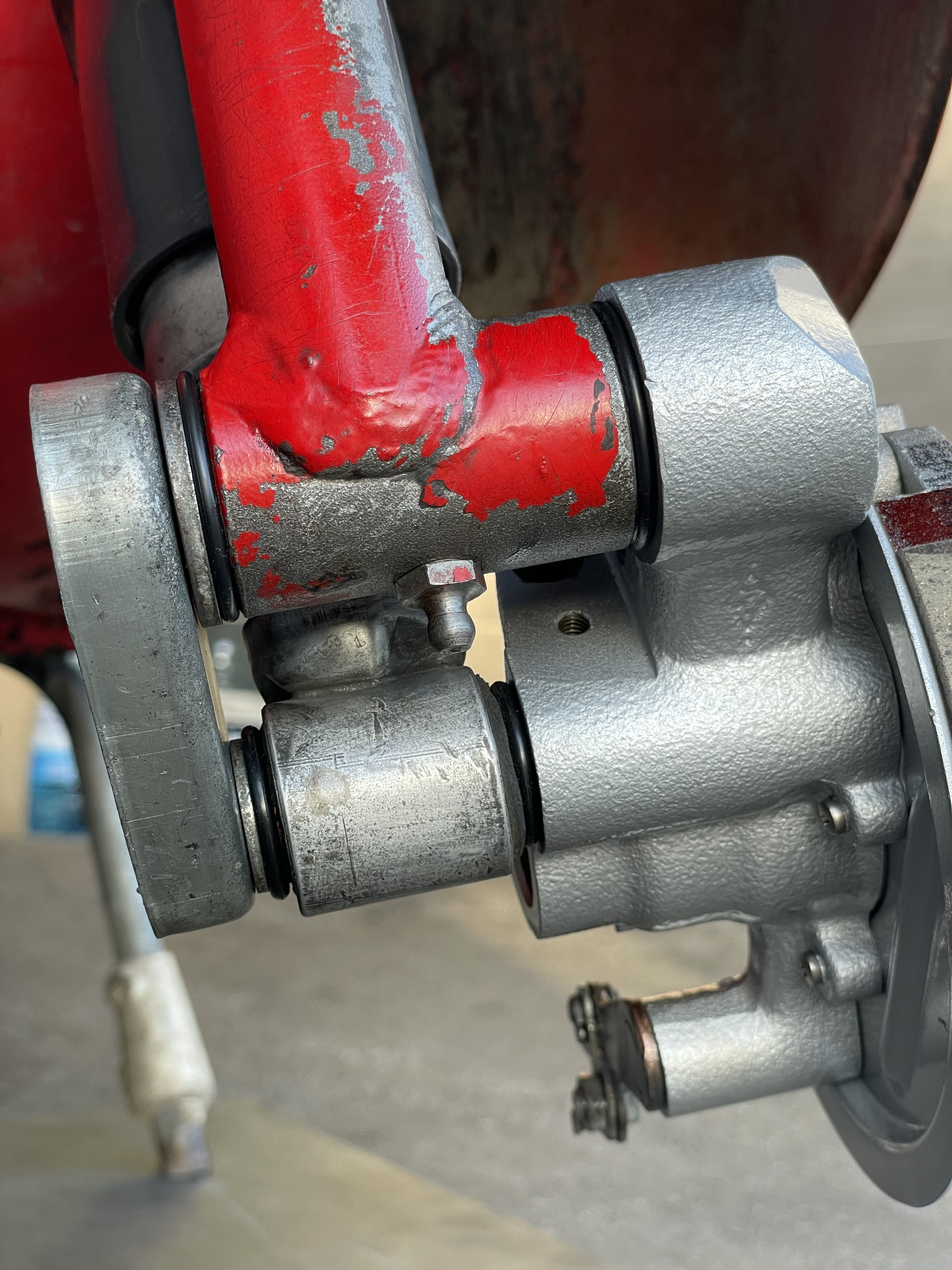

New SIP brake shoes(absolutely can't recommend it), hub bearings and seal.

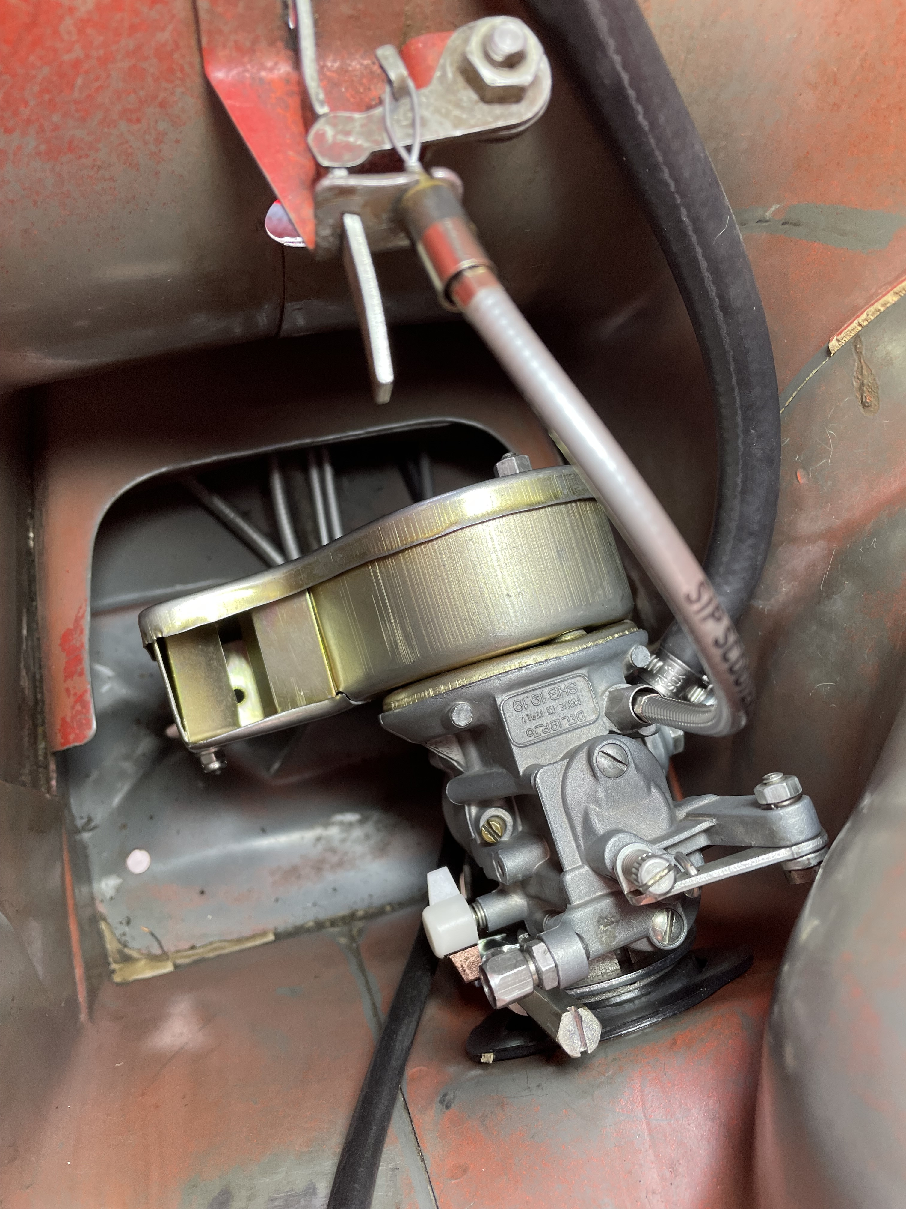

Carburettor time. There was 80 main jet while the manual shows 74. I put 75 in.

Assembled wheels with SIP rims and tubes and Vietnamese SRC SV-525 tires(which looks same as Kenda K303 and SIP Classic, but much more cheaper and locally available).
Old and new.

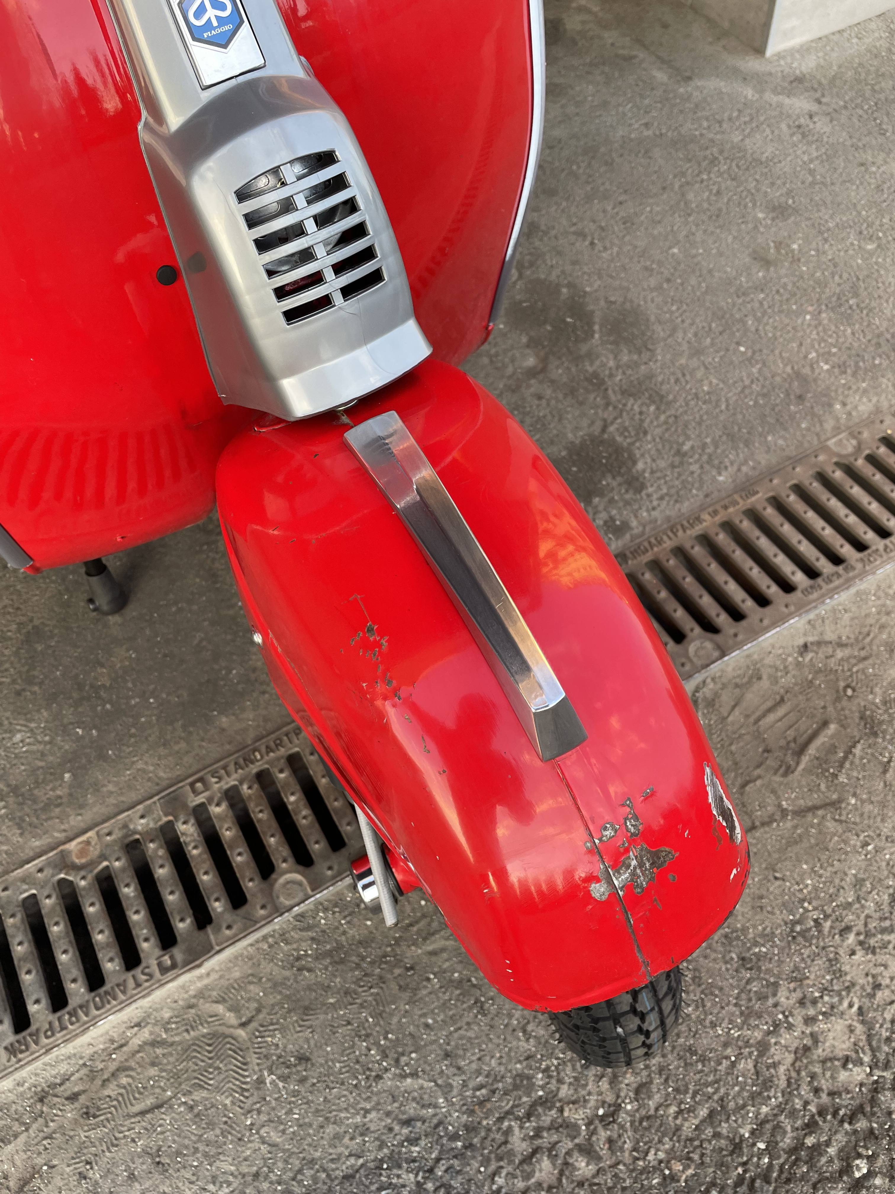

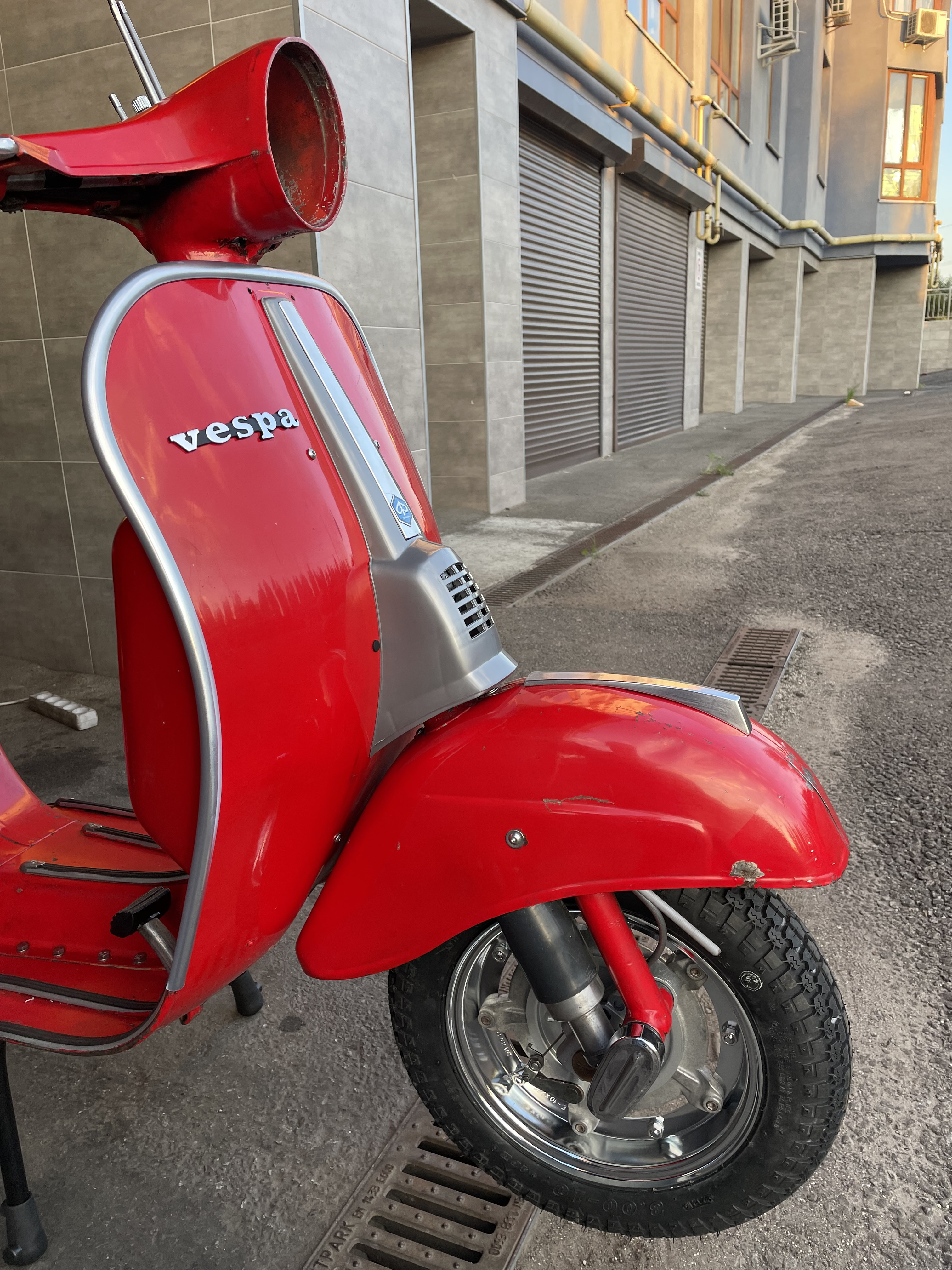

And bit progress again:
- cleaned horn
- mounted horn cover
- mudguard crest(polished a bit)
- leg shield plastic beading(absolutely mad shit)
- new Vespa badge
- brake cable and lever(polished a bit)
- speedo cable outer
- new centre stand
- mirror bracket
- new hex stainless bolts for glove box

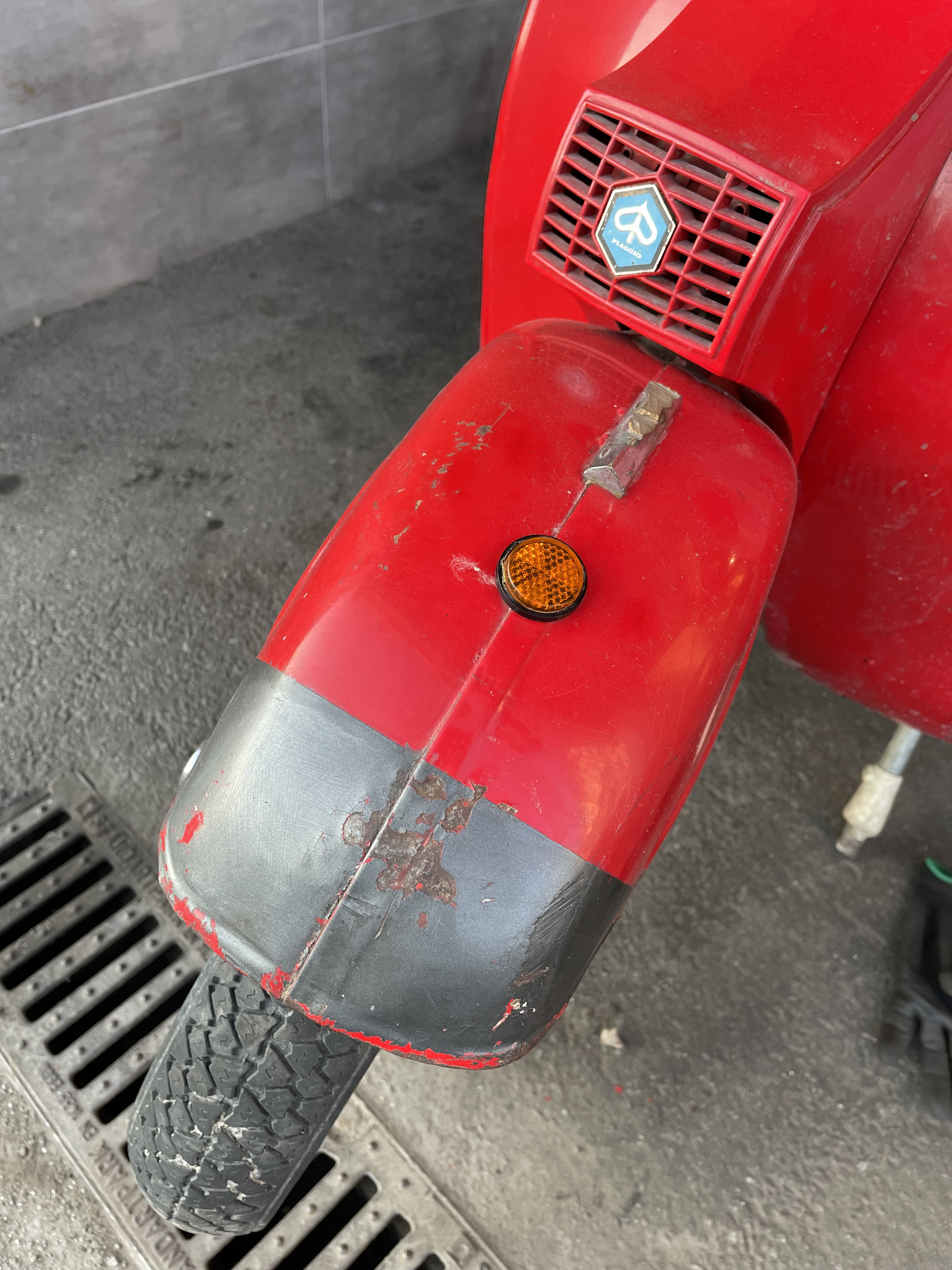

- removed awful gray paint from mudguard.(this is my first experience in it and I really like the result)

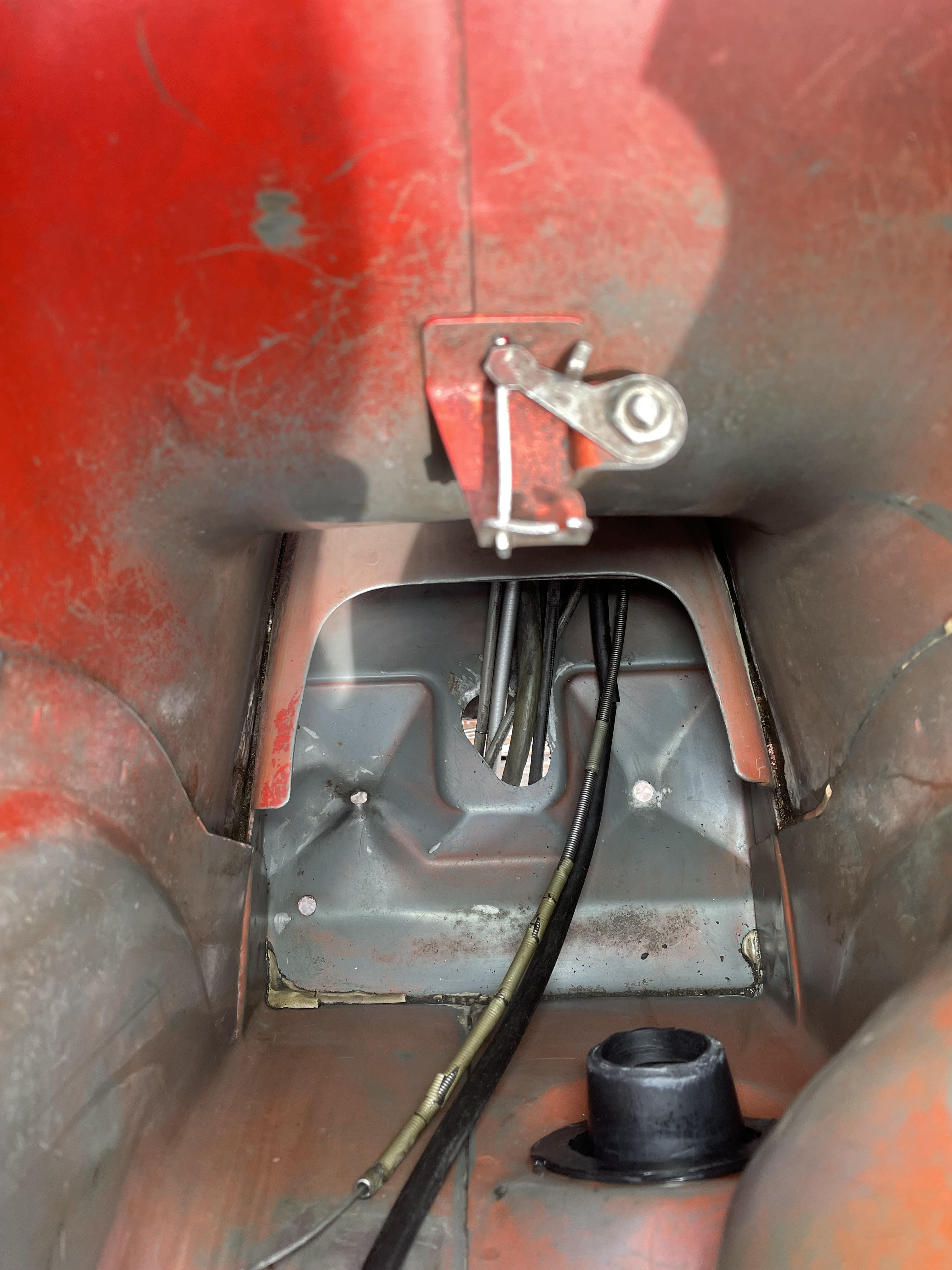

Finally I got back gear tube from the welder. Today assembled all cables. Thanks Birdsnest for suggestion about clutch cable mounting in the tube. All works as it should.
Not perfect look but good enough.

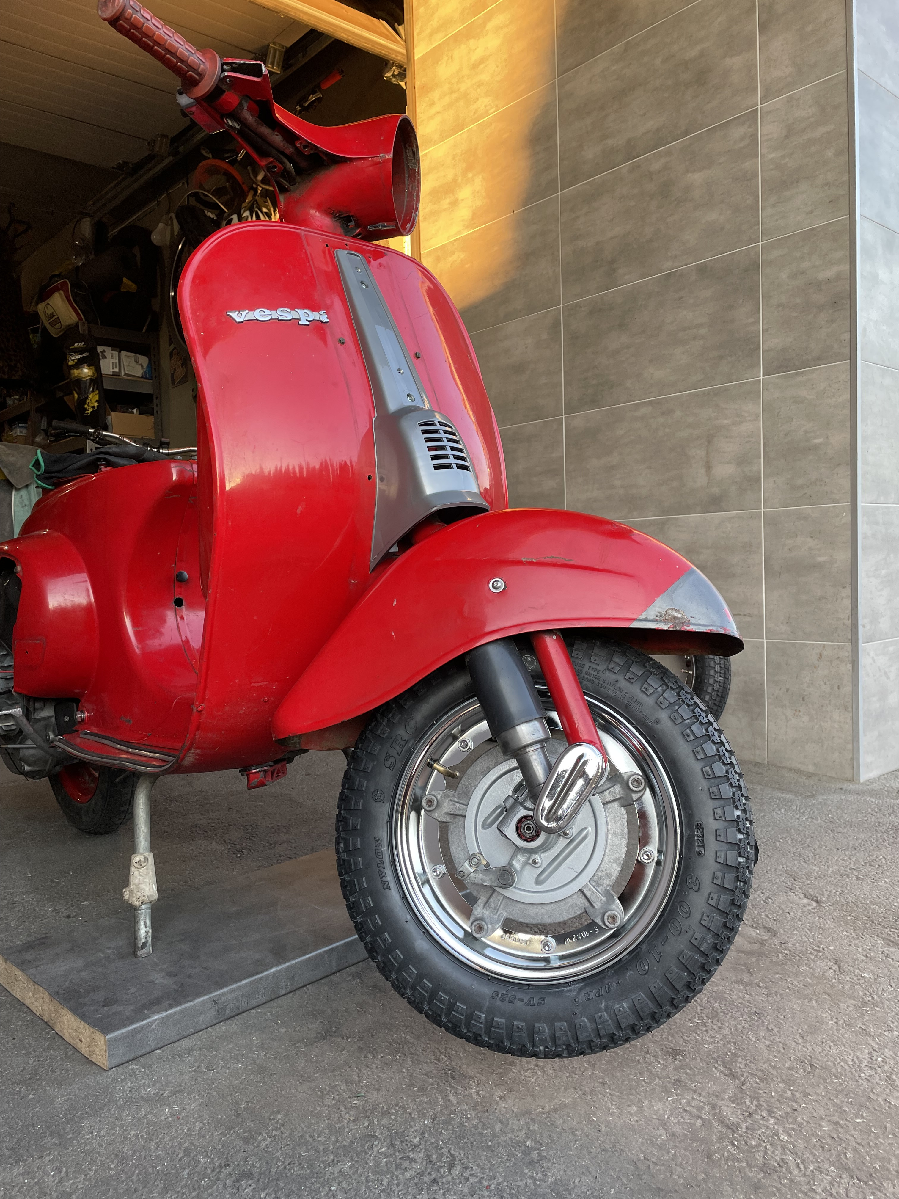

Finally on new wheels.

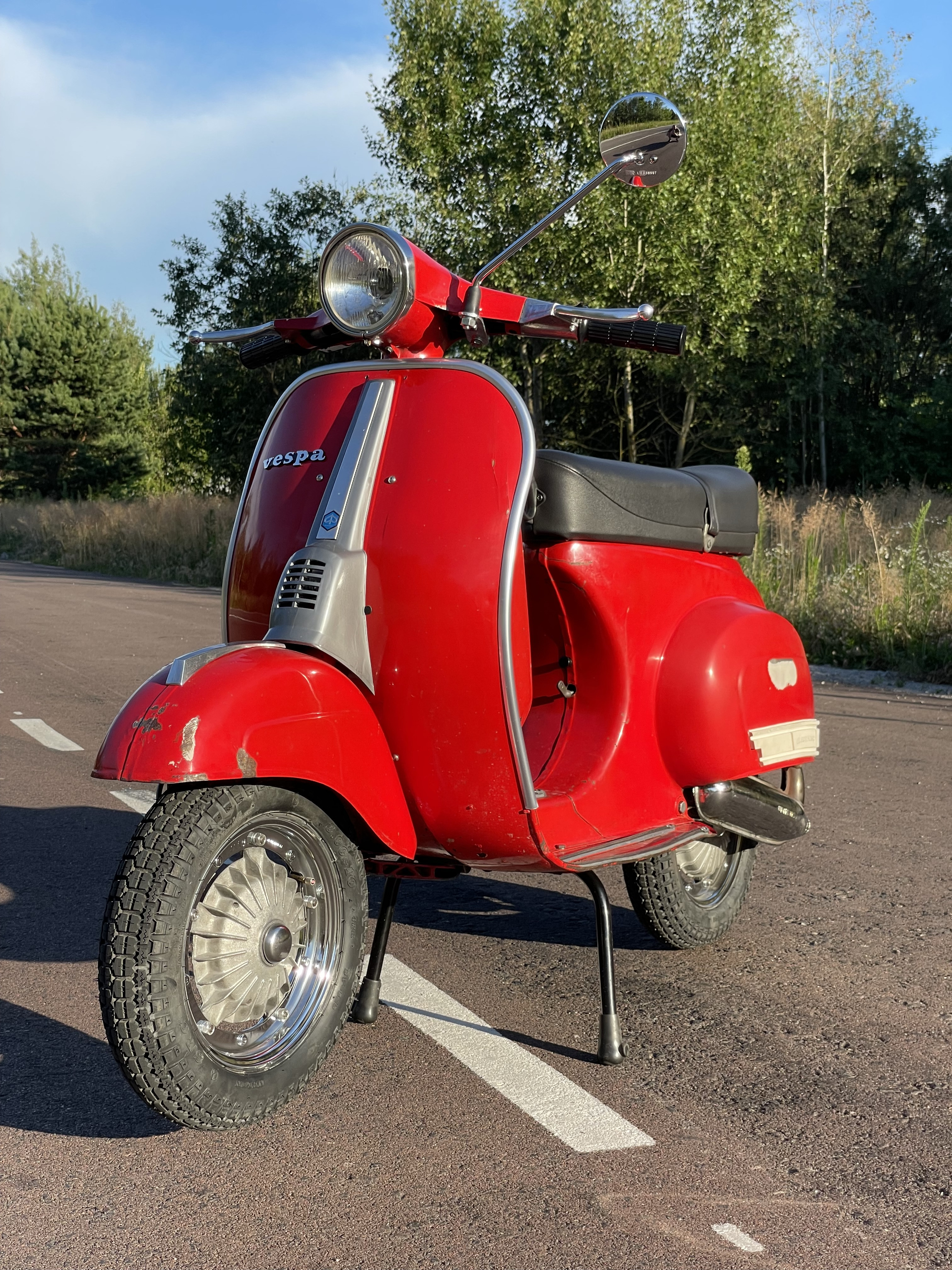

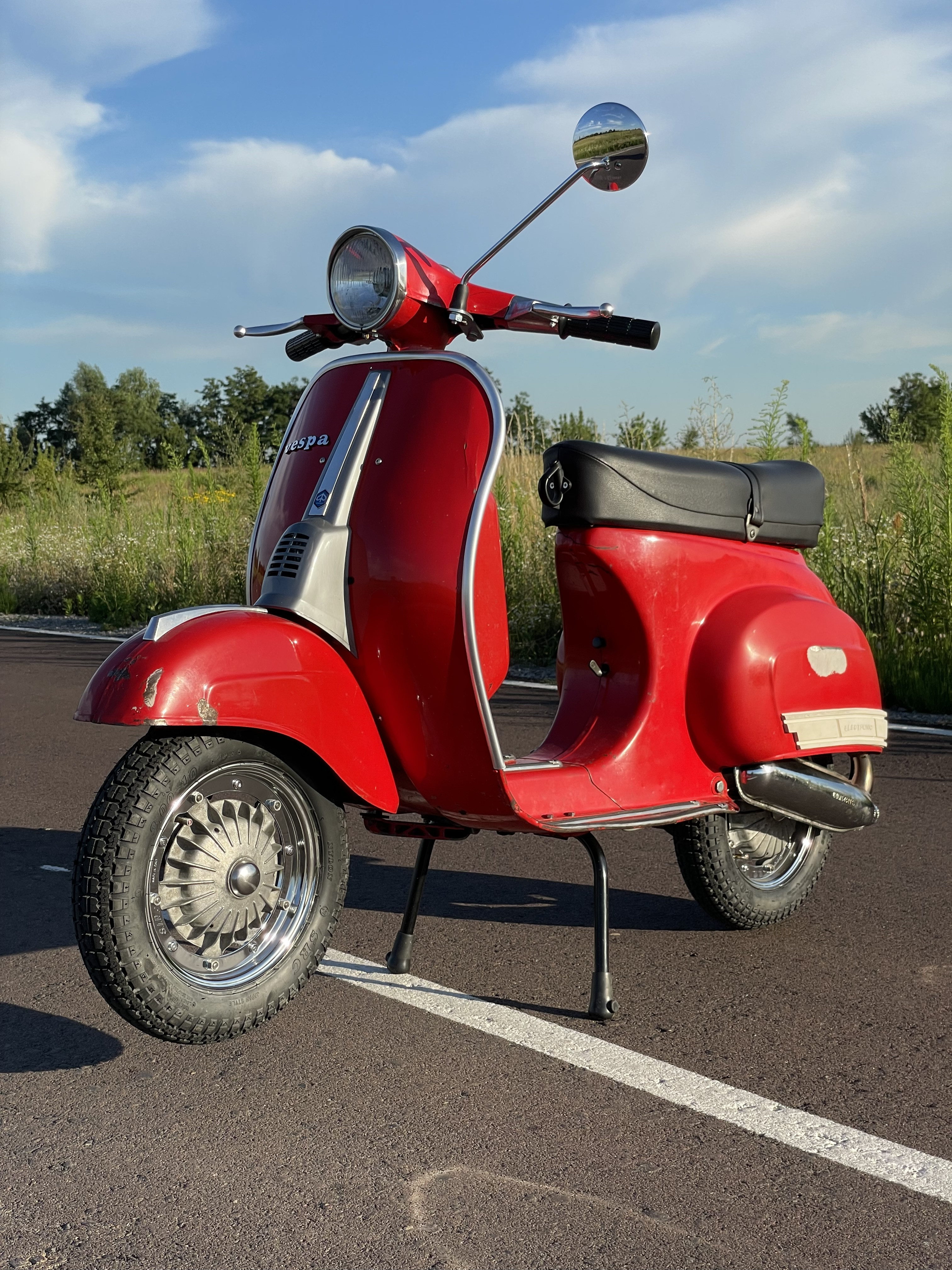

Happy to share first ride out on Primmy! Still have some questions about jetting, but feels close.
When I got it there was a 80 main jet. I checked manual and it say 74. I have no 74 so threw in 75. Riding terrible but I couldn't understand is it lean or rich. Tried 73 and all turns worse. Then went back to 80 and all turns better. Not perfect. Will ride more to understand.
Still needs some adjusting but I already love this little red. I never ride Primavera before. Yes it is stock and slow but it very smooth and it is special fun. I even don't want give it back to customer.
Later I will make more detailed photos.
