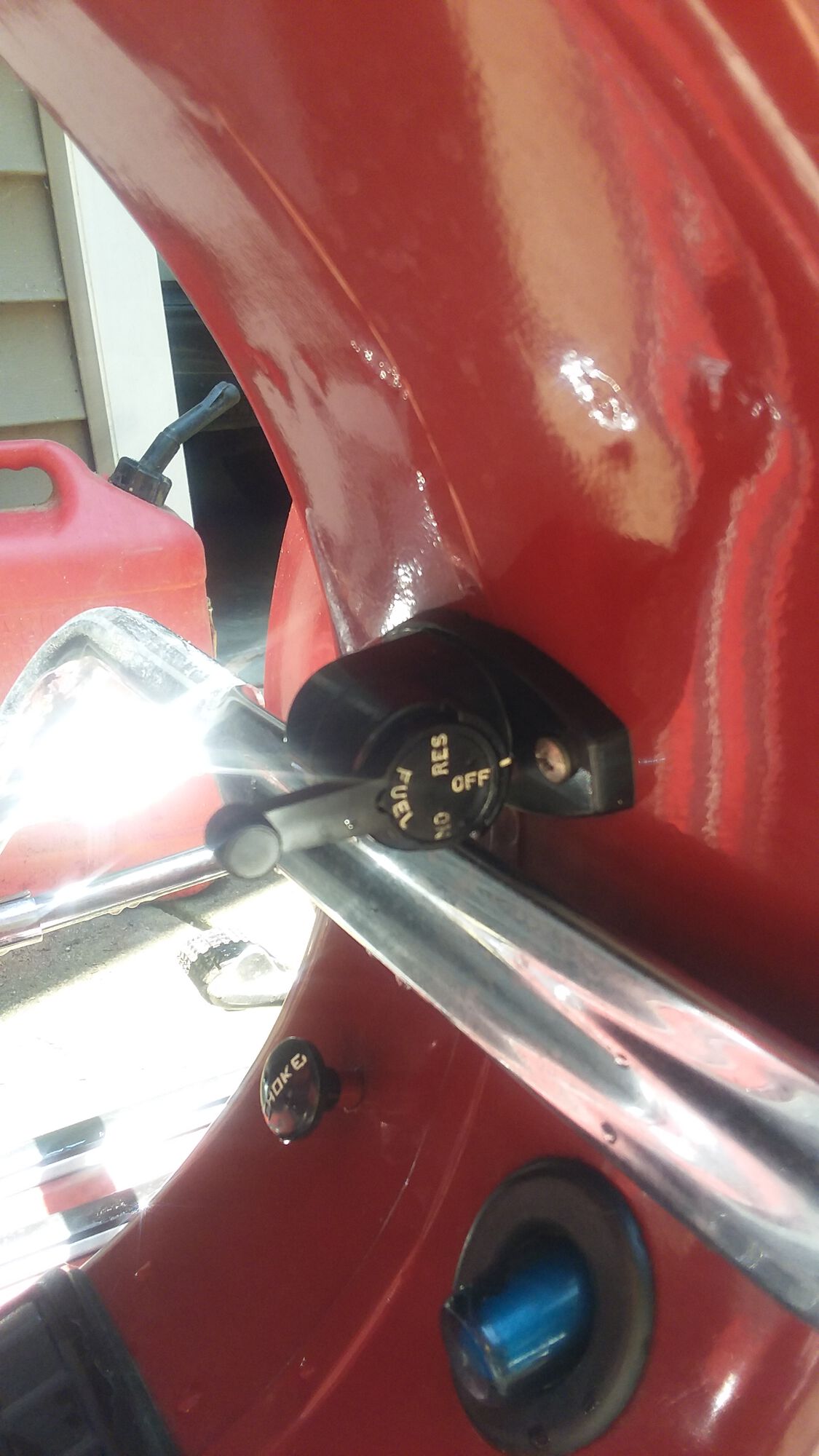

I mentioned this scoot in the ongoing thread: Today, I.... but I thought I would start a separate one. Anyhow, so I picked up 1980 P200e today. Probably the nicest one I have ever seen. Big bonus was not having to drive the usual 2 hours one way as it was a 1/2 mile away. My son and I walked over, pumped up the tires and pushed it back home (that will never happen again!). I gave it a quick wash and gave a quick once over. I have spark! Gas tank was drained but has some white dust in it, The fuel selector is stuck and I know I'll break it if I screw with it. The fuel line is hard as a rock and lastly, the 20/20 carb needs a deep clean. It is soaking now and I'll get back to it in the morning after chores. My first question: This carb jet set up as follows: 50/120 idle jet and the jet stack is 118/BE3/160. Does this make any sense to anyone that has a P200 with this carb? Also, does anyone recognize these cowl protectors? Here's some pics:

that's a reasonable jetting for p200 with 20.20.
looking great. that chrome shines hard - it's making it hard to take a photo!

The selector I'd figured I would most certainly break if I force it. And a pic of the cowl protectors from the back.
fragile looking thing

Be very careful with that fuel tap. They are unobtanium and that one, other than being frozen up, looks to be in excellent condition (just like the rest of the bike).

Such a lovely bike! If you remove the plastic housing on your fuel tap lever, you will find a keyed steel rod poking out that you can safely work on to try loosening up the tap.
Mercado has the stainless conversion plate if you'd prefer to use a traditional one piece metal lever rod and put the fragile plastic one on the shelf. https://www.scootermercato.com/Scooter-Parts/Fuel-Taps-and-Parts/FUELCONV

That's the plan. No way I am going to even try using the plastic tap. I'll flush out the fuel tank and try to work the on the petcock as you mentioned. finish the clean up on the carb and get it fired up. Then come up with a list for Scooter Mercato.

Removed the tanks - Oil side is all good, even the line, but I'll replace anyway. The gas tank is a bit messy but no rust. The petcock vent tube is split bad, no saving it. I removed the US fuel selector and put it in a box on the self. Even with a new petcock working smooth, I'm sure I would break it. Making out a long list for Scooter Mercato. If anyone is holding a 24/24 carby, let me know. I may go it that direction instead of the 20/20.
