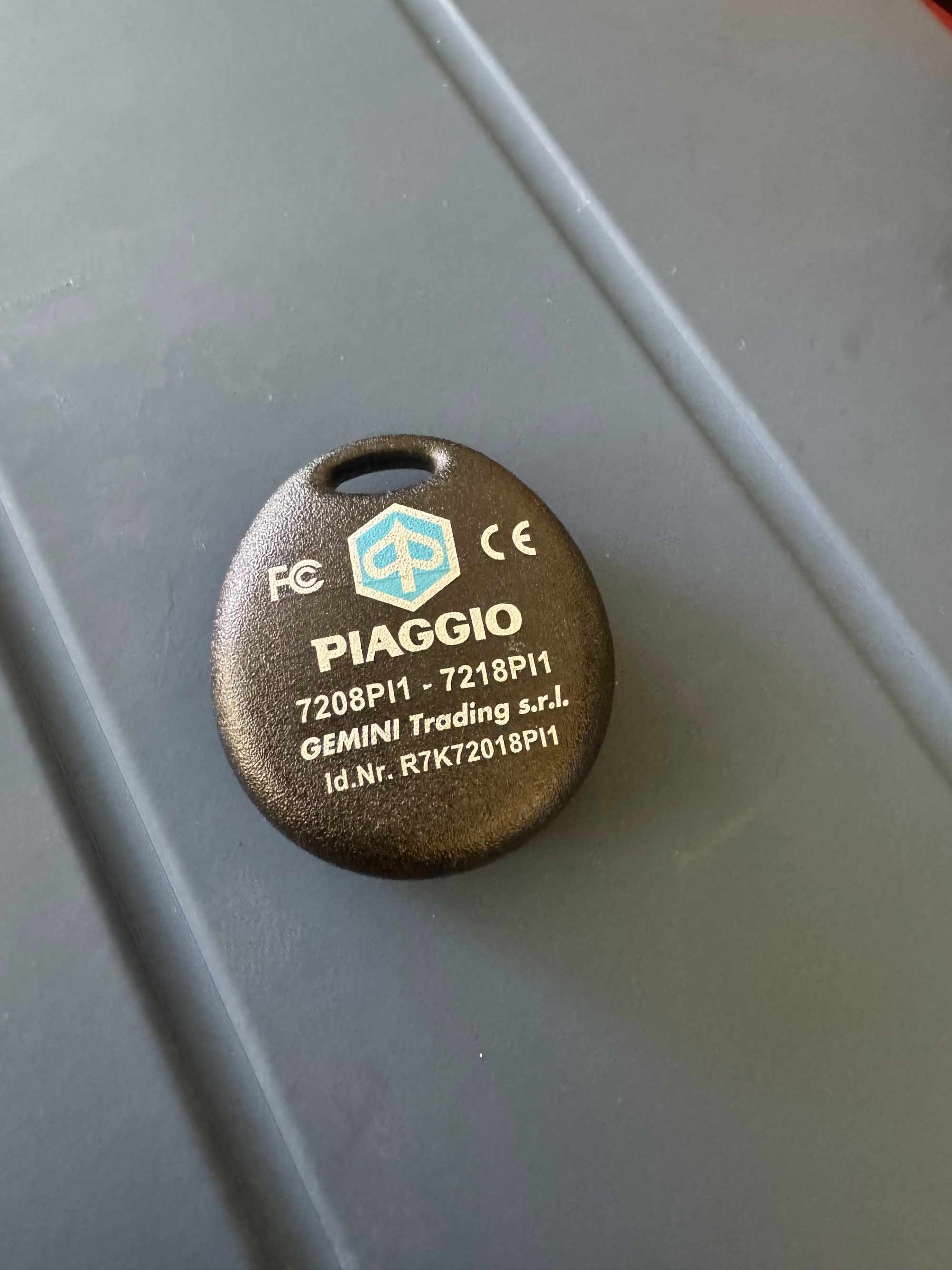

I purchased my first Vespa, an '08 250ie that has the Piaggio arm. I picked up a new remote from eBay Piasggio 78208PI1-7218PI1. I cannot find a website describing how to pair the remote to the alarm. In the meantime I just use the manual two prog device on the keychain. Can anyone assist?

72018PI1 Remote Control Transmitter User Manual Gemini Trading s.r.l.
https://fccid.io/R7K72018PI1/User-Manual/Users-Manual-445298
is this the manual?

I hope one of these manuals will help:
https://manuals.wotmeworry.org.uk/Alarm/

Thank you both! Sorted, the second link's sequence worked a charm...very happy.
