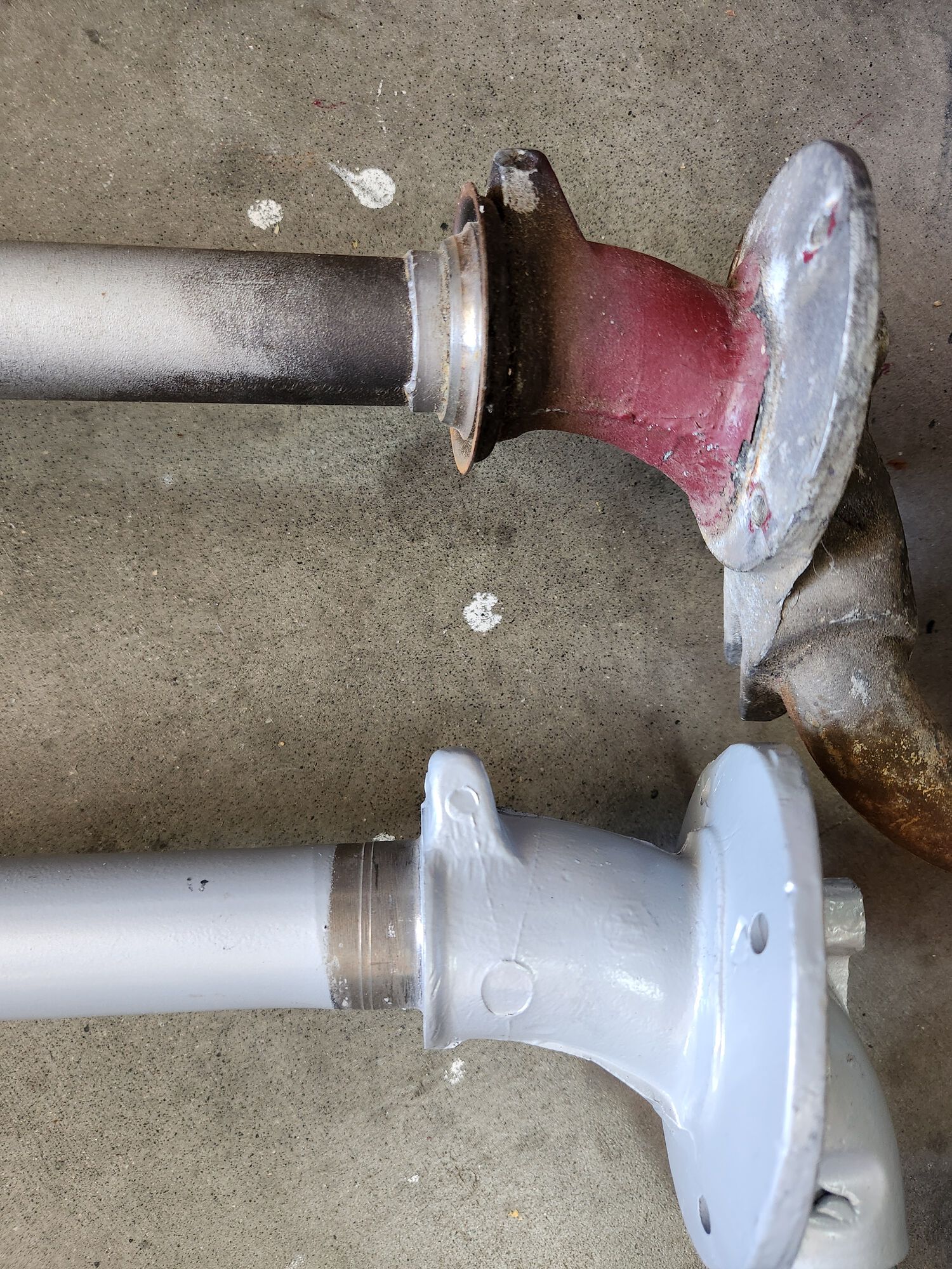

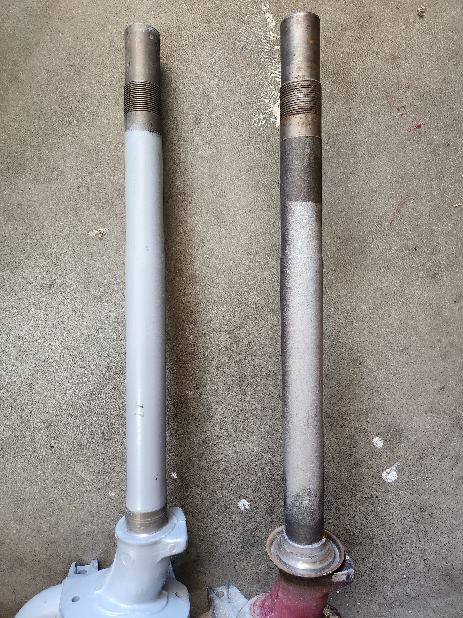

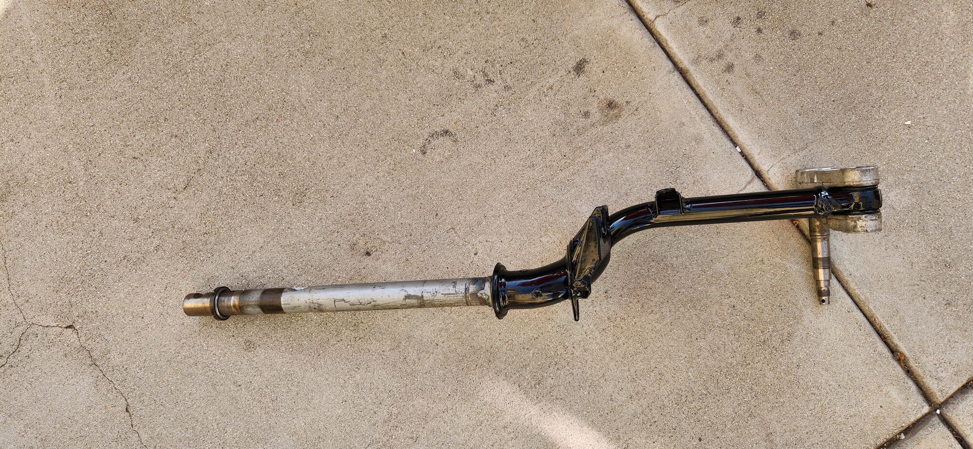

I forgot to add a photo.
I have three froks. no clue how I got three... All are 390 mm length.
Two are freshly powder coated gloss black, one is a metalic red and the stops were cut off for a some custom job..
All are 20mm axles
one is still fully assembled and on the bike so I could sit there and scratch my head staring at it.
