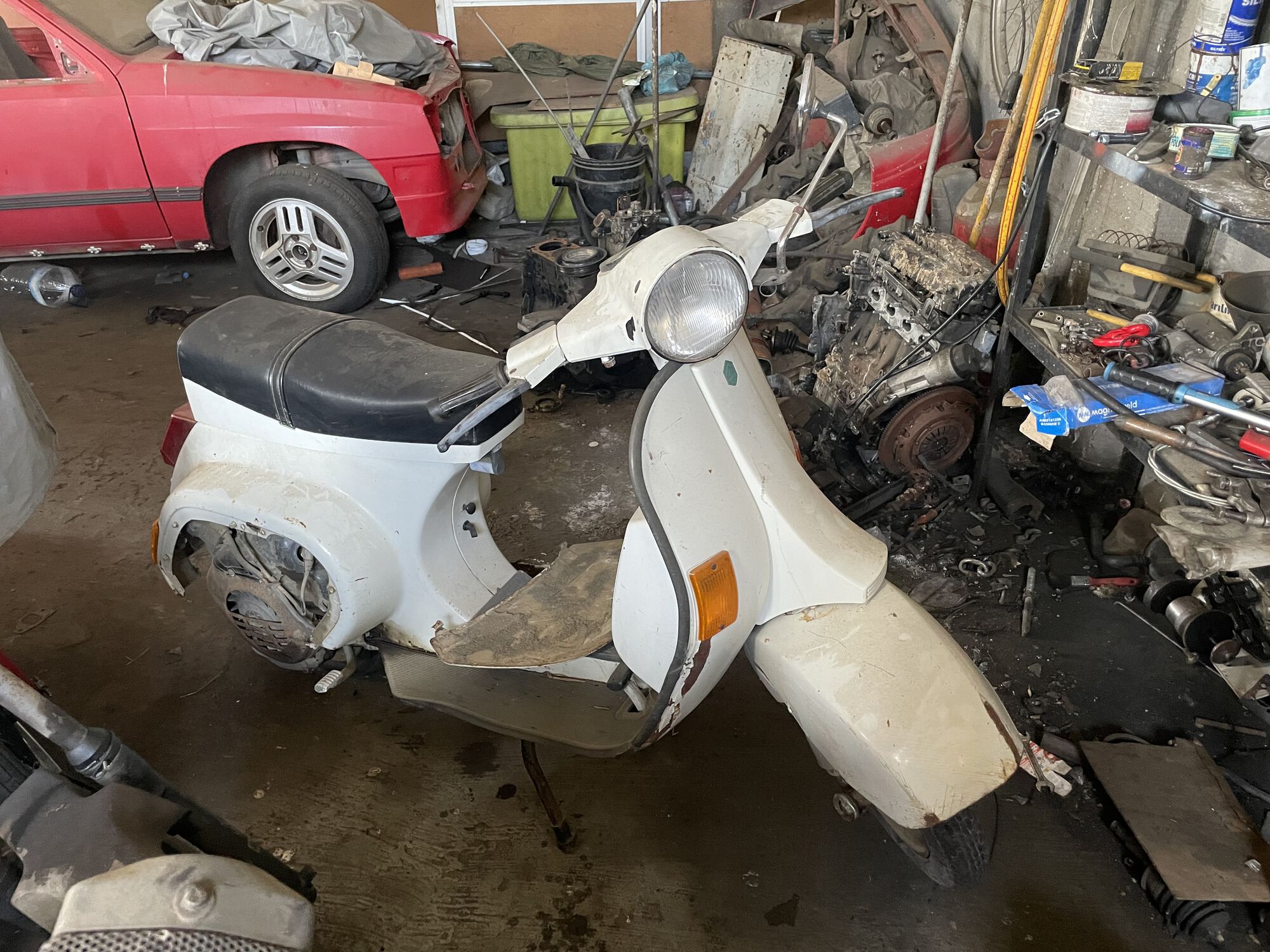

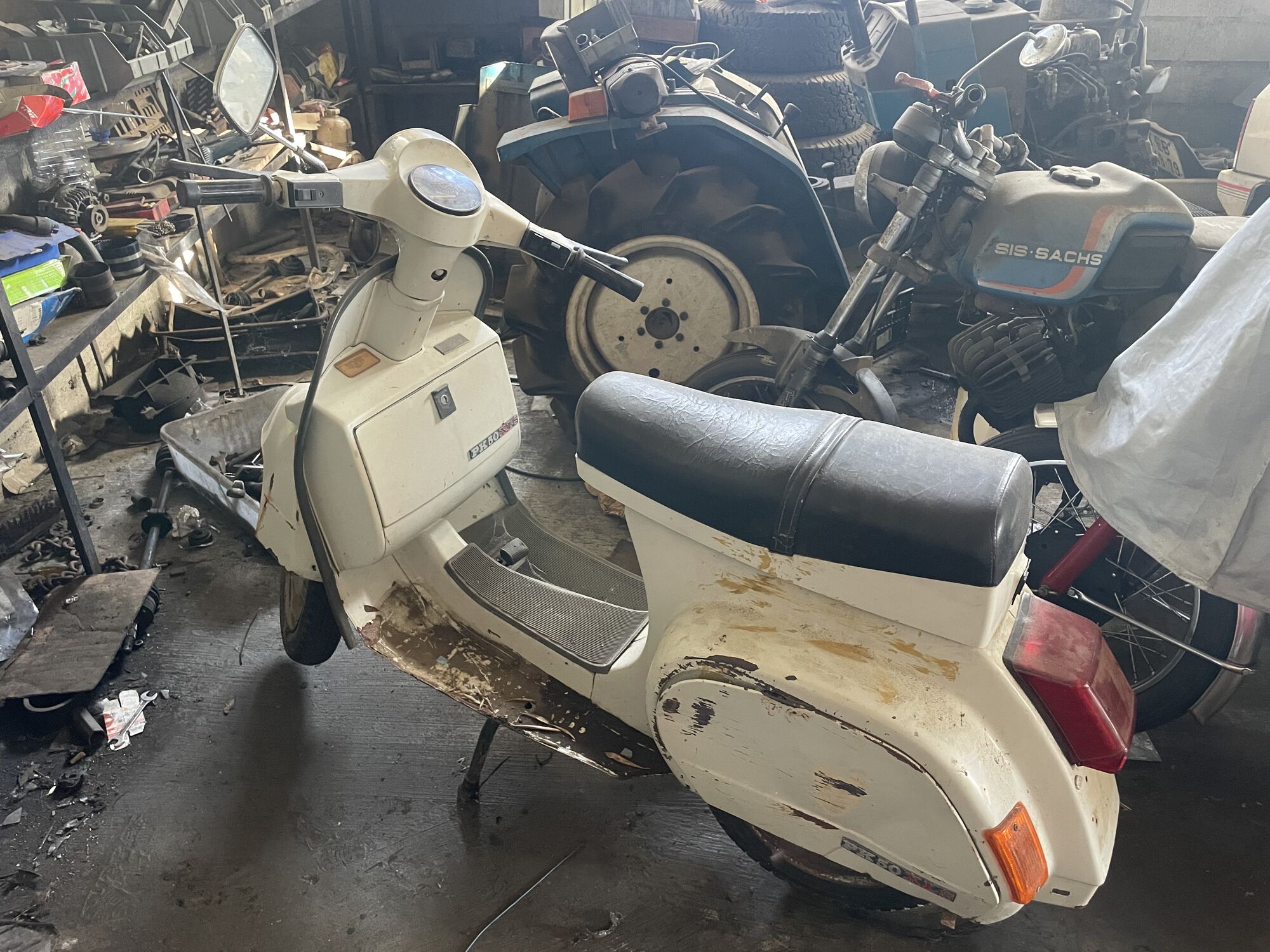

Hey Folks! New to the scene here.
Have a Vespa PK 50 XLS (V5S2T) from 1986. Rode it through the forests here, but ever since the wheel bearing on the rear wheel got loose, it has been put aside until I had the money and time to fix it.
Now that I have the time, the plan is to restore it! However, I can't seem to find a manual to restore it, anywhere! Not even in online stores: it seems like it doesn't exist...
I sent an email today to a gmail that was in the official Vespa Website, but until I get a response (which I doubt I'll get one because it's a weird email [?]), I humbly ask for help from you all:
Where can I find it and buy it Crying or Very sad emoticon Crying or Very sad emoticon
Meanwhile, here are some photos of the lady Razz emoticon
Cheers everyone!
