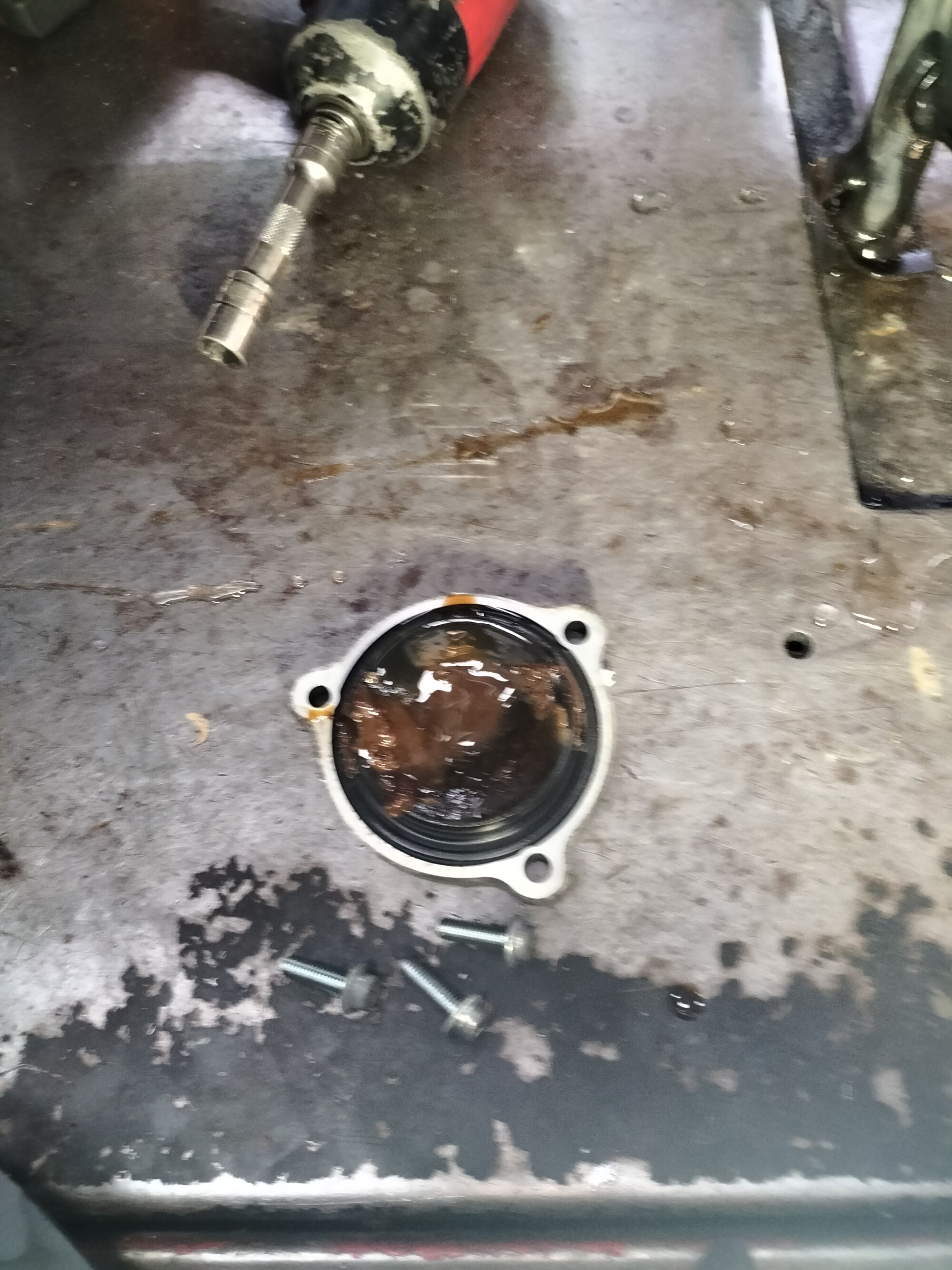

Hi, I was at the mechanic and he opened it up, it turned out to be the bearing, it is damaged and it allowed water to come to the compartment and that caused the water, see the pictures attached and the youtube video,
please provide your comments,
Link to video: https://www.youtube.com/shorts/jtBXOlag3W0
thanks
Pic 1
Pic 1
Cover
Cover
Pic 2
Pic 2

Hi, yes it is the same issue, and I think yours is just starting out, you started hearing just recent. This is the sound of metal on metal. The dealership changed a seal and the bearing, the seal is behind the bearing as I was told and that is why the water leaked in. It took time to fix as some parts were ordered from overseas, but I guess in the USA there will be more supply of the parts, so I don't think you will face this delay. My recommendation is don't ride it, and wait until it is fixed, I did not really ask the mechanic but I guess metal on metal will have a good outcome in the future if kept ridden. I think this issue is with the TMax scooter, as the mechanic he did the same work for other customer, of course the same issue. How much have you done on yours (Mileage or kilos)?
