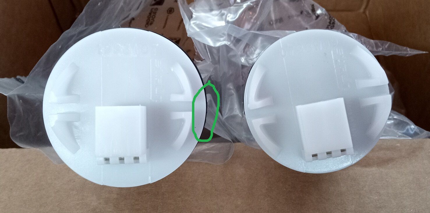

CM086809 is the current part number of the sending unit with the smaller flange, that is a replacement for the sending unit used in the GT 200. It is the unknown direct replacement for CM025709 that has not been available since December 2019. Indeed, this photo I just took might be the only evidence that it still exists in the wild. It is not usually associated with the GTS or GTV. But the 2006-2007 US Market parts catalogs for all three scooters list CM025709 as the fuel sending unit, which is likely an error on Piaggio's part.
Here they are side by side. You can tell which one you need by comparing them. The smaller one is about 2 inches across, and the larger one is close to 2 and 1/2 inches across. CM0257073 is the larger one and CM086809 is the elusive one rumoured to be extinct since December 2019.
