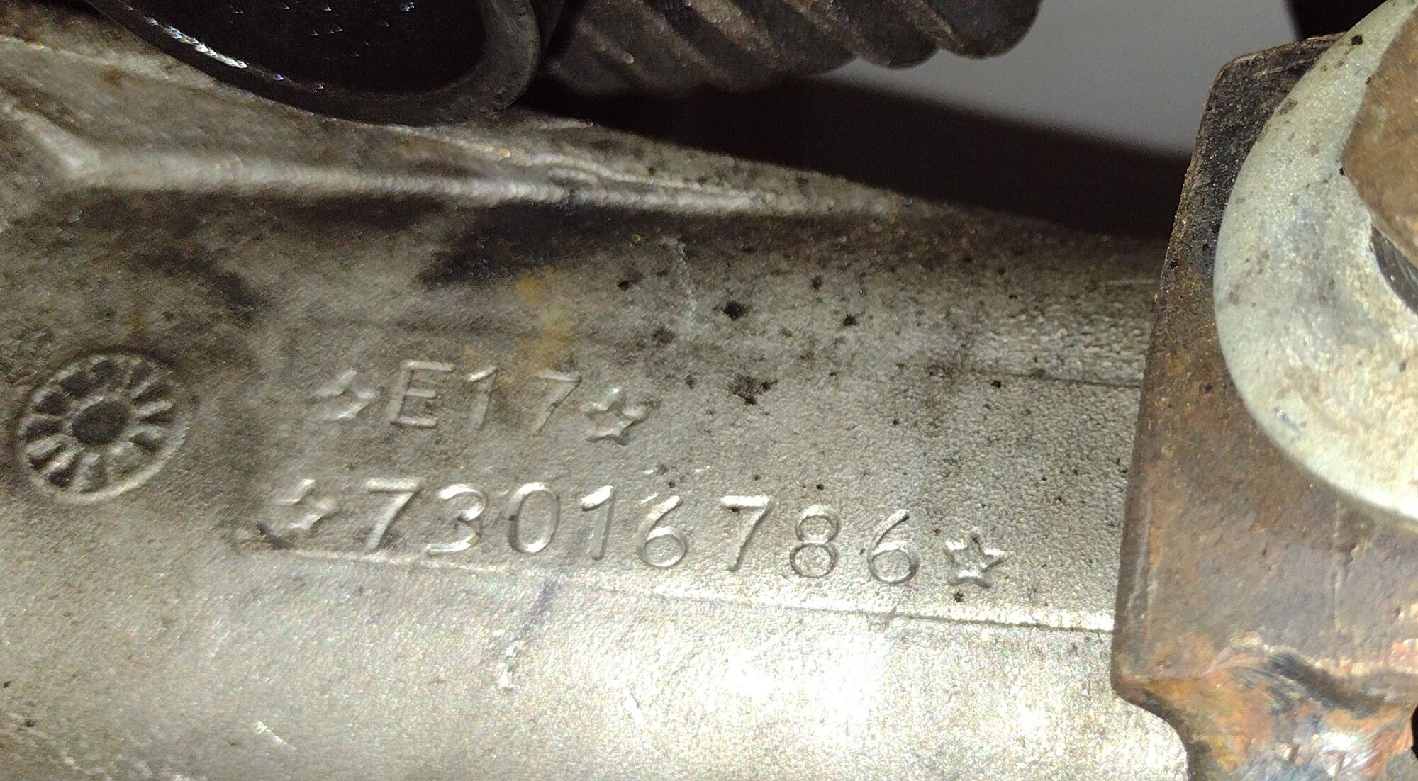

I should try to find the info - I run an LML in my Super... Do any of you LML experts know more, and how to date the motor from the serial number? I do drive my Super gently, but would like to know what I have.
The serial number is preceded by E16JR all on a single line.
This motor came installed in my 125 Super, I know nothing about it other than it runs well w/ lots of stock power except Sito+ and usually starts one kick - it has NEVER quit on the road.
The serial number is preceded by E16JR all on a single line. This motor came installed in my 125 Super, I know nothing about it other than it runs well w/ lots of stock power except Sito+ and usually starts one kick - it has NEVER quit on the road.

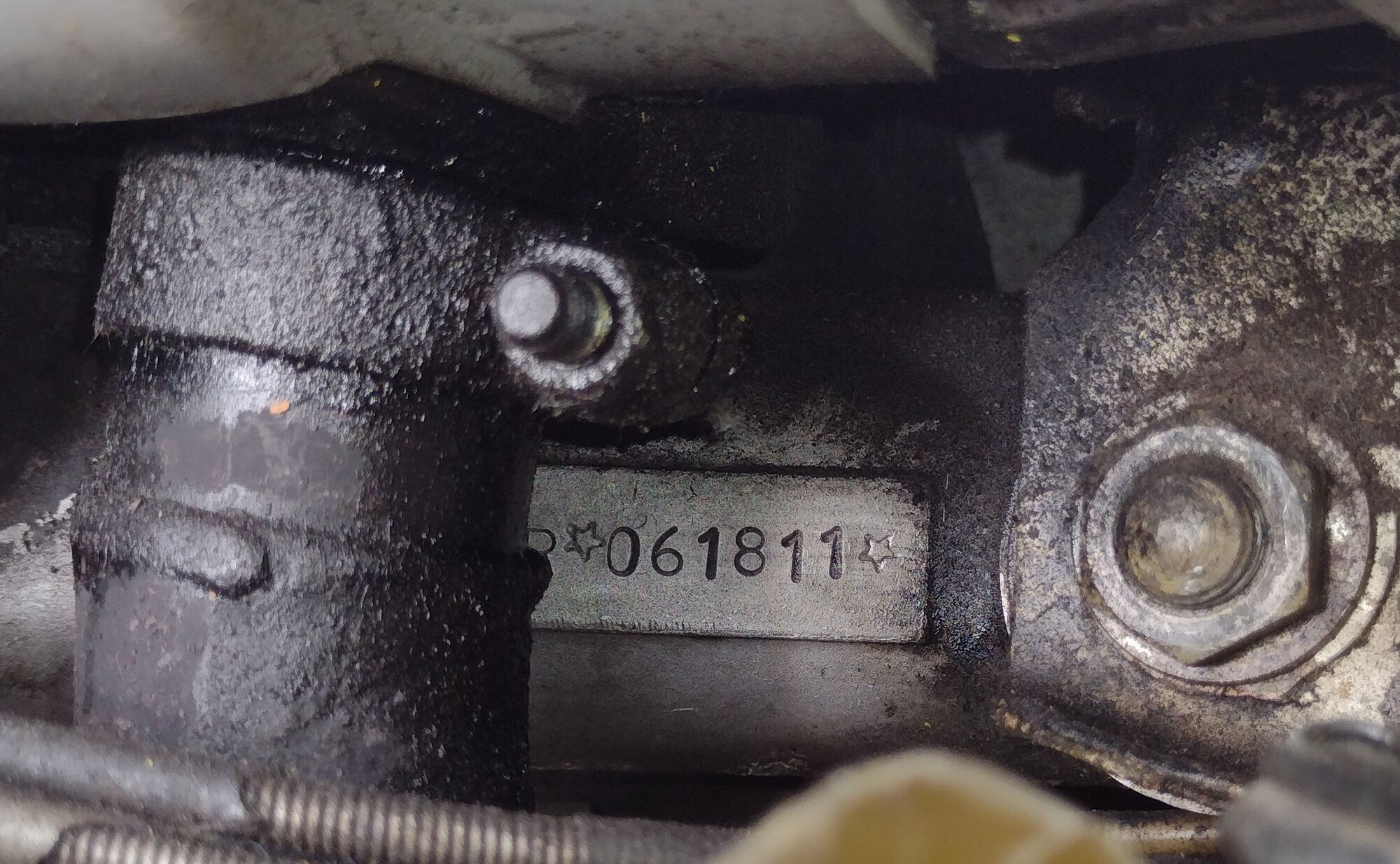

This motor is newer, came low miles from a new Stella about 2011 when it upgraded to P200. It has auto lube & electric start , let me know if you are looking for one.

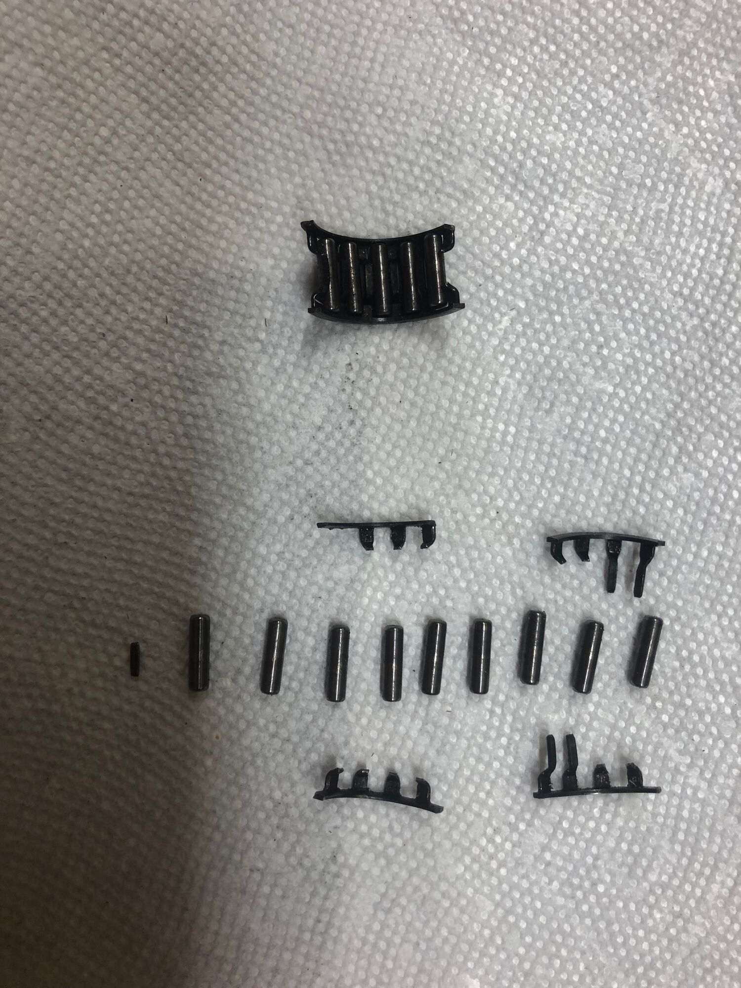

My crank failure occurred on a 2008. I have heard many references to failure and general poor quality of Stella cranks. If you had a high mileage stock engine with a Piaggio crank, it would still make sense to replace or at least evaluate the crank if adding a kit. Cranks can be rebuilt, but it seems to be cheaper to replace them, at least with Vespas.
Stella/LML bearings are also mentioned as being lower quality, but you would probably be replacing those too.
