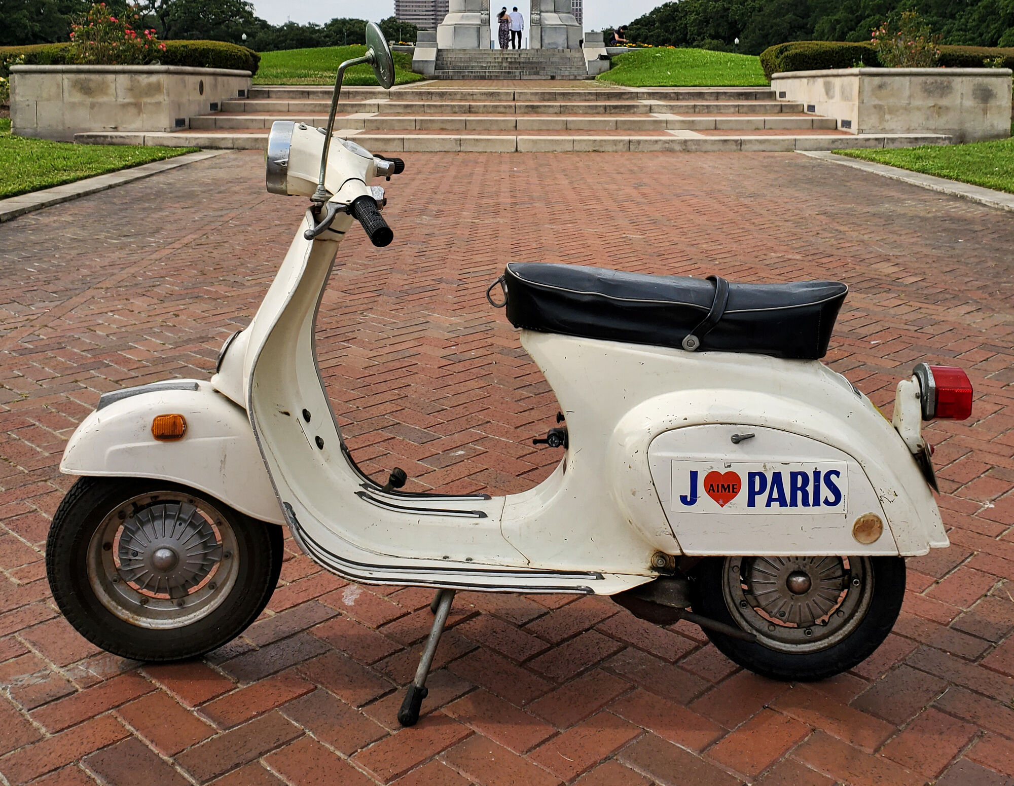

My Vespa 50 Special blows the taillight at high rpms. I can replace the bulb and it works fine until I ride fast - then it blows the taillight. The break light works fine and does not blow. I replaced the entire taillight assembly and still have the same problem. any thoughts? Many thanks for your input.
Cheers,
M. Daleo
