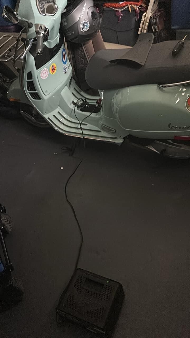

I was in a hurry and had a careless moment, leaving the ignition knob turned to the right on my 2023 Vespa GTS, went to ride this morning and it was dead.
I have had it on a charger for 2 hours and the immobilization light and seat lock have enough power to work.
Two questions:
1) How long should I leave it on the charger?
2) We have bad thunderstorms and may not be able to ride after I take it off the charger, will that be an issue?

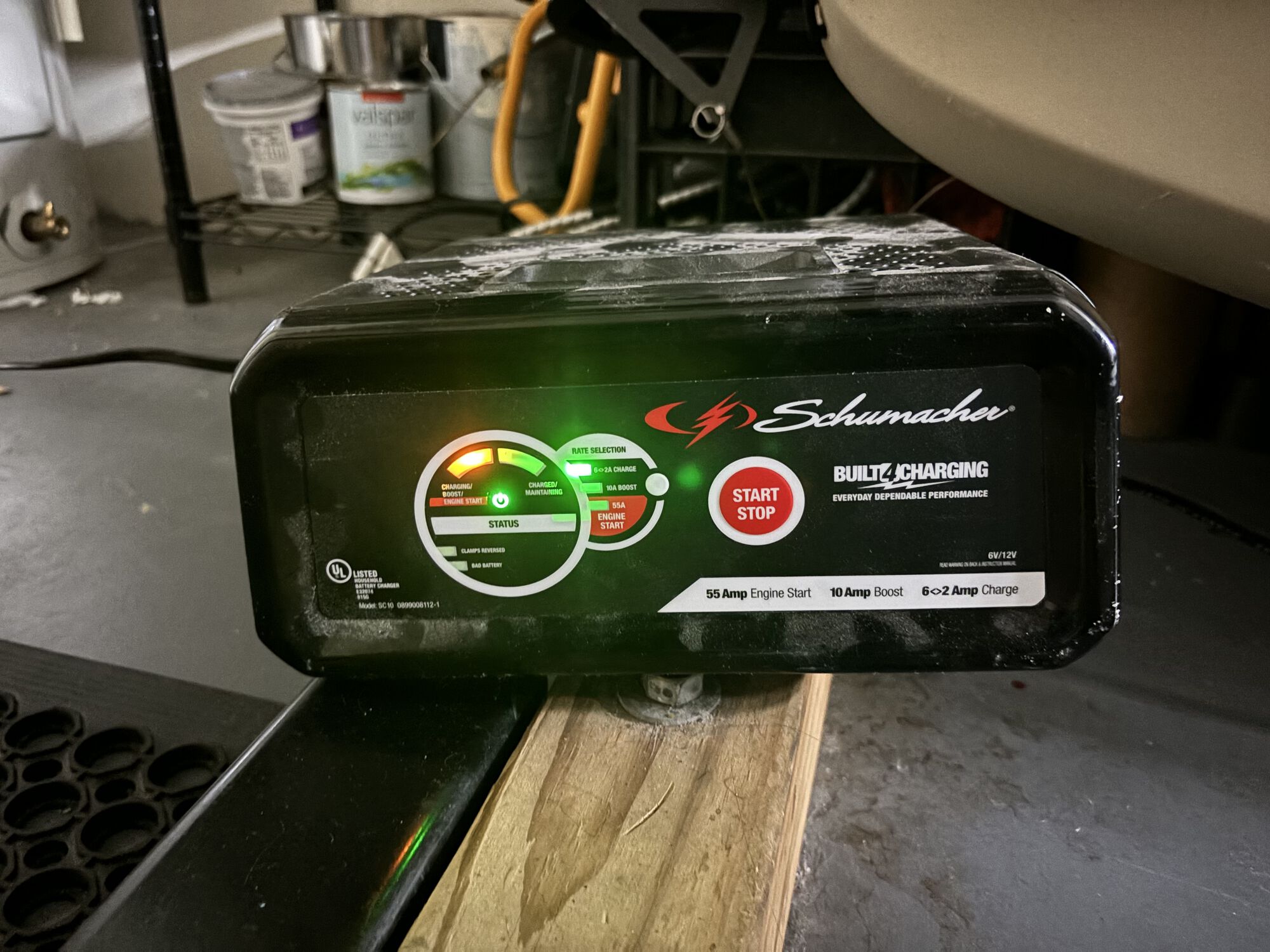

that charger does not look like a smart charger and I would not recommend more than 5 hrs on it. looks like an automotive 2/10 amp straight charger.
Without knowing the device pictured: I can't imagine that anyone would still use a charger without a protective circuit, but if that is the case, you are of course right.

This is the charger I am using
You charging at 6v and 2 amp? On a 12v battery?
"6<>2A"
I didn't see it as that - it automatically goes between 6A and 2A, that's bulk charge and maintain, and will drop to near 0A when it determines fully charged. The voltage selection is automatic. That's OK for a 12Ah m/c battery as well as a car battery.
Not knowing anything about that particular charger, I'd interpret that as 2 to 6 amps, constant voltage rather than constant current. I agree with OAD that it's not a great charger, and Noco does indeed make some really nice ones. We use a different Nico Genius model on the airplane - it's got a roughly scooter-size 12V 18AH SLA battery.
