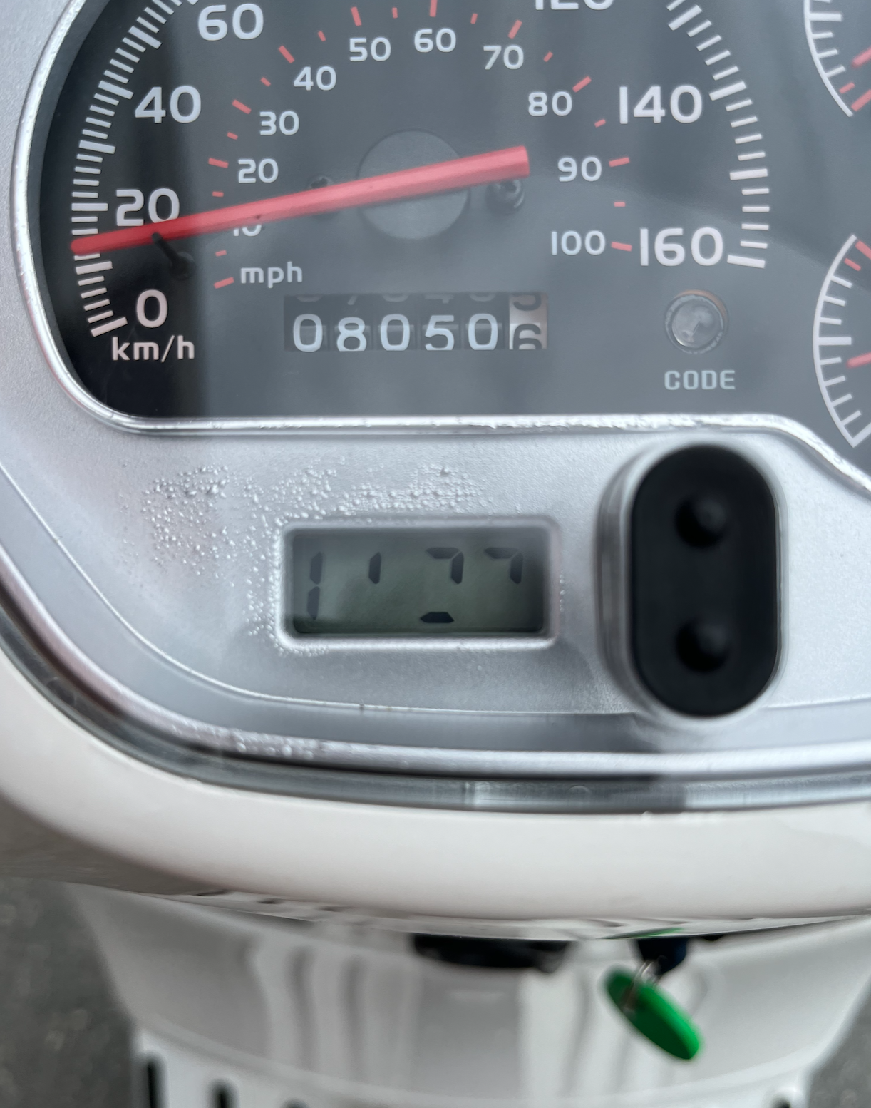

The clock in my instrument panel was not dead when I bought the scooter.
I read there was a battery in the instrument so I suppose this was the fault.
New battery came in the house and late in February I demounted instrument panel from scooter found a YouTube video about how to change battery and did that. Clock start working again, I mounted instrument panel back and adjusted the clock so it was right.
Scooter is parked inside a warm garage the whole year. it's approx 10 degree there. I checked the clock some times in march and every thing was good.
When I started up for first drive this season the clock was acting strange. No hole numbers.
so is it just to get a new battery and change it again or is it something wrong with the instrument?

Not a battery problem. The cheapo LCD panel has come away from its connecting pads on the circuit board behind. You *might* be able to persuade it to re-connect, but I'd cut your losses, remove the battery, and if you must have a clock onboard, stick a cheap LCD watch on the headset with some Velcro.

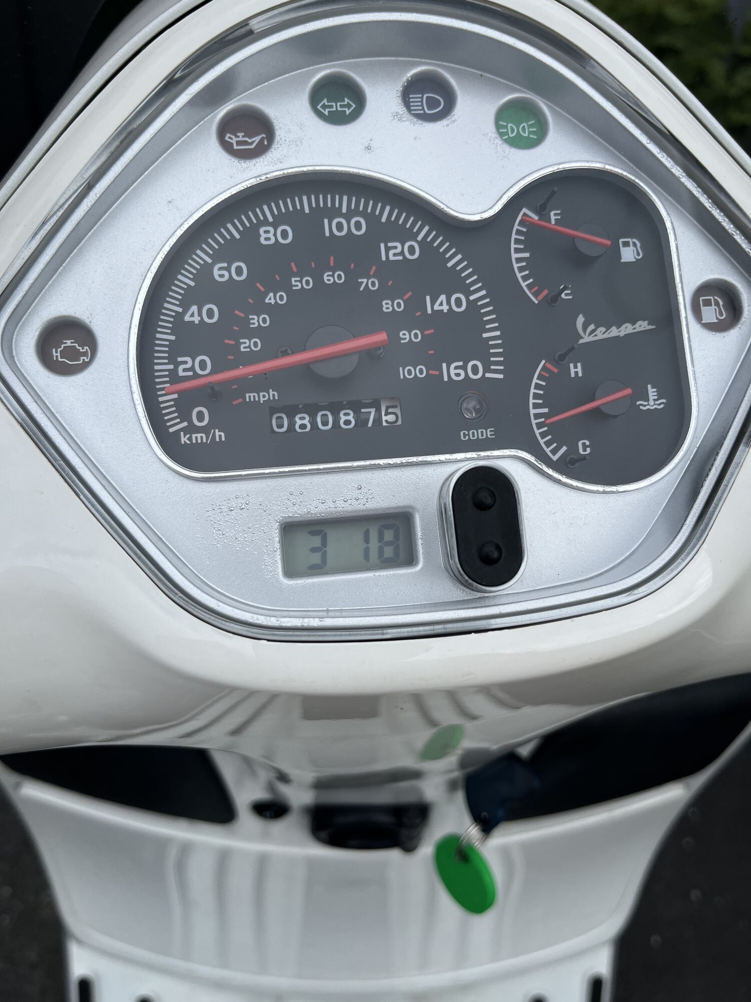

My scooter has been parked about 10 days without been used. Today when I started it up the clock was working
