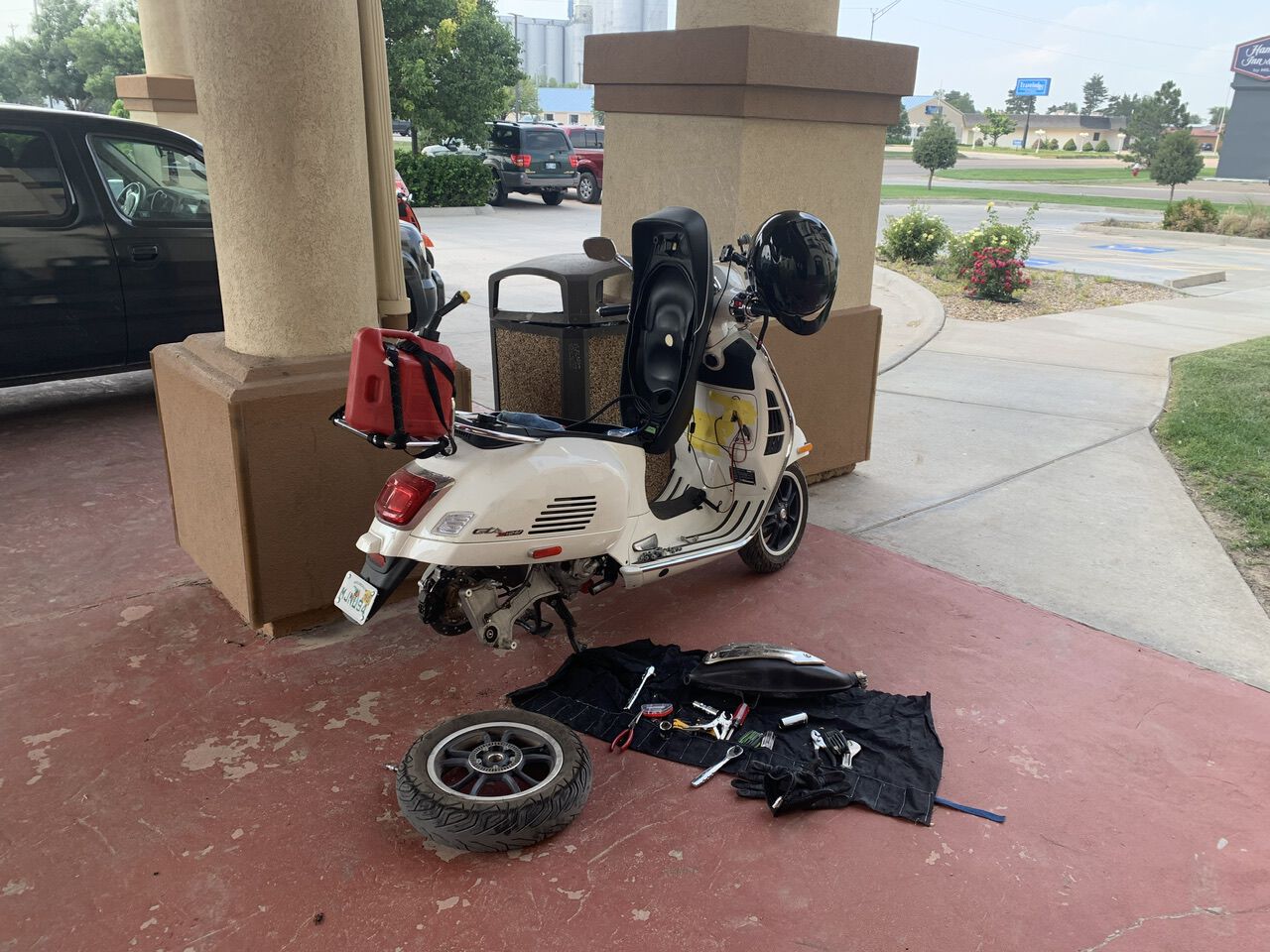

For the Cannonball I rigged up a hardwire solution.
I didn't want a direct, unbroken connection, so I used an SAE connector coming out of the battery box.
Then I could disconnect it when not in use.
I taped the wires to the glove box panel to keep them from blowing around.
When I got home I disconnected everything, now using my Garmin XT with the power cable plugged into the back.
Bill
You can see my professional wiring in this photo, the night I had to change a tire in Oklahoma.
