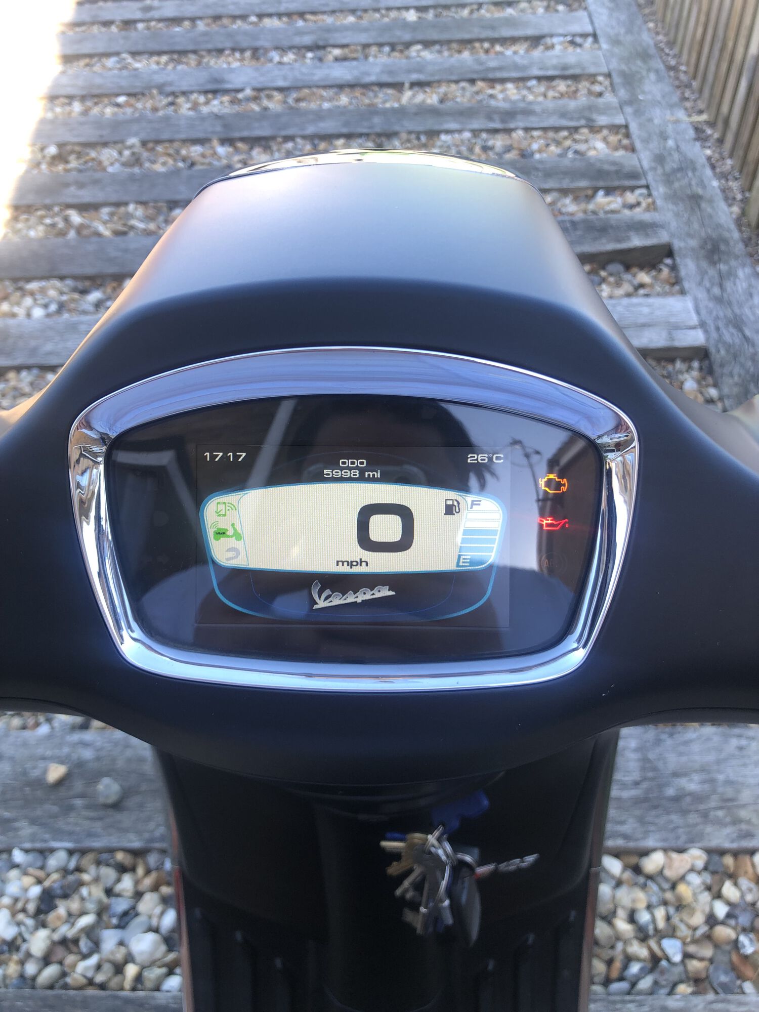

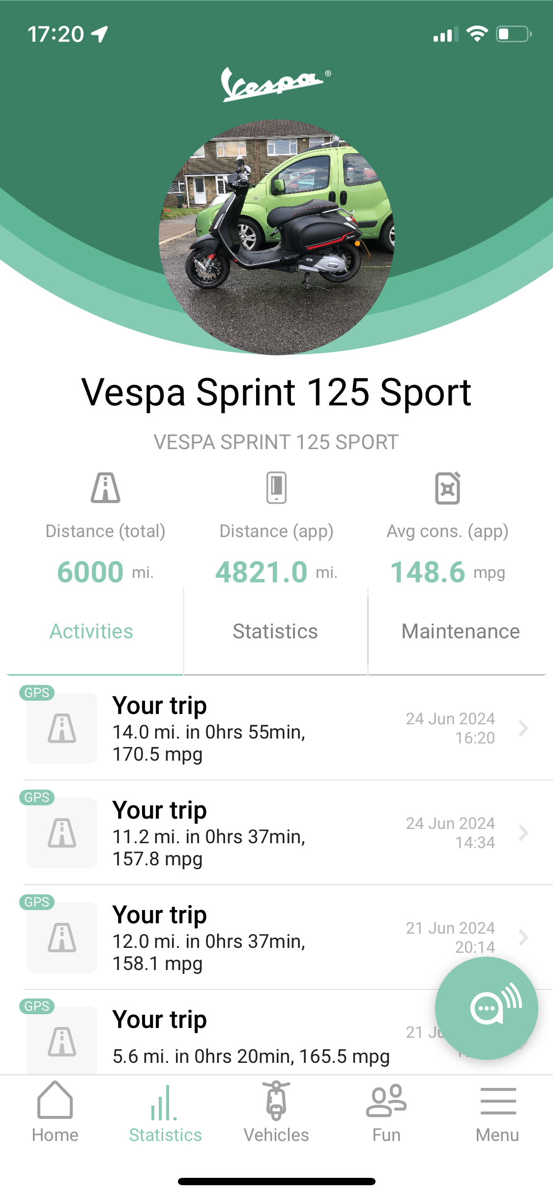

Found it curious that the total miles displayed on the Vespa app doesn't match the total miles travelled by my Vespa odometer.
Turned on the Vespa and reconnected a second time, and still showing 2 miles different…

ok, I dug into this for you. App bug unsurprisingly.
the app is receiving the odo value from the bike as miles*, ie 5998. It converts this to kms using 1.61 which is 9656.78km and then stores it. At display time it converts it to miles using 0.621371 giving 6000 miles.
PS, even worse for some bikes it uses 1.60934 in the first step which correctly becomes 5998 when displayed.
* this is poor design of the tft module + pmp protocol that if well designed would always send an accurate value in a consistent unit and kms are more accurate then miles. Hmm, looked further and on some models it is always kms and on some it sends based on the dash display mode.
Facepalm emoticon Facepalm emoticon Facepalm emoticon Facepalm emoticon Facepalm emoticon

More importantly, that is some seriously impressive MPG figures.

Bear in mind that those MPG figures are with the UK gallon. So, about 119 MPG here with the US gallon, but still not bad at all.

Well for the mpg on a Primavera in the app:
pre - Euro 5: the injection timing and rpm are retrieved from the ecu and mashed together to create litres/hour.
Euro 5: the throttle and rpm are mashed together (using different consts for a 125 vs 150) to create the litres/hour.
The litres/hour is then mashed with the speedo to create kms/litre which is displayed in the users preferred units.
Of course such estimation ain't gonna be perfect ...
Bonus comment: the app does check if the phone's regional settings are US or not and uses US or UK gallons. No idea what the dashboard does for this distinction - does it offer the user the choice, too lazy to dig through the manuals?
PS for a GTS the ecu supplies the litres/hour directly. (injection timing is also avail but not used in these calcs)

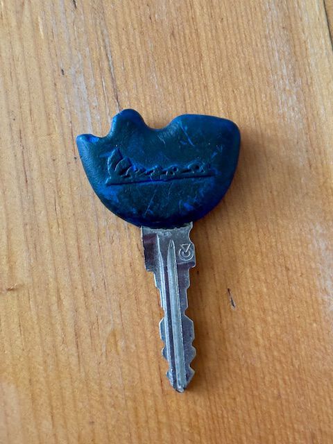

Tierney wrote:
I don't really know where your 2 miles are, but I was going to suggest you lighten up the key ring that has the Vespa key on it. This is known to cause havoc with the ignition switch after a while.
Thanks, I wasn't aware of this! I've decided to separate off my blue key now, and will either run it on its own or with a small single keyring to make it more visible.

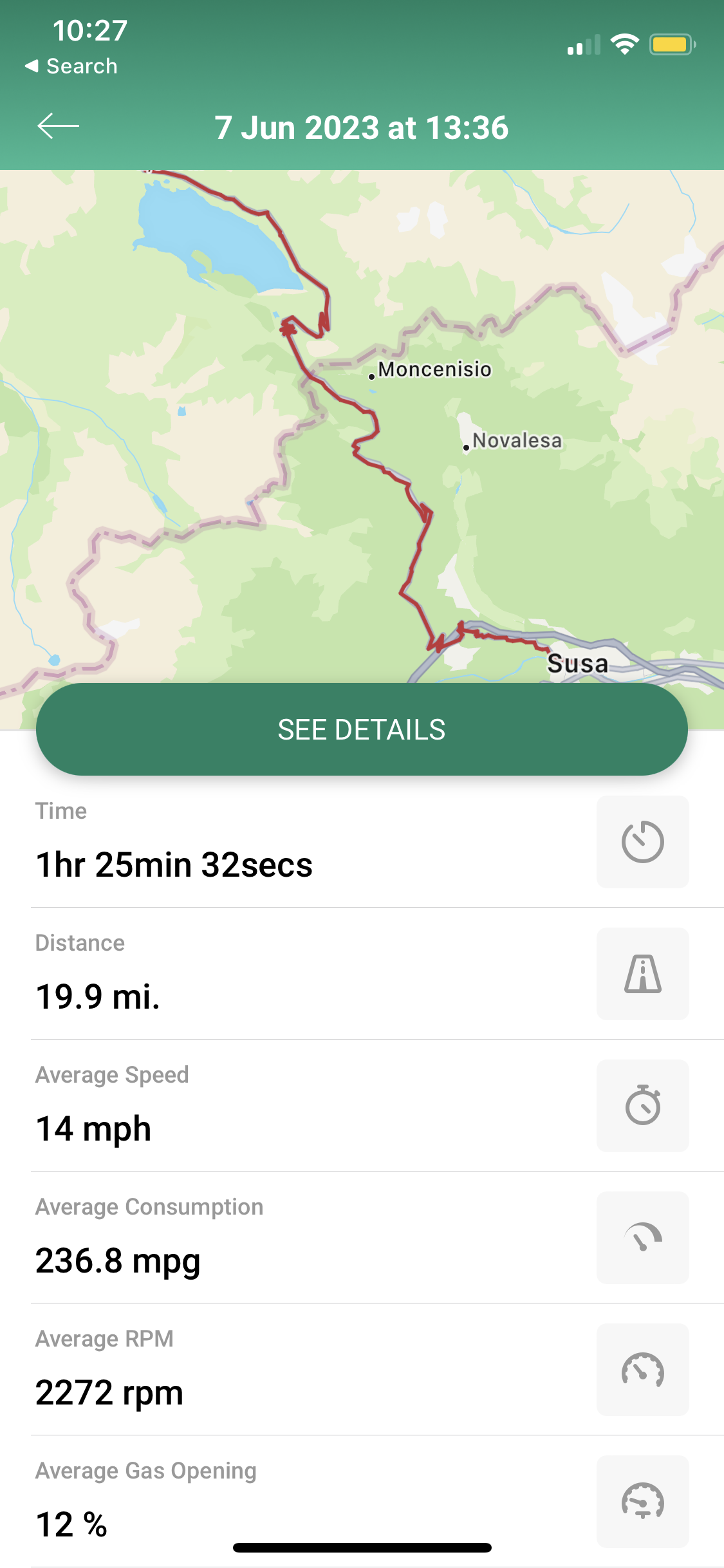

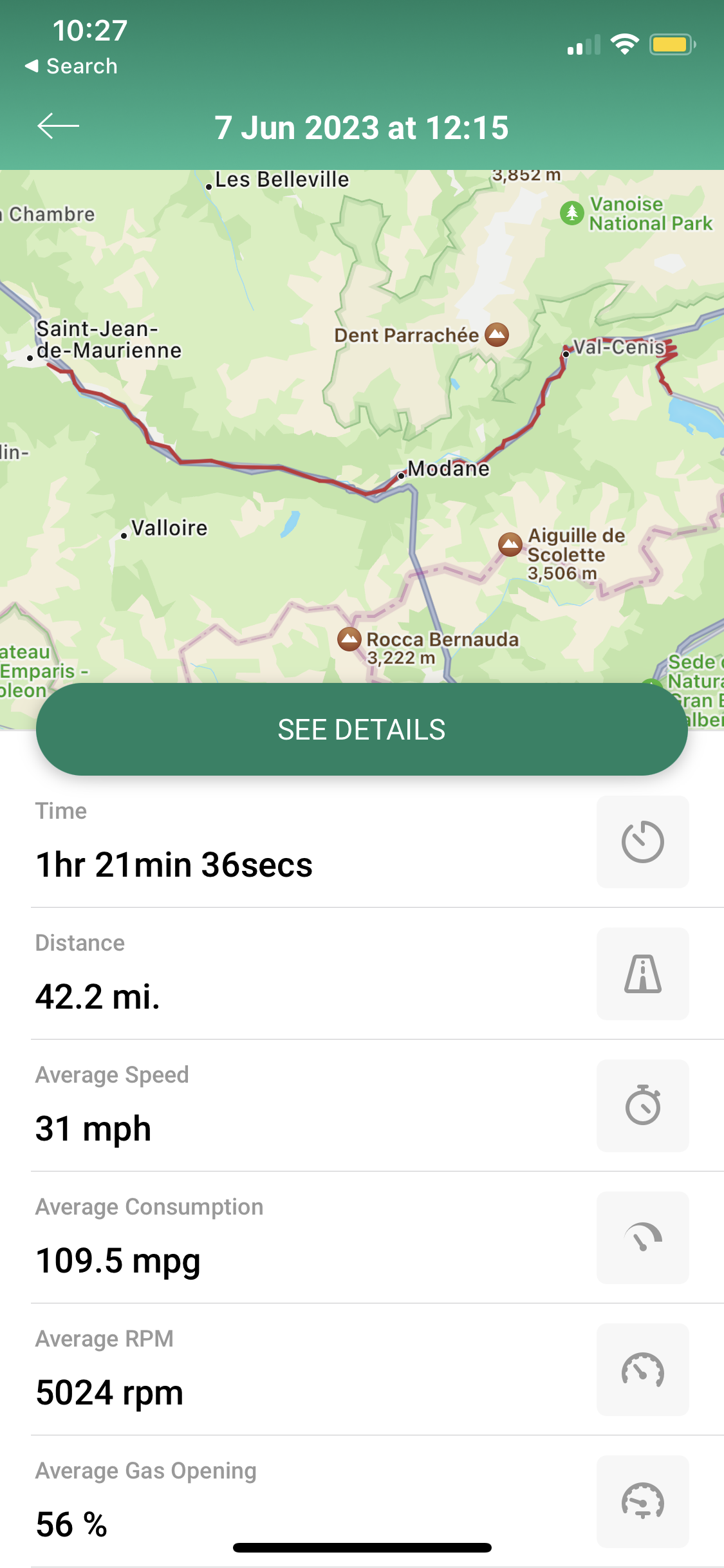

90% of the time, I always use full throttle launches. I found my clutch would get glazed with slower launches and would take a few weeks to clean back up again.
I think the key to the mpg has been that my favourite roads are 30-40mph roads as I'm a "big fish in a small pond". I can filter at traffic lights, and I've got pace to overtake.
I still do use some 60mph roads on a daily basis though. I top out at 60mph, but I've noticed that modulating the throttle and sitting at 50-55mph is much better for mpg than going full throttle for 20 minutes or so at a time.
My favourite two mpg figures were going over the alps into Italy. Big difference between climbing and dropping back down! ROFL emoticon
Climbing the alps!

Dropping down from the alps

jimc wrote:
Not only that, but the hole in the Vespa key isn't that strong - you could lose all the other keys just going over a harsh bump.
Good point! There's no metal in the loop it's just plastic.

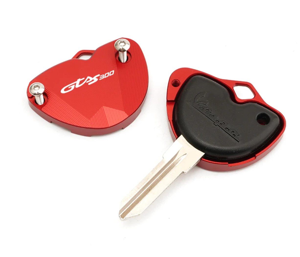

that happened to the key for my old gts which has that soft-ish feeling plastic.
the key with my hpe is a harder plastic and is lasting just fine.
here's some solutions (not sure how the aluminium ones go with the immobiliser)
https://www.aliexpress.com/item/1005003945281414.html
https://www.aliexpress.com/item/1005001596186044.html
https://www.aliexpress.com/item/1005006858478681.html
https://www.aliexpress.com/item/1005006130992052.html
