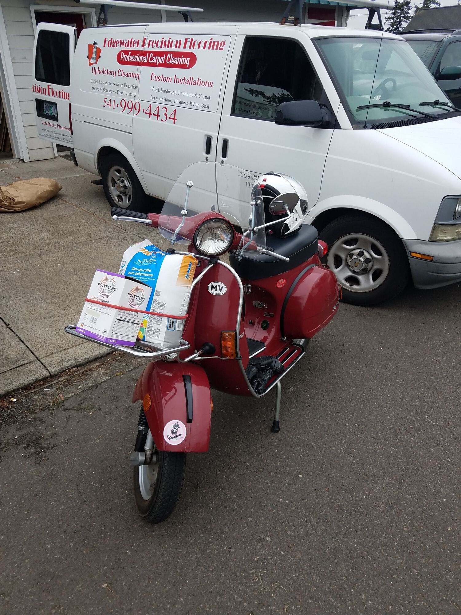

I like my front rack for around town but only use it when I know I'm hauling something. I usually don't ride with it on.
It takes 30 seconds to install, and I can put it on whatever scooter in the garage ..

So far you've got the award for biggest loads on a scoot that i've seen!

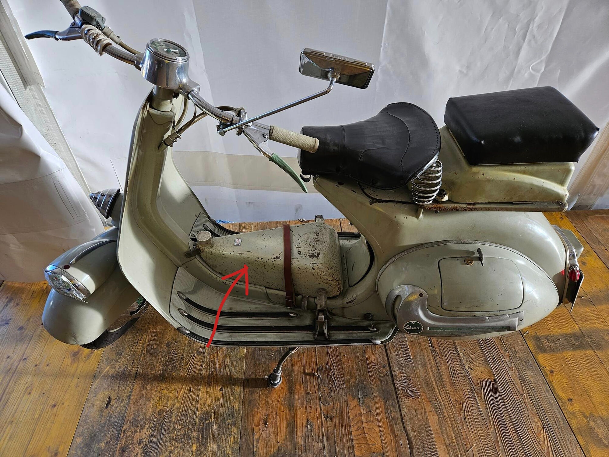

Some of my long-term projects:
Smallframe.
Spare tire holder with gas tank, along with a larger tank that eliminates the toolbox.
Allstate/VNA.
Tunnel top tank.
Not sure how to pull this off yet
Something like this
Something like this
Saw this in Spain. SIP used to carry that and the radio. $$$ though
