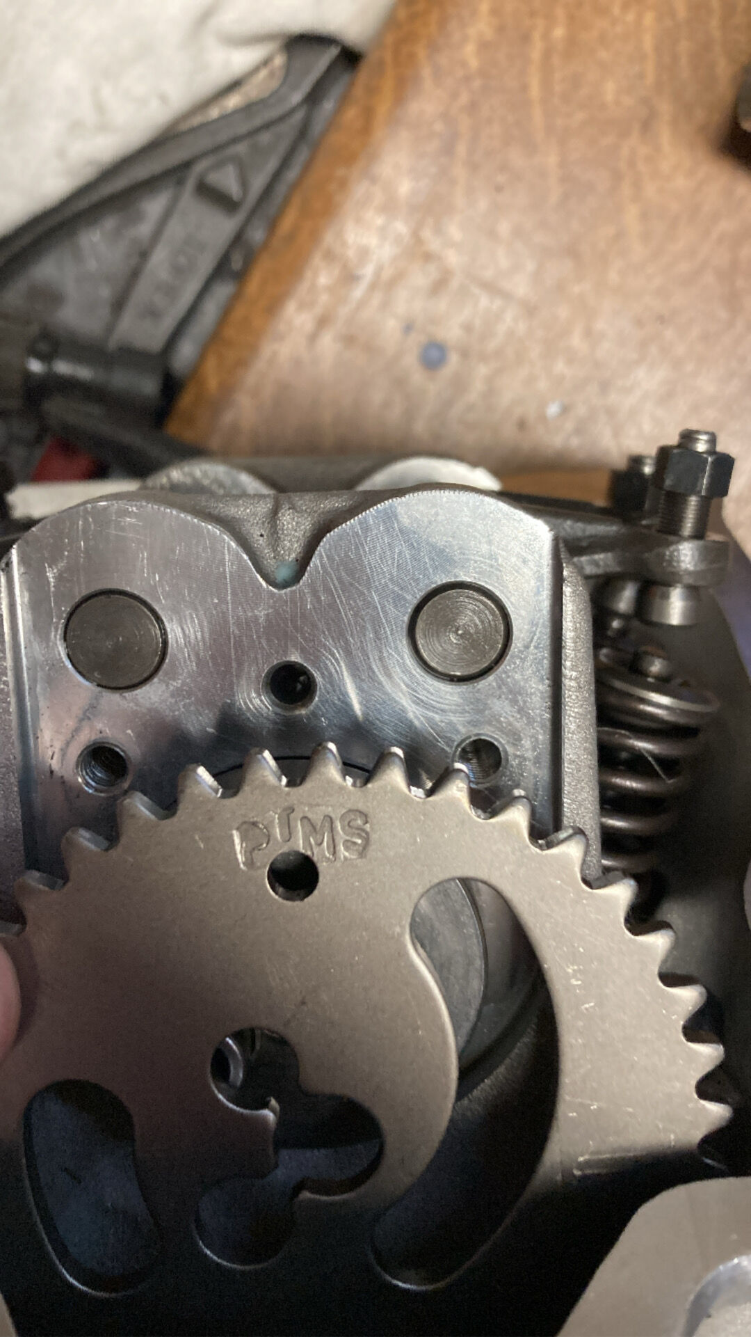

Hi all,
I'm in the process of rebuilding 2017 Vespa 250 gts engine. I have question related with timings marks for valve adjustment. Looking into YouTube videos and Haynes or workshop manual they all referring to 4v mark as reference point. Surprise is that on my wheel there are no marks 2v or 4v.
As you may see on the photo there is p'ms mark ( no clue what does it mean) and line (over small bean) Can you help me with understanding what is the correct position?
Thank you in advance

that's not an oem part.

That's part from gts 250 year 2016 with 10k km so do not expect that it has already been rebuilt.[/i]

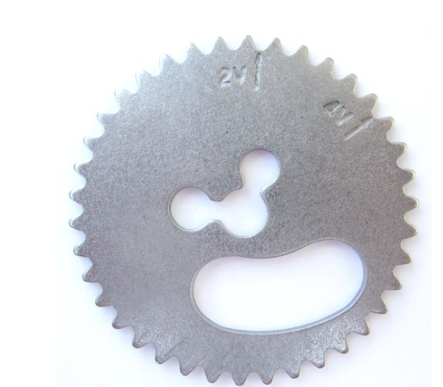

anything on the backside? here is one that is on Scooterwest site and it definitely has timing marks. Only about $10 so maybe buy one.
Yeah, definitely looks mickey mouse.

Whatever year it is, it certainly looks like the I in the PIMS stamping is in the same place as the 4V line in the factory model.

The timing gear you originally posted is NOT a vespa/piaggio part.

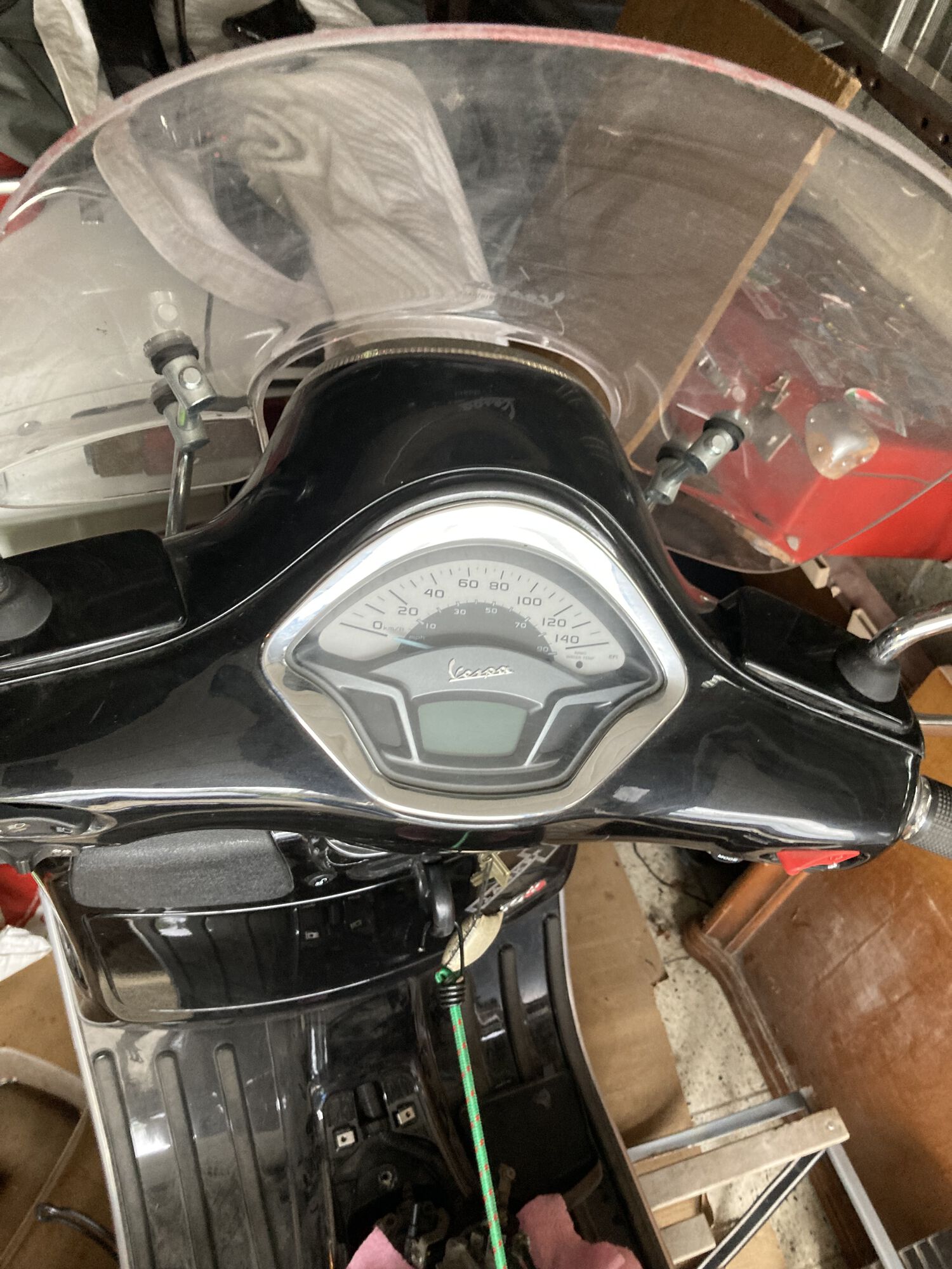

They actually did 250s till 2016 (at least in Europe) with the new speedometer cause they had leftover engines. Markings are fine on the cog (it's OEM, made in China), you align the small hole with a marking that's on the head…

Correct. I'm in Belgium and founded several 250s from 2015,2016 on the market. Picture of my bike : 250 GTSie with new console.

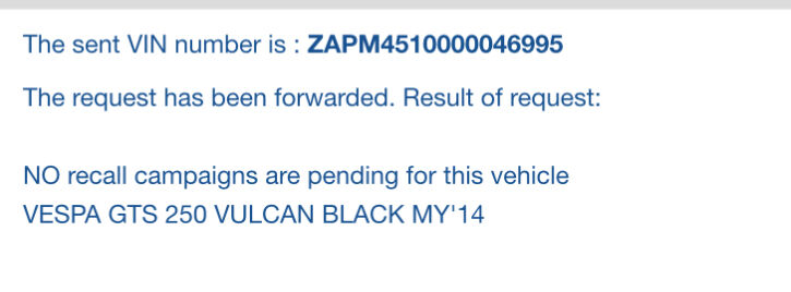

Generally if you stick your VIN in here then you'll get the year
http://recall.piaggiogroup.com/
If you don't see the year with English selected, try again with Italian selected. Seems a weird thing to say but just do it

another anomaly is the timing gear the op posted is BRAND new no marks of any chain wear. kind of strange with a scoot that has mileage on it.

@SaFiS- thanks, I aligned it as you proposed ( small hole is aligning with small hole in housing)
To end up discussion about production year you may see info from Vespa recall page below (model year 2014).
