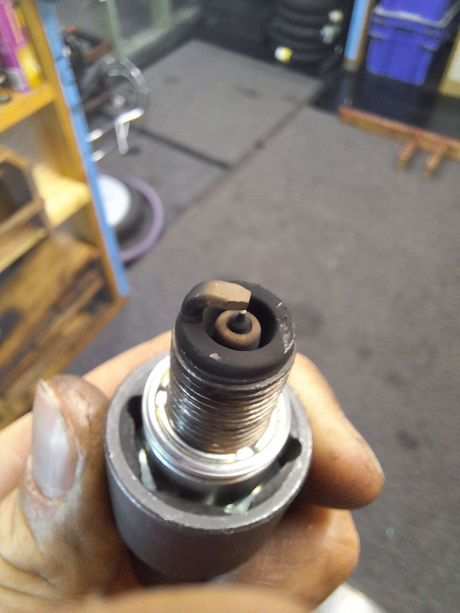

So just finished putting together a 221 sport on OEM cases, no porting, standard SI24 with main jet upped to 130 and a 50/120, drill jet stack to 2mm, fast flow tap, Mazzuchelli K2D 60mm crank and 210 sport top 1.5 gasket, 0.9mm QK, SIP road 2.0, ducati ignition timed to 18deg.
This is a standard sort of build that I've done a fair few of but normally I'd use the SIP 60mm 115/4 cranks but they were not in stock. So the scooter goes well when you're getting up it but seems to flood when you're putting up a hill in a higher gear, say third, and just feels like it's flooded. Plug is sooty and black after a ride, telling me rich. Also, trying to warm start it, it needs full throttle and chugging and eventually, it will clear up but plug isn't wet still, just sooty.
I've changed plug, CDI, tried different jetting combinations, including smaller idle, but still has that bog is still there. My thinking is that it could be the timing on the crank... K2D has a 138/6 which might be pulling too much fuel in for such a tame setup?
Any ideas?

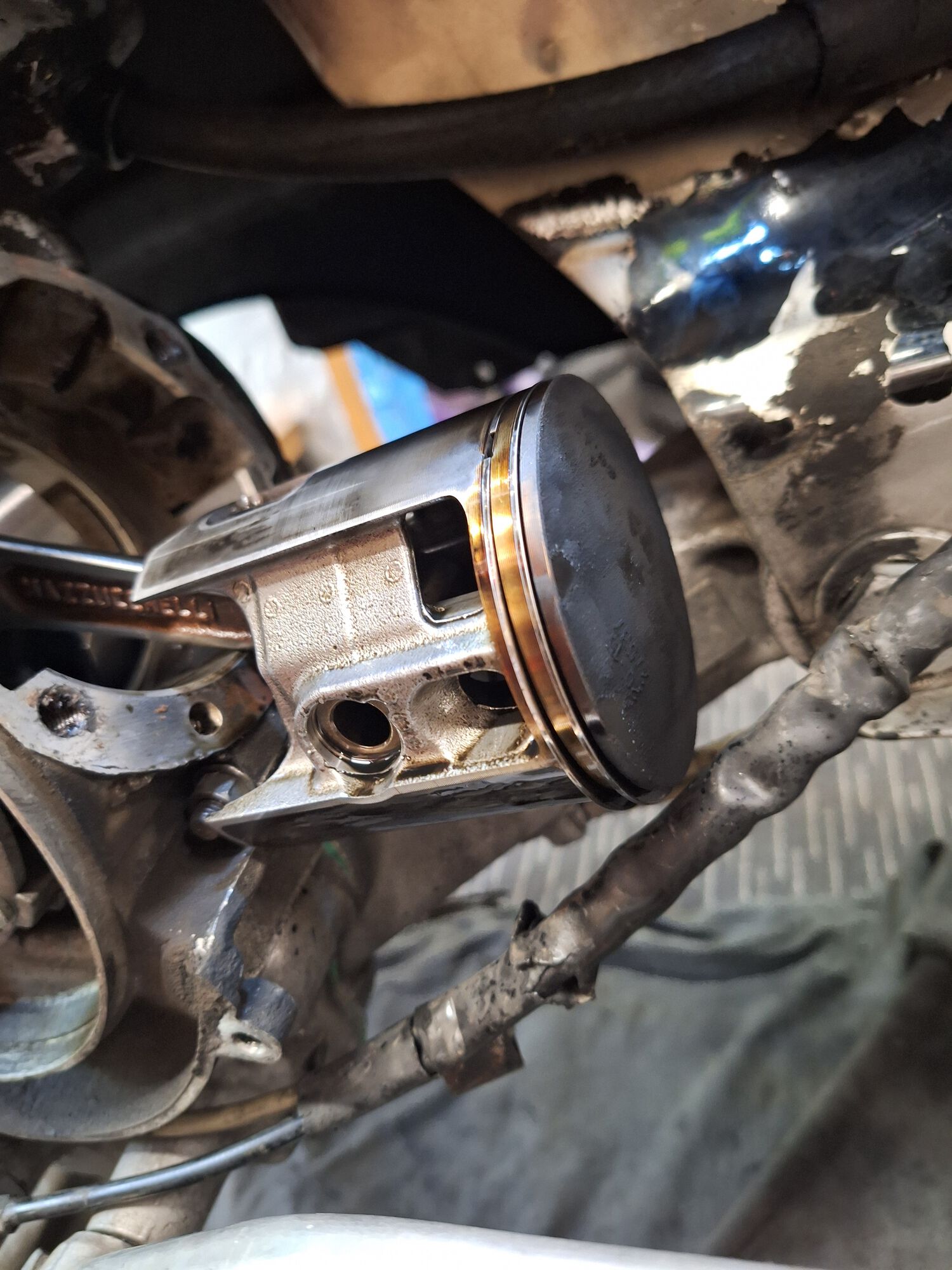

top of piston is pretty sooty.

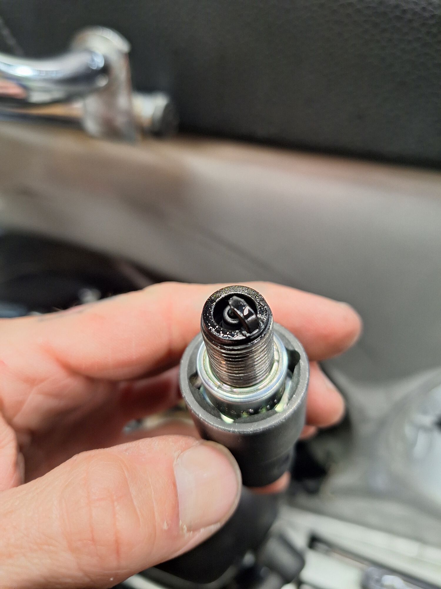

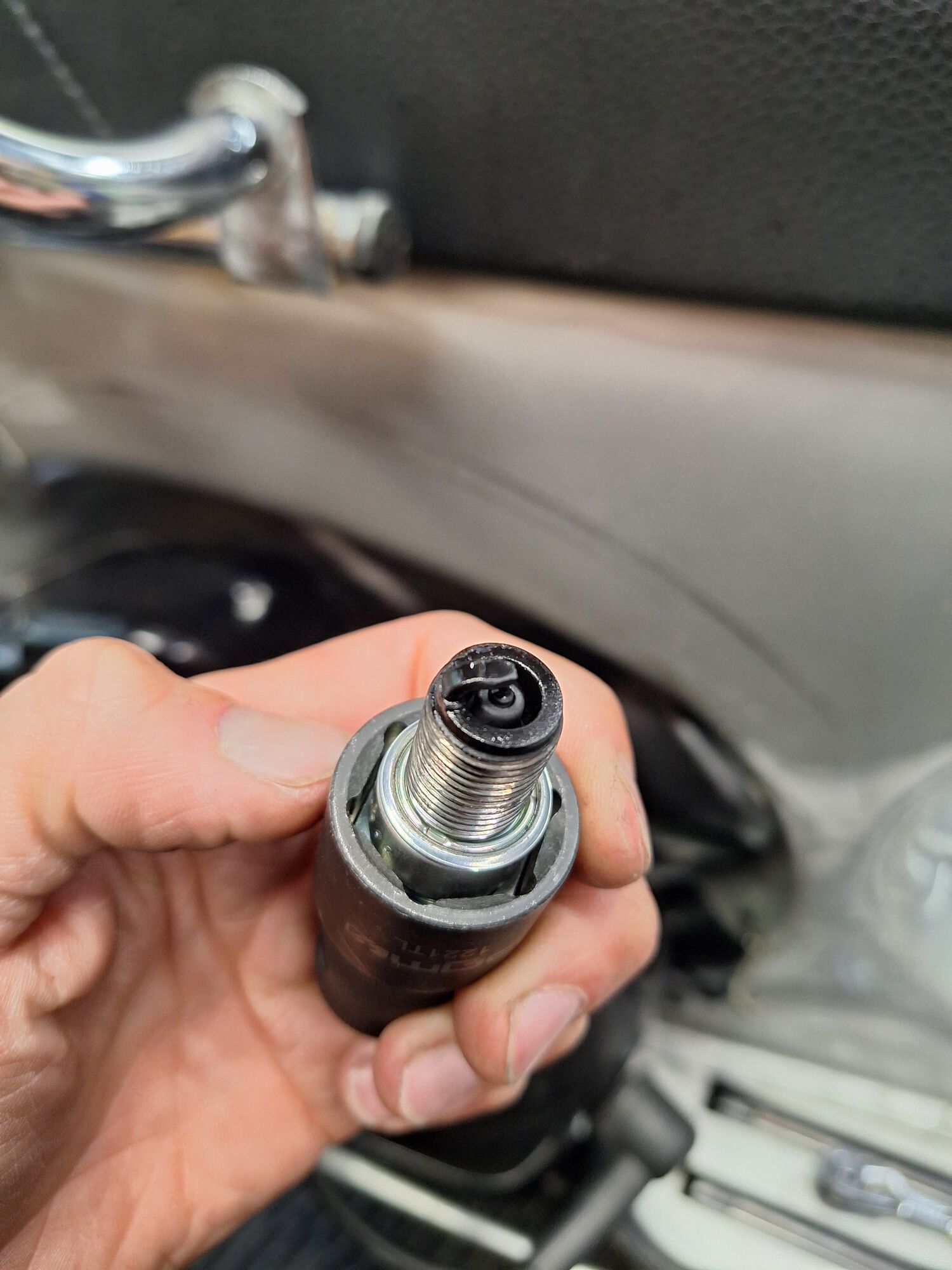

plug is lighter than it looks, but that soot doesn't ring true.... surely needs to be a bit of moisture around there?

Pretty sure it's just the jetting. Main jet is too big. AC is too small. And for this set up, pilot jet no smaller than 55/100.

The 122 that I've settled on just felt nicer than the 125, with 2 turn mixture. Plug is sooty and black, not wet, but yeah, as You said (and I thought) it's riding fine, and sounds normal... a little bit 4 stroking a low/light throttle but I'm counting that as needs for high speed roll off.

Open the mixture screw to 2.5 tuns and do that same video again. I think I hear something slightly lean.
Plug colour off full temperature (only a fast long run), is irrelevant. When non stock, dark brown or matt black on an 8+ plug around town, usually means pretty good.

So the sooty black is around town, aggressive(ish) riding with a BR8EIX plug, squish is at 1mm with a strobed 18deg.
