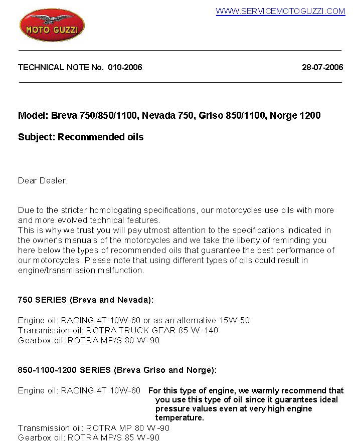

Piaggio bought Moto Guzzi, and switched their bikes to 5w-40. Three years and a lot of broken engines later, here's what they did

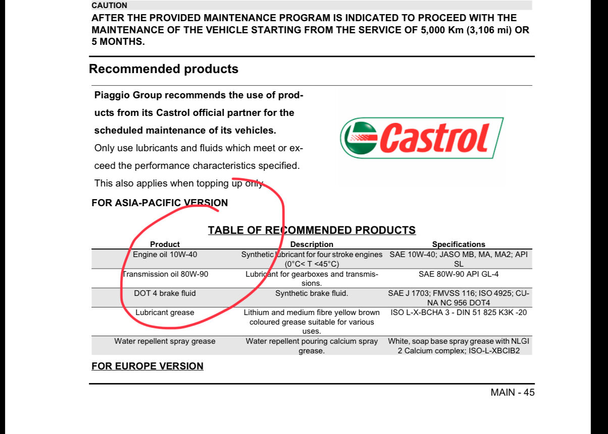

According to the shop manual. 10w40 is recommended in Asia 5w40 in Europe
Which shop manual?

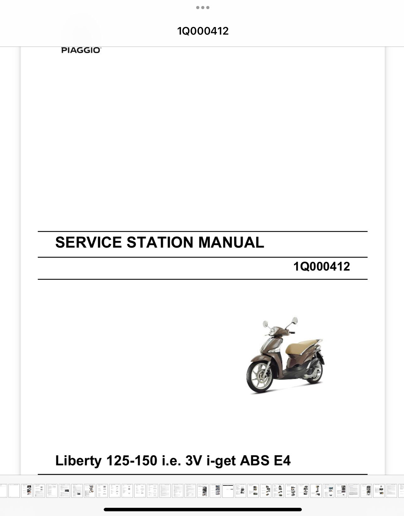

Liberty 125-150. Euro 4 though. Mine is euro 5
Sorry, forgot it was a liberty
Can you please give that manual to jimc so he can stick it on the archive at https://manuals.wotmeworry.org.uk/Piaggio/
And post the next page please so we can see the European oil recommendation.

says 5w40 for Europe.
