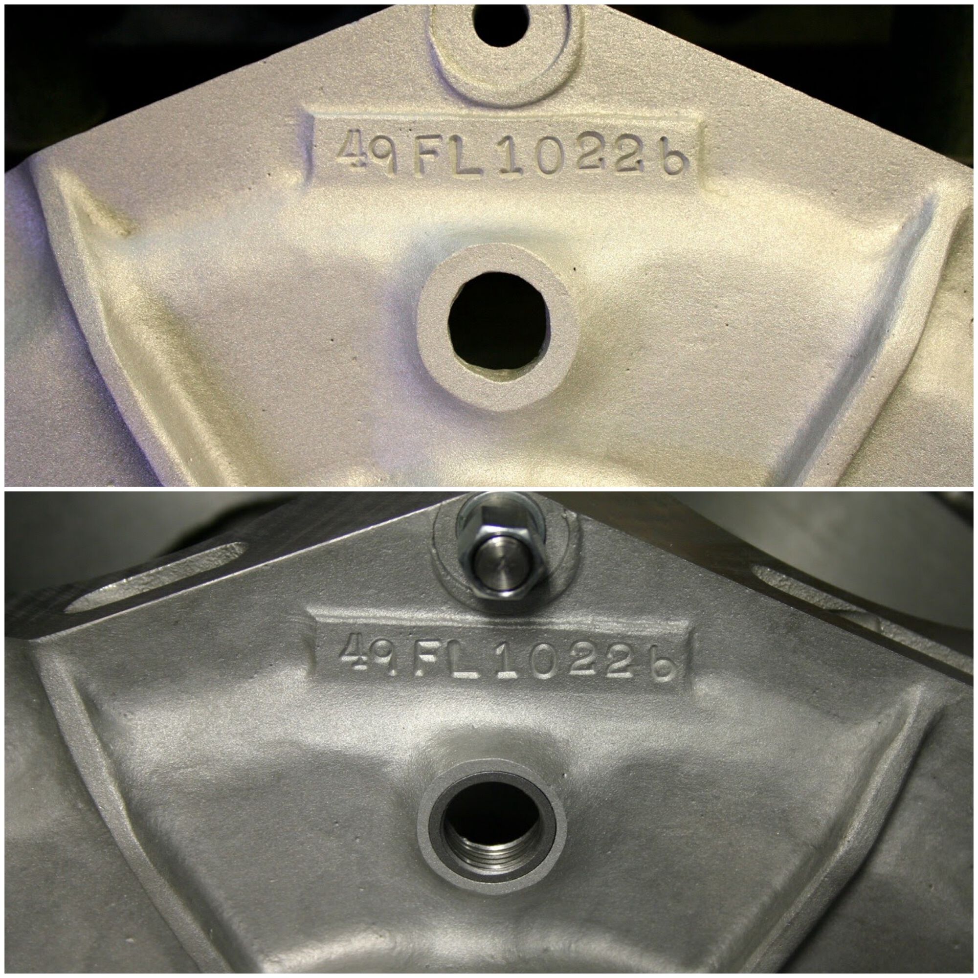

A timesert is how I repaired this left side motor case on my '49 Harley-Davidson. It would take a bit of searching and $4,000-$5,000 to replace this case half. So the cost of a timesert repair is insignificant by comparison.

When I see this kind of repair, it tells me the the scoot is well loved. good man, Craig.
