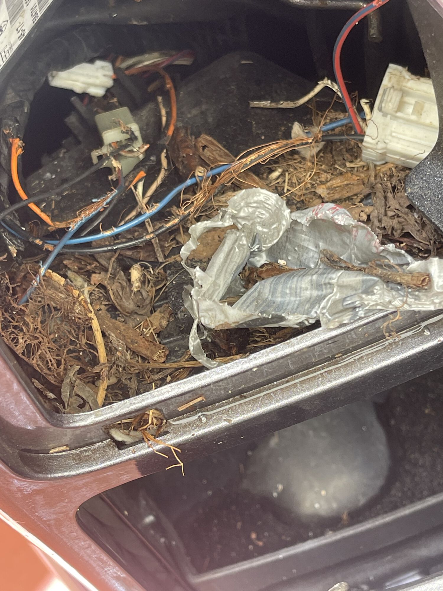

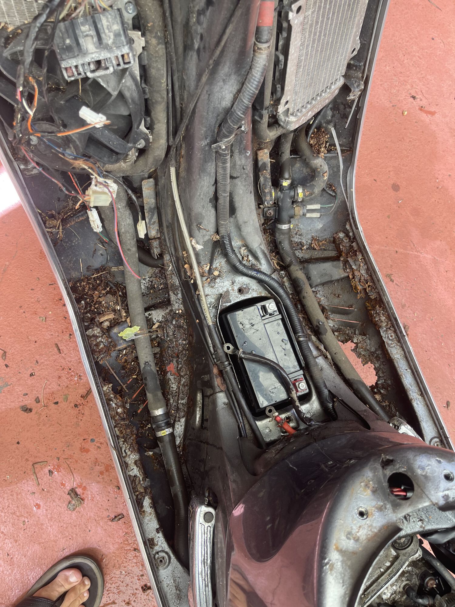

Hello,
Got this GT 200 as a project. A new battery has some of the electrical come to power.
Some wires are clearly disconnected.

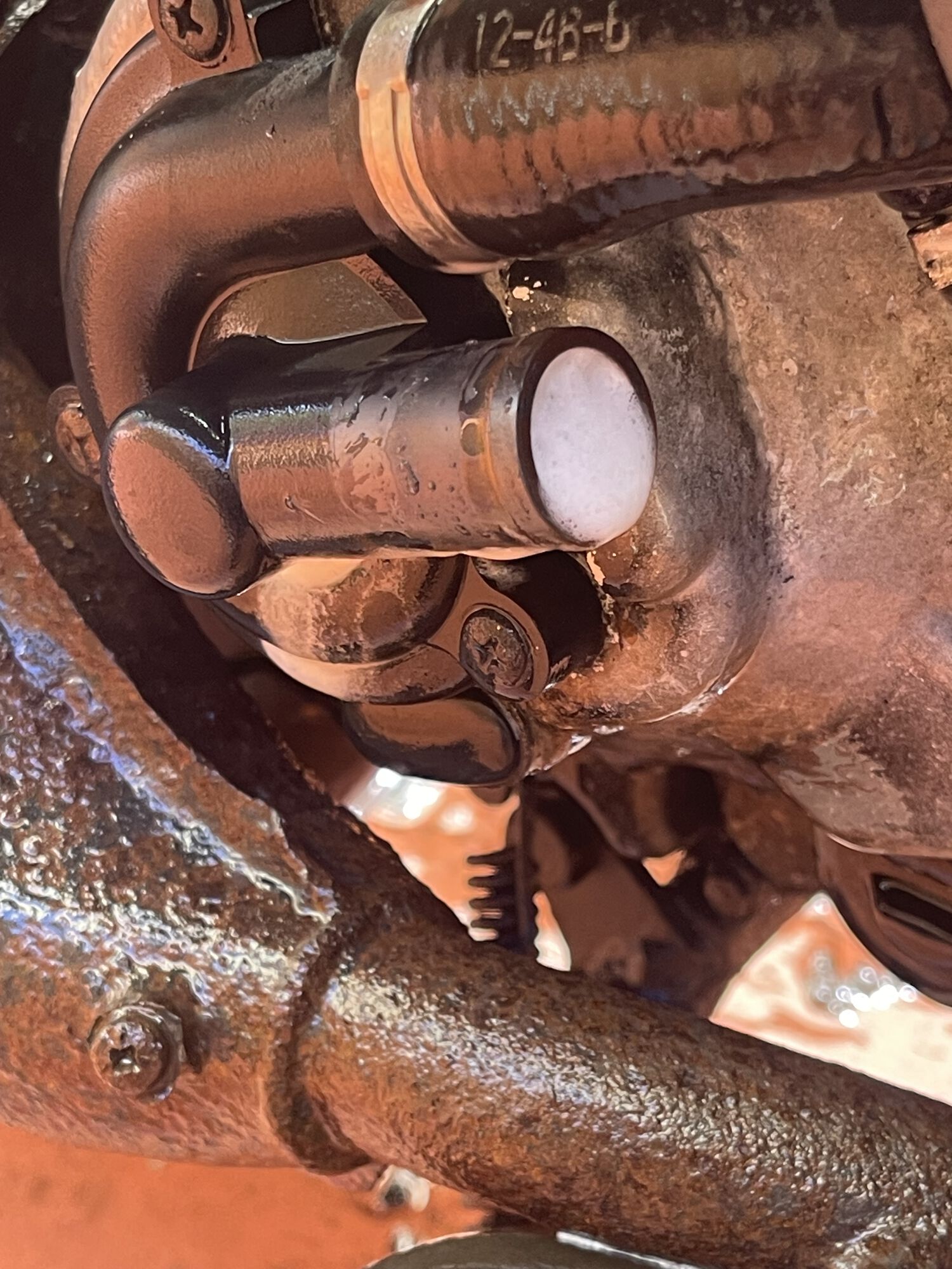

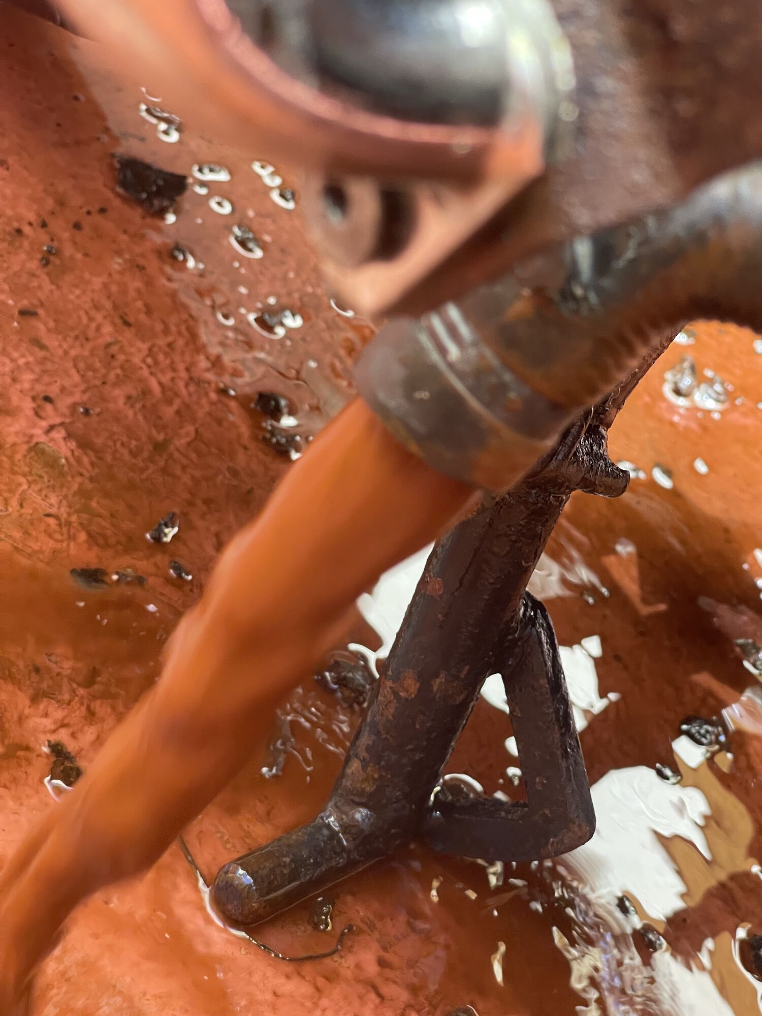

Look at the radiator water. What is the white stuff.

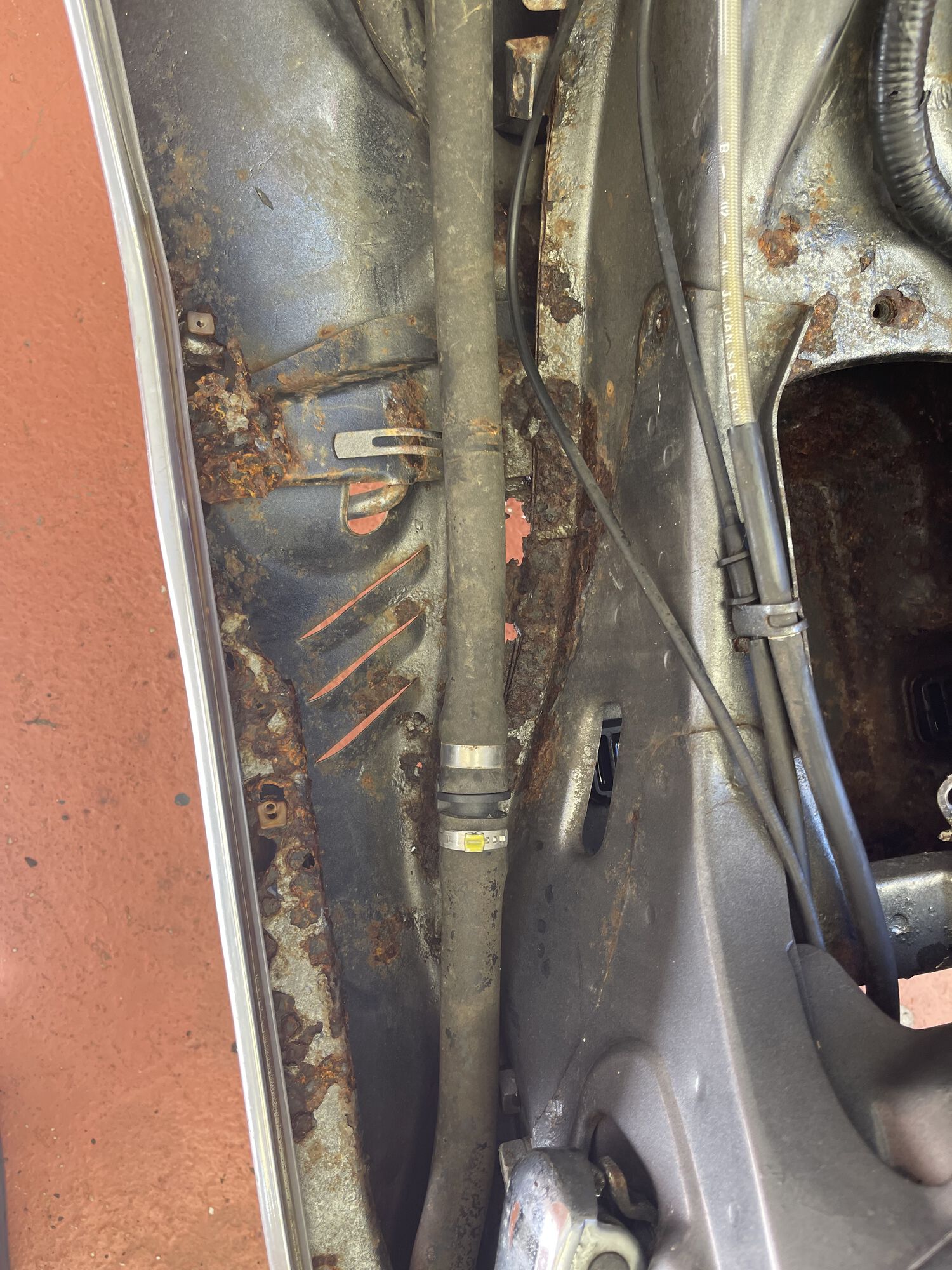

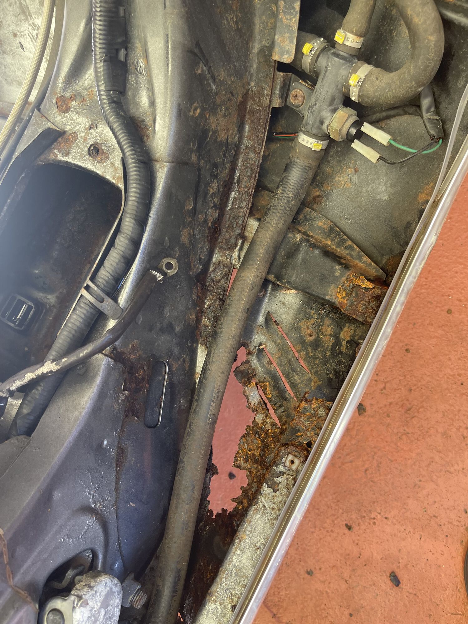

How does the rusted floor looks? Salvageable?
Any suggestions as what it might need to run again?

with a floor like that, that's a parts bike.
that coolant (if you can even call it that) looks dreadful. if the motor runs, it'll need a head gasket and a water pump for sure, and likely a comprehensive cooling system rebuild. I'd call that parts as well.

not to mention the wiring harness total mess that WILL be hell to sort out.
I would pull off decent spares and take the rest to the scrap yard for some cash.

looks like a flood bike. or a theft recovery that was dumped in a river.

how did so much shit end up *inside* the body work and why is the wiring all gacked up?

No idea. I got it last night. I turned the key and the electric came on

Perhaps mice got up inside from the holes in the floor, bringing in debris and chewing the wires.
If you're really determined to bring the scoot back, you'll need to disassemble it completely, media blast at least the floor and weld patches of steel in there. Then prime and repaint that area.
You're also looking at partial wiring loom and full engine rebuild. That brown water and white foam coming out is a bad sign.

I admire your motivation but am going to jump on this pig pile and repeat the same thing. You'll most likely be better off parting it out and applying those gains towards another machine. That is unless you are in it for the challenge and don't worry about those things. Enough effort, parts, time and money can fix most machines. IMHO, it's uneconomically repairable. Corrosion is the enemy, the money and even your DIY energy to fix it is going to exceed the scooters value.
If you can't get it running without dumping money into it, cut your losses. The pictures posted do not look good, hence the responses. Think safety, you don't want that to fold in half while riding.
