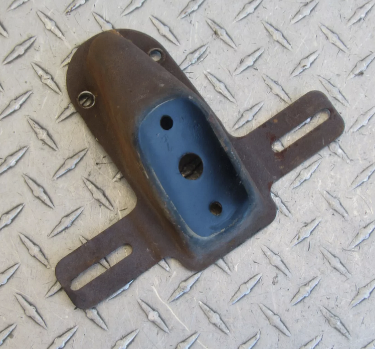

So I bought this bracket for my P200e and the mounting bolt holes don't line up vertically on the body.
The light itself and can mount perfect in the horizontal holes. What do I have ??? I could make it work and not care , but wondering if this is a rally 200 bracket or ??

look like it is for a moped
the seller said it was for a Vespa P200e, but who knows. The curvature is correct, as well as the can mount holes

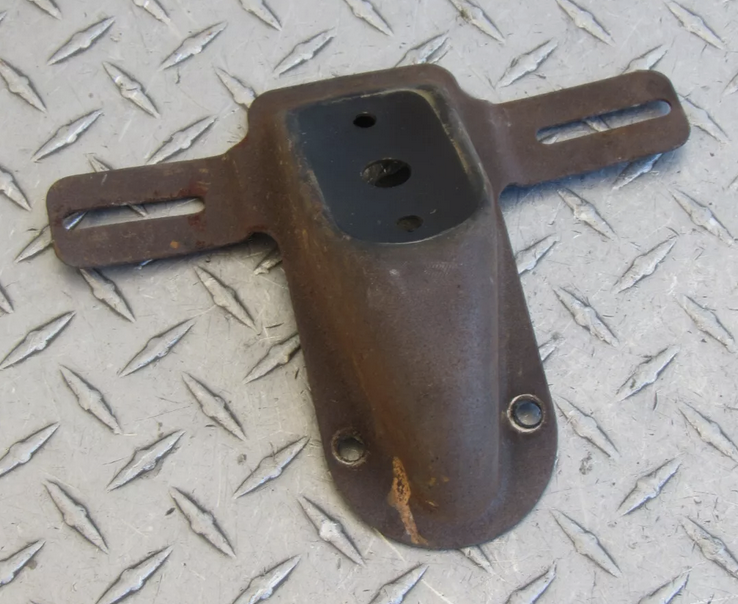

that's not for P series
hold plz...
this is the one you want:
hold plz...
They both look the same but slightly different on the stampings (your 2 pics)
How much you want for one?

pamapunch wrote:
https://www.treatland.tv/ProductDetails.asp?ProductCode=cev-9350-license-bracket-ANGLE&utm_source=googleshopping&utm_medium=cse&gad_source=1&gclid=EAIaIQobChMI056FrbeThwMVUCGtBh0x6ADFEAQYAiABEgJiZvD_BwE
This bracket if or a Ciao moped, not a Vespa. The tailight housing mounts to the bracket the same way, but the angle and frame mounts are different. See Greasy's photo above for the correct bracket
Still kinda eyeing it there. I've got several Ciaos; one with a tuna can ('71) and the P-style ('81). I've also fixed two Bravos and four Grandes for friends. Their backed mounts a lot differently.
Maybe it's for a Sí, or a non-us market?
Yeah could be
