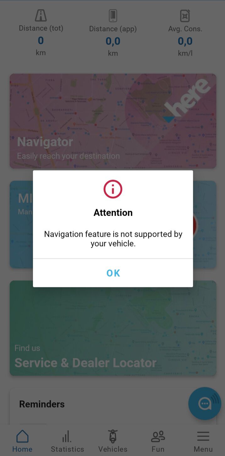

Hello all!
I have just bought a 2nd hand GTS super tech 125. I looks great but I am experimenting some troubles with the navigator. I downloaded the Vespa Mia App and I linked the bike with my phone via BT. Music and calls do work but when I click on the Navigation box in Vespa Mia, I get the message "Navigation feature is not supported by your vehicle". My free navigation license is still valid.
Anyone had the same problem? Any idea what is happening?
Thank you all!

1.
a) Android or iOS?
b) If android use my app instead as then you'll get support. 'Vespa Snoop' on Play Store
2.
a) Uninstall, reinstall.
b) Don't add you bike in the vehicles garage screen, instead click the round connect button first.
c) select supertech 125. note: If it's a '2023' pmp3 then select my22/2022, if it's bt-router then select entry that does not say my22/2022.

Thanks for your answer.
My mobile is android. I will try with your app.
In point 2 of.your answer, you mean in your app or in the official Vespa app?
Posts: 7502
Posts: 7502
My point 2 was for the official app.
My app is quite different, it is more lenient about which model you choose. Have a play with it, if you get stuck then email me using the support menu option in the top right of the main screen of my app.
