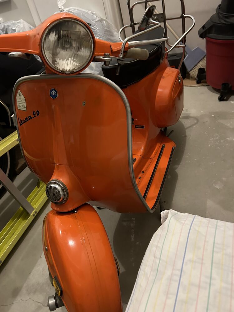

but there's some inconsistencies: you say 74, but there's no turn signals. the "tuna can" style rear light was earlier than what would've been on there in 74 (tractor style light). the front fender reflectors are wrong and in the wrong location.

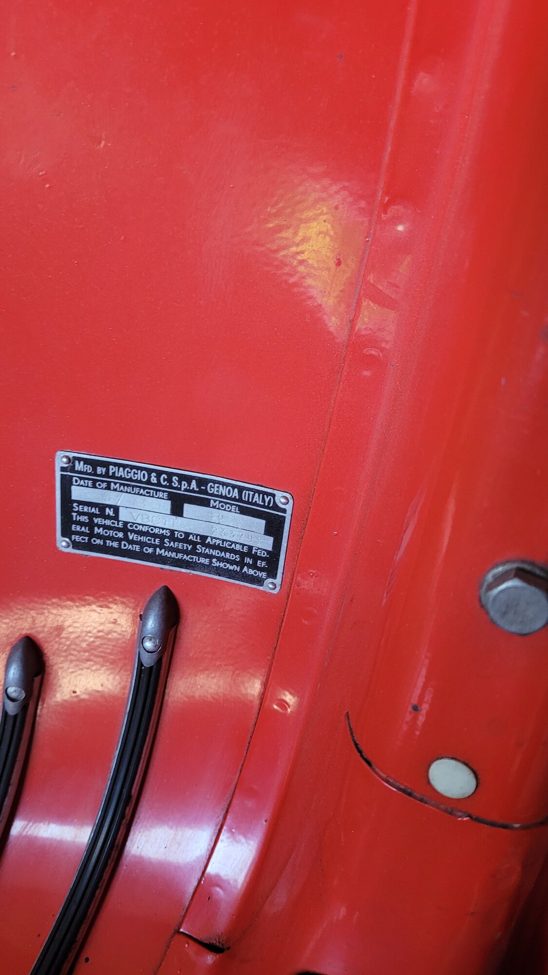

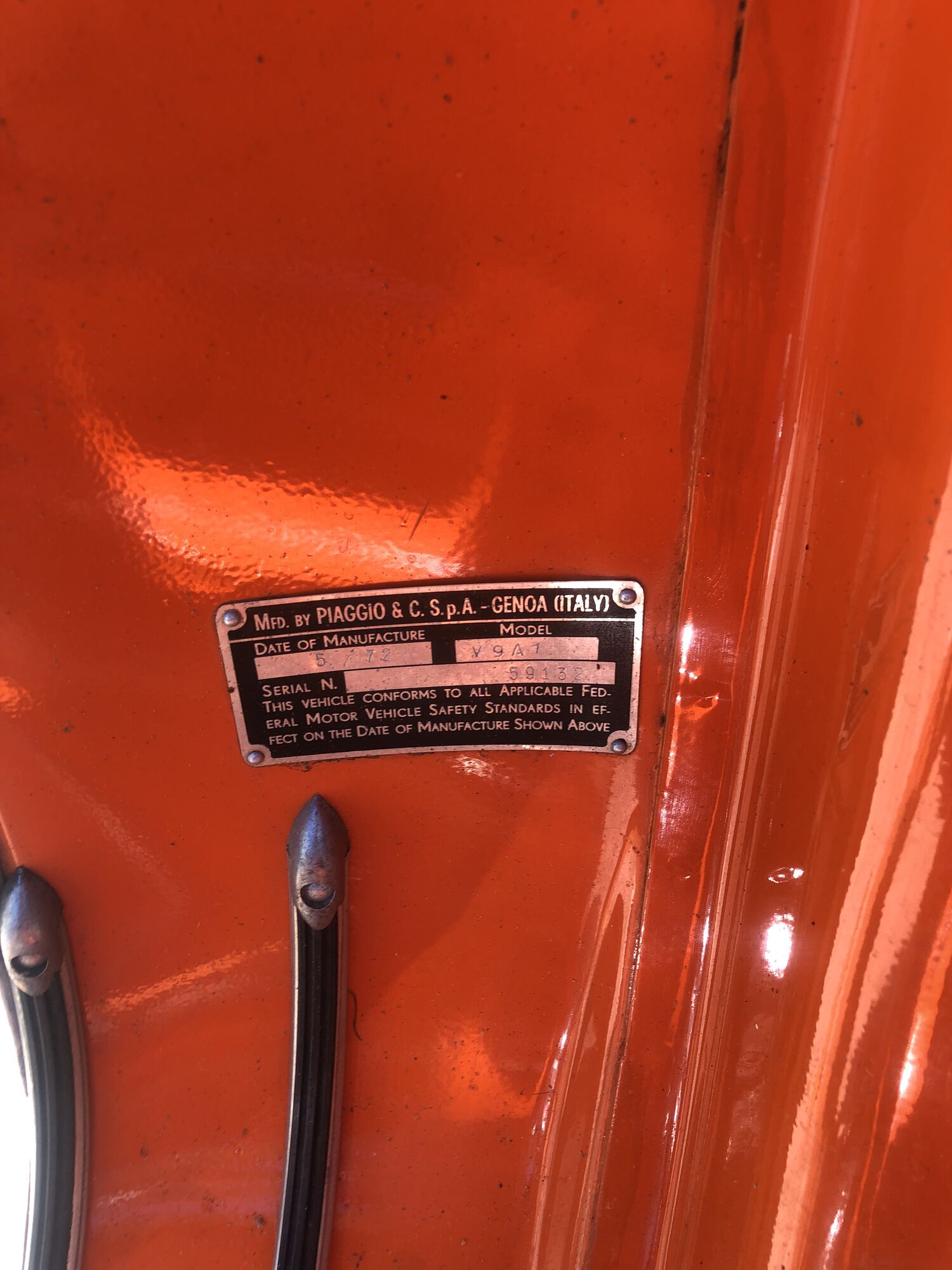

what's the data plate say and what are the frame and motor numbers?

Hubs look earlier than 74 too.
*Scratches head*
Script badge or block lettering on the front?

It's a 1972 after looking at the plate

Are you sure that wasn't repainted? Looks like it has a fair amount of orange peel that you wouldn't expect from the factory.

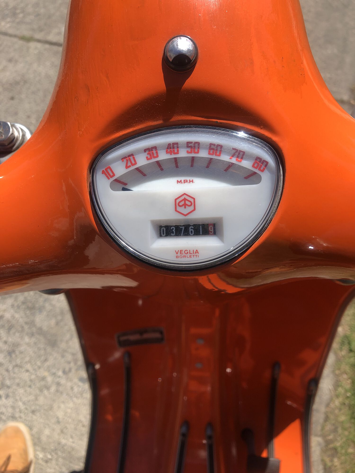

Definitely repainted US spec Primavera. Look at the front fender reflector replacement, no chrome bezel on the headlight but screws for it, missing badge on the tail, the orange peel, Speedo and exhaust super shiny and clean with that mileage.
It's nice, but not original.

Why does factory plate state V9A1? Thought that was v90
Yep. Sure says that. Ignore that I typed Primavera and turn that to V90.

The battery door pre dates '74 in the US. I have seen it on a '72 Prima with tuna can tail light. So it looks like this is likely a '72 V90 [3 speed] with maybe a respray (headset, orange peel...) this should have signature script on the legshield with a hexagon piaggio badge. the headlight could go both ways with a chrome rim or not. Speedo is correct and not yellowed, if rebuilt it was done well, if not, it's been kept out of the sun, both a good sign.

The wheels look too new to me, it looks like they had a coat of silver paint over the nuts !
the top of the front light surround looks like repaited also (1st picture)

That's not silver, it's "chrome paint". In fact chrome is my last name.
