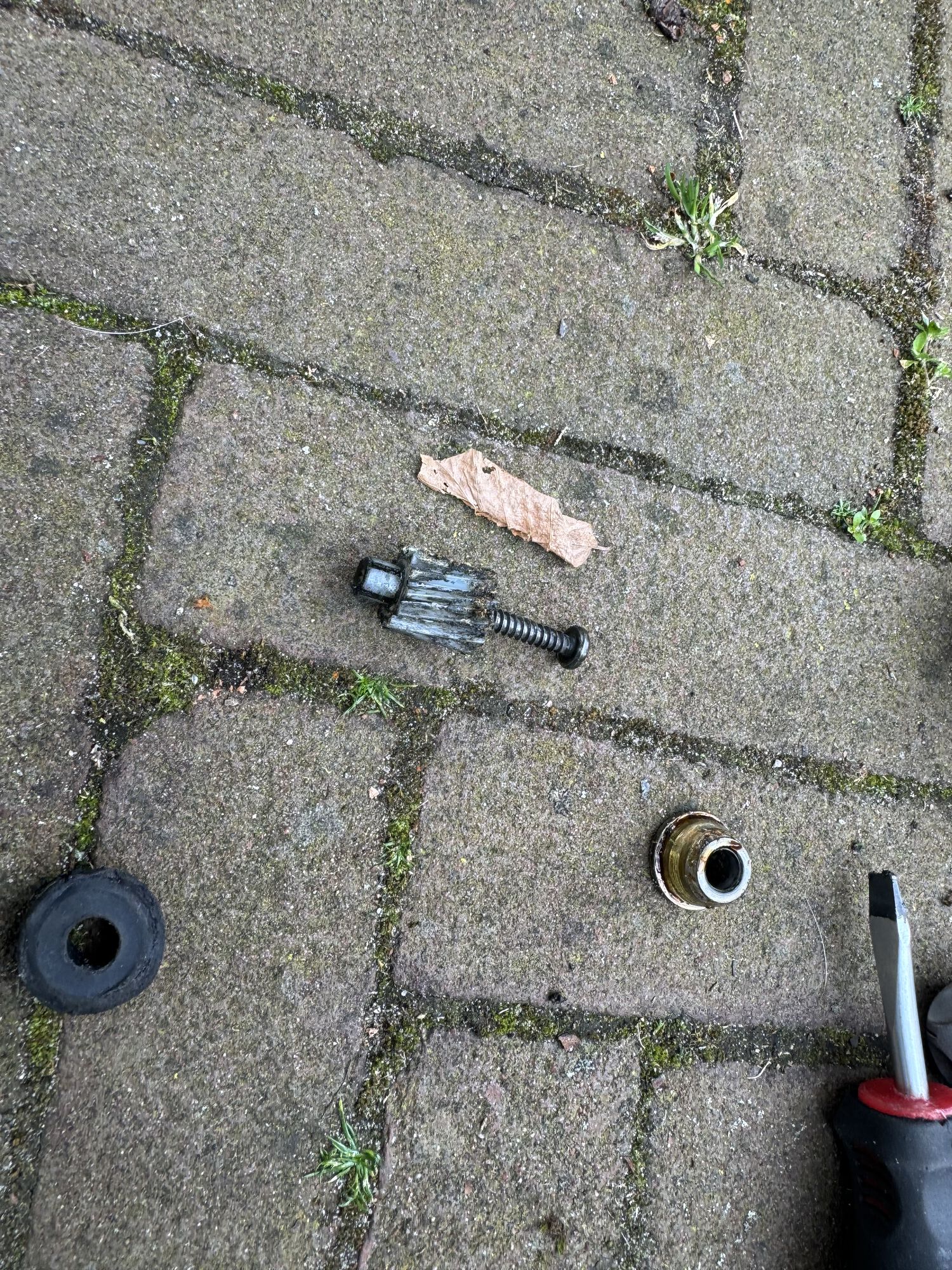

Did you only replace the cable or also the other parts like the little white gear inside the mounting point down below? That fixed it for me on my GT 125 as it was gued up.
The screw in the gear was used to get it out since it was stuck
