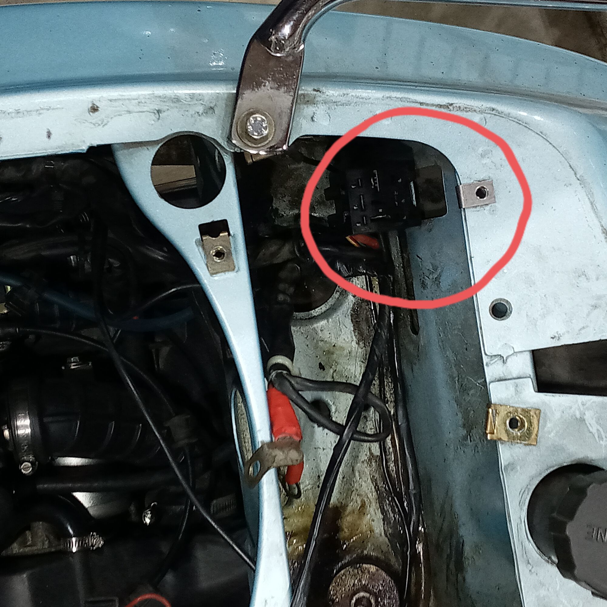

I am trying to remove the harness connector for the starting relay on my LX150. I assumed it would be a standard plastic tab that you push in to release from the frame / metal bracket. But this isn't working. And there's not much clearance to get a good look at how it's held in.
Before I break anything, I thought I'd check in here in case there's some kind of trick. Facepalm emoticon

Your lucky day - I was bored! Use a screwdriver between the tab and the metal support to push that shoulder away from the support. You can bend the metal support forwards to gain more access. I trust this photo helps:
That's perfect! Thank you!! Clap emoticon
