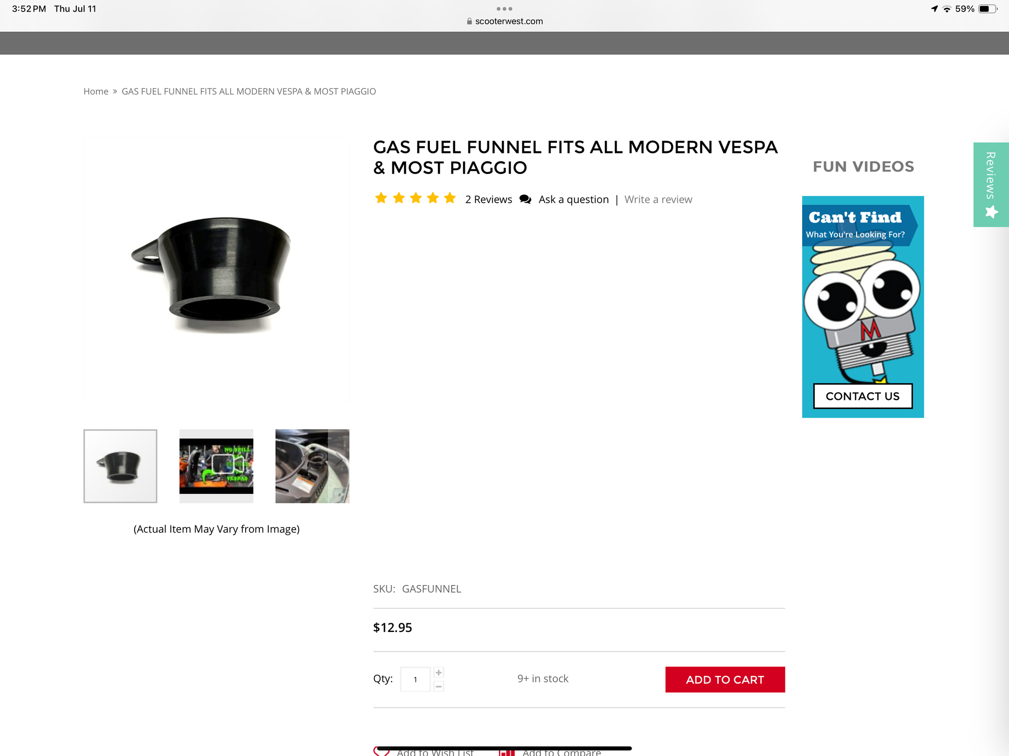

I don't know if it was clear, but I did mention (in different words) that I have tried both #1 and #2. I like the idea of #3 - that would at least limit the overflow to the funnel.
thank you for that suggestion!
Posts: 45155
Posts: 45155
That funnel is to help with filling from the CA pumps, which have the fume-collection 'foreskins' on them, and also filling from cans. If it fills with fuel, what do you think happens when you remove the funnel...
Keep the fuel nozzle pointing towards the rear of the scooter and fully inserted, i.e. with the handle over the raised pet-carrier, and go slowly. Don't hold it half-out in the hope of seeing fuel level. Bear in mind that all pumps are different - if you find a local one that doesn't overflow each time, remember it and try to use that one exclusively. Some people keep a 5 gallon container at home, and use that to fill up.
I find I can use the CA nozzles with no funnel and very rarely get spillage - they shut off very smartly.

Two thumbs up for the Vespa gas funnel

I have the funnel and live on the US coast of the US (NY). I cannot say that in my case the SW funnel does anything to help (I have it and use it anyway). Go slow and carry a rag seems to be the way to go.

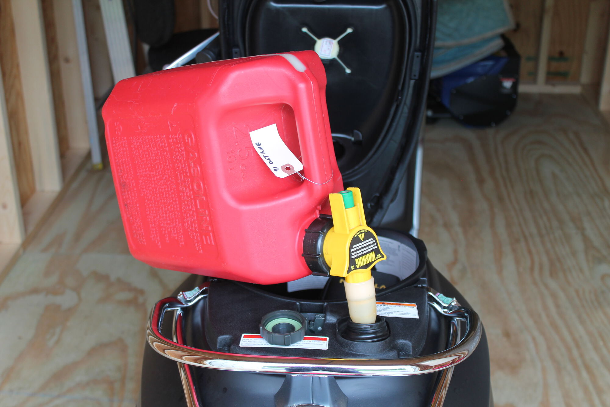

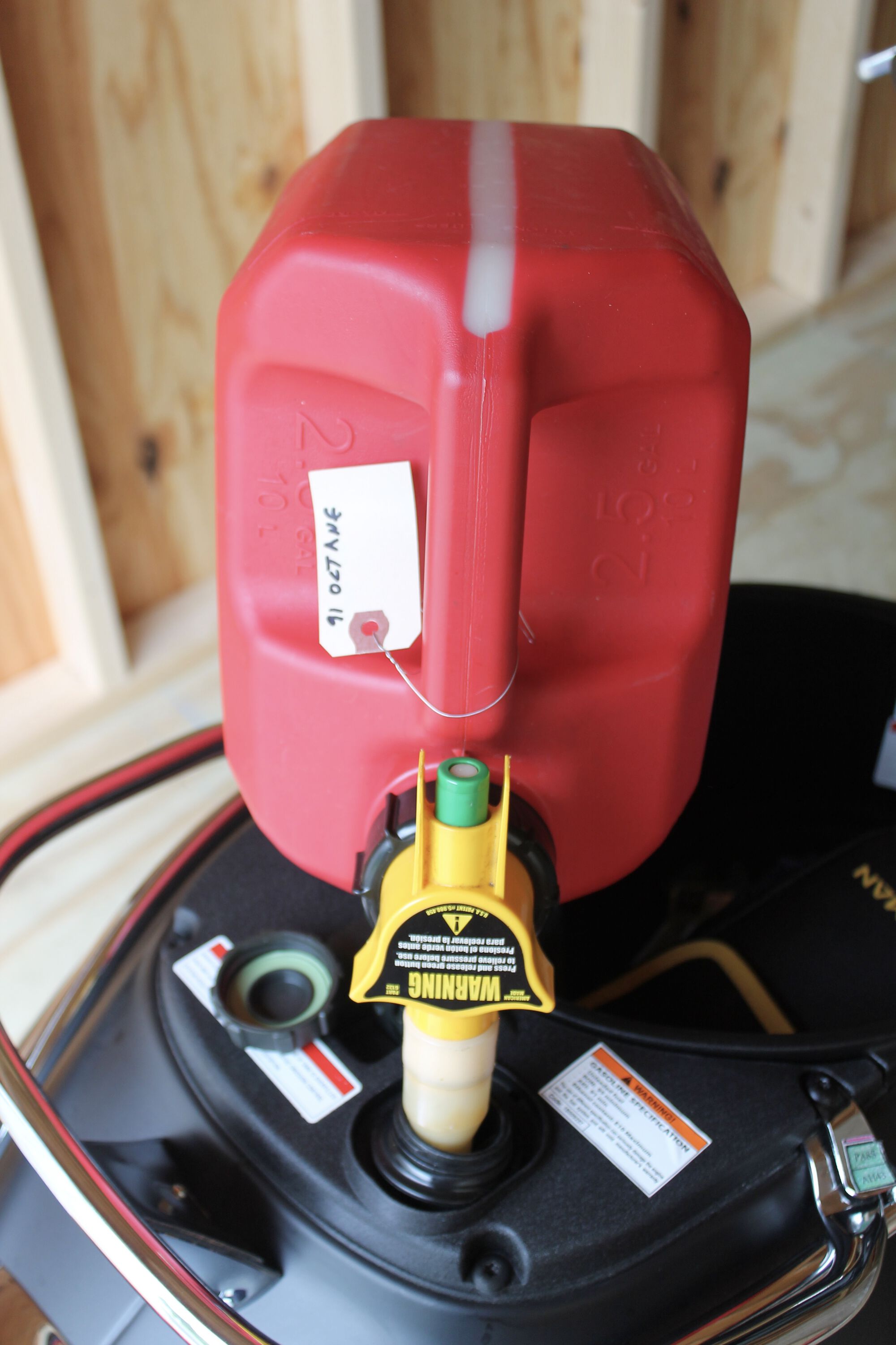

@olde_rider avatar
Primavera 150S
Posts: 637
@olde_rider avatar
Primavera 150S
Posts: 637
I'm a bit late to the discussion, but I was doing some testing of various ways to fill my Primavera. This can (pictured) works great! I don't even have to support it, as it sits on the grab rail. The trick is to use the green button to control the flow. Same as a gas pump, too fast is no good. I listen to the gas trickling in, and when the sound changes, release the button. Not a drop spilled. I fill the small can from a 5 gallon can, so I have a maximum of seven gallons on hand. The smaller can is available at Ace Hardware stores, and online.
Posts: 22937
Posts: 22937
great for when you only fill up at home. having a good technique is essential for when your traveling or day trips of more than 100 miles. Hell a sandwich run for me is every bit of 165 miles.
