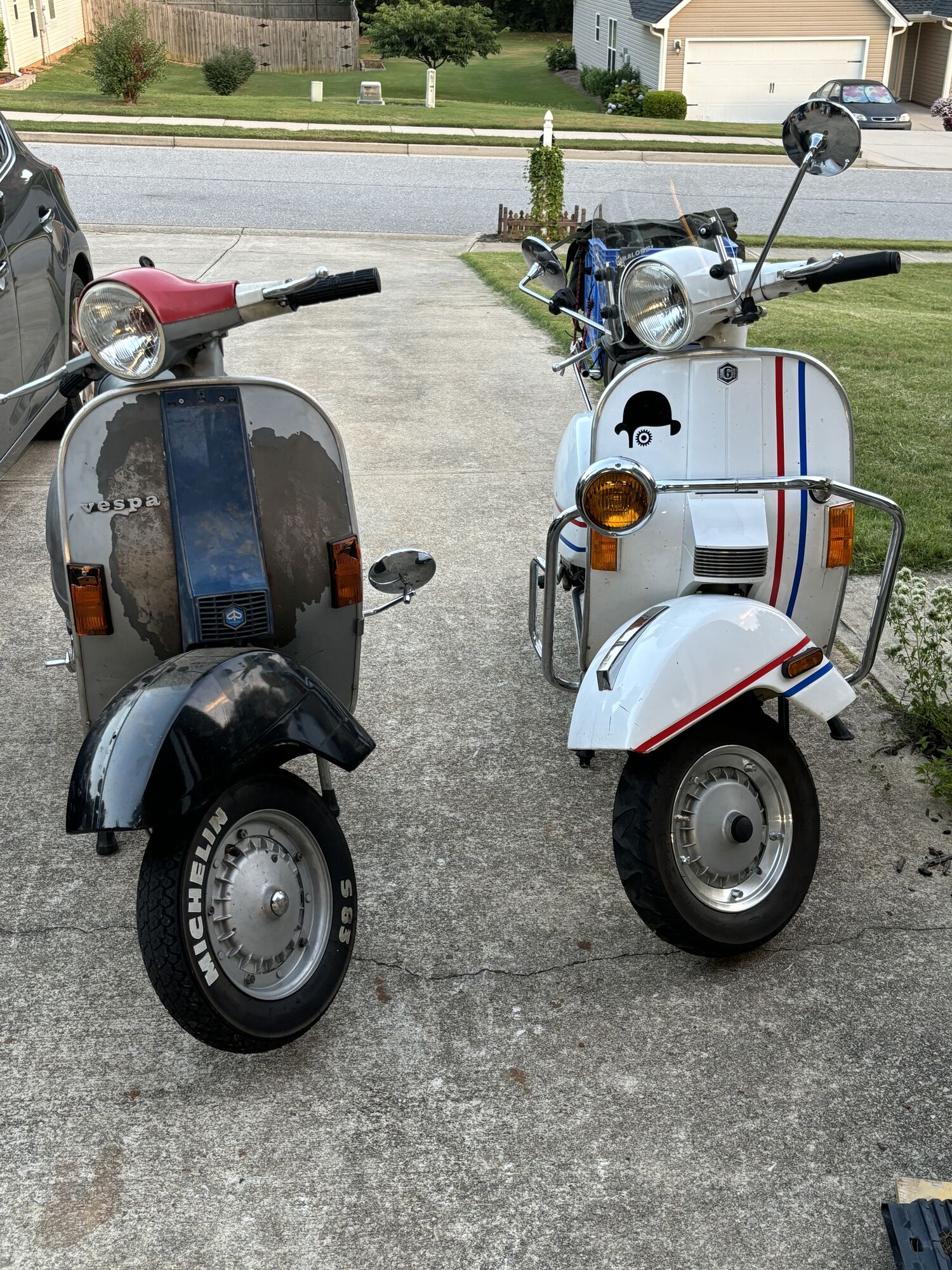

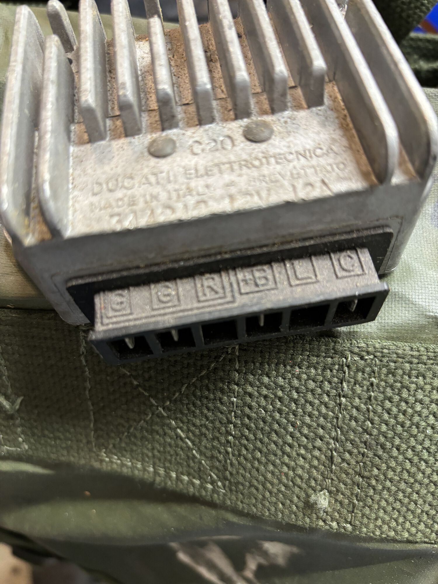

So I have a Ducati regulator, with the two G connectors. Unregulated AC in and regulated AC out. I'm getting intermittent voltage spikes that blow the headlamp bulb. I'm not using the sealed beam thank goodness. I have a 12v AC regulator, and since everything else works, I'm installing it in the purple circuit under the horn cover. Question is, can I leave the wires connected through the regulator G connections and let the inline regulator up front handle the spikes, or pull the wires off the G connections and splice them, isolating the Ducati? Any downside I'm missing to either route? Thanks. I don't have a known good replacement. Pics of the newest addition, built from pile O' parts.

Correct me if I am wrong, if you have a double G (double yellow) system, which uses the 4-pole regulator/rectifier you are showing, the purple wire from the stator is not regulated. It goes straight to the headlight. Two separate AC systems there; one to charge the battery, one to power the headlight. Yellow-yellow charges the battery, purple runs the headlight.
The newer (1980 on) red/yellow system with the 5-pole regulator has a headlight regulator as it uses a 'higher output' stator. It is the A-A purple leads into and out of the regulator/rectifier. Similar to the earlier system, it has two separate AC systems; red-yellow charges the battery, purple runs the headlight.
You can run a separate 12V AC regulator under the horncast to alleviate your headlight burning out. If you run high rpms, the headlamp will burn out on the older yellow-yellow system as there is no regulator on the headlight circuit. Higher rpms = higher voltage, leading to burned out bulb.
You can also run a higher wattage bulb to take more of the load. It will be a tad dimmer at idle and lower speeds. Stock spec is a 30watt bulb. I run a 35watt without a regulator and have not burned out a headlamp in years whereas the 30watt would burn out quite frequently, especially if rpms were held high for awhile.

Good catch, I did take a pic of the wrong regulator! It's the newer system. So far I still have a light, so seems to work ok. I used the yellow/brown wire cheapo regulator like the one on my VBA.
