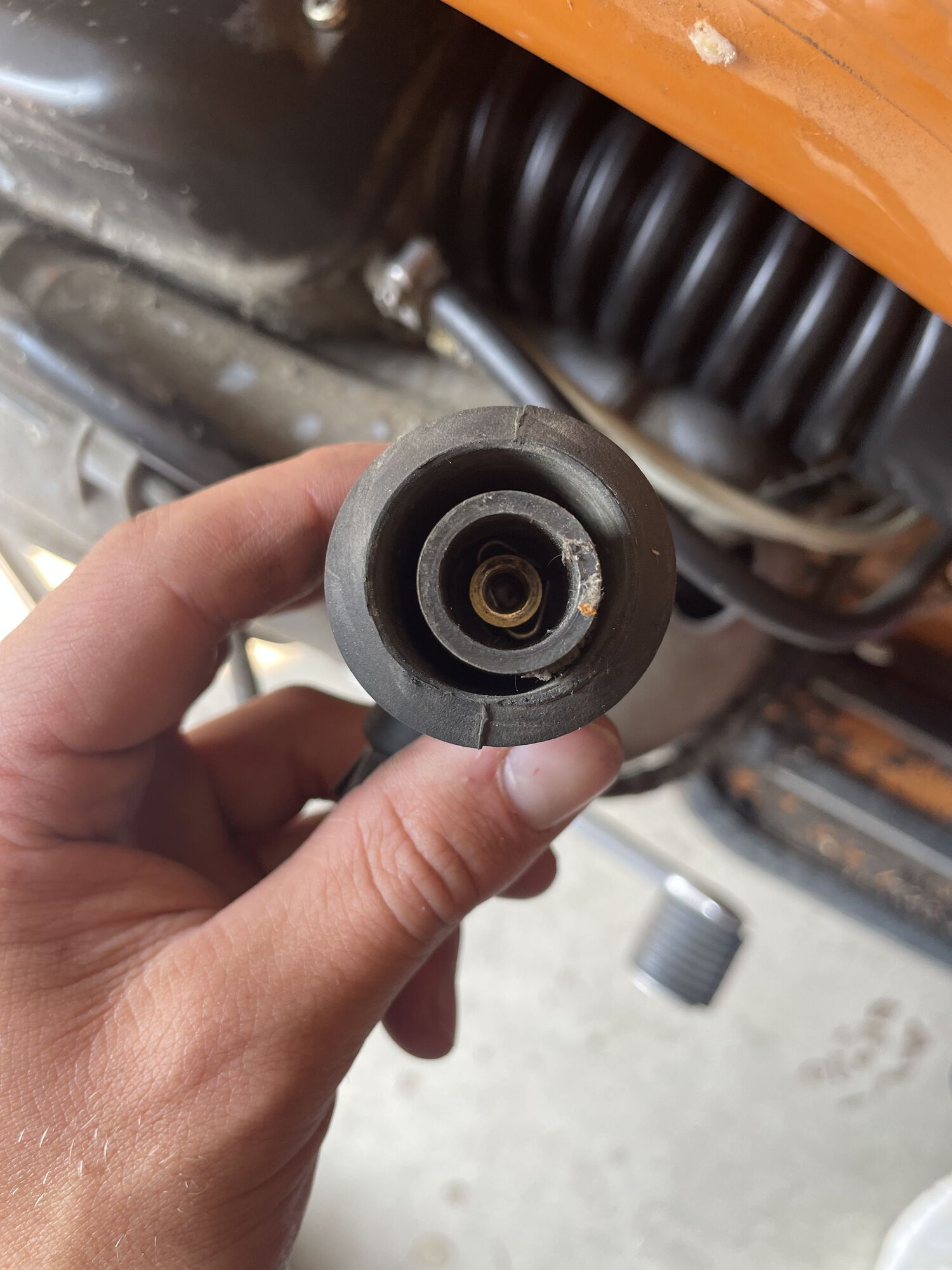

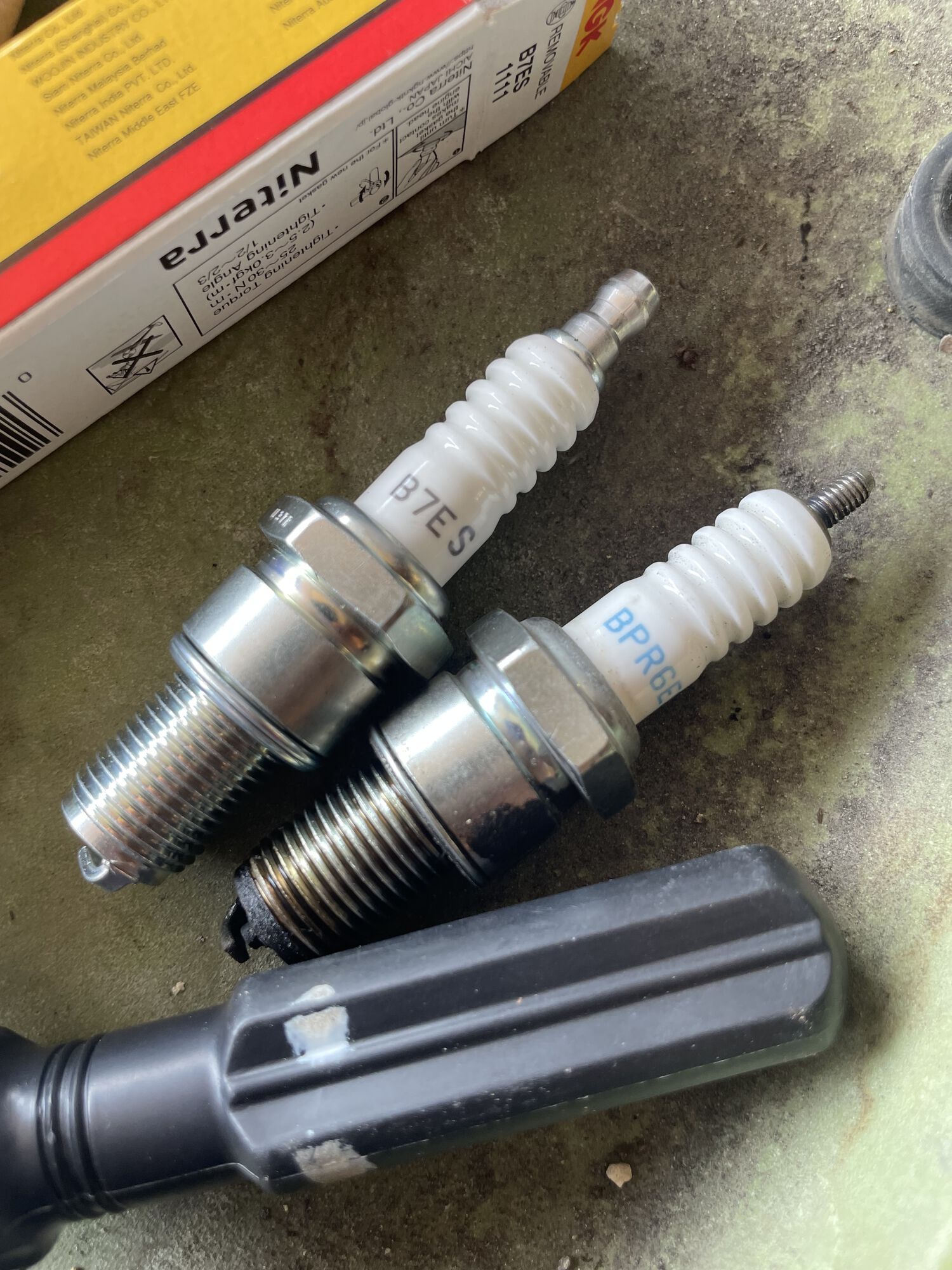

I acquired a 2008 Stella that's been sitting around for many years and I'm attempting to fix it up as best I can. I know little about fixing the scooter besides a few youtube videos. I'm trying to change the spark plug, but the old plugs' (BPR6ES) tip looks different from my new one (B7ES). Did I buy the wrong one, or is the cap different from what I need? If it's different, how do I go about changing it?

Spark plugs
Spark plugs
cap
cap

The little aluminum cap on the new plug unscrews. You can unscrew it with a pair of pliers.
Some spark plug caps snap on to the aluminum part, and some have a fine wire that rides in the grooves. Your old plug should be your example.

The 6 is the correct heat range for a stock Stella. Why do you want to go colder?

Also, the P on the old plug refers to a projected insulator, which is wrong. I would use the B7ES before I would use that. If you're stock, though, what you really want is a B6ES or BR6ES.
