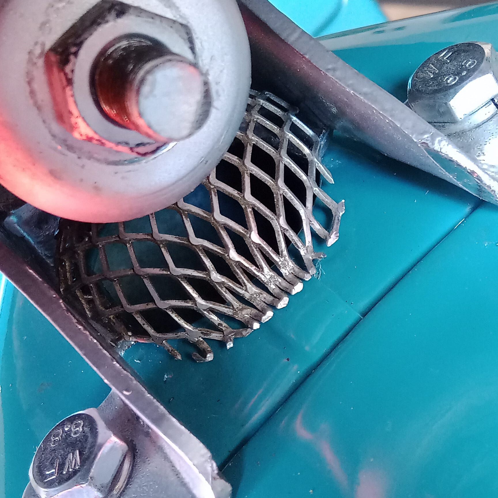

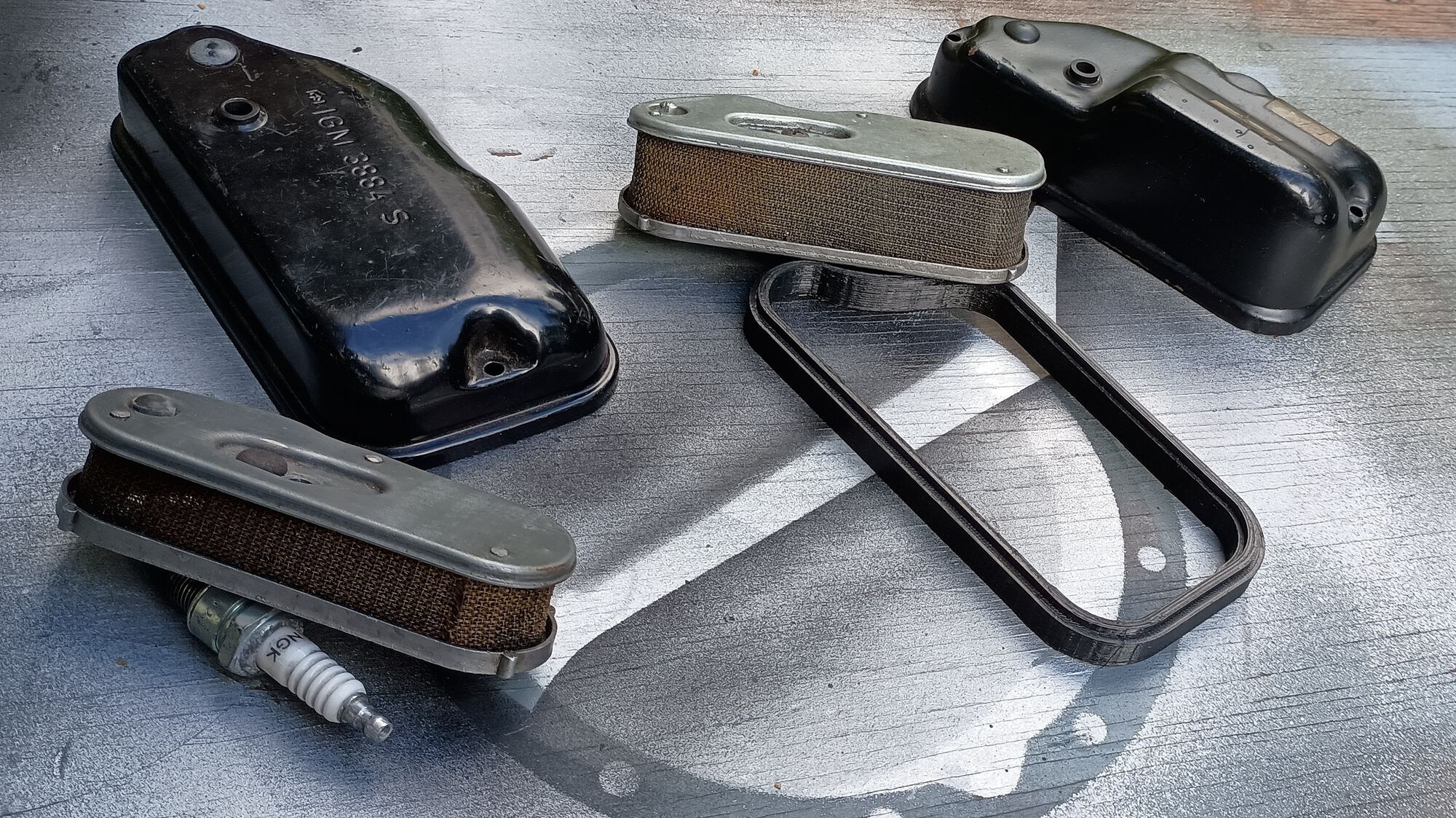

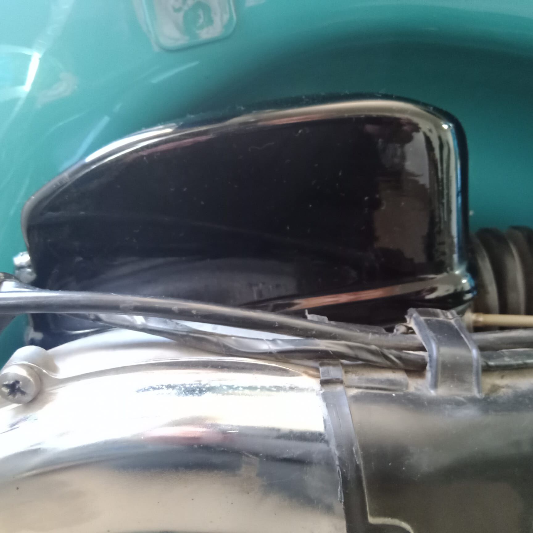

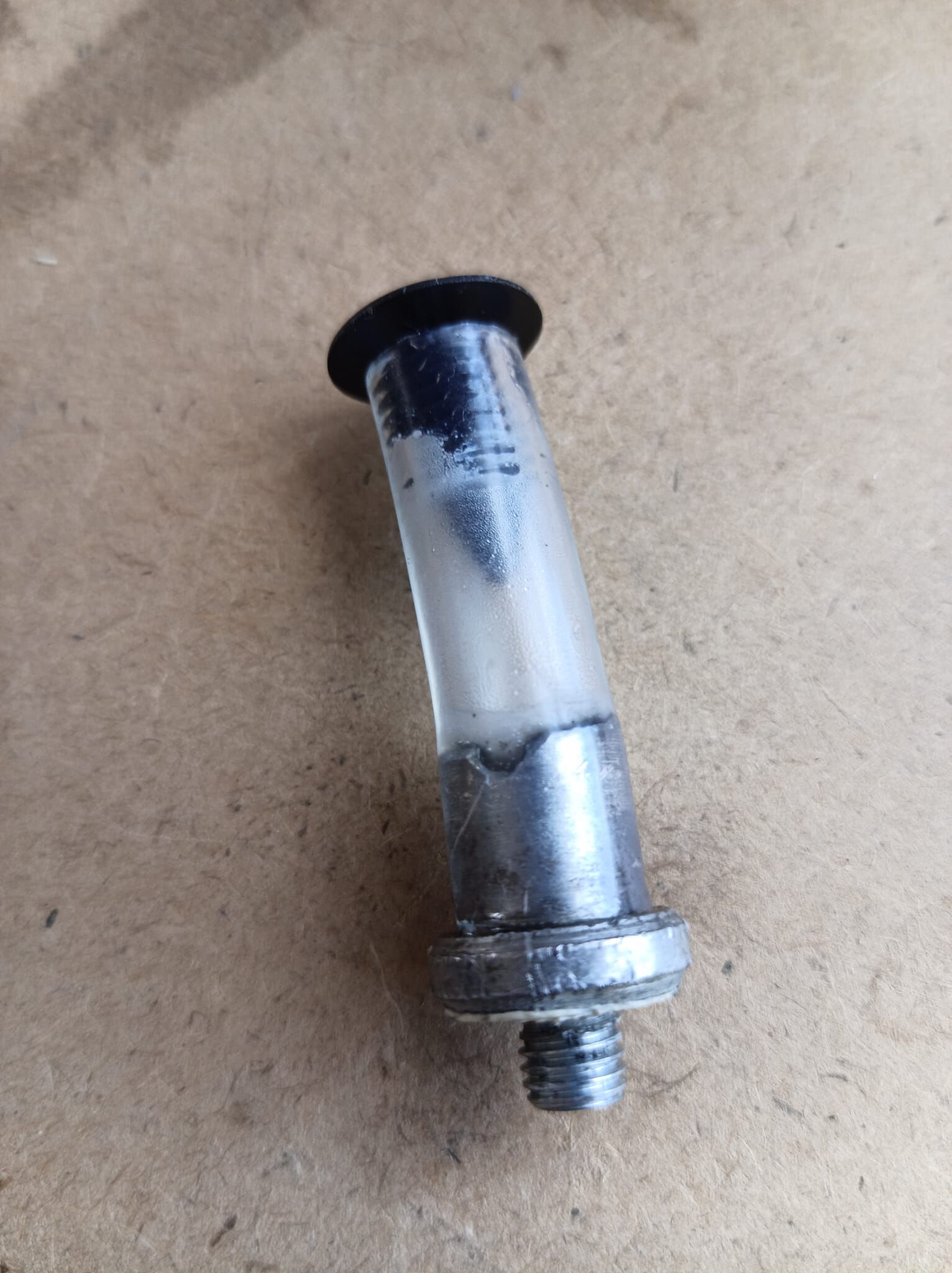

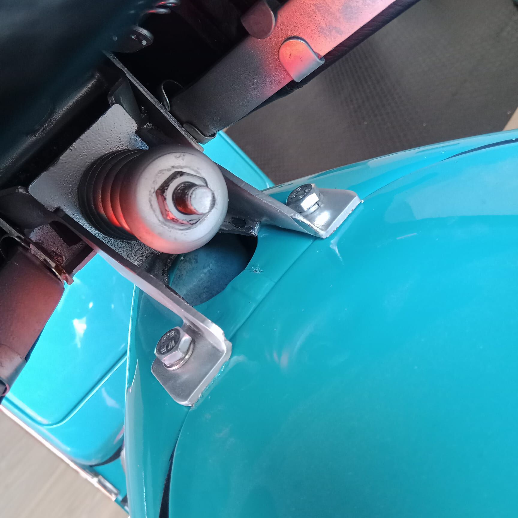

The breather with extension. Not sure how this will behave under suspension but there is plenty of free movement in the manguita.
@ray8 avatar
Posts: 2258
@ray8 avatar
Posts: 2258
So fitted the breather, tube on, clamp tight and... next realised that the oil is never even going to enter through the vent hole Facepalm emoticon
Sorry, I was going to mention that. 3mm hole into a sealed container.
Just use a squeeze bottle at the filler hole, inject it, and have the plug ready.
Or lean it to the left/lift the rear, idk. Not much dribbles out level after a 400ml squeeze-in.

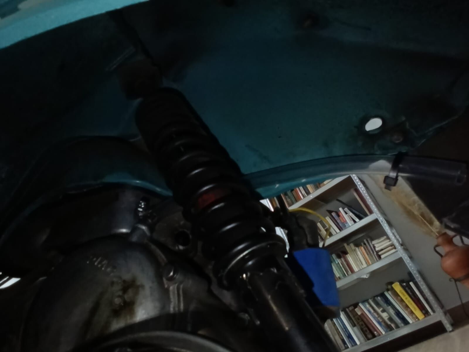

Routed the clear plastic tube up and to the back. Drilled a small hole in the black plastic mud guard extension, tie wrap loop to loosely hold the tube.
"I'd" rather see it zip-tied/zero-stress to the base of the shock.
found me two potentially rather serious faults.
Guessing that won't be the last you'll find on a bike with history.
Would have if not on the box with the wheel out.
I am not AOK with the current routing either. As the wheel studs will not be in for some days yet will try loop it up/down in front on the shock and tie wrap.
When rolling on the floor again may have a go with the dremel and cut the lower extension off of the rear mud guard plastic.
Same expectation here. Were not the first either.

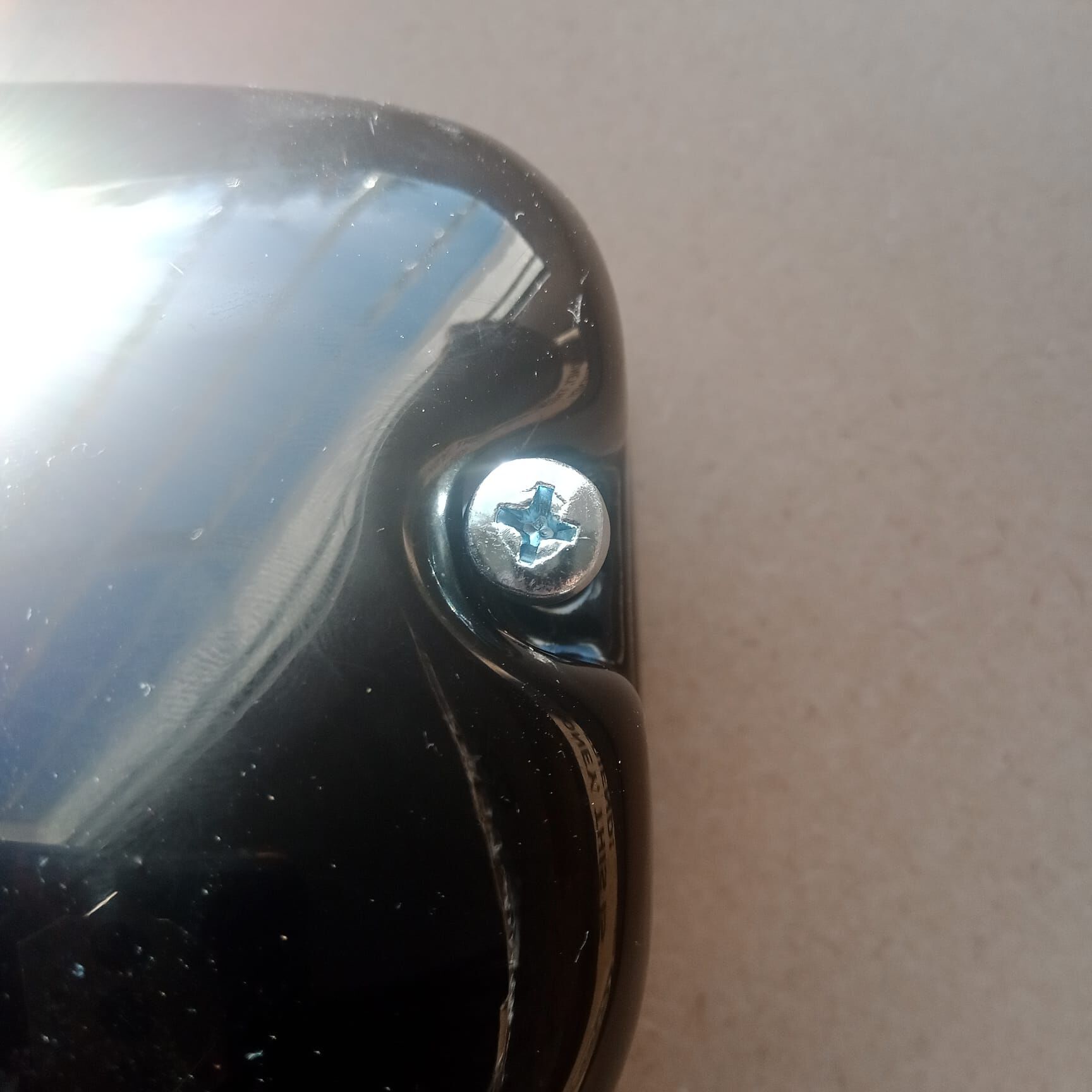

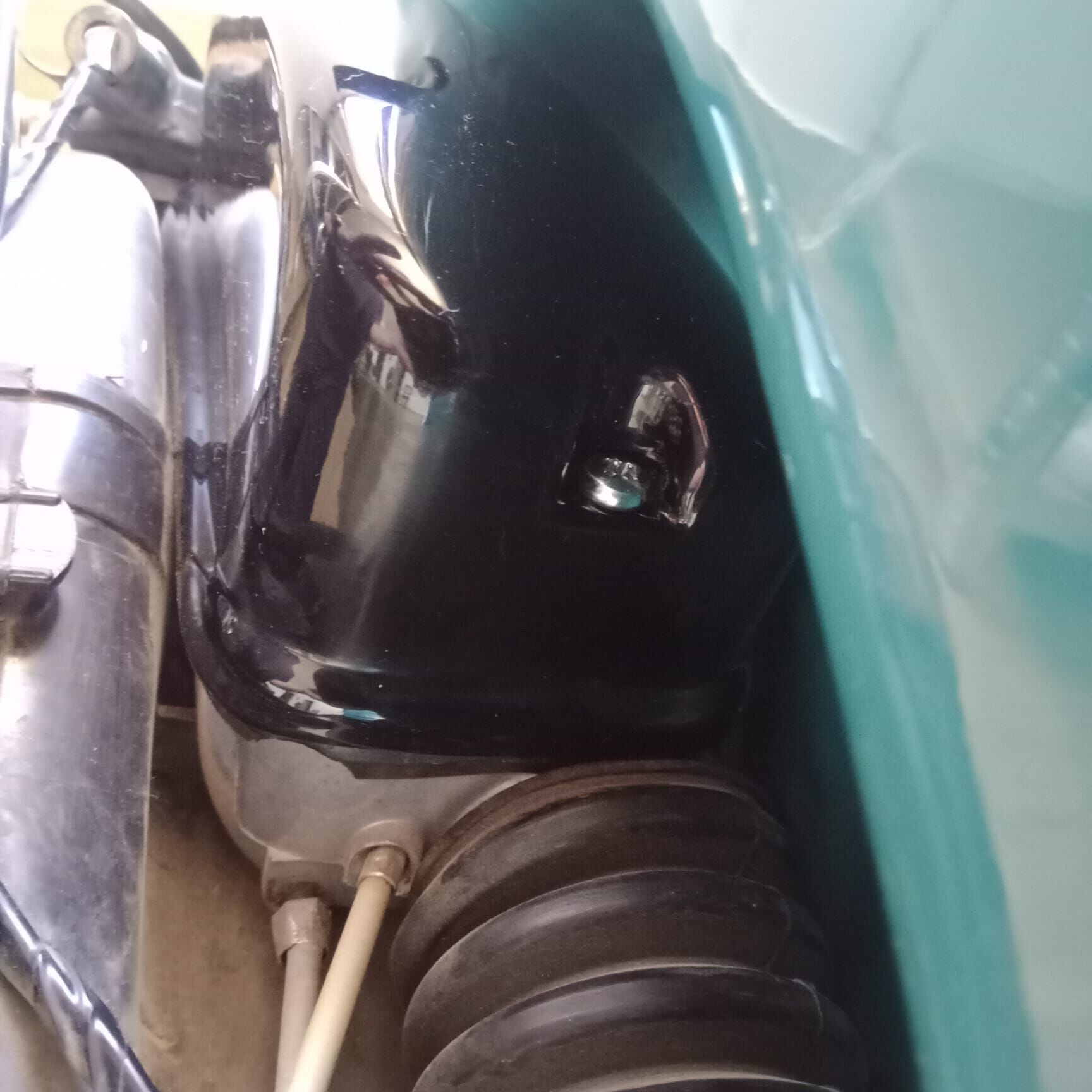

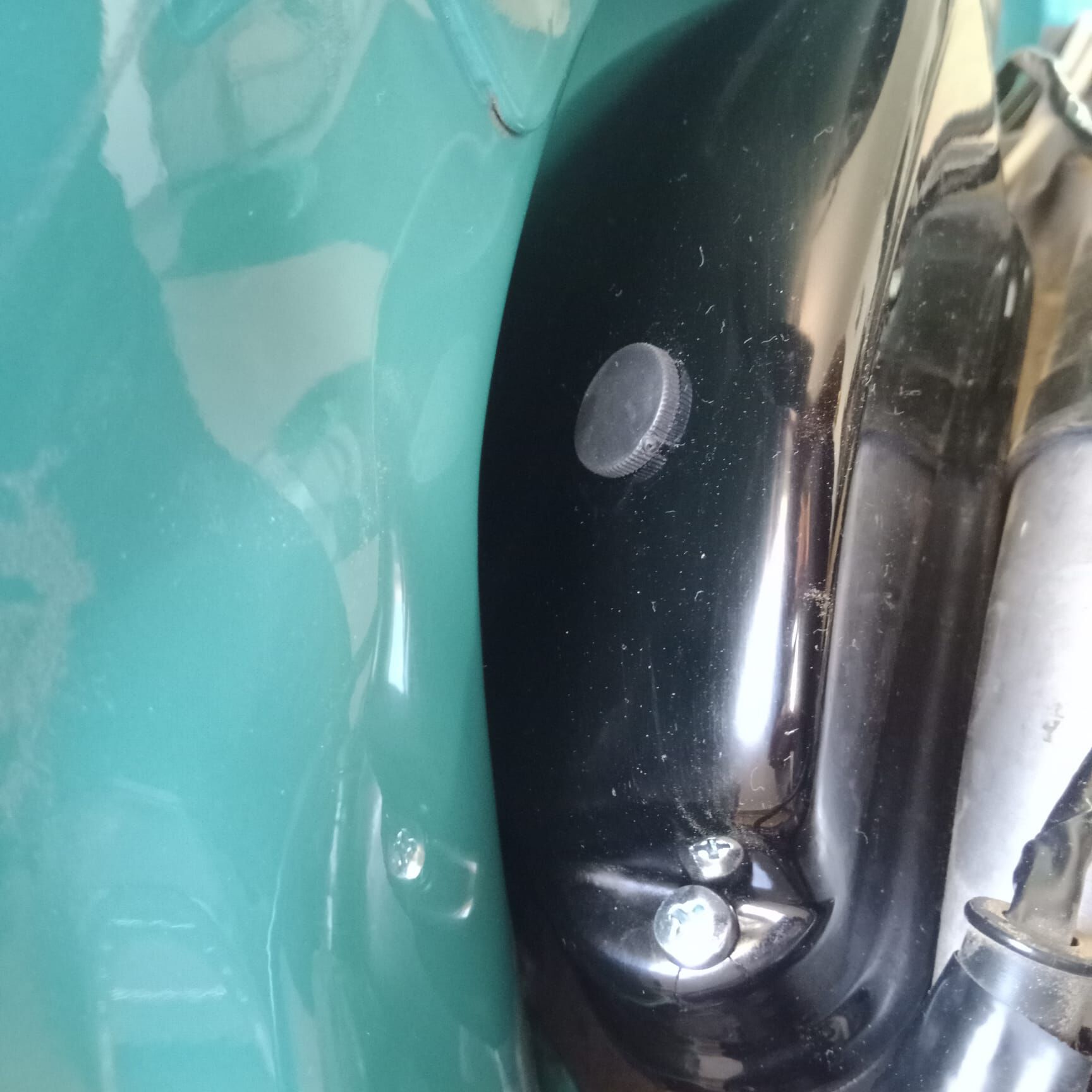

Ray8 tried routing the ´manguita´ severalwhichways but it only sits free the way I routed it to the back. The only alternative I see now is to route it up at the front of / parallel with the spring and stick it to a loop at the top. Will need to put a filtering plug in then and not ride in rain.
Maybe that will change when the weight is on the suspension but the way I ´see´ it now, the chassis coming further down twards the engine will only reduce the space.

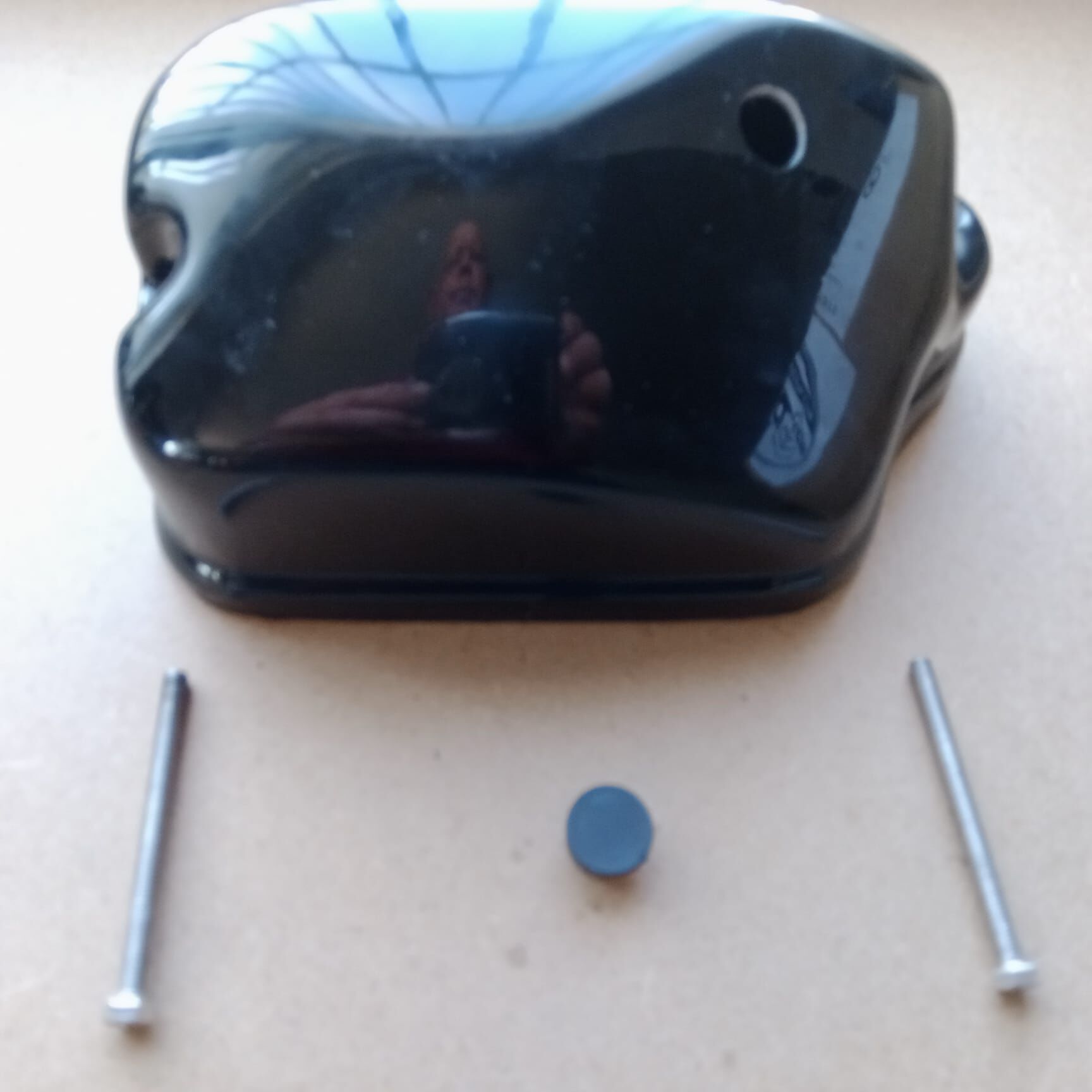

The plastic mud guard looks to be two piece design with the lower half fitted using a metal strap locating it over plastic pins of the upper half.
That upper half is held in place at the sides by the cofanos. Under the number plate unfortunately also with two screws which are inevitably and generously lathered in the velvet impersonating black muck.
Best brave the latter and have a go at taking off the assembly for disassembly. Maybe possibly even leave it off altogether depending on how that looks.
The screws turned out to be a work around to compensate for the worn original split square locating pegs.
Sadly the cofanos stick out lower than the rear frame so leaving it all off is a NoNo. Cannot enjoy áll of that weight saving
The metal strip too was a repair and the few remaining plastic pins melted to keep all in place.
Dremeled the lower rubber off of the upper plastic, strip and all. Then used a bit of the ground off upper plastic to repair the square pegs.
All in all the OEM pins/pegs mounting of the upper half is rather clever but the thing could/should have been a single piece.
The upper bit was gréy plastic painted black btw. Maybe a later LML part?
Anyway, now looking better imo.

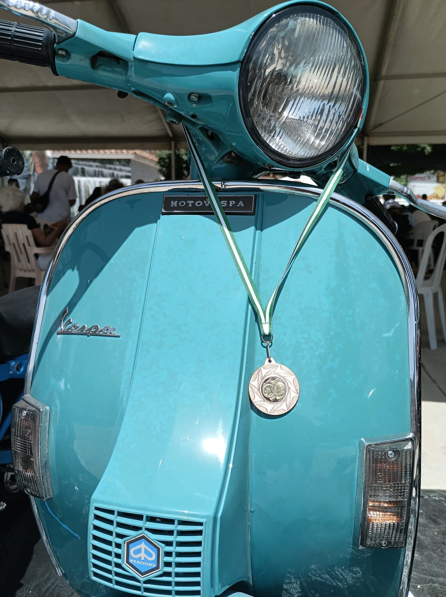

8th of March a classic event at the other, southern, side of the climate devide. First ´official´ attendence of our new classic club yeah Clap emoticon
Charming company will be on modern Red (Primavera), me on NSM Blue.
As she is a former cýcling champion but not a motorist, I have confidence in her learning asap but she does need some experience. Already tried Sundy morning laps on an industrial estate. Today first proper ride out and back.
Blue is running really nice now and the extra oil in the clutch works a silent treat. Only one up, she is delightfully quick and flexible. Lóve it. Cruising 80 km/h and just about no vibrations is
Although old Vespas are far from a rare sight, in the cities even common, the aquamarine drew a lot of attention. Even asked if they could take a photo
Tanked up and back home charming helped me refill the lube tube. I have two in the glove box so no way I will run out with a tank full and the second aboard but feels better to have two
Was oddly satisfying to refill together. Makes me think charming is réally into it. Níce that.

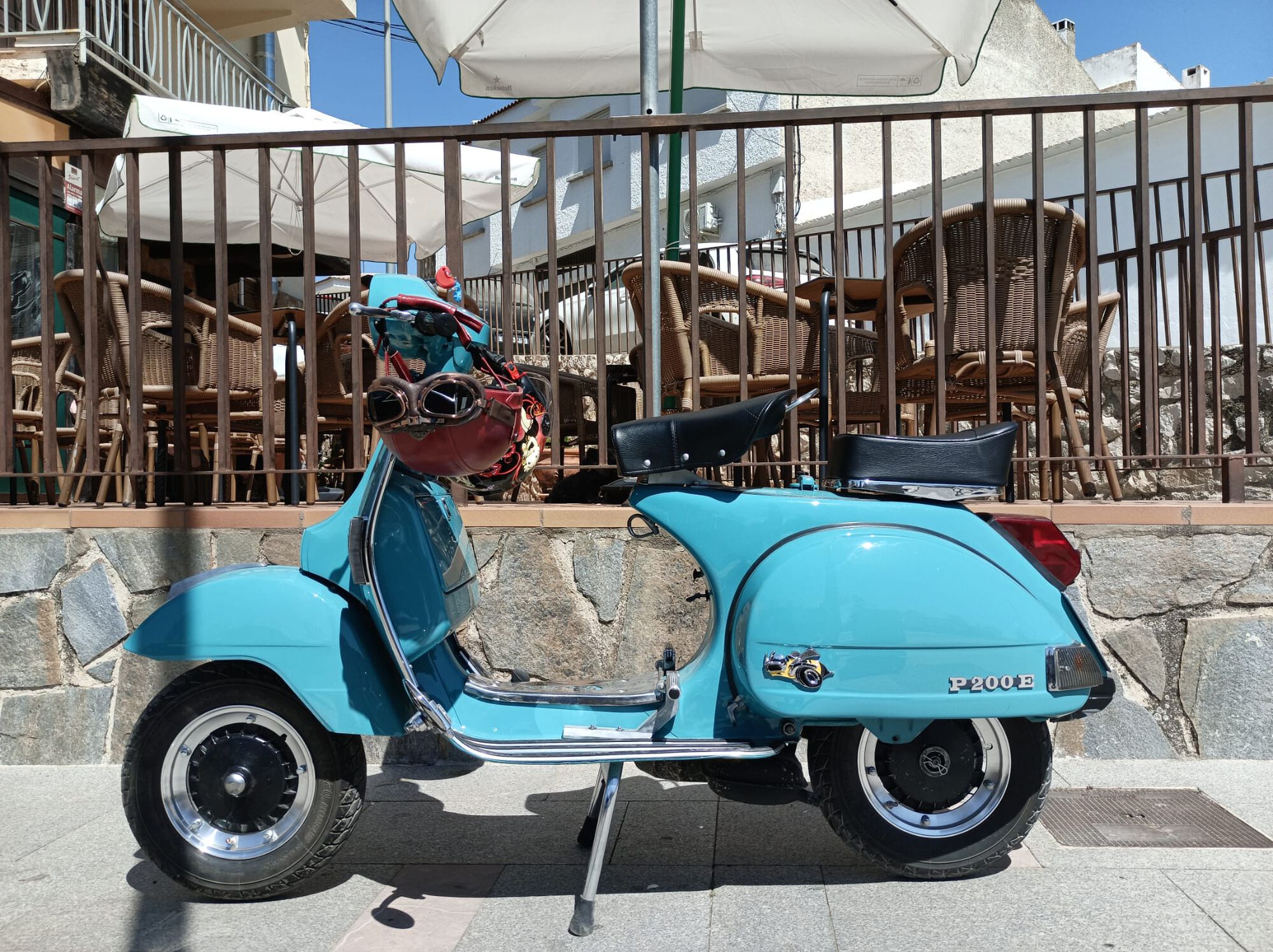

The first classic event in the region. Was postponed because of a-typical persistent rain.
Was fun. Only one NSM Vespa: Blue.

Photo of arriving at the event Saturday.
The picture illustrates nicely why my top speed in Blue is not a yard stick

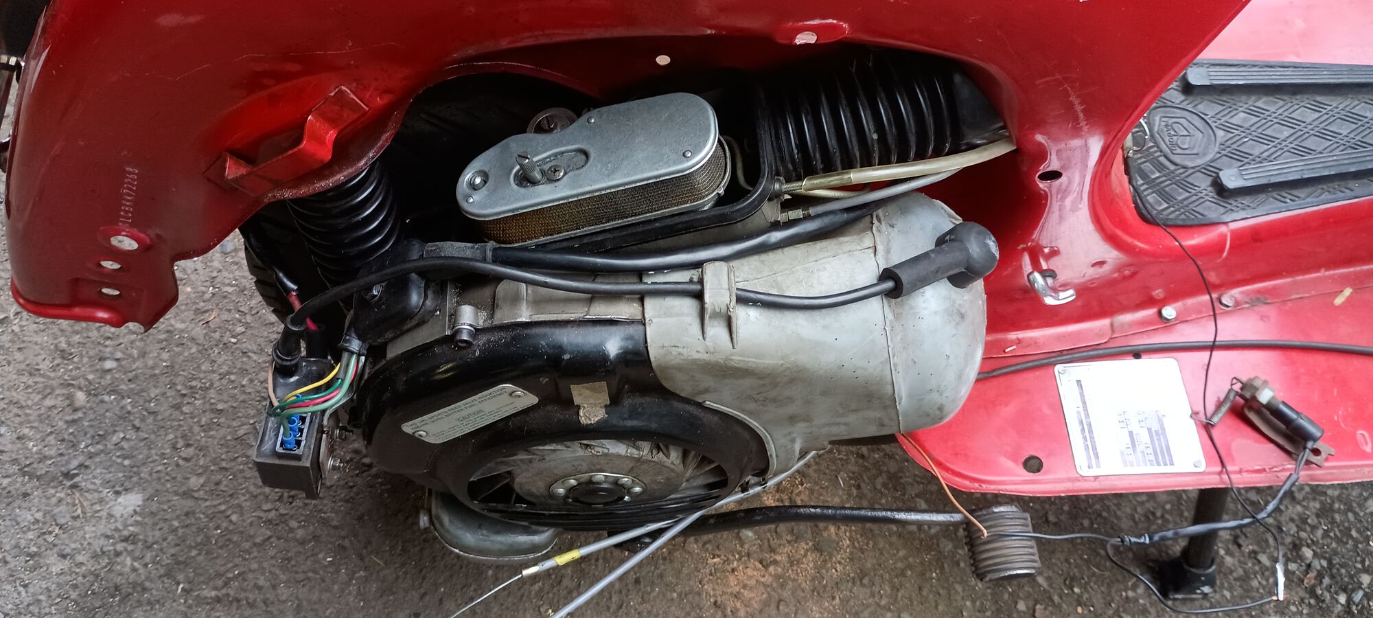

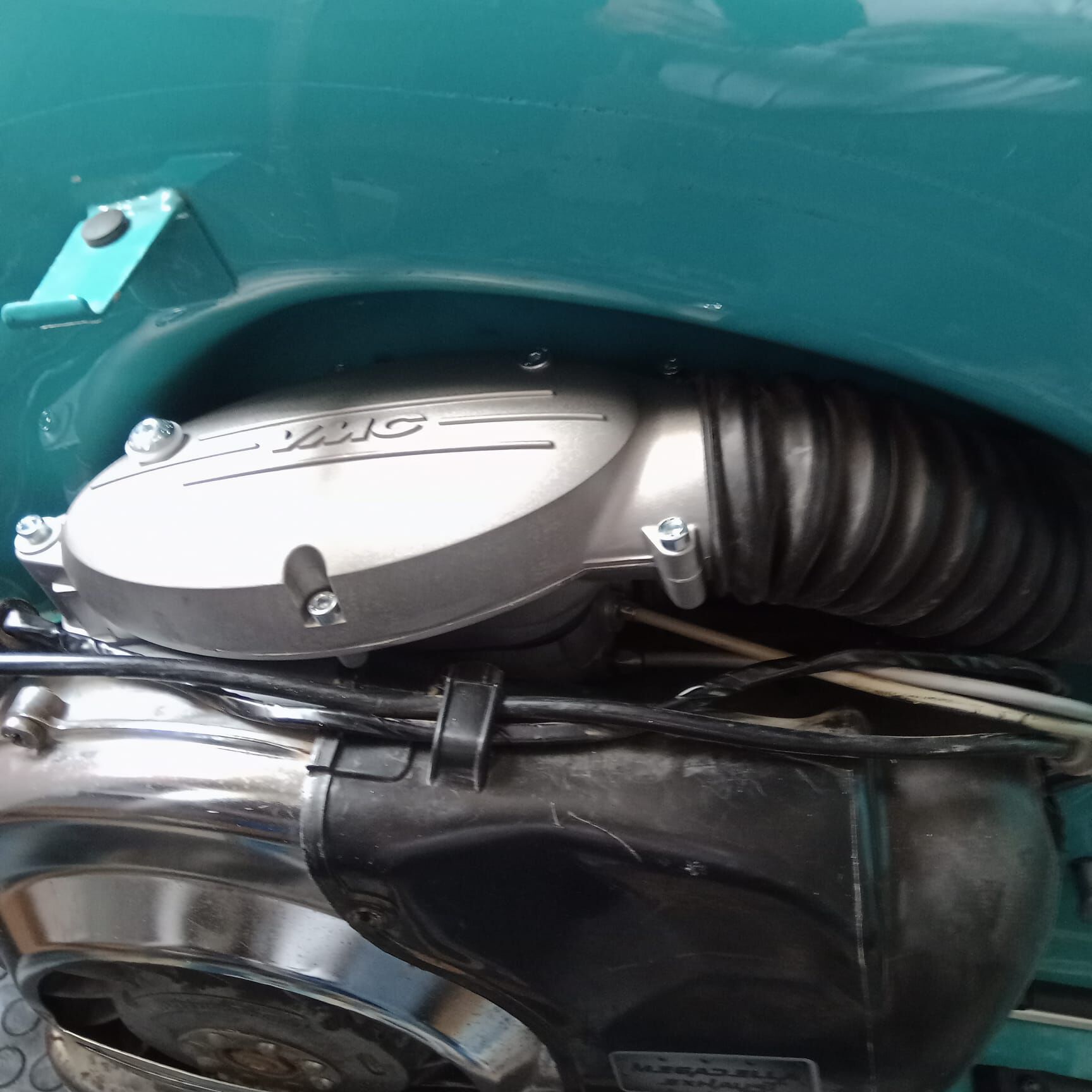

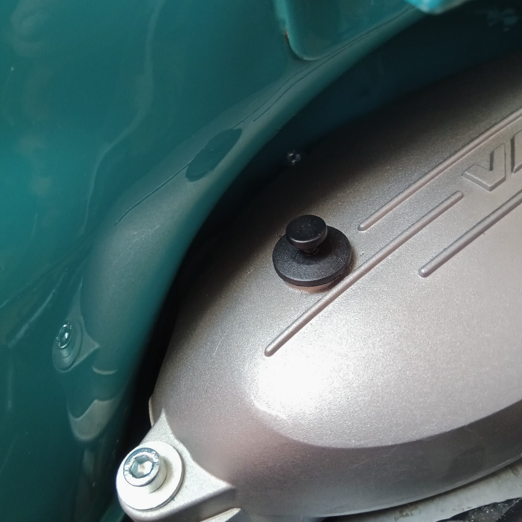

Not happy with the clutch breather. Have put the EGIG one is my shopping basket.

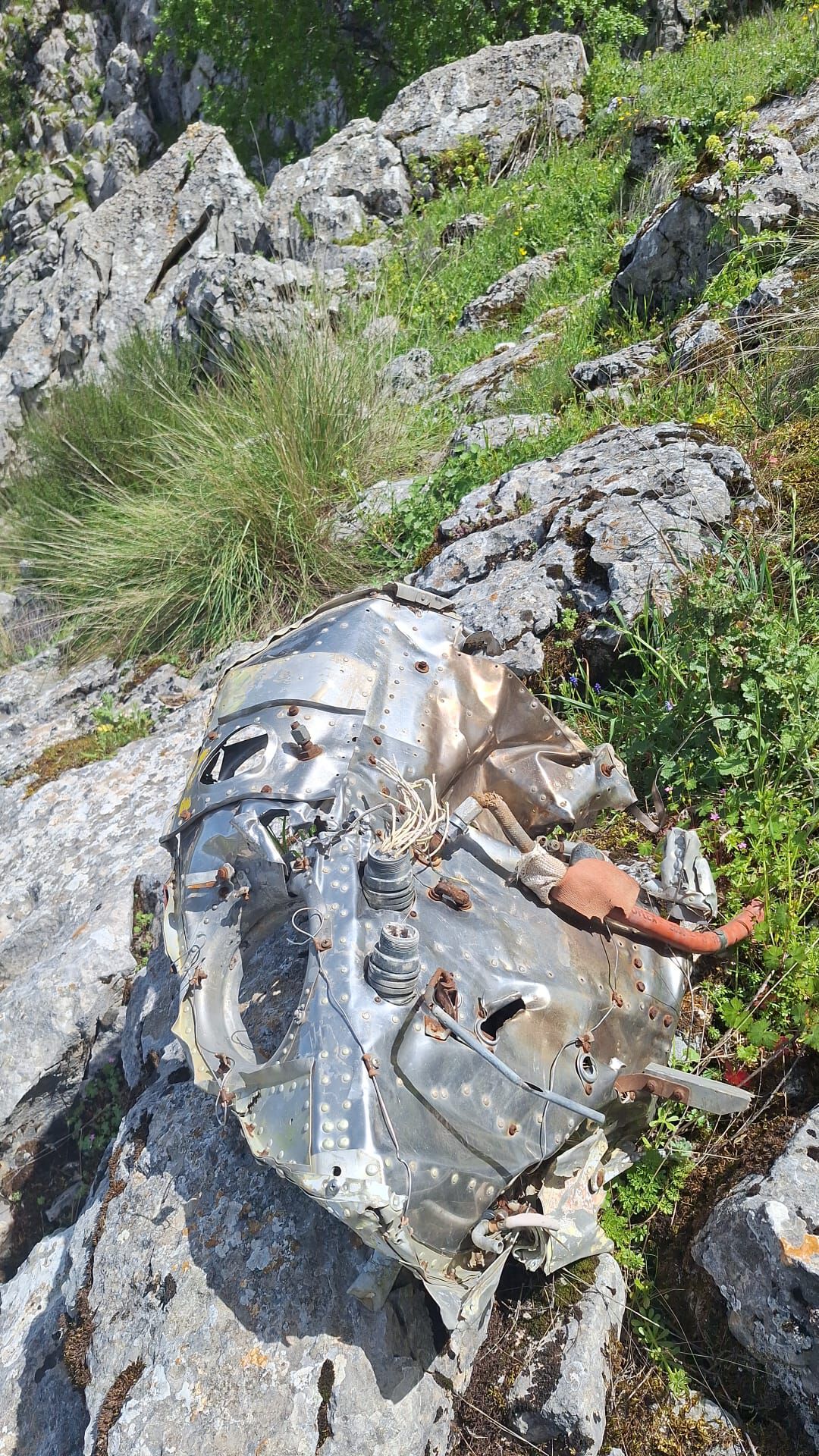

The mountain ridge behind/above the village ´tells´ many stories. The last larger tragedy was a light aircraft with 6 people abord which only júst failed to clear a peak. Cause was/is ???
Today climbing the ridge came across parts.
The first photo is of the site where it is.

Apart from a highly enjoyable day and good feed back on my PE´s performance, some work to do:
- The vent on the clutch cover is not to my liking so having another go.
- Rear brake locks up. An improvement in slowing down but not much it at all safer.
- And when looking at the rear brake will look at the only marginally more than token front one too.
- Will find something more.
@petrus avatar
P200E DN 1982
Posts: 1211
@petrus avatar
P200E DN 1982
Posts: 1211
Rear brake was a Facepalm emoticon
The new shoes were fitted without chamfering the leading edge. I should have spotted and rectified this so mea culpa
I fitted a way shorter tube to the vent and gave it a little roof. It is like the VMC solution now.
Sofar all good and no weird surprises. Maybe I feel lucky enough to take the front wheel/drum off...
