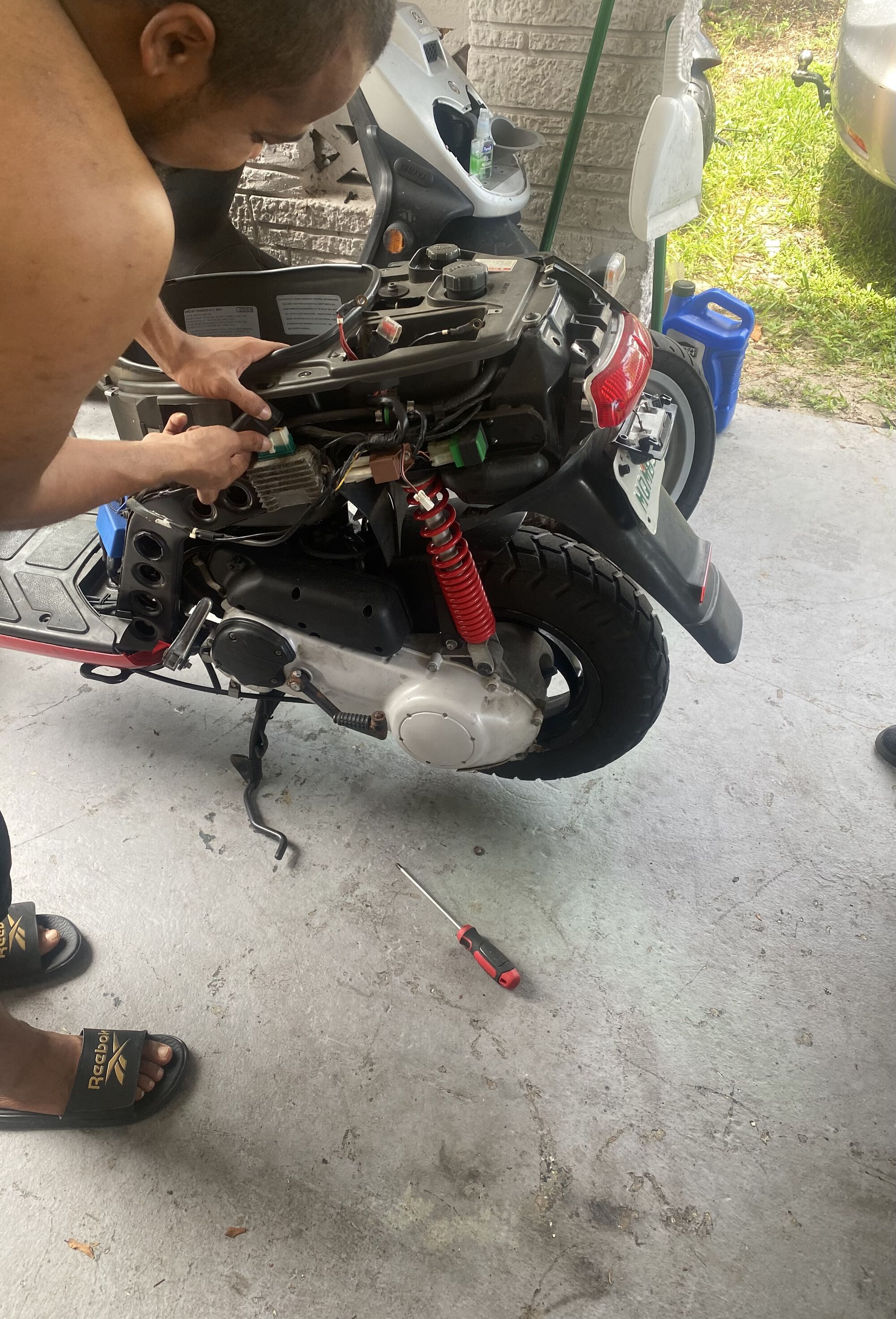

Figuring out wiring and removing engine.

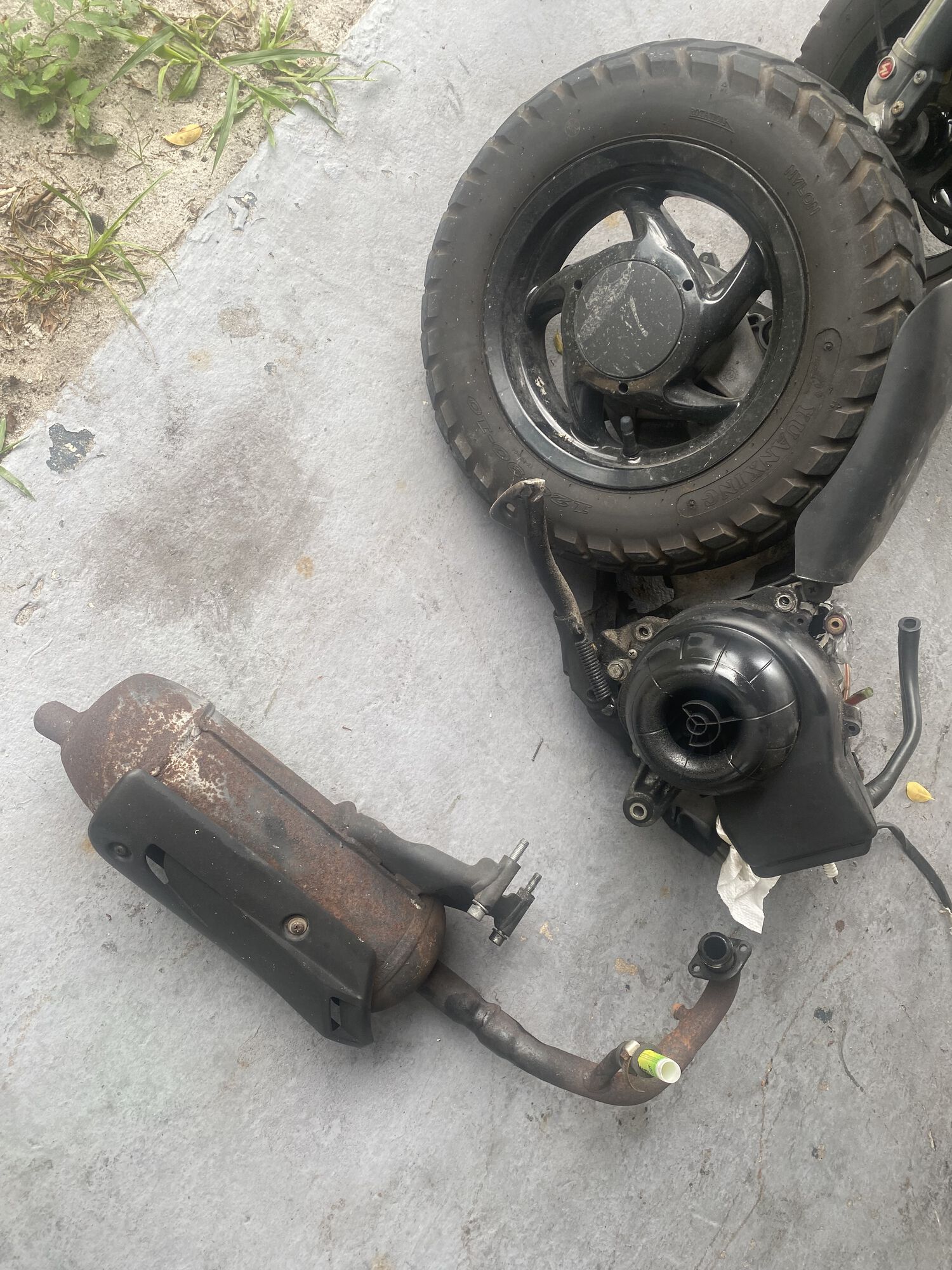

50cc engine removed.

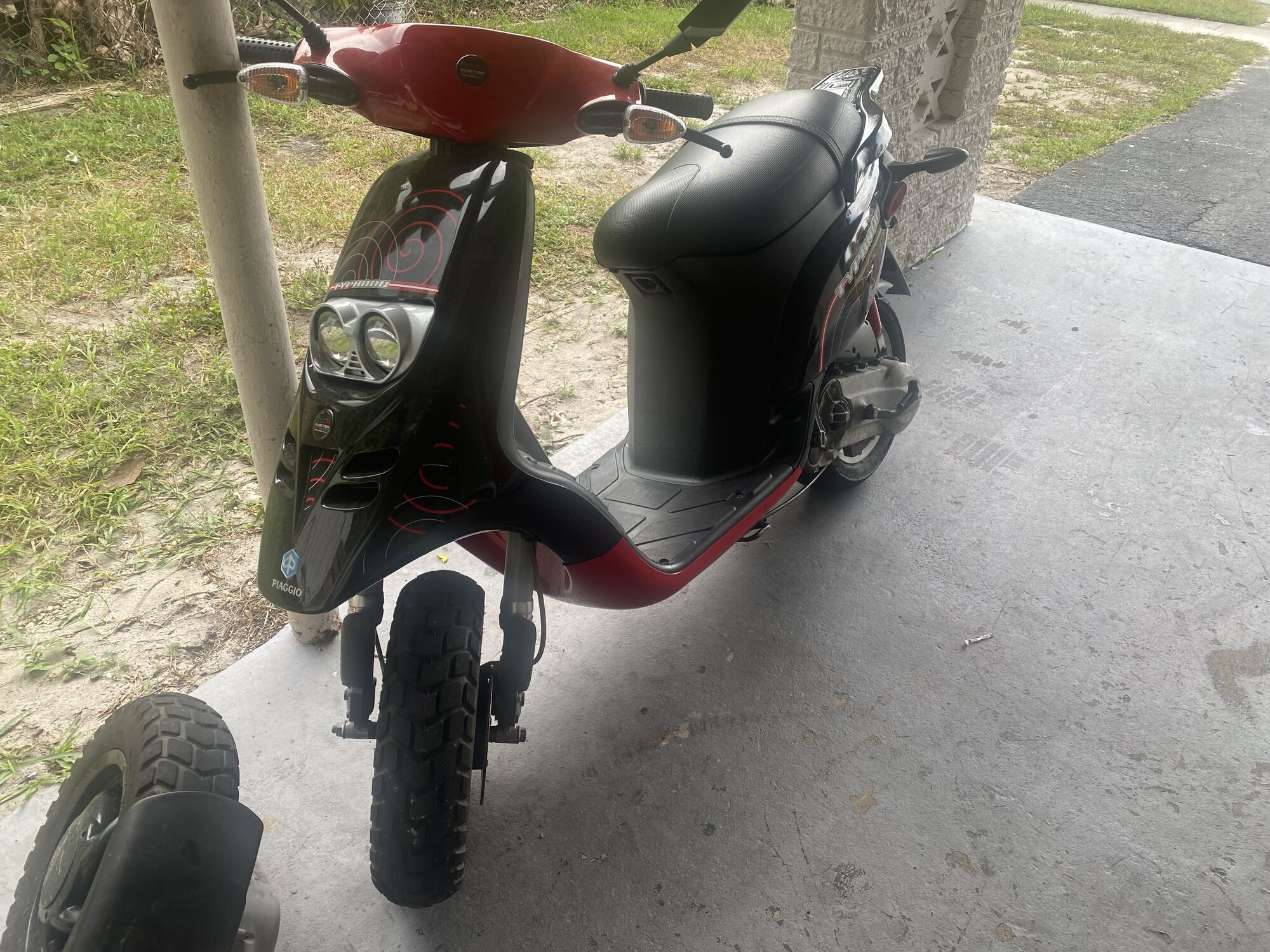

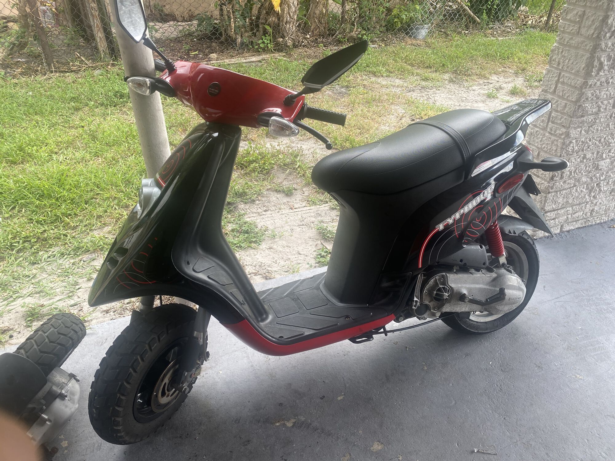

And there we have it folks, bone stock, even has the tiny 17mm carb from the 50cc. Runs smooth like butter.
Much faster than before. If i add any upgrades i will be sure to post them.
