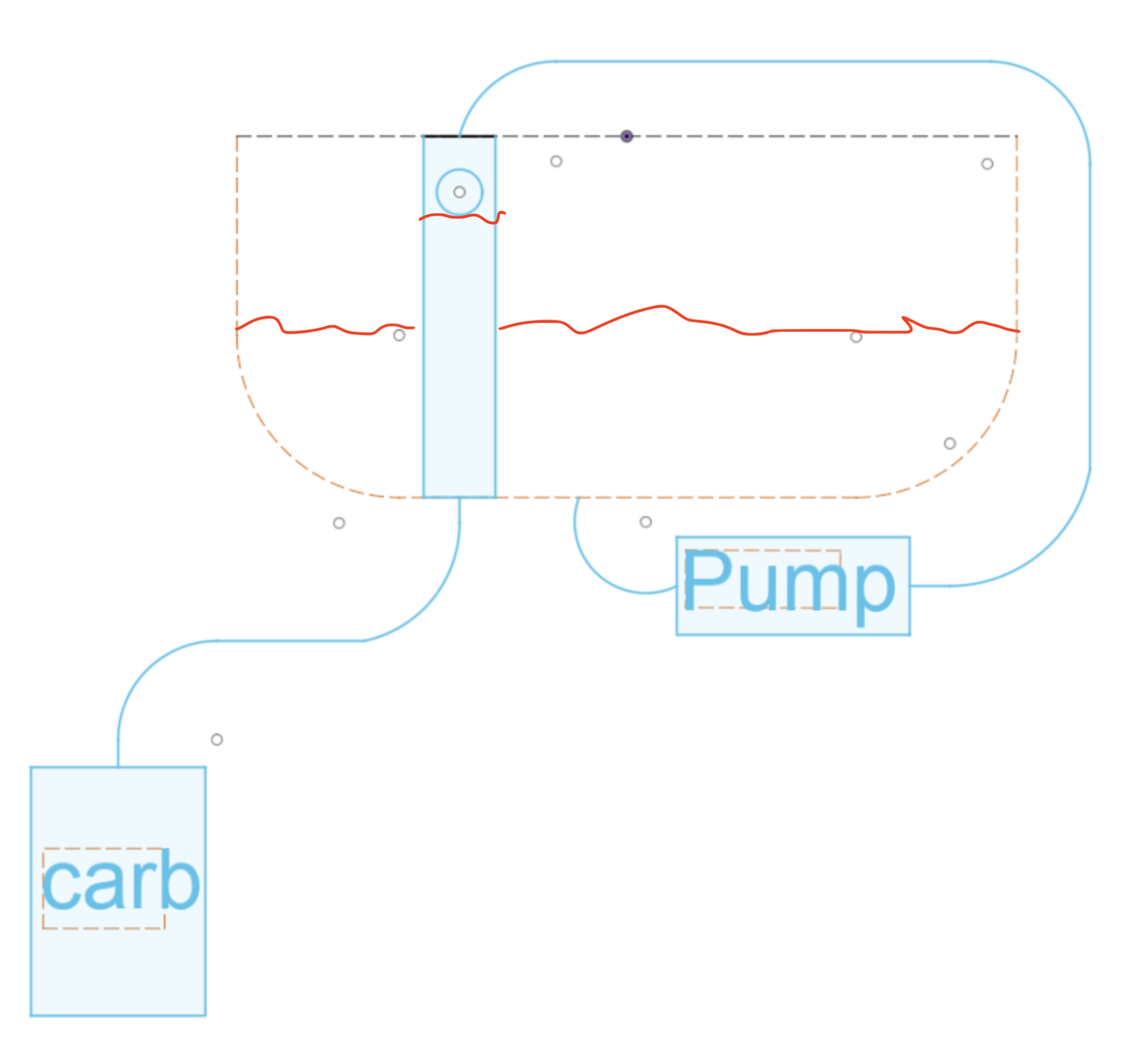

another thing Iv'e kicked around when a pump is in the loop...
the outlet from the bottom of the tank can be inside a large diameter tube that runs to the top of the tank but is open to the rest of the tank.
the pump can then dump into the top of that tube so it fills the tube to the top and then the rest overflows to the rest of the tank. This simplifies the plumbing and gives the carb the same head pressure all the time.
Great idea, i like your thinking.
The tanks with oil reservoir could be the go, as the pipe is already there & goes thru the tank, therefore it only needs a few overflow holes
