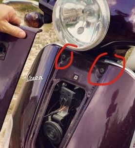

Even though LX150 parts are easy to look up, i can't seem to find what the proper size is for the glovebox-to-frame screws(the one hidden in the horn cover)
The heads on mine are starting to strip so i was lookin to replace em
Are ya'll able to lead me in the right direction? Hehe thank you!

Only a few times really.
Last i removed them, the left side was super stuck so i had to use a bit of force so it did a bit of damage on the screwhead

Metric screw M6x22
CM179302
I think!

Yep!!
Was able to replace both rusted af screws
Thank you so much!
