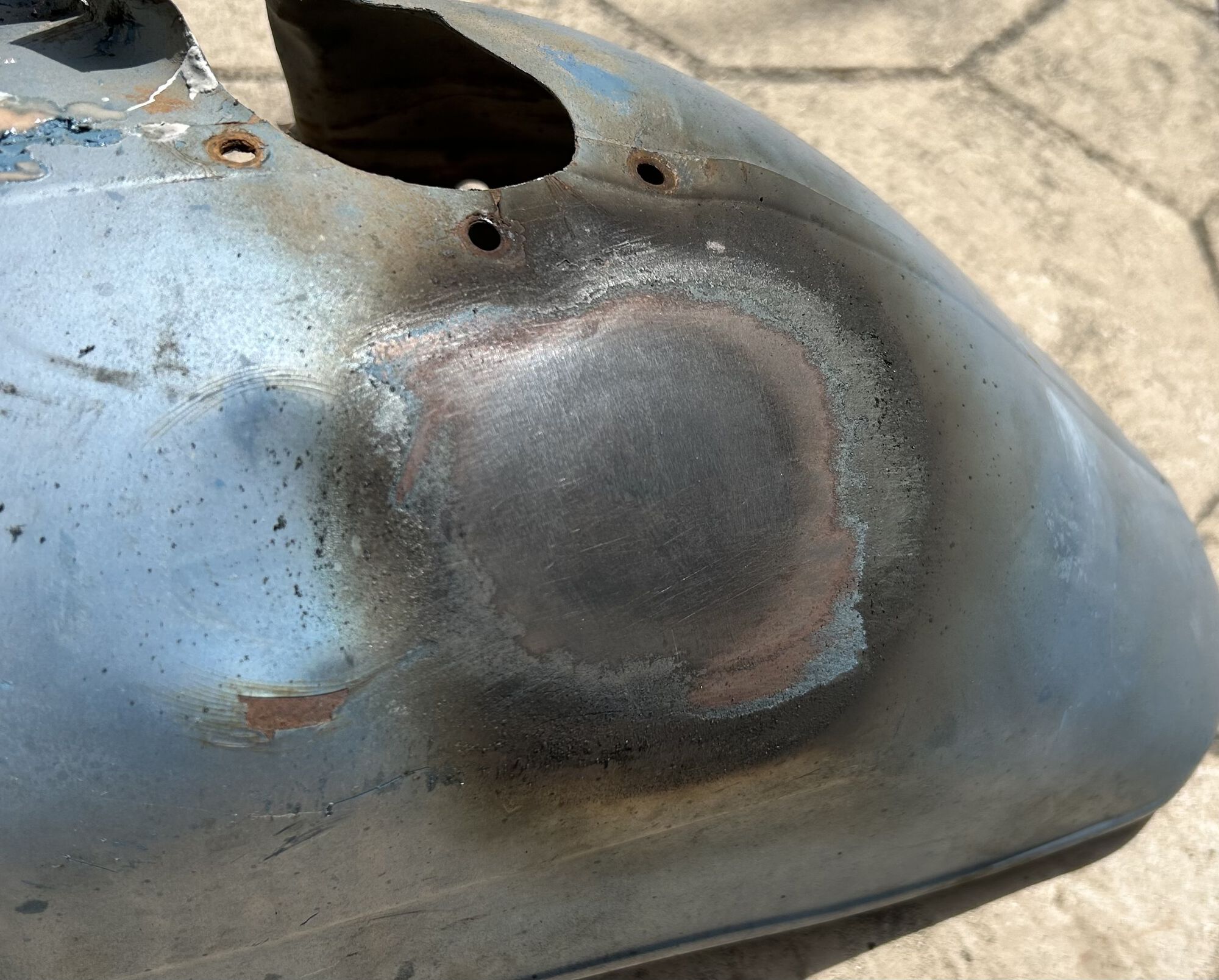

So I'm taking my old VBB down to bare metal. I've read that one method is to scorch the paint with a torch until it bubbles, then just scrape it off.
I tried that, with a butane torch, on the VBB's old, crushed fender. The paint bubbled quickly and came off easily, but the metal became dark and discolored from the heat. I.e., not shiny like where it has been sanded or ground.
Is the discoloration a problem? Will it affect the primer or paint? The paint came off so easily that it was a real "Eureka!" moment—I could see how I was gong to get paint out of tight edges and difficult spots.
But the discoloration gave me pause. Heat is tempting, but I don't wanna use it if it's gong cause problems later in the painting process.

Actually, that hadn't occurred to me. I wasn't worrying about deforming. My concern is that the heat made the metal darker than if I sanded/ground paint off, which leaves the steel all shiny.
Is the darker metal a problem in any way, as far as primer or paint is concerned? If not, I'm tempted to go at a lot of hard-to-reach places with the torch.

Don't think so. Post a pic. The darkness may just be surface staining that can sanded off. Either way you'll be priming before your paint, which will cover any discoloration of the metal.
Posts: 7681
Posts: 7681
Does the dark discoloration wipe off with some solvent? It may be just soot from the gas/paint combination.

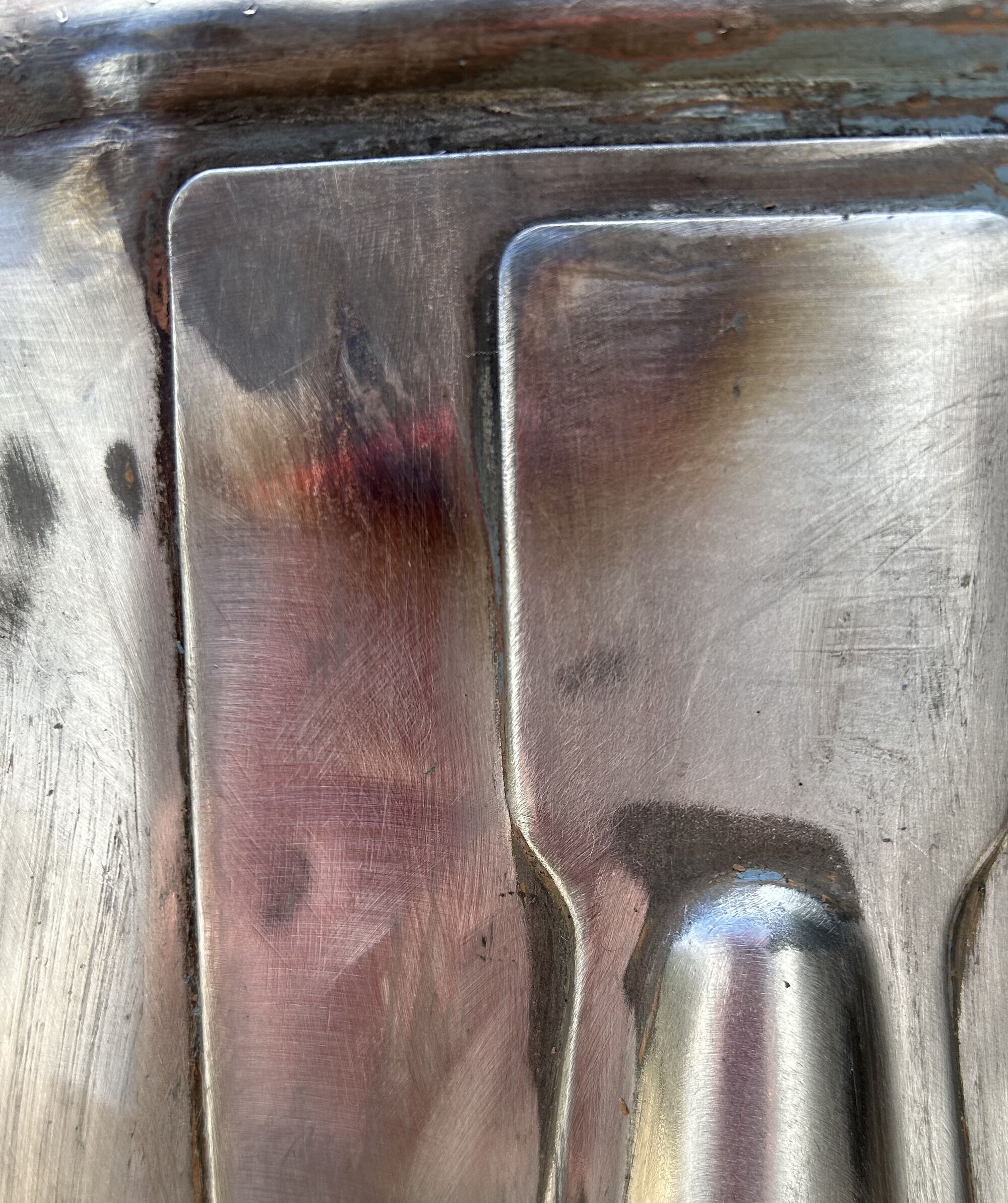

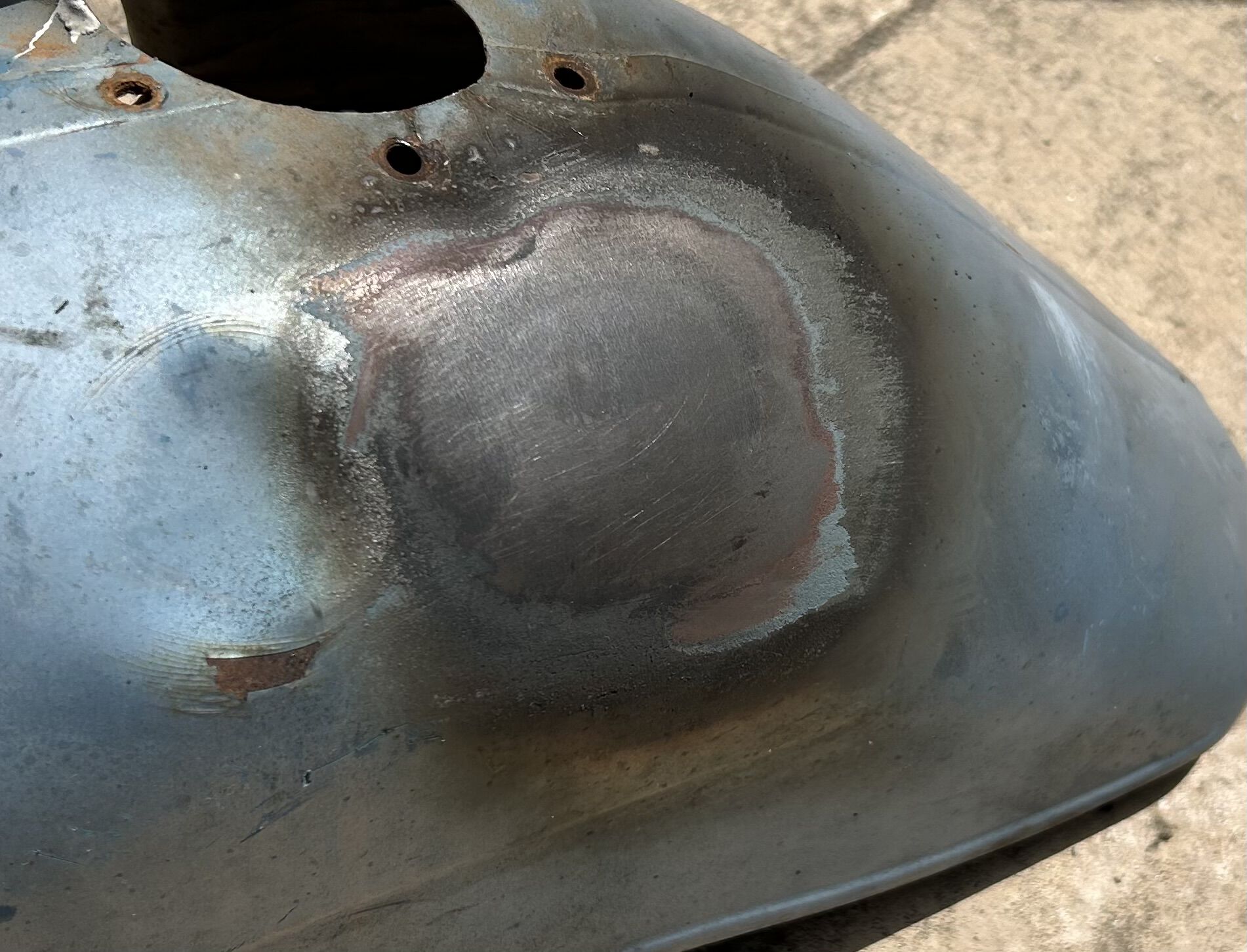

Well, I tried some lacquer thinner on it, and scrubbed with steel wool. A LITTLE change, maybe 30% better, but no a lot
Here are before and after pix, plus a pic from the top of the leg shields where I took a little paint off with heat. Thinner & steel wool did a little bit, but not a lot. The discoloration seems to want to hang around.
Before
Before
After
After
The quarter-moon curve is from heat

If you sanded it, you would end up with clean steel. Even if you heated it enough to weld it, the surface discoloration would sand off.

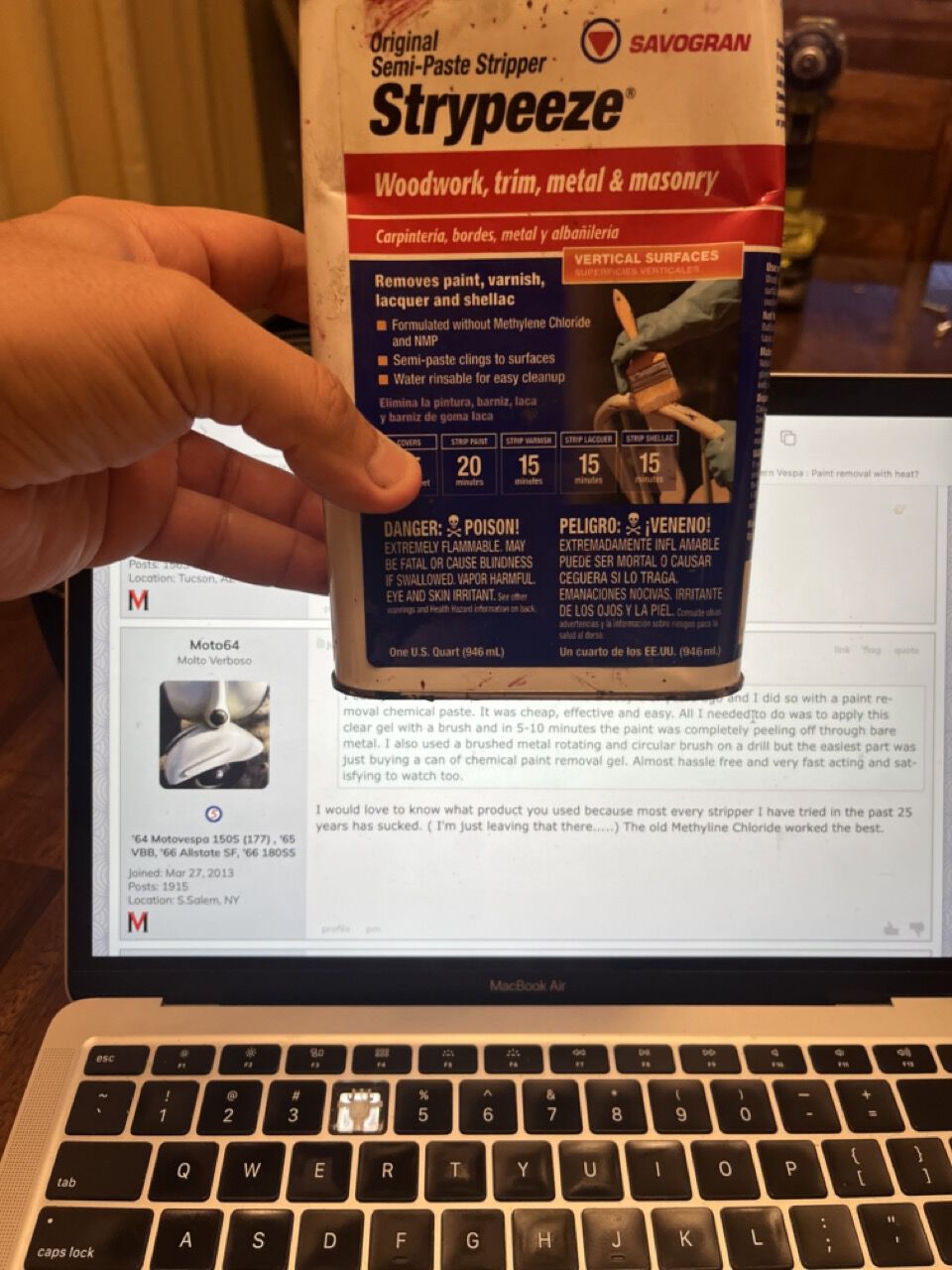

I easily removed the paint of a Lambretta a couple of years ago and I did so with a paint removal chemical paste. It was cheap, effective and easy. All I needed to do was to apply this clear gel with a brush and in 5-10 minutes the paint was completely peeling off through bare metal. I also used a brushed metal rotating and circular brush on a drill but the easiest part was just buying a can of chemical paint removal gel. Almost hassle free and very fast acting and satisfying to watch too.
I would love to know what product you used because most every stripper I have tried in the past 25 years has sucked. ( I'm just leaving that there.....) The old Methyline Chloride worked the best.

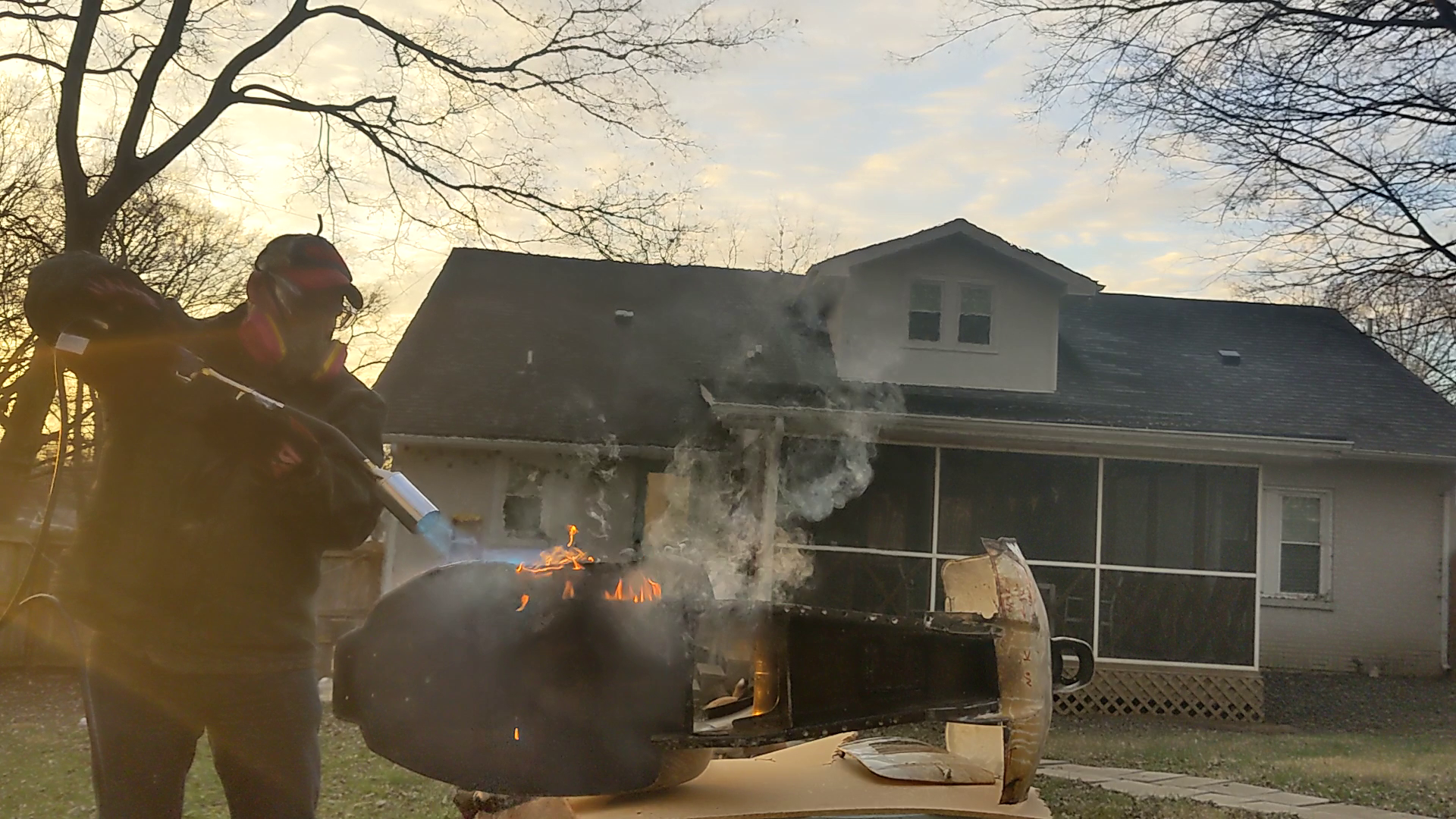

I don't think there's a stripper on the market today that works worth a damn on OG Vespa paint. Leaded paint is just too damn tough.
When I stripped the Boobadge, I used a big propane torch and after I'd burned the paint (OG paint with rattle can over that), it pretty much fell off when I hit it with the wire wheel.
The entire process took less than half an hour for both the frame and the mudguard.
You're my kind of neighbor.
Imagine a whole neighborhood of scooter guys…

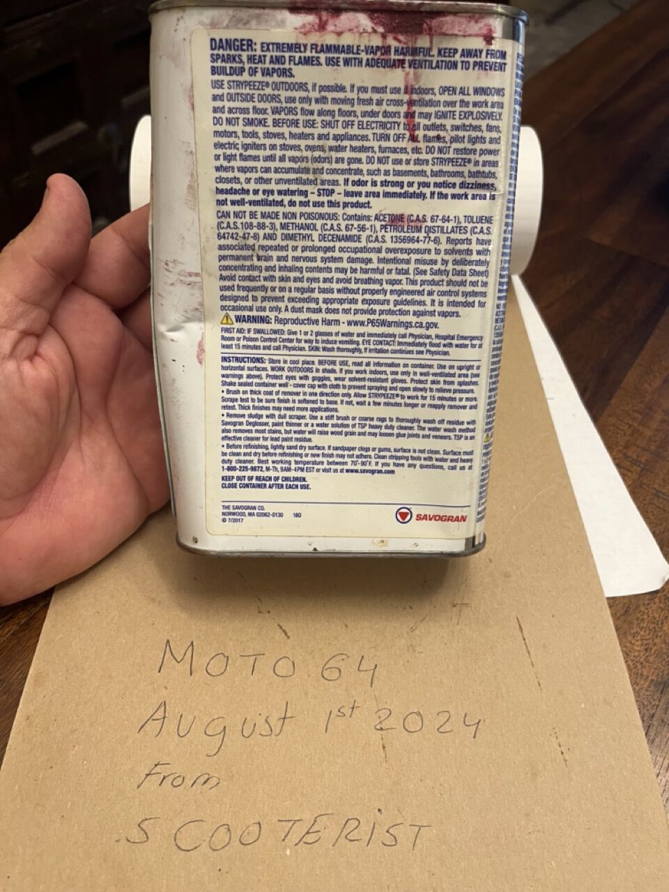

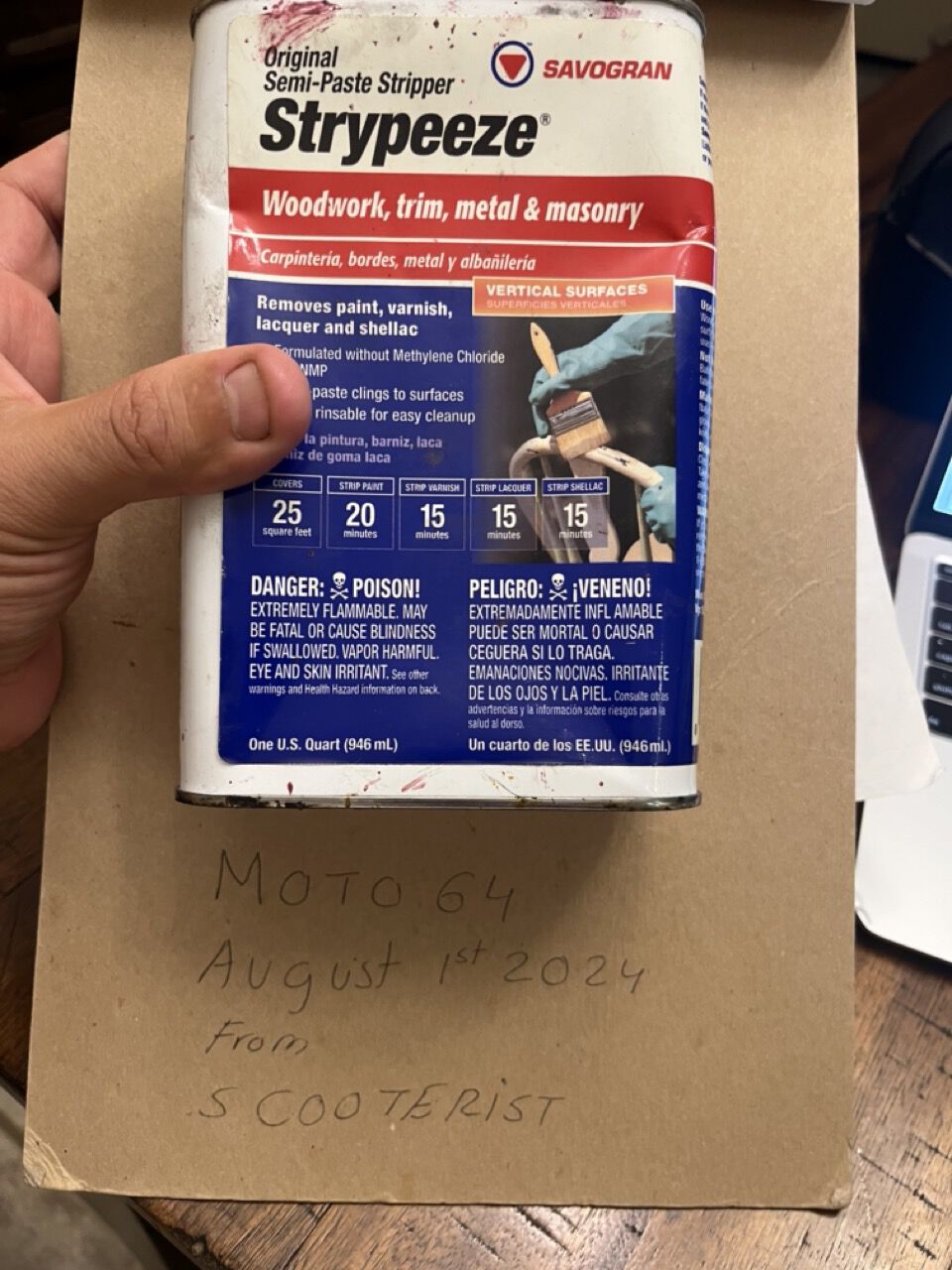

Sorry for the late response. This is what I used and it worked so well and so easily. It peels off the paint as if you are burning it with a torch and you are watching it in Timelapse. You just apply it with a brush, it is a clear paste, jelly like and after a few minutes the paint softens so nicely that you can remove it with a scraper or a rotary metal brush. I stripped a entire Lambretta and I had a lot left on the can.

Depending on where you live you might not be able to get methyl cloride stripper. A bunch of states outlawed it and most auto parts stores stopped carrying it anywhere.
It's still legal in PA and I can order it through McMaster Carr.
If you spread it on, let it bubble up, and clean it off with a pressure washer it's pretty easy. I do it outside where there's weeds I'm trying to kill.

I know the brand and that's the formula without Methylene Chloride. Most contemporary strippers just seem to soften paint layer by layer instead of lifting all of them at once like they used to do. Or they just take a stupid amount of time and dry up. I'll give Strypeeze a shot next time.
