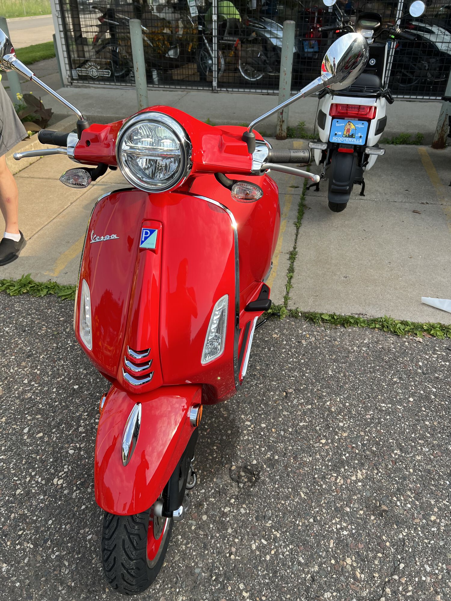

Hi everyone! I'm the proud owner of a new 2023 Primavera.
I've been riding smaller (50-70cc) scooters for the past dozen or so years, this is my first time both with a Vespa and larger engine.
I'm wondering about the first maintenance at 600ish miles. The dealer, of course, wants me to bring it to them, I've been wrenching on scoots for a while now and watched a YouTube video about the valve adjustment and it looks simple enough and I feel confident to do it.
I've got the tools and the time but does anyone know what, if anything that does or I should I document, to retain the 2 year warranty?
I bought extra oil filters at the time of purchase and I am planning on doing that myself.
My other scooters were all two strokes so I know what oil I'd use in those. Is the Castrol Power1 motorcycle oil good?
The final question is about wind. Obviously a larger engine has opened up new roads and speeds to drive, I am not used to the wind that becomes pretty significant at 45-50+ mph. A new helmet is in order for sure. Does a half windshield help with this at all? I
I don't want the full size but would a half direct the air up and over me, or just channel it more into my face?
I appreciate any insight people could provide.
Obligatory picture attached.

Welcome to MV! Love that color on the scooter!
My understanding is that you can do your own work...keeping receipts for supplies is a good idea. I was lucky, I think-had my dealer do the service, and I could sit it on it and watch and ask questions, so no regrets. Money well-spent. But I think I was lucky. If you do your own work, there's a wealth of experience here.
On the screen, I think the midsize is the sweet spot for me. It makes a world of difference over 30 mph or so. You shouldn't need a full size unless you're planning on riding in cold weather (for me under 45 degrees or so).
Hope that helps.

Congratz on the bono red vespa , it shall bring you much joy

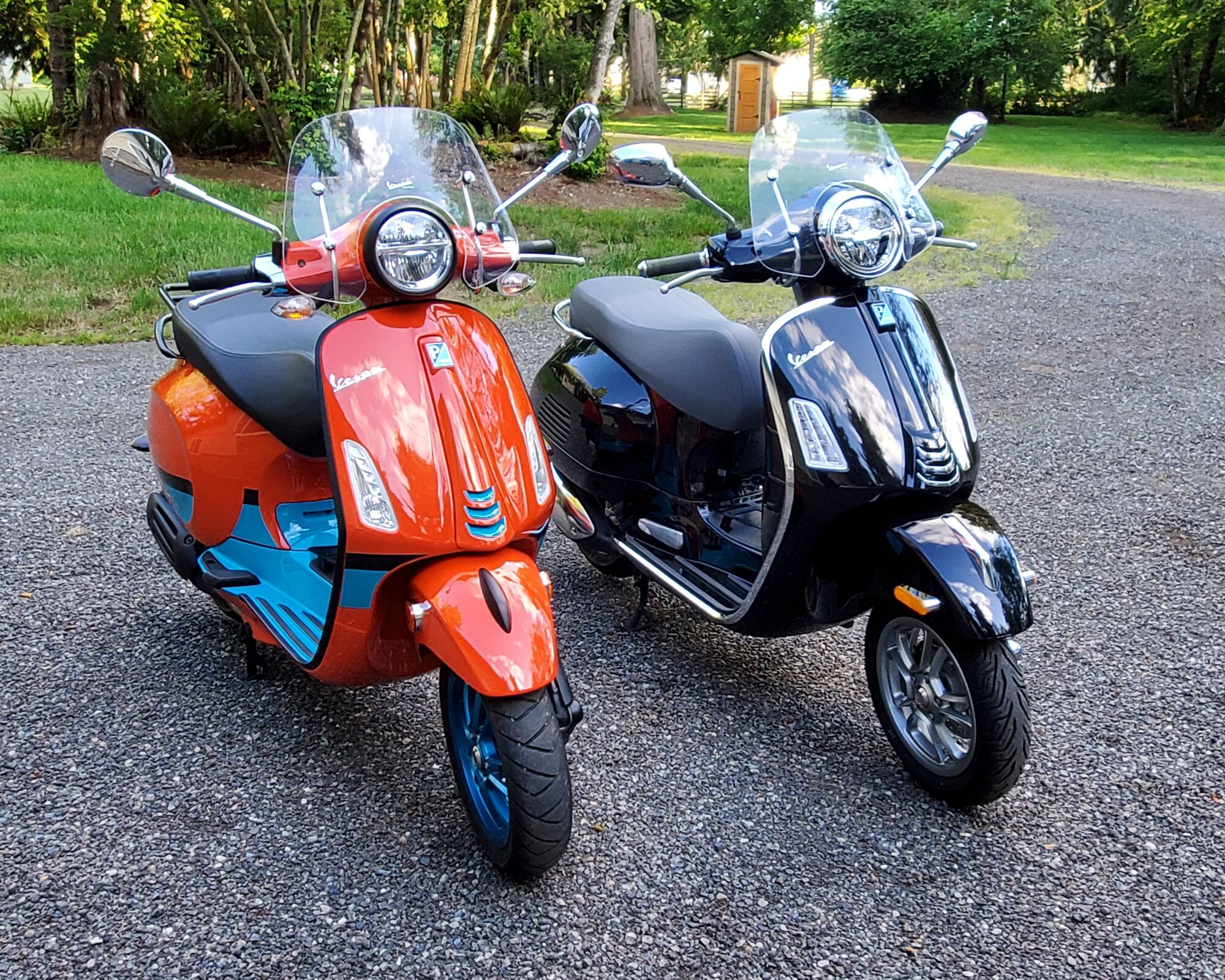

1. Fly screen, directs the wind up toward my head, but keeps the pressure off my chest and likely improves fuel efficiency (hard to tell, because I almost always refill them myself at home from 5 gal (US) containers). Earplugs can be helpful in this regard.

Hello and congrats on the new scoot. Yours looks like the 'Red' unit but doesn't have the logo by the front Vespa badge. My better half gets compliments on her 'Red' all the time.
Depending on how tall you are, a fly screen would help keep the wind off your chest. If you wanna ride later into the season, I'd recommend a mid-height windshield. Some of them have a small wing to direct wind off your hands. Shop around.

It is actually the 'Red' model. I didn't like the sticker Vespa decal so I had them remove that and put the Vespa badge on instead.

Congrats on your scoot - the perfect color.  Your photo looks like you are at Scooterville.  If so, great service team.
